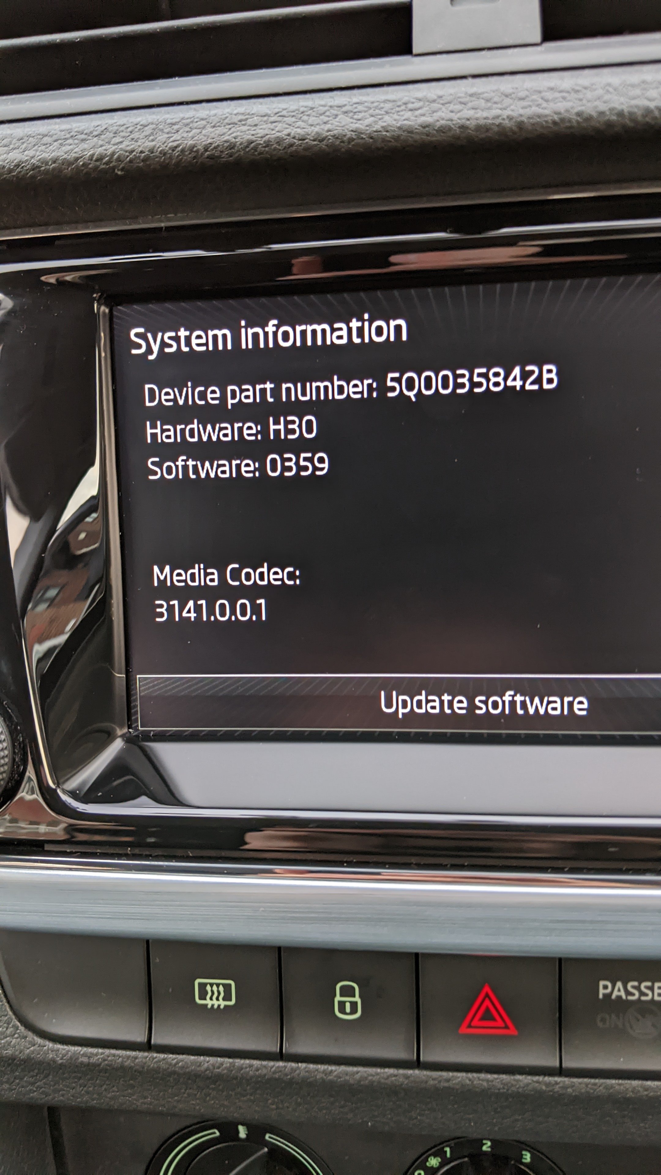

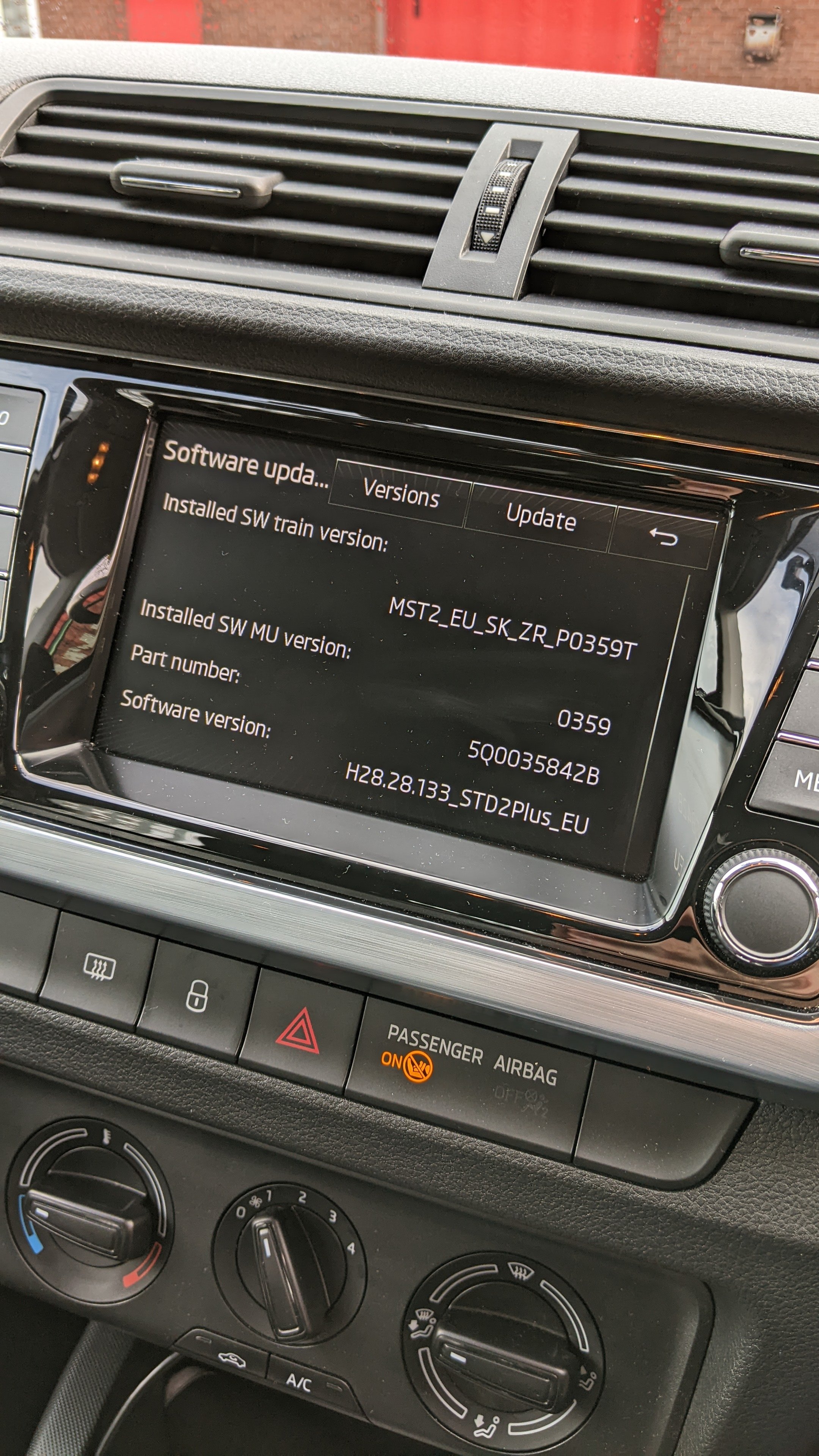

Hi all,
I'm looking to update the software on my unit to fix intermittent crashes and possibly 'ghost touches' during cold weather. The dealer requested a £70 diagnostic fee to begin, which I kindly declined.
Is there an update available for my unit? If so  please provide a link.
Would updating deactivate any features?
Regards
PXL_20221020_162110569.thumb.jpg.e827b58868c6f7201d3c1f12038af239.jpgPXL_20221021_122420077.thumb.jpg.897eab0adaecb42cdce7af8648de8656.jpg
1 minute ago, TSiTorque said:
Hi all,
Regards
Keep your £70 in your pocket, will send you a link to download and install yourself.
Usually nothing is lost in the process, unless unit was "hacked" to enable something it never had.
