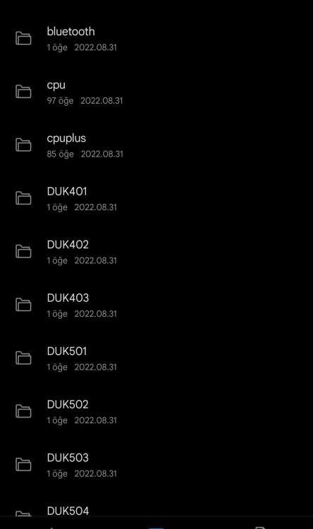

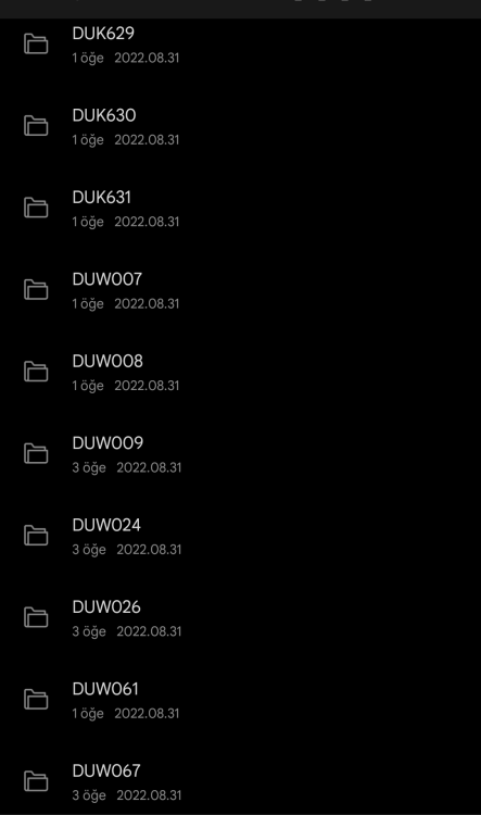

1 minute ago, gumuskurt22 said:

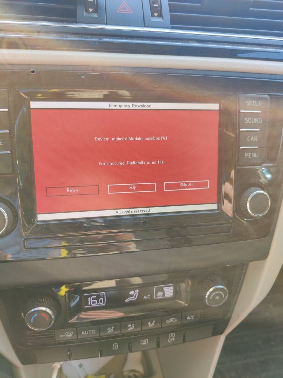

Hi please help me
It cannot read a file for some reason, was you able to begin any copying stages?
If yes, then maybe just one file/folder is missing or corrupt (looks more missing)
You will need to take an image for me of the SD Card contents

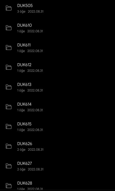

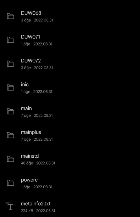

Yes
6 minutes ago, varooom said:
@gumuskurt22 You are using SD Card, and not phone or USB to SD Card adaptor?
Have you done a full (slow) format on the SD Card, and no errors found?

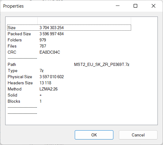

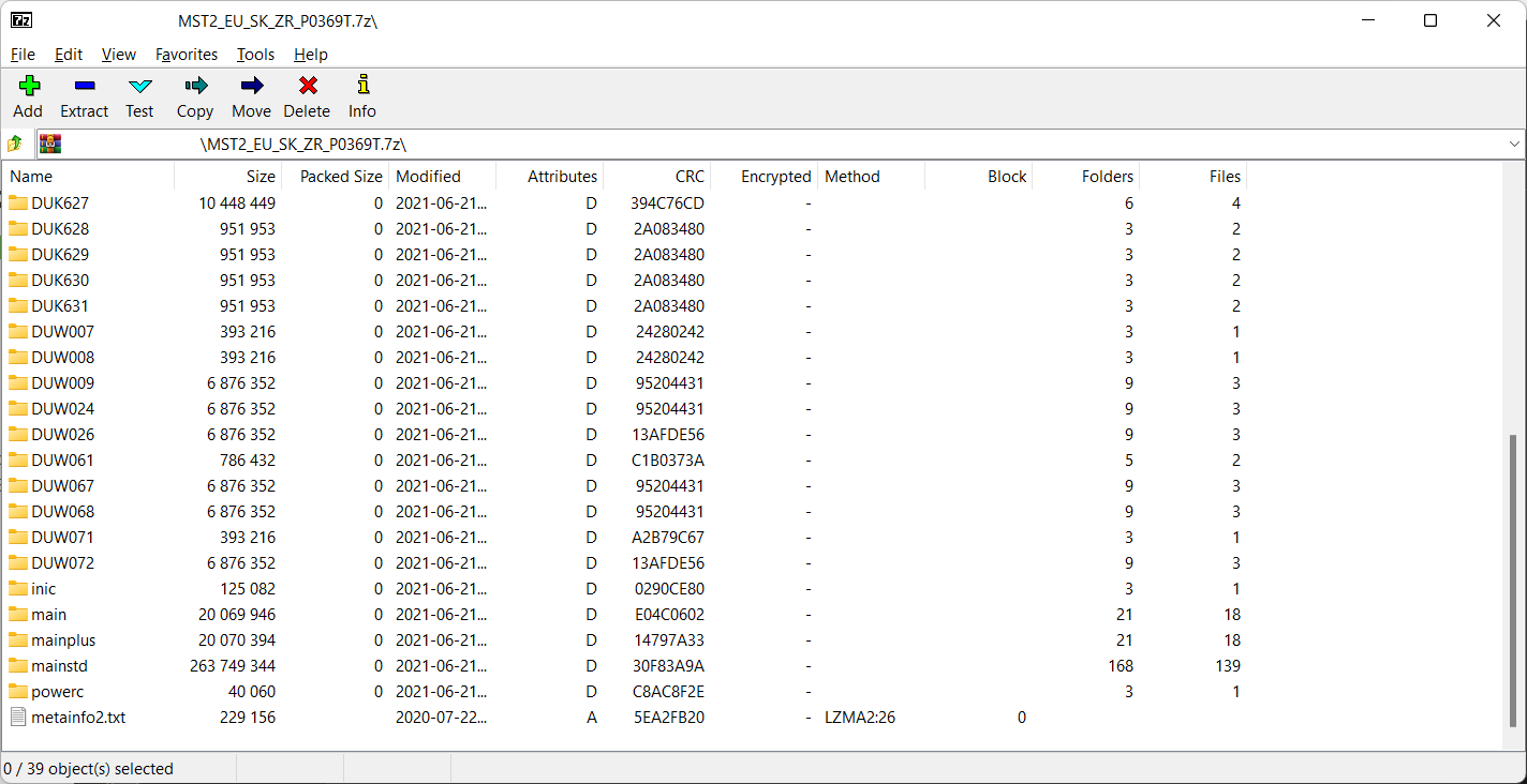

Here is the original package, and checksum of overall 7z file
Sdcard.device stays on. Is it okay if I buy a new sd card and try it?
16 hours ago, varooom said:
Yes buy another card, I presume you are using PC (though issue usually affects maps)
Thank you! the update is complete. but nothing changed. He got hopeful when he saw MirrorLink in the update files, but it still doesn't show up in the menu. Is there anything that can be done to enable MirrorLink?

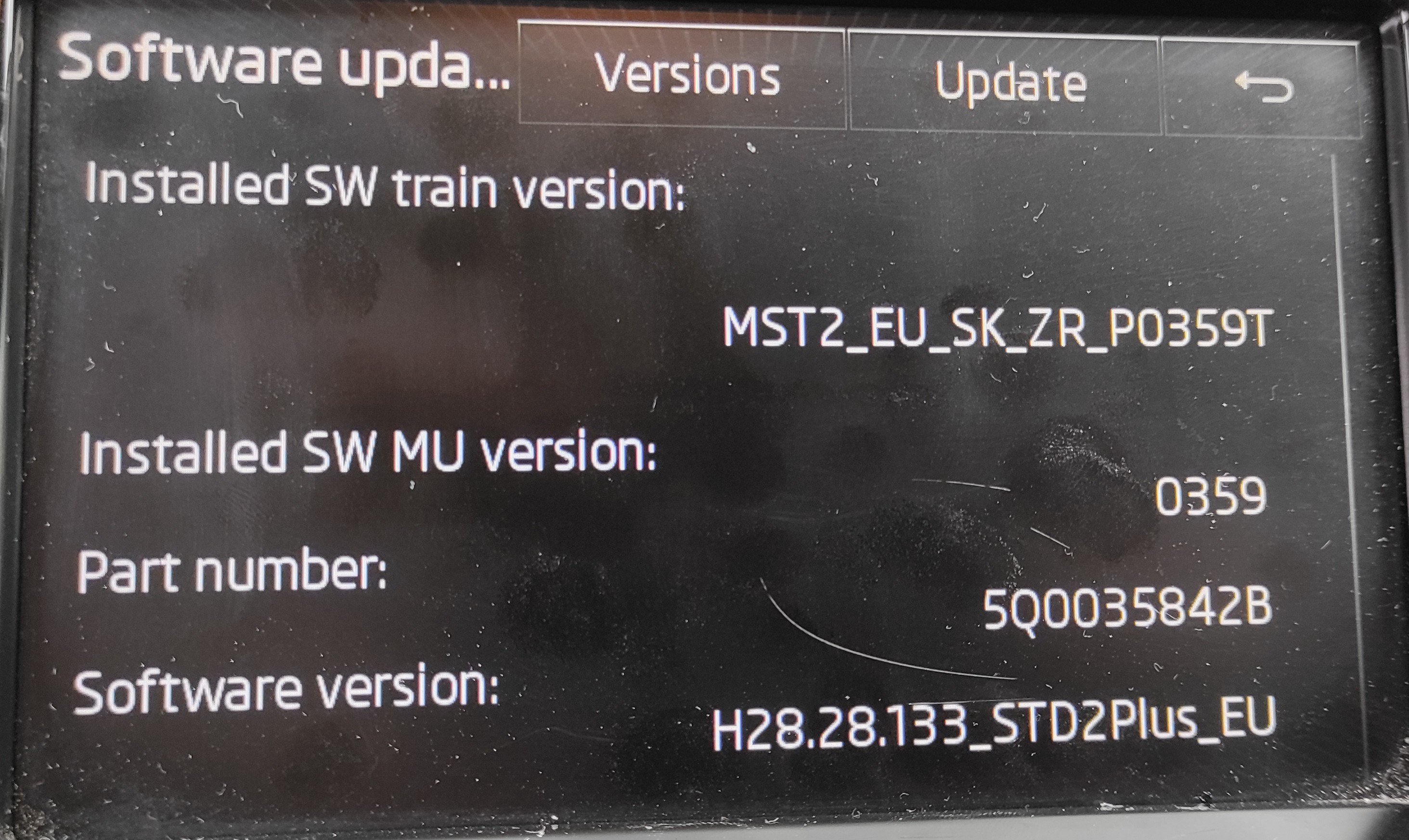

Hey @pab567@RomanB & @varooom,
I've been recently following this thread and noticed you guys are the leading experts in the matter.

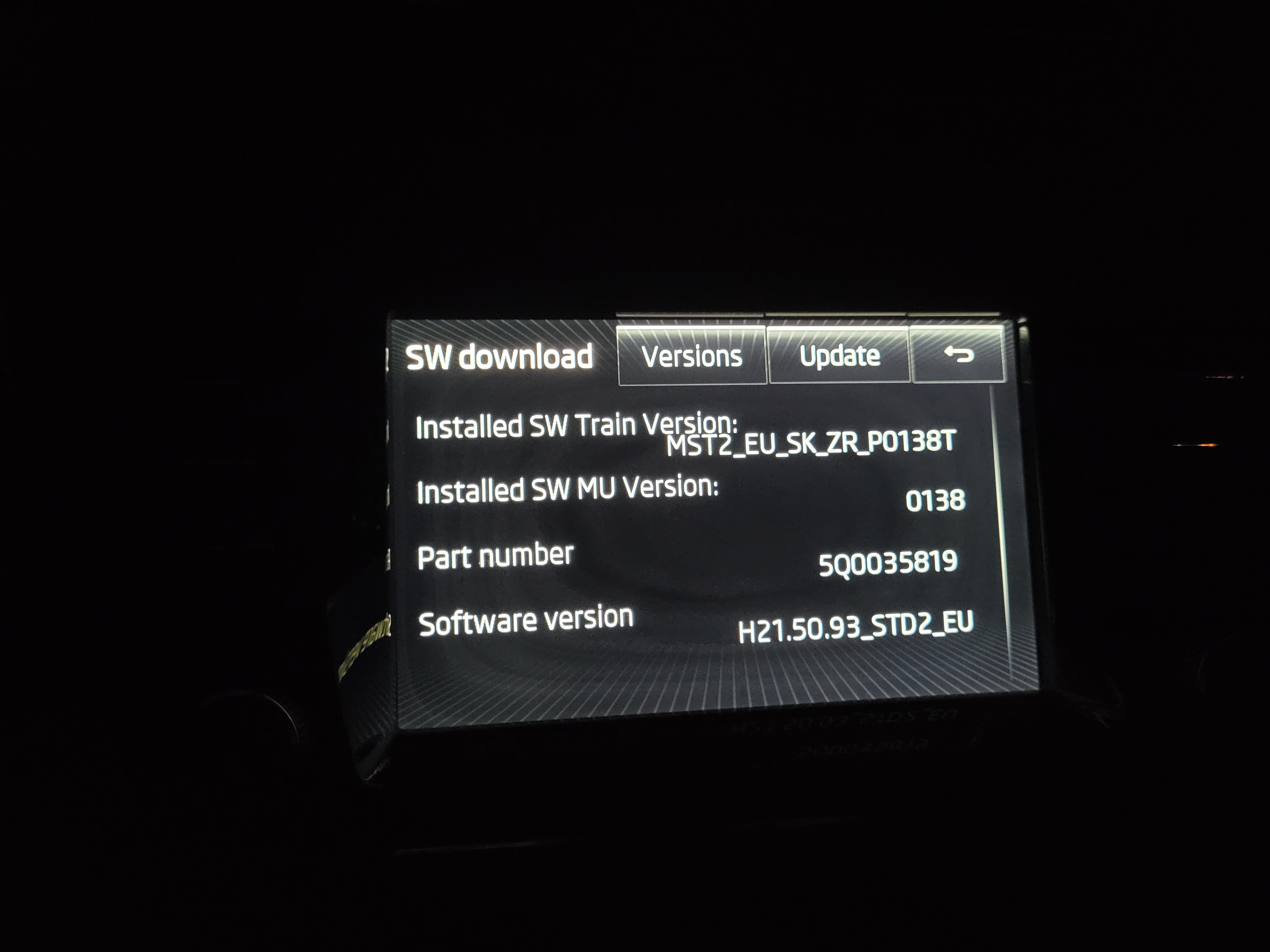

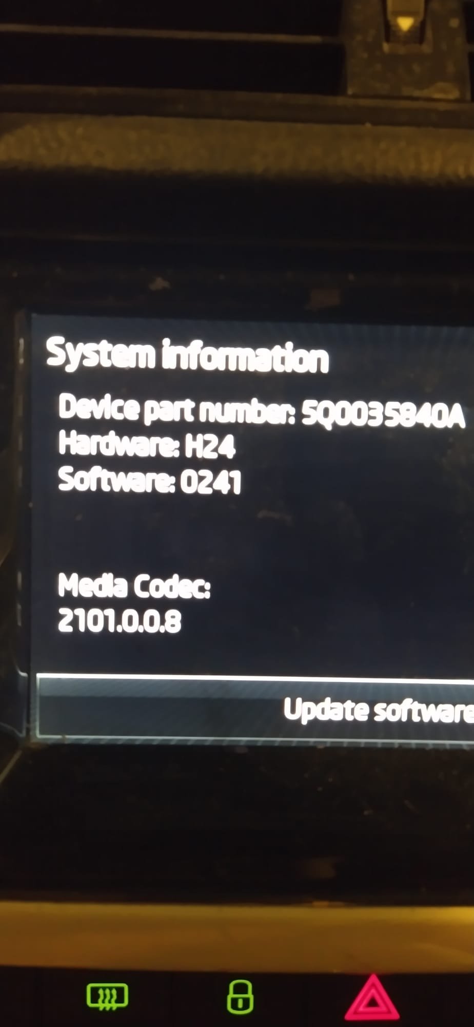

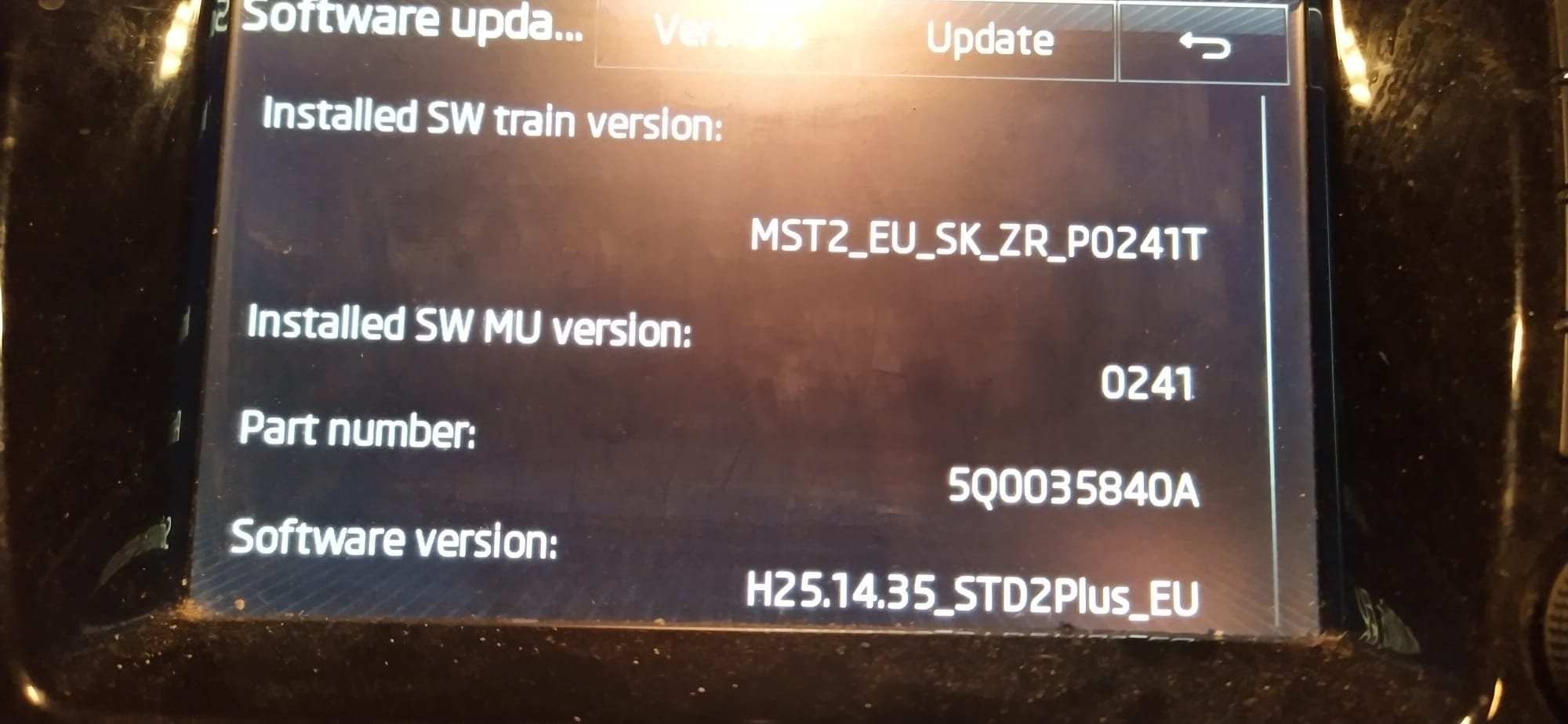

I tried updating my Skoda Fabia 2015 Bolero system by Technisat.
I'm corrently running the following:
440887041_SkodaFabia2015.thumb.jpeg.b16fce2fcea00425a65186d3bfe59300.jpeg547802958_SkodaFabia2015(1).thumb.jpeg.3bdabb0b3c1ca44033846ccdd6db6eba.jpeg
If i understood correctly the latest firmware for my system is the 253?
I've downloaded it from the "mibsolution" link @RomanB provided and extracted it into a usb thumbdrive, which was formated to fat32.
As I go to update through the "service menue" I encounter the following error:
"Error file access
Code 15
Cannot find the correct medium"
Could any of you assist me as of what is going wrong and how to do it correctly?
I've tried 2 different USBs and also the older version 245 & 252 with the same error occuring.
Any assistance would be very appreciated.
Thanks in advance!
@MaShu Stick files onto SD Card, and forget USB!
Remove all USB and other cards from car.
Use battery support, or start the engine before update, do not start engine during update, it needs stable power for up to 1 hour, usually 20mins average time though.
That should make success.
