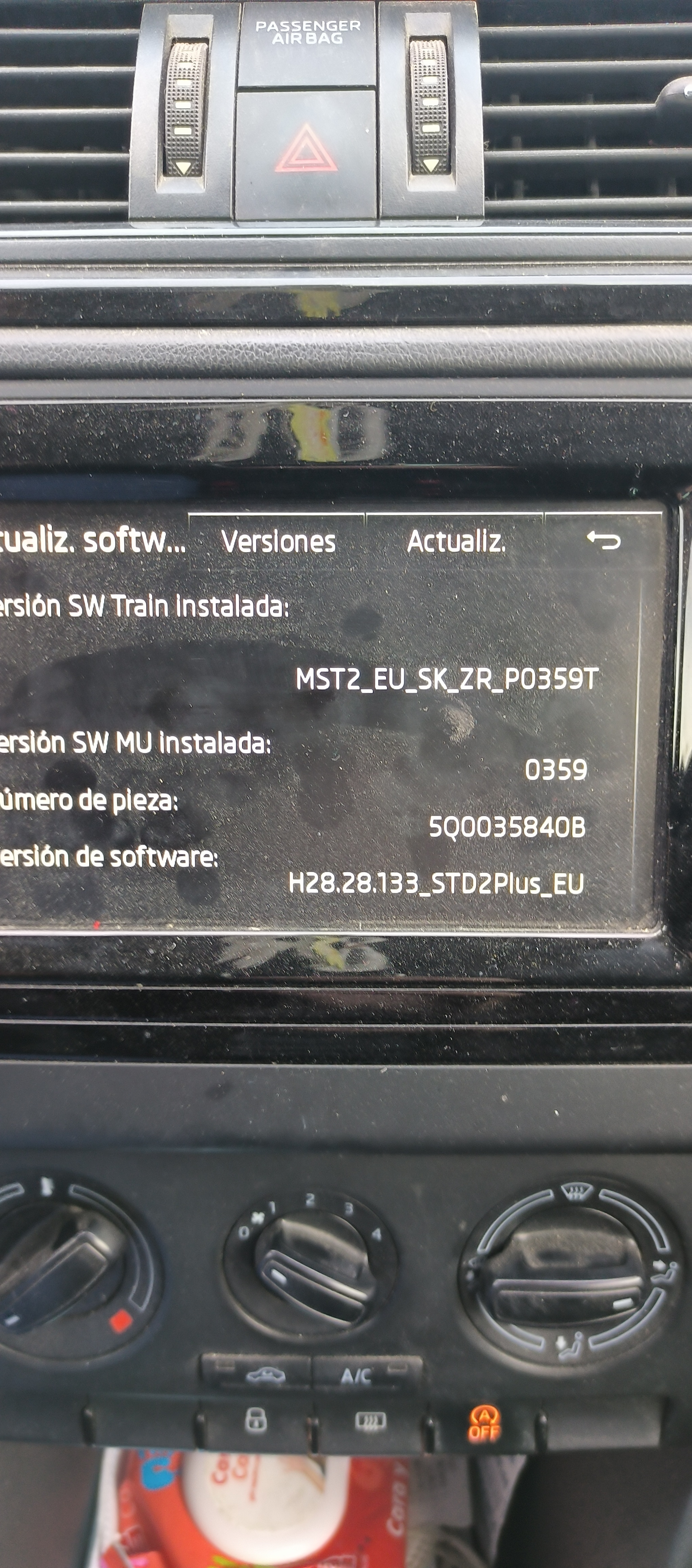

Can someone clarify the process?
I have unzipped the contents of the provided file onto FAT32 formatted USB drive and an SDcard, neither of which are recognised by the head units system menu for upgrading.
On 26/04/2023 at 17:32, Tulsey said:
I now have the SW train and have attached it @varooomor anyone else who knows about all this stuff.
You need to be on this page here to push that update button.
The file I sent needs unpacking to the root of a FAT32 or exFAT formatted SD Card, not to a folder like E:\MST2_EU_SK_ZR_P0480T
The root of the SD Card should contain a single file called metainfo2.txt, and then a collection of 38 folders
Yes, that is what I have, FAT32, in root one file and 38 folders. I am on the correct screen and chose the update button. Simple requirements, I am not sure why the media s not being recognised.
Maybe I will try exFAT?
To rule out human factor (me)
Check your metainfo2.txt
Should contain these lines near the top
[common]
Release = "MST2_EU_SK_ZR_P0480T"
MUVersion = "0480"
Vendor = "TechniSat"

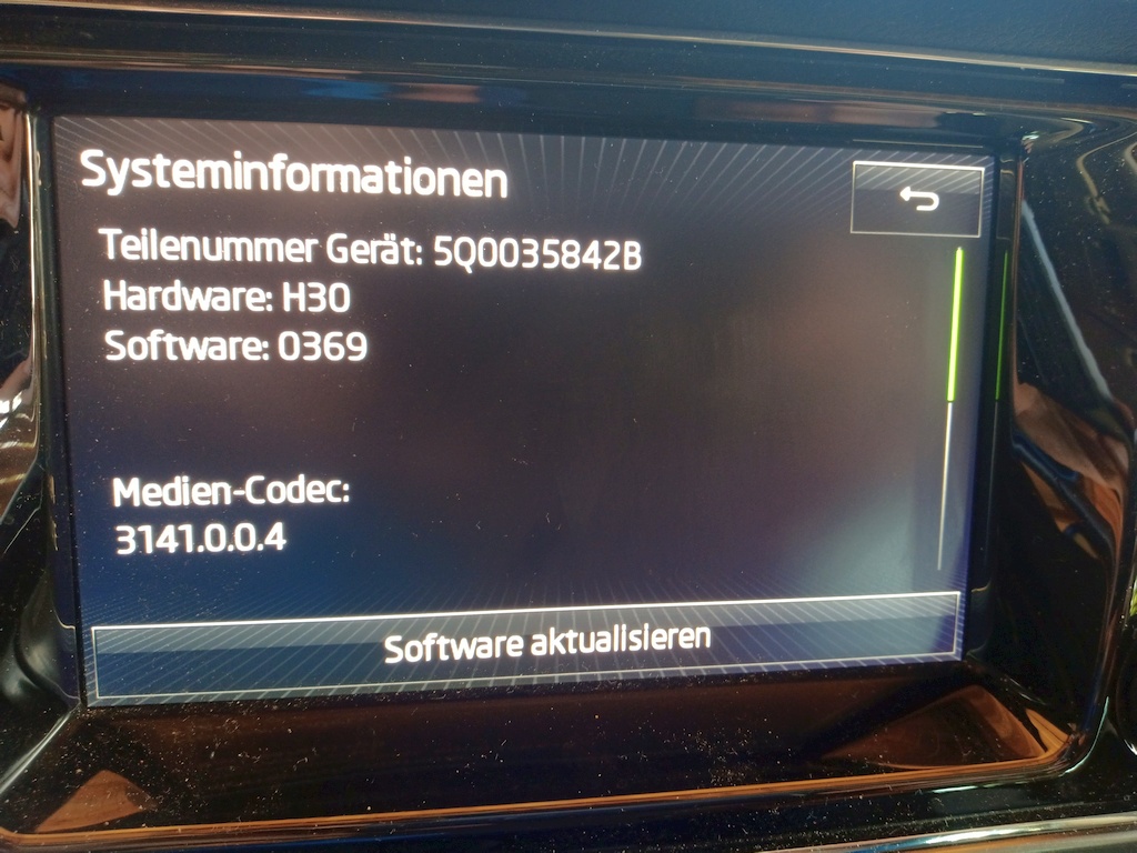

Hello,
i got to manage to install version 0369 for my car. Thanks, varooom!!♥️
Is this the newest version (its from 2018)?
So here are the screenshot:
Yes is current version.

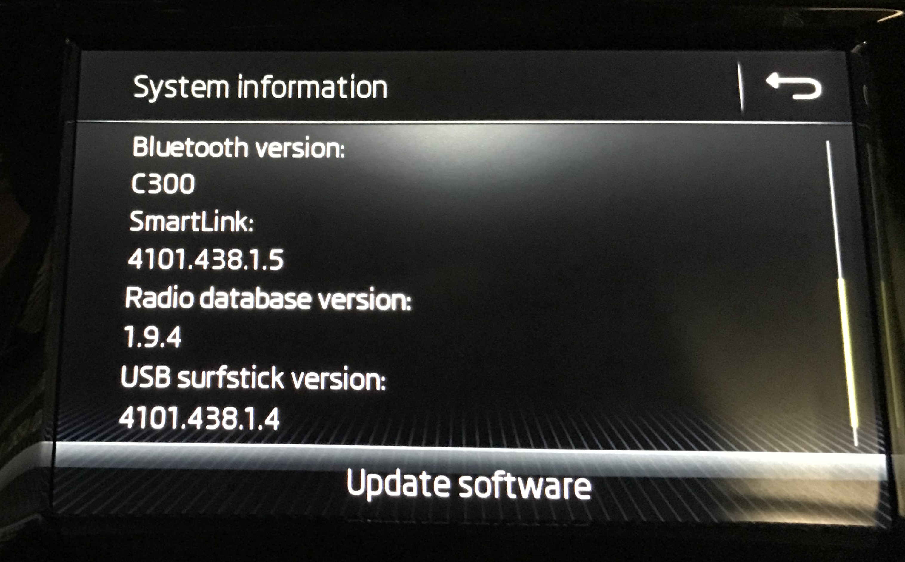

Hi,
I have a Fabia Mk3 Clever 2018.
As I understand it has the Smartlink SW but it is disabled. It's missing some cable between I think the BT module and the "System box" if I remember correctly?
The car has the voice control button on the steering wheel, but it says "voice control not supported" when pressing it.
I would be very grateful for any help getting Apple Carplay working in this car. Also thankful if I can get a SW update link by PM.

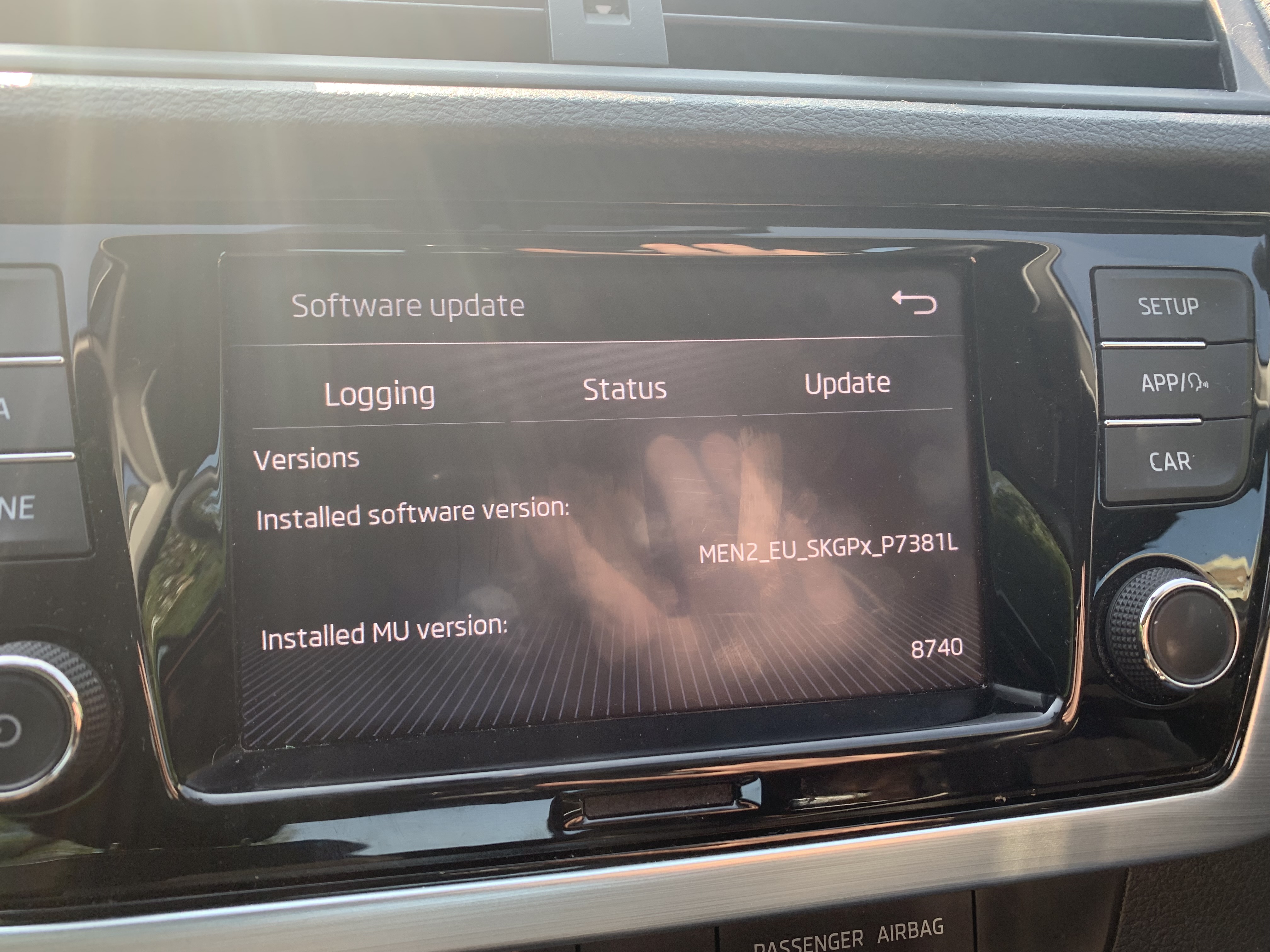

Is there an update for 2019 Skoda Fabia please?
Installed software version:
MEN2_EU_SKGPX_P7381L
Installed MU version:
8740
8740
You can update to version 8755, I will send you a link shortly.
