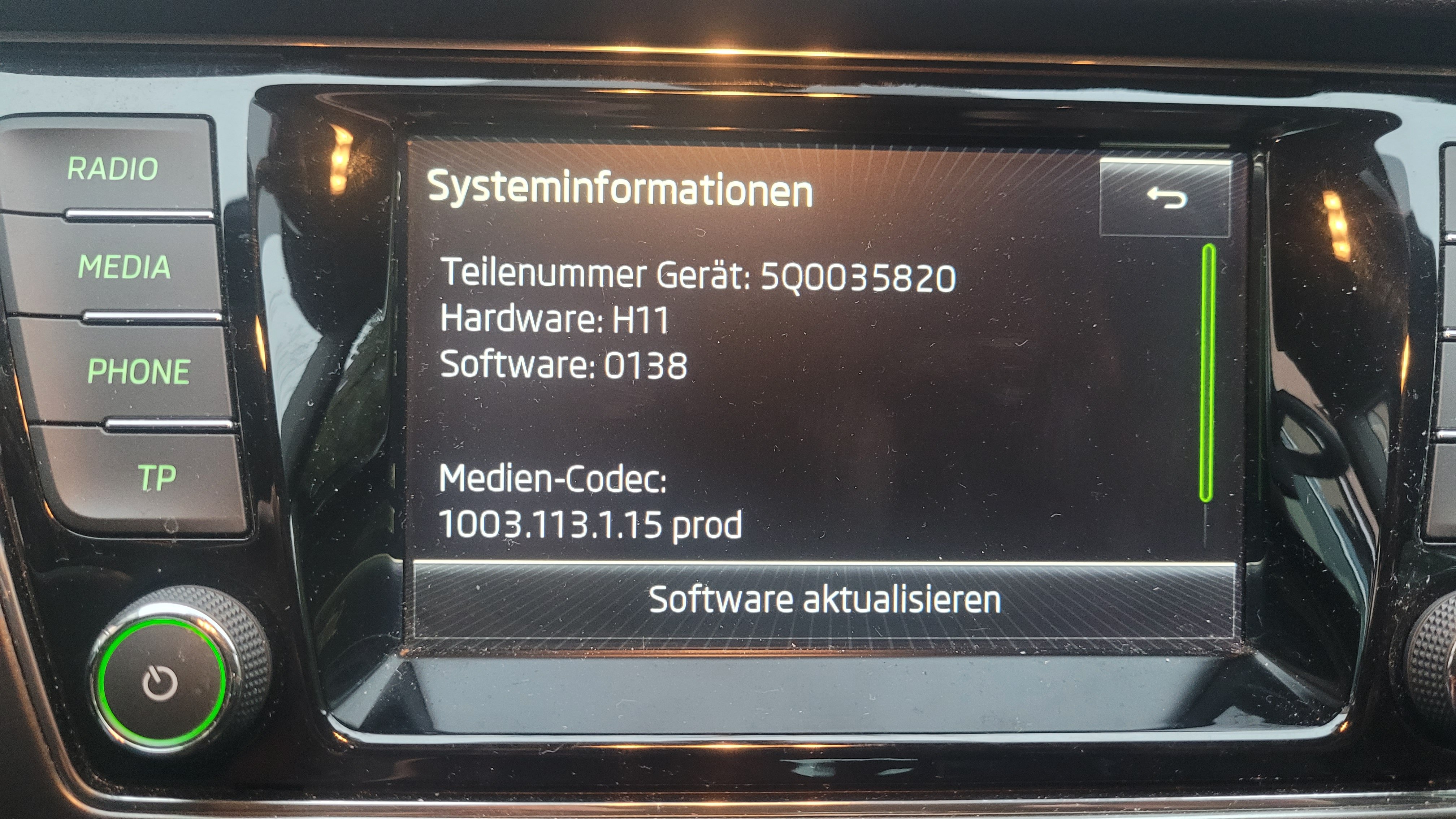

Hallo Ich brauche auch Bolero update, kann jemand mir helfen?
Vielen Dank

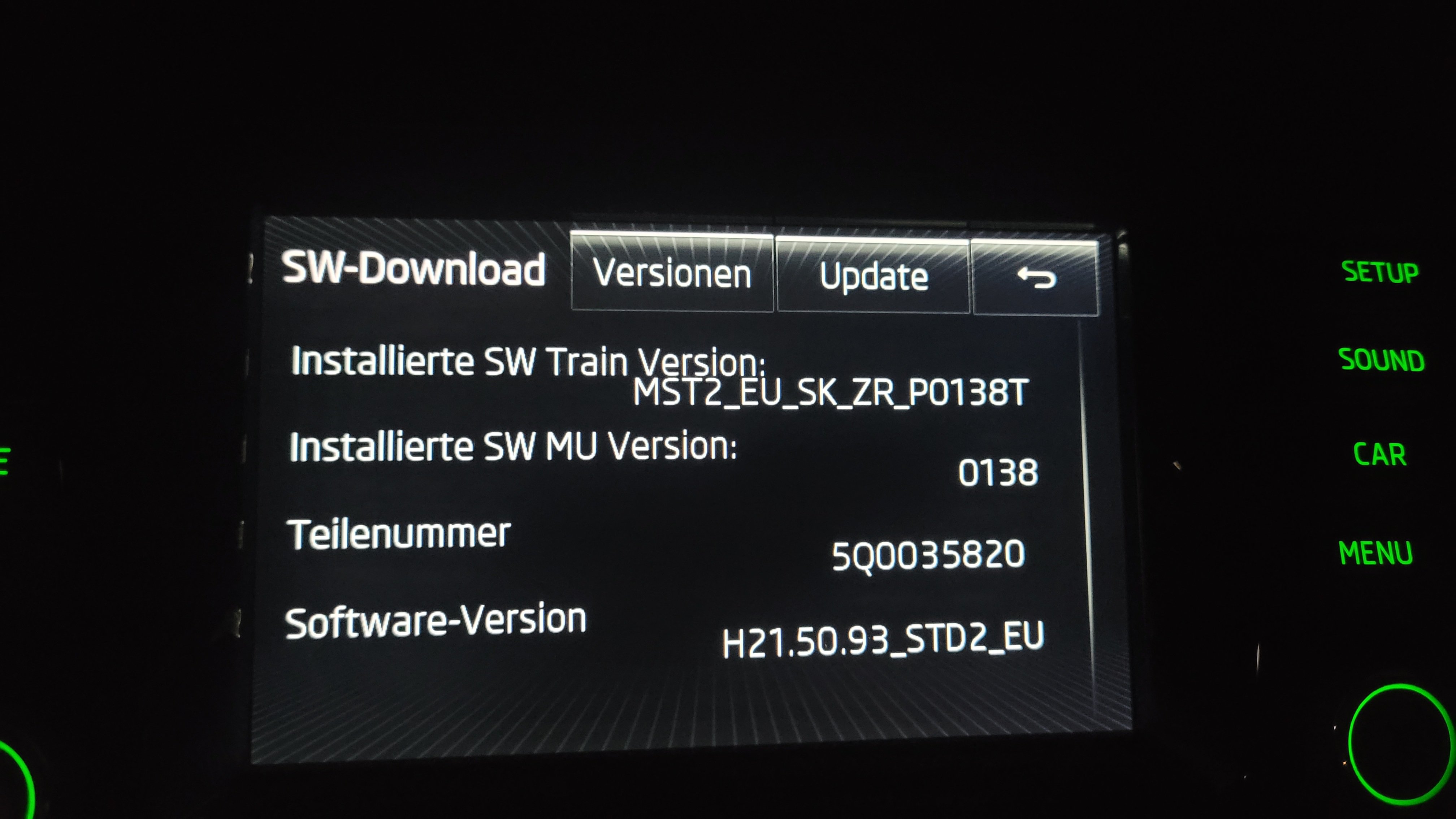

This is the current version for your software train, so no update available.
MST2_EU_SK_ZR_P0138T
Hold your Menu/Setup button for ten seconds to enter engineering menu and find this value to verify.
Thank you for the information,
there is absolutely no way to update, attached is my version
Thanks a lot

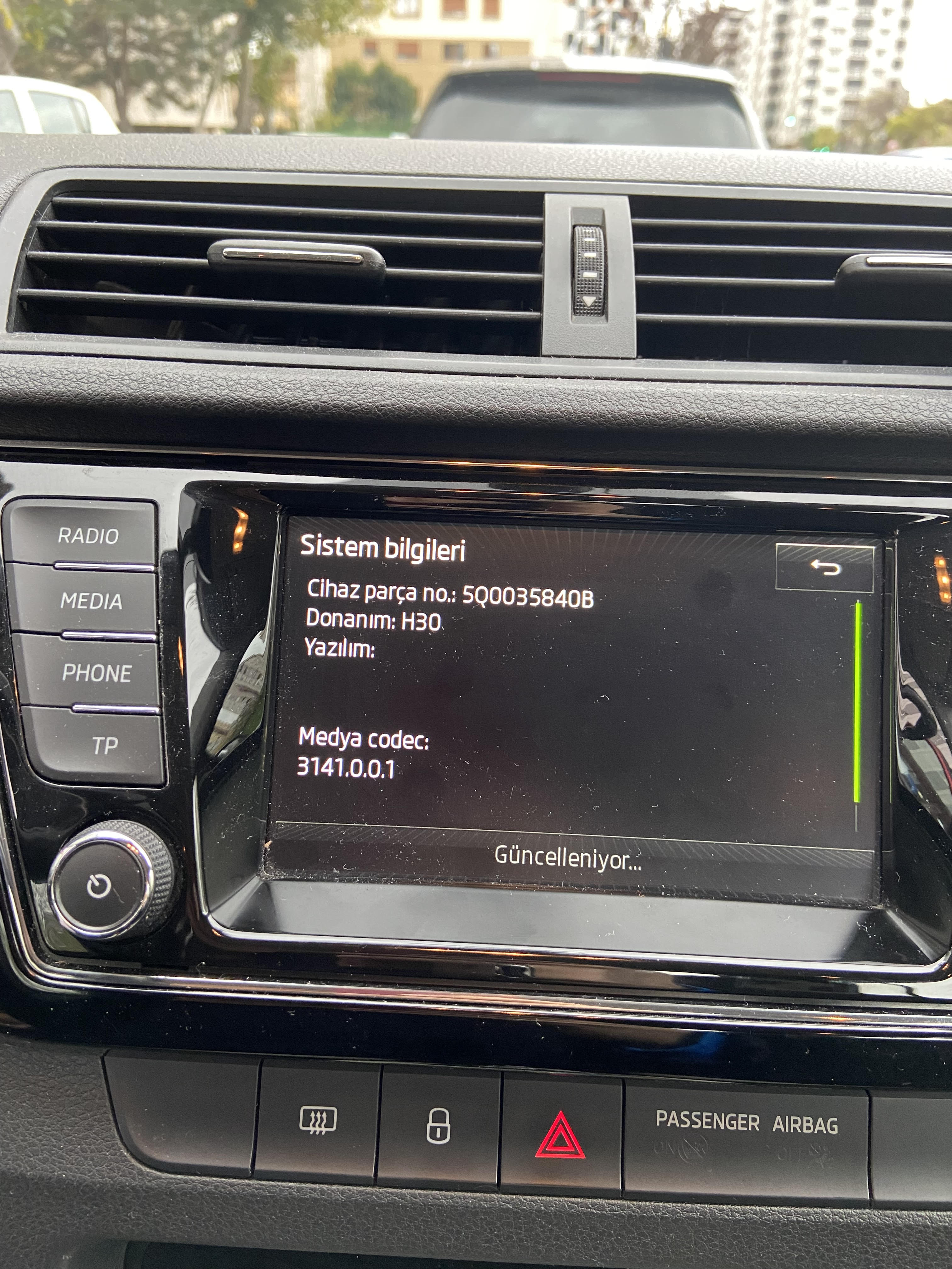

I have 2016 Fabia 1.2 TSI Style Manuel.
I'd like to update my swing radio please, could you send me an update link please ?
I live in Turkey. I use the multimedia language Turkish. Thank you very much in advance.

Hold down your menu/setup button for about 10 seconds to enter the engineering menu.
Look for Software Train information.
Post back an image.

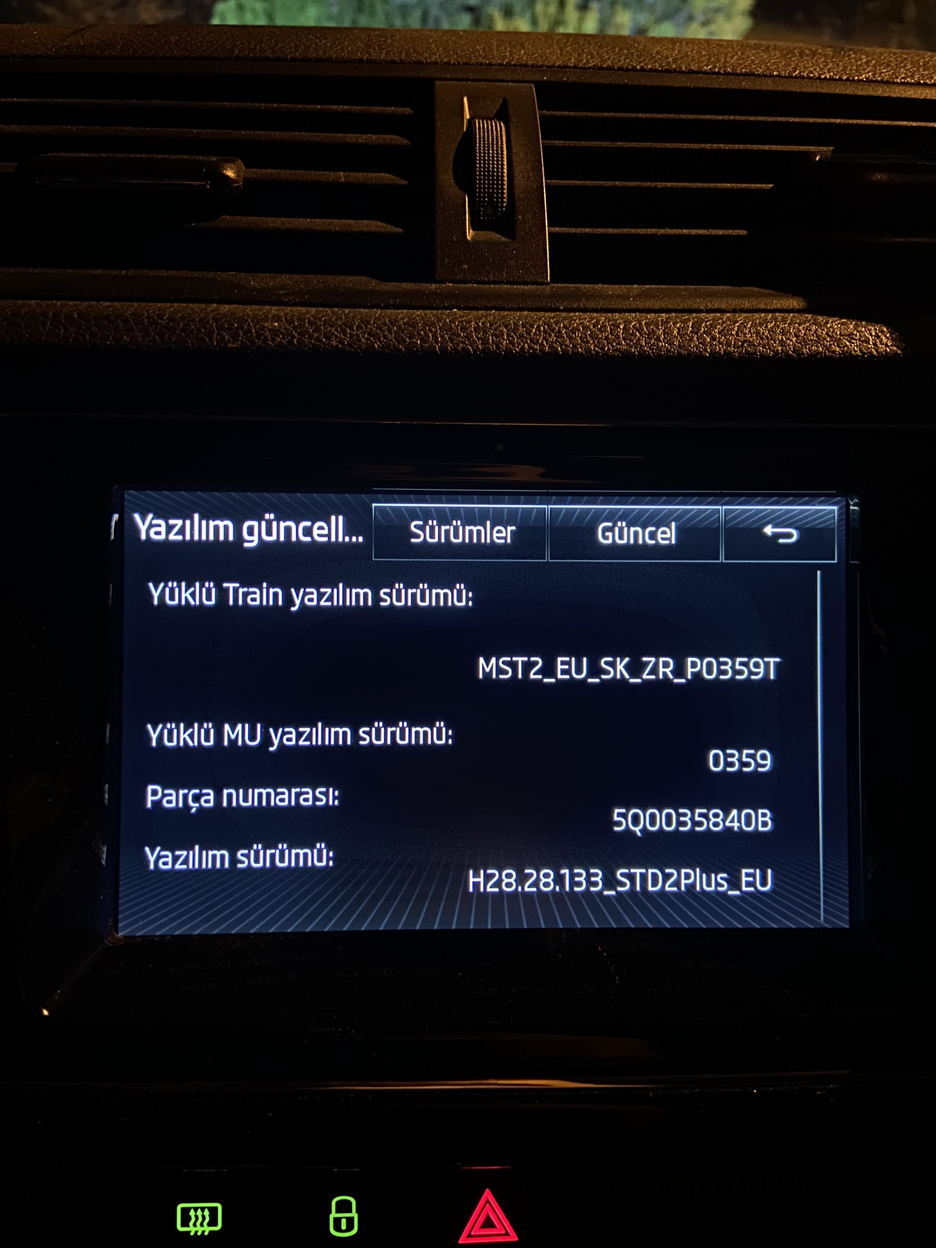

Ok
2 minutes ago, varooom said:
I will send 0369 soon, and the above image is your update location.
5-10 minutes.
5-10 minutes.
I downloaded and installed version 0369. It took 17 minutes. Everything is great at the moment.
thanksssss

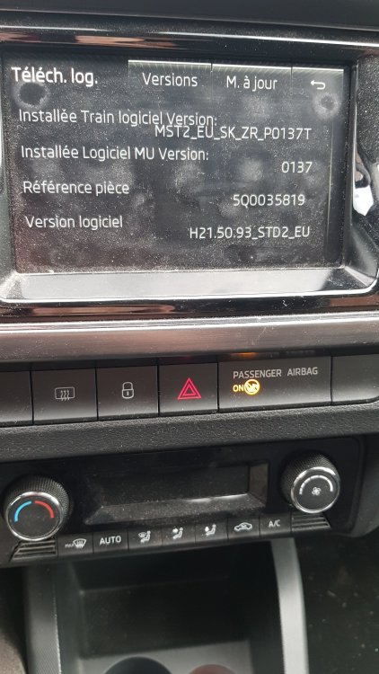

Hello,
Do you have a new firmware for my system ?
Thanks for your help.
1 hour ago, Gonzague145 said:
Hello,
MST2_EU_SK_ZR_P0138T is available if you still want it.
Can you send me it by pm ?
Yes of course
