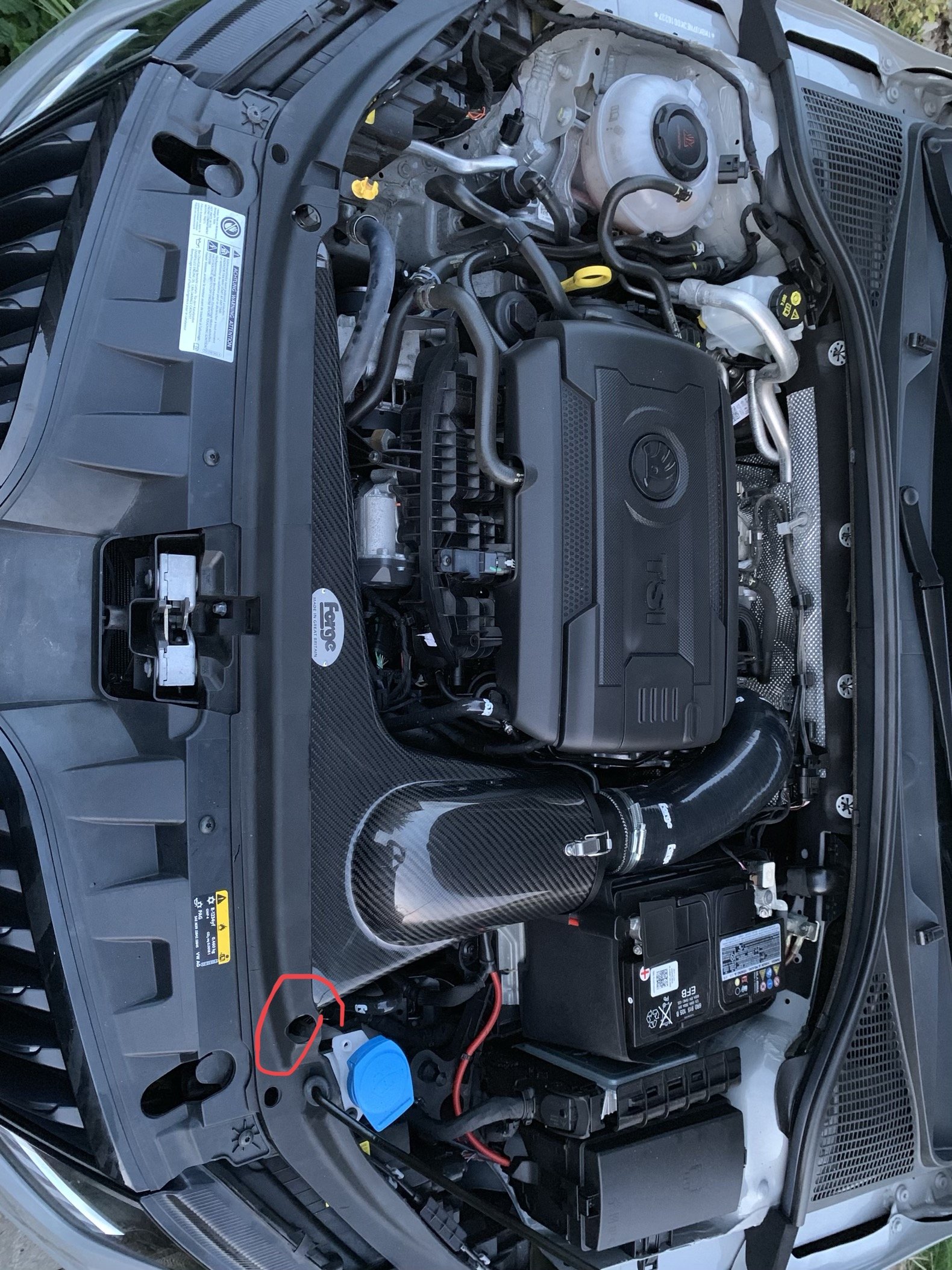

Evening gents ,
Since Iv fitted these parts Iv noticed it has created a really annoying metallic reverberation between 1k and 2k revs and the other thing is it’s more apparent when in sport mode 🤦‍♂️,
initially I thought it was the plastic dash shaking but I’m leaning towards the tin heat shield in the engine bay 🤷‍♂️
Has anybody else experienced this or has a solution please ,....I still absolutely love the thing though lol

Have you checked that all fastenings are tight and secure?:thumbup:
That’s a very good point apart from just giving all’s the new bits a shake I haven’t to be honest actually checking the bolts and screws are tight but I will tomorrow morning first thing 👍

I couldn’t wait till the morning lol so I went out with the trusty head torch and my ratchet set to check and the screw that locks the carbon airtake to the grill was lose not a huge amount but I could lift the front up from the grill by about 5 mm , everything else is tight ,..
tool it out for a quick spin and it seems to of gone 🤞this is it 🤞🤞🤞🤞
This screw here in the red 🤷‍♂️
