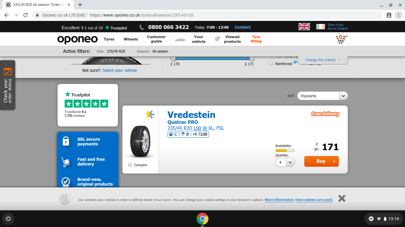

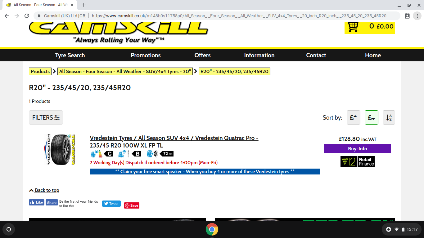

I fitted the Vredstein All Seasons on my Kodiaq and I'm really happy with their performance. Good on snow and I've not noticed any obvious downside for summer use.
Yes the Vredstein would appear to be the only all season tyre available in the UK. However it looks like there is more chance of me finding rocking horse poo than selling the tyres that will come with the car for a decent price to make it financially sensible. Plan B could be to wait until they've worn down sufficiently, swapping front to back at 10-15k, to justify changing them to SWMBO!

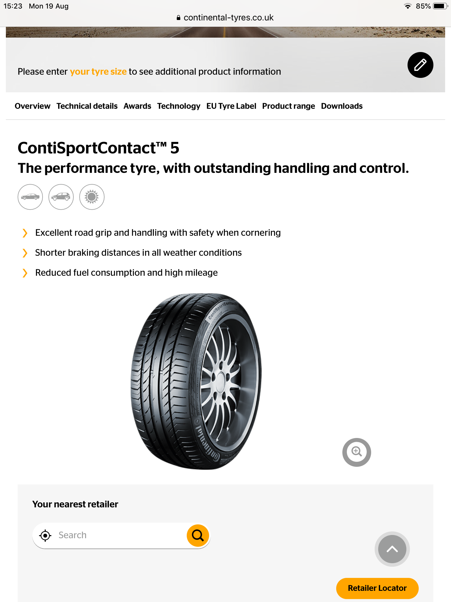

Anyway the truth be that Continental class their Sport Contact 5 as a summer tyre.
Oh I know, and its been superseded by the ContiSportContact 6. Which is, yup, a summer welly.

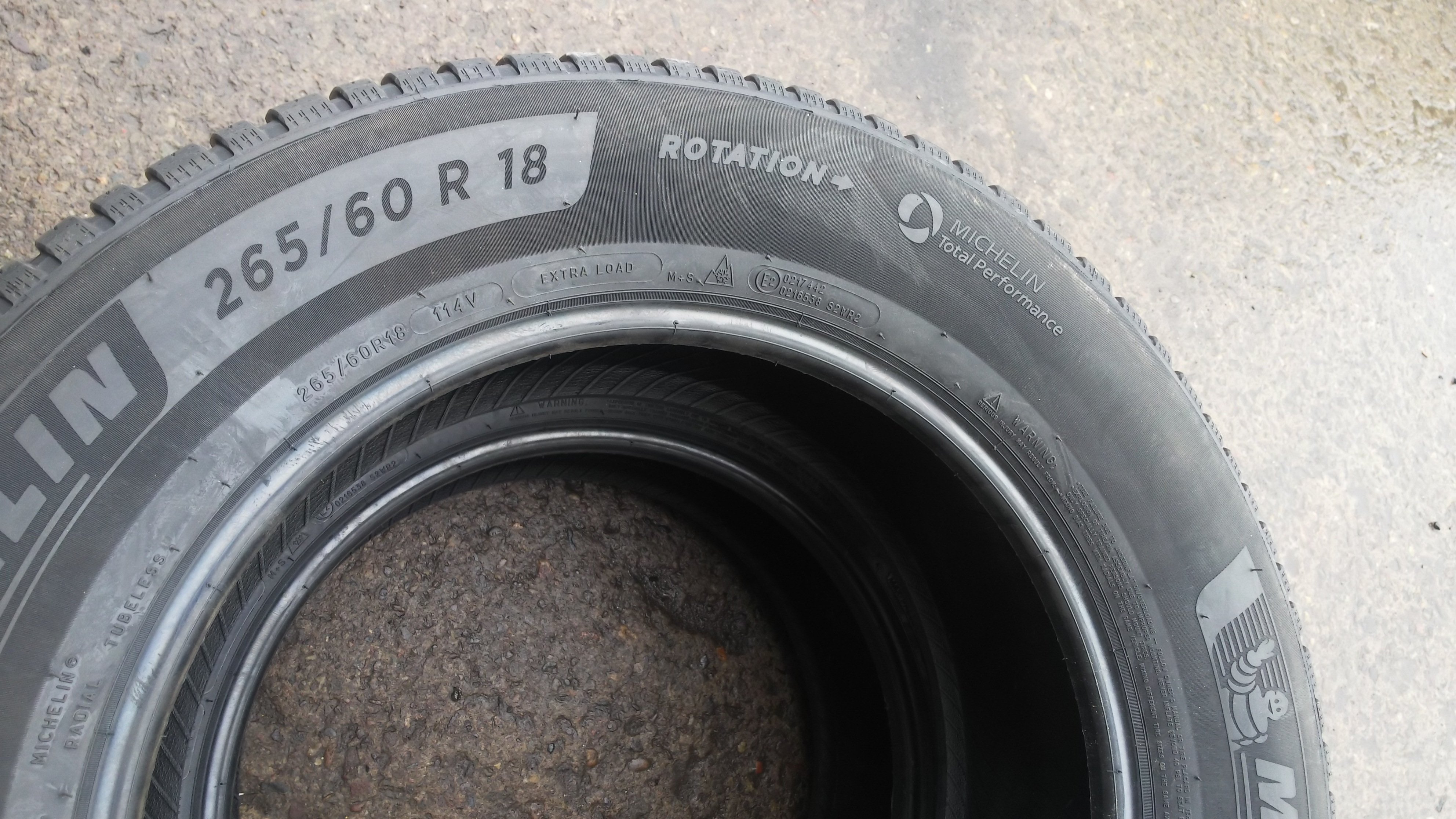

I fitted 265/60 R 18's to my Mitsubishi instead of 285 Scorpion Verde that were fitted.

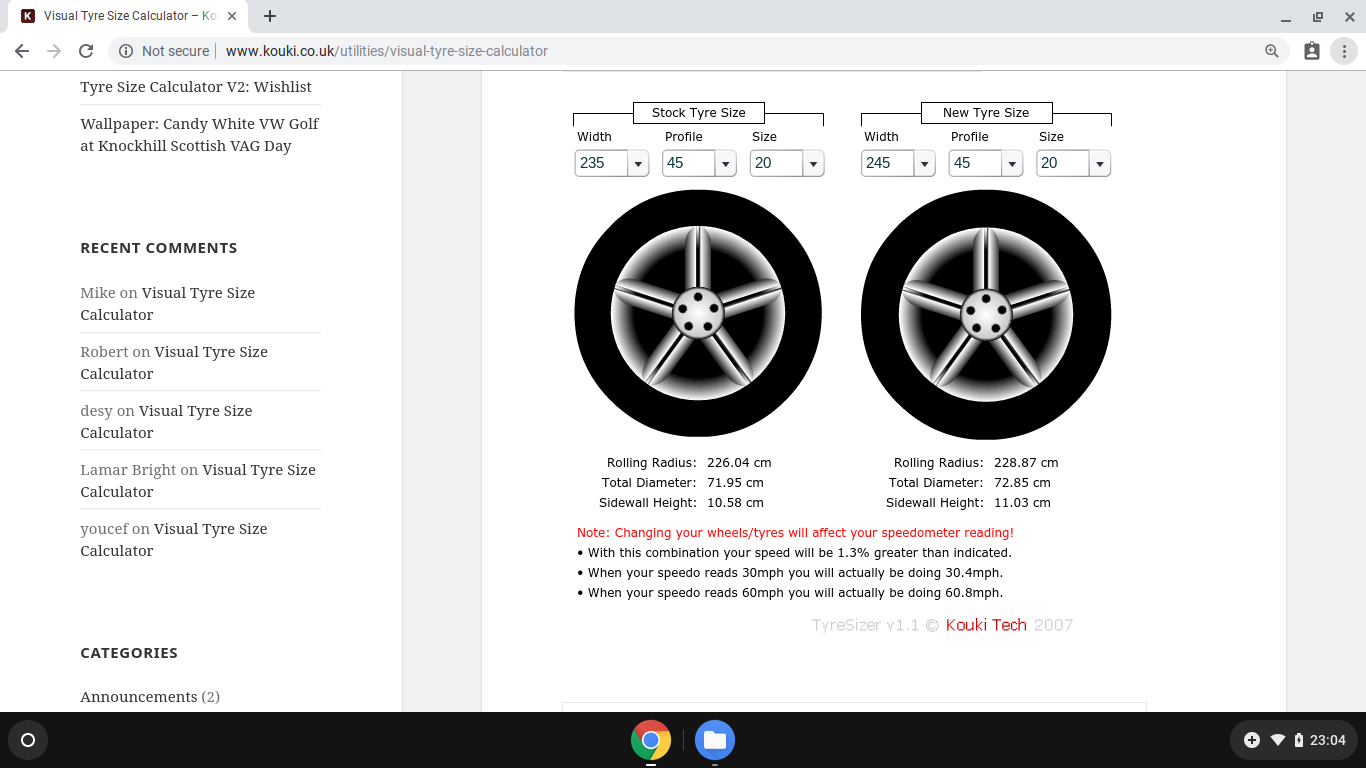

To add some more info to this thread, I’ve just fitted 245/45/20 Michelin cross climate SUVs to my kodiaq sportline and they work great. Look a bit more chunky but wet grip much improved and will give us half a chance in snow (without going for full winters).

They look good and presumably the extra 10mm tyre width over the stock 235/40s gives an extra 5mm of kerb protection when parallel parking.
