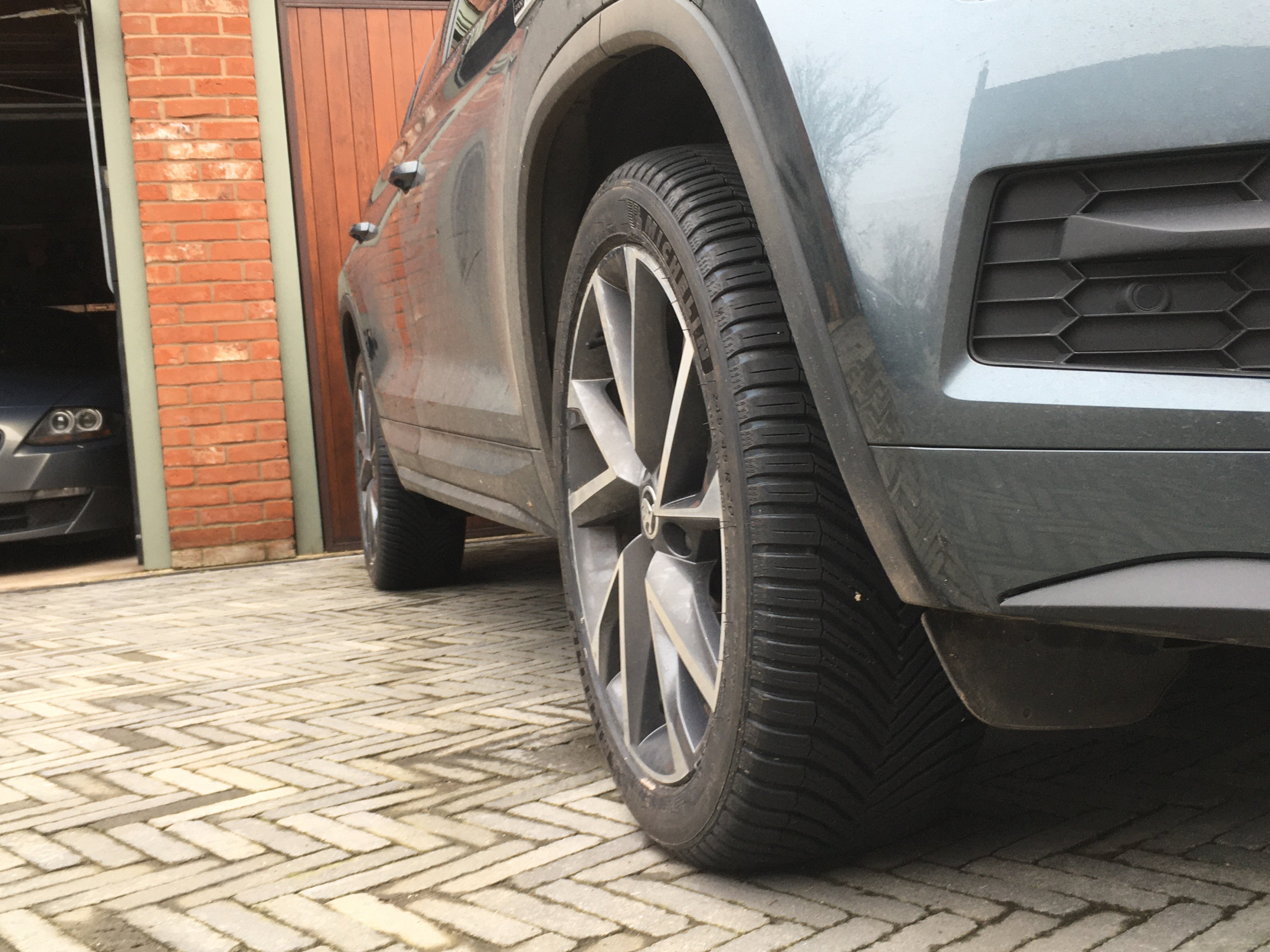

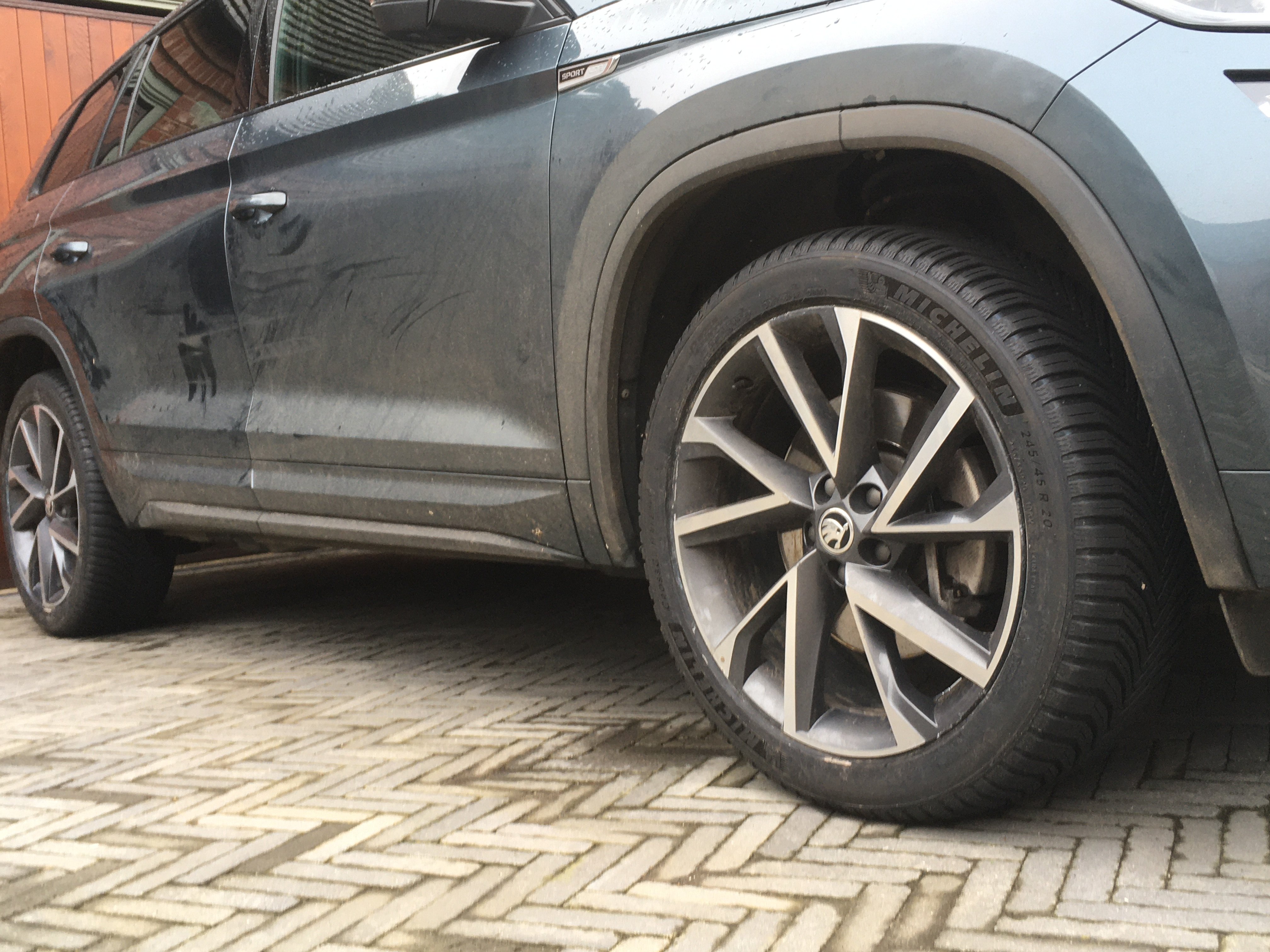

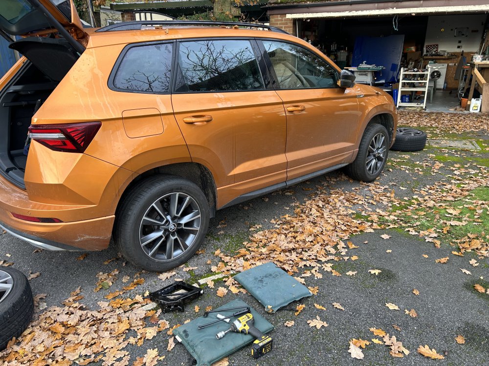

I just downgraded my 19” wheels to 17” yeti wheels .. for more suitable to the New Forest single track roads
The replacement tyres touch the kerbs , not the rims
The outside circumference is less than 1% difference
so I have a spare set of 19” rims and tyres with just 5000 miles on them
(also… 21mm socket seams to fit over the jack winder up if you have an impact driver, so I hear)
225/40/19= 2082   As supplied
225/50/17 =2063 0.92% less ( yeti )

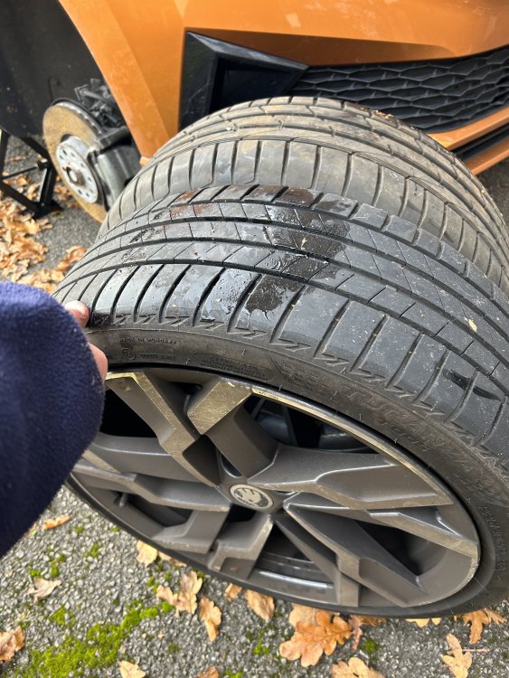

Hope you don't mind me saying, but zooming in, I'd have thought kerb damage is the least of your worries!  There's damage over the full alloy radius.  What have you hit?
Hope you never used the best out of the four to take a picture of. :D
4 hours ago, kodiaqsportline said:
Karoq no one had 18” wheels and had no damage for 3 years until it was rear ended at 40 mph  at the end of the motorway . It was a total loss- I had very limited choice of replacement cars , or a 38 week wait
.In two months the new one touched two kerbs at very low speed
is very poor design choice .
it’s a SUV, who puts narrow low profile tyres on a SUV .
They will need a minor referb before selling.
As per JR above.
