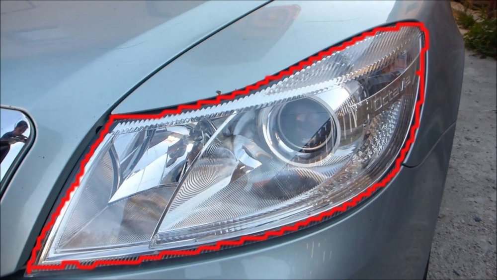

For the lack of a better picture, see the badly photoshopped red line. It's the one that goes around the perimeter of the front of the headlight assembly to stop dust from getting in. I'll get a better picture in the morning.

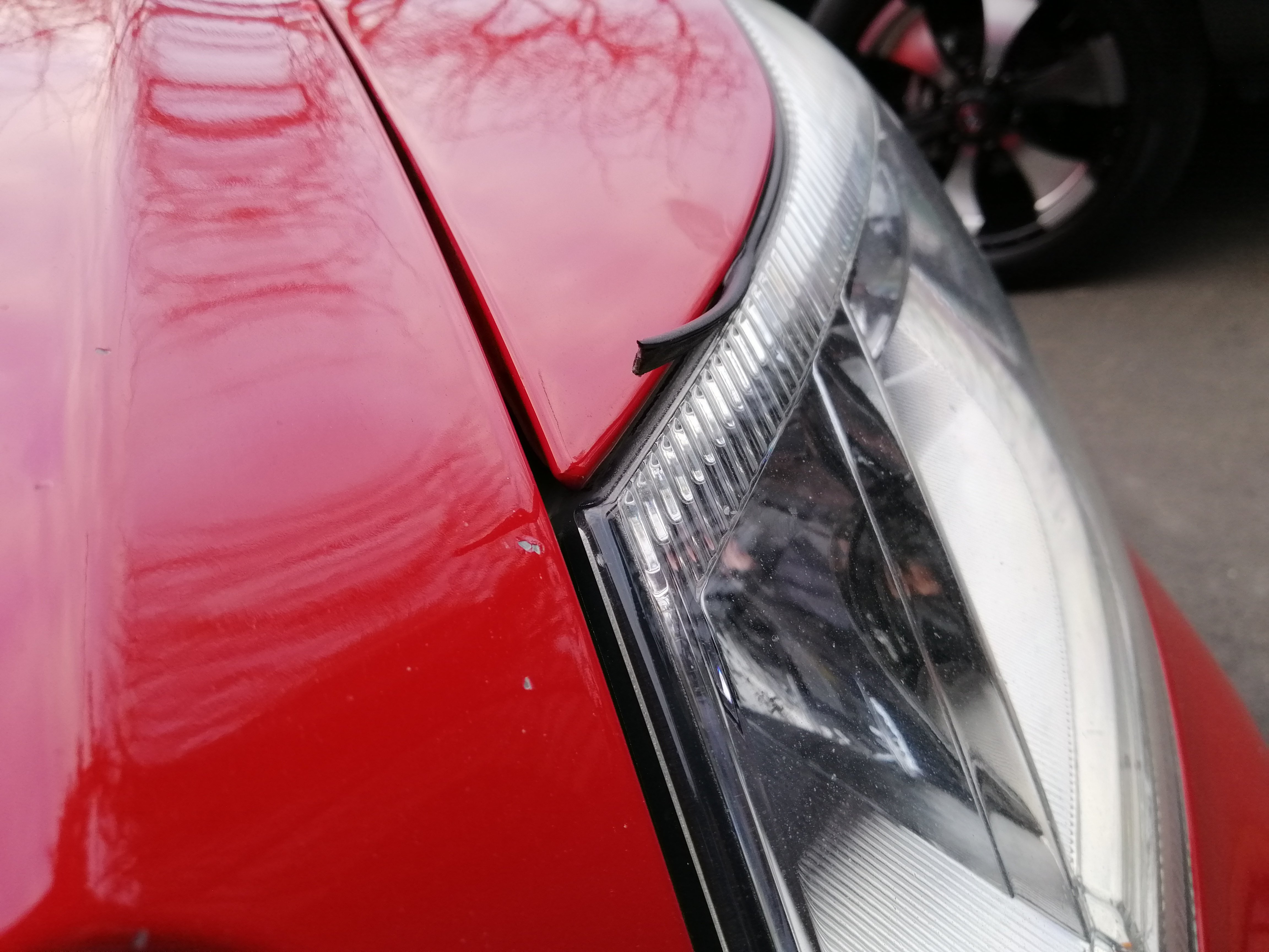

Here's the photo of the seal! Any clues?
Cool, looking at that, a few images online and the parts diagram, I'm afraid to say it seems to be part of the headlight and isn't available separately. I'd never even noticed it :)
As for the fix, you probably need to remove the headlight and either use some double sided 3m tape or adhesive to reattach it. Be slightly careful as polycarbonate (headlight lens) can react badly to some glues.

Think it is to give a firm fit against the wing and bonnet panels.  I don't think it seals the headlight assembly. Just remove and try to glue back down or remove the damaged bit.
