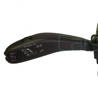

3) Cannot find a cruise control button. I thought this was standard?

Cruise Control was not standard, maybe just on the S2000.

3) Mine is on the Left Hand side of the Stalk, Its got a tiny up, down button (on the end) when its on a green speed light comes on the dash, only the brake pedal will disengage it, Accelerator will not work when its on, i never use it (previous owner must have had it fitted as an extra)
