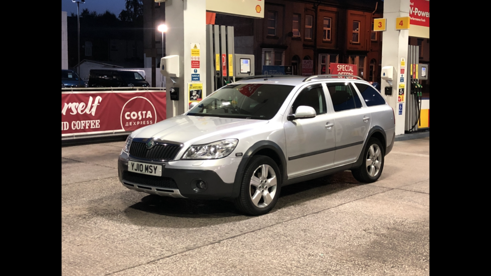

 While at work I leave the keys to my car IN THE CAR, drive to work, park up, switch engine off then either throw keys on the drivers floor or leave in ignition as I’m in and out of it all day... so last week it randomly locked itself. I thought nothing of it and got my spare to open it again.
 Camping last week as I was stood at the side of it the alarm chirped then flashed its hazards and locked itself with keys inside. This only happens (or I think it does) when I’m in and out of the boot and possibly once when using rear doors. I can’t find any problems, the alarm battery is fine and was replaced a few months ago. It does this with both keys so it’s not a fob problem. Is there a setting on diagnostics that I could of upset? I use my snap on solus pro to change settings so as ‘cornering lights’ (fog lights) work etc etc. Also if I hit over 80 something mph the headlights used to auto come on but that’s stopped as well (not a problem as such I’m just curious)
 I have also checked for water in the loom but not sure where else to check. Fault codes indicated a problem with LED in door card BUT I have replaced door card months ago so this could be a fault code from then.
 Many thanks people... I will scan again for fault codes but I’m sure nothing will show.
