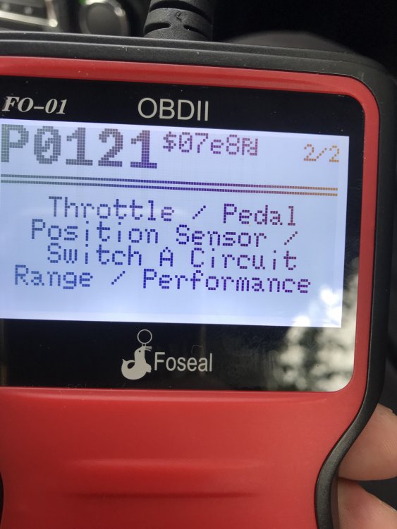

P0121

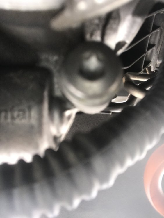

Good morning, thought i would share my findings.
I got the p0121 and these are the pictures to show mu findings

The item circled in red is the throttle body and i used  brake and clutch cleaner to clean it out.
Where the light after clearing the code would come on after restarting the car normally so far it hasn’t come back on
