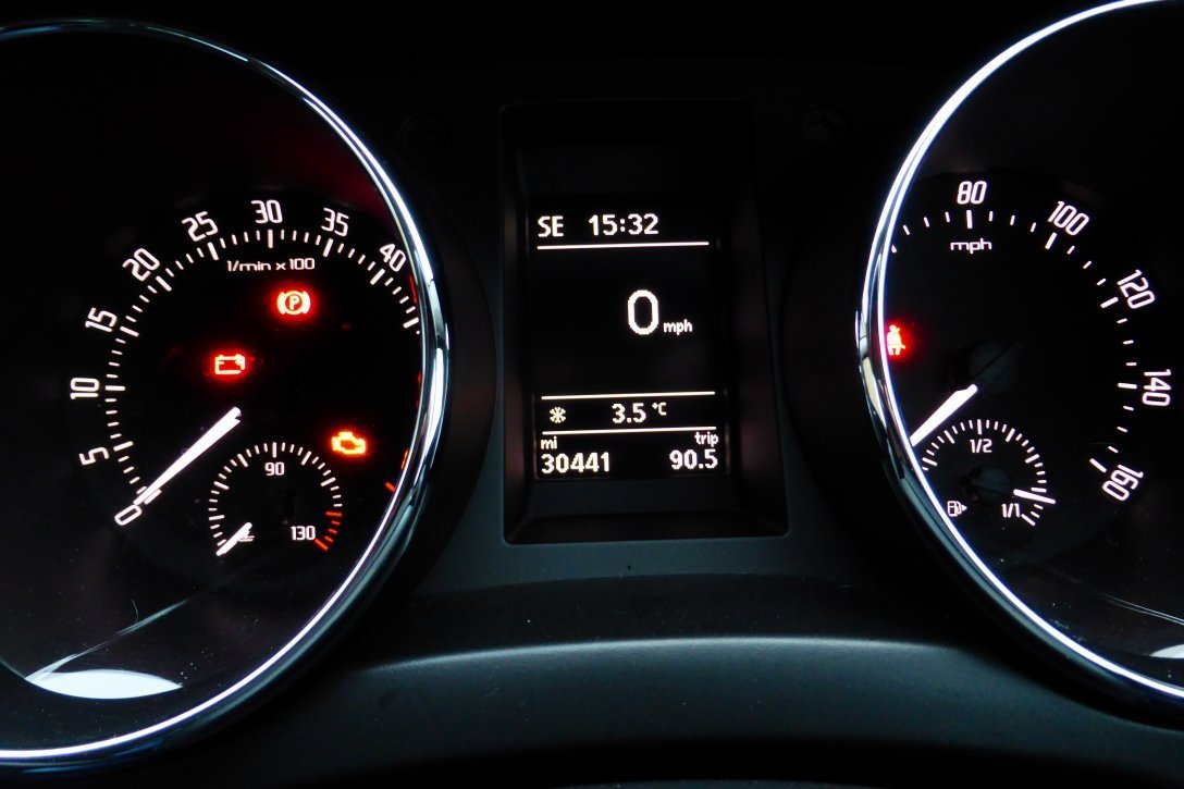

I added MPH to the Maxidot display on my Yeti and changed a few other features too.

And adding the MPH option also puts a tick box in the Maxidot menus to give the option of displaying either KPH or MPH in seconds.
