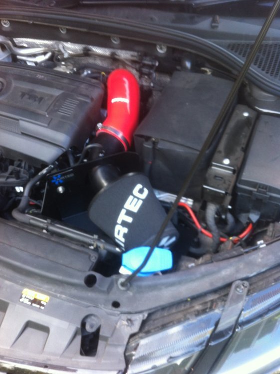

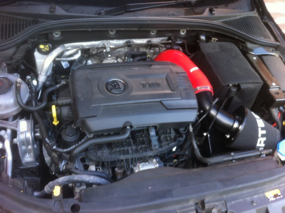

Airtec's induction kit £300 fitted by AMD.
