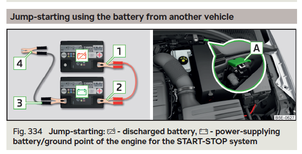

My question is related to this point in the manual regarding jump-starting the Octavia equipped with start-stop system.
Any special consideration where that same Octavia is the battery "donor"? What connection point should be used on the Octavia?
2019-09-10 15_41_14-A7_Octavia_OwnersManual.pdf - Adobe Acrobat Reader DC.png
I think it should be the same. I was jumpstarting a Clio with a Superb and hooked it up as the manual says and didn't have any problems (Superb was the donor car).
So, on the Škoda, was the negative on the battery or on the ground point?
Ground point.
