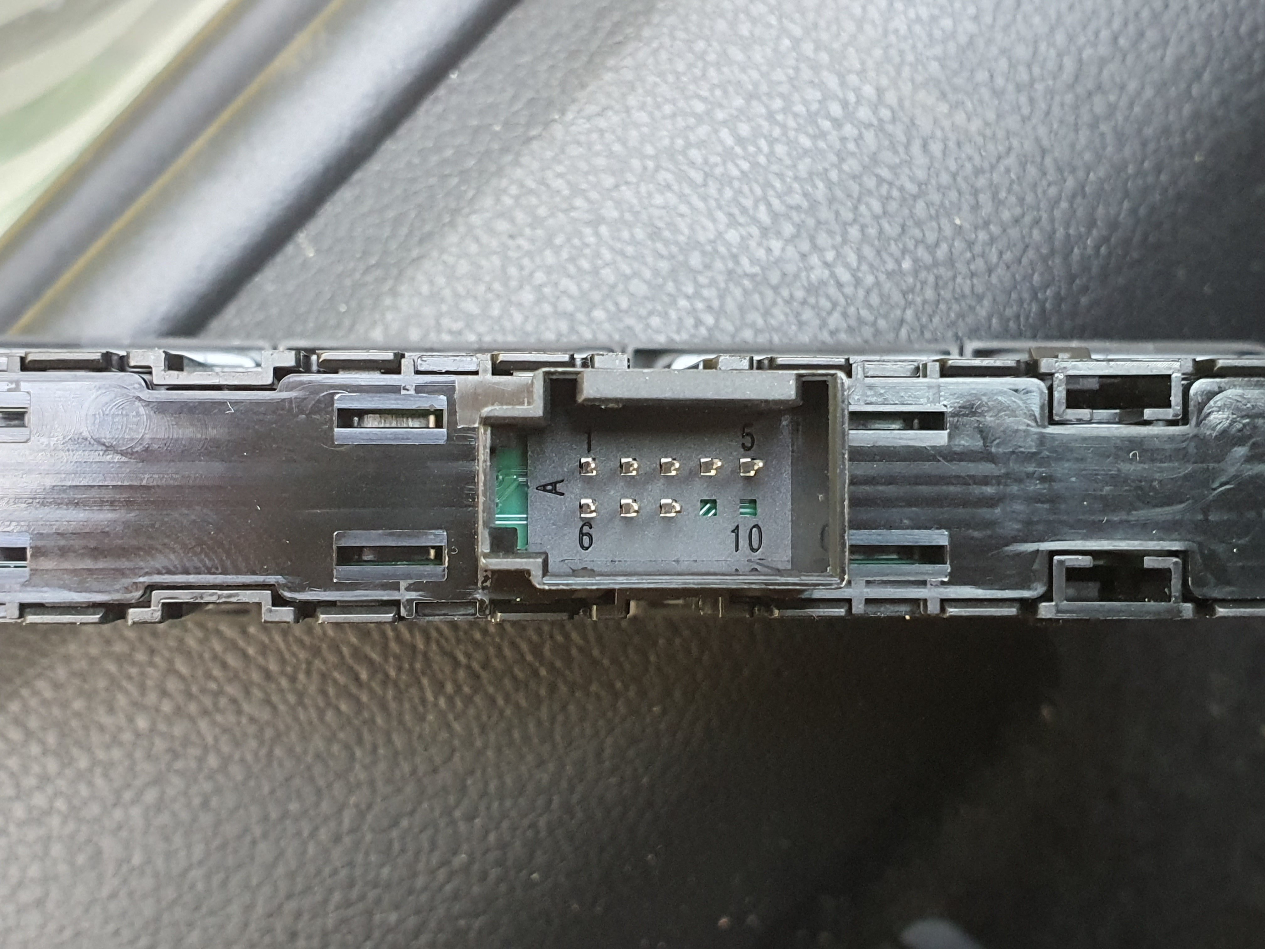

had to make research what pins are in use, on Russian forum found that are:
1 - +12v
3 - mass
6 - SSA
measured voltage on first pin, all ok

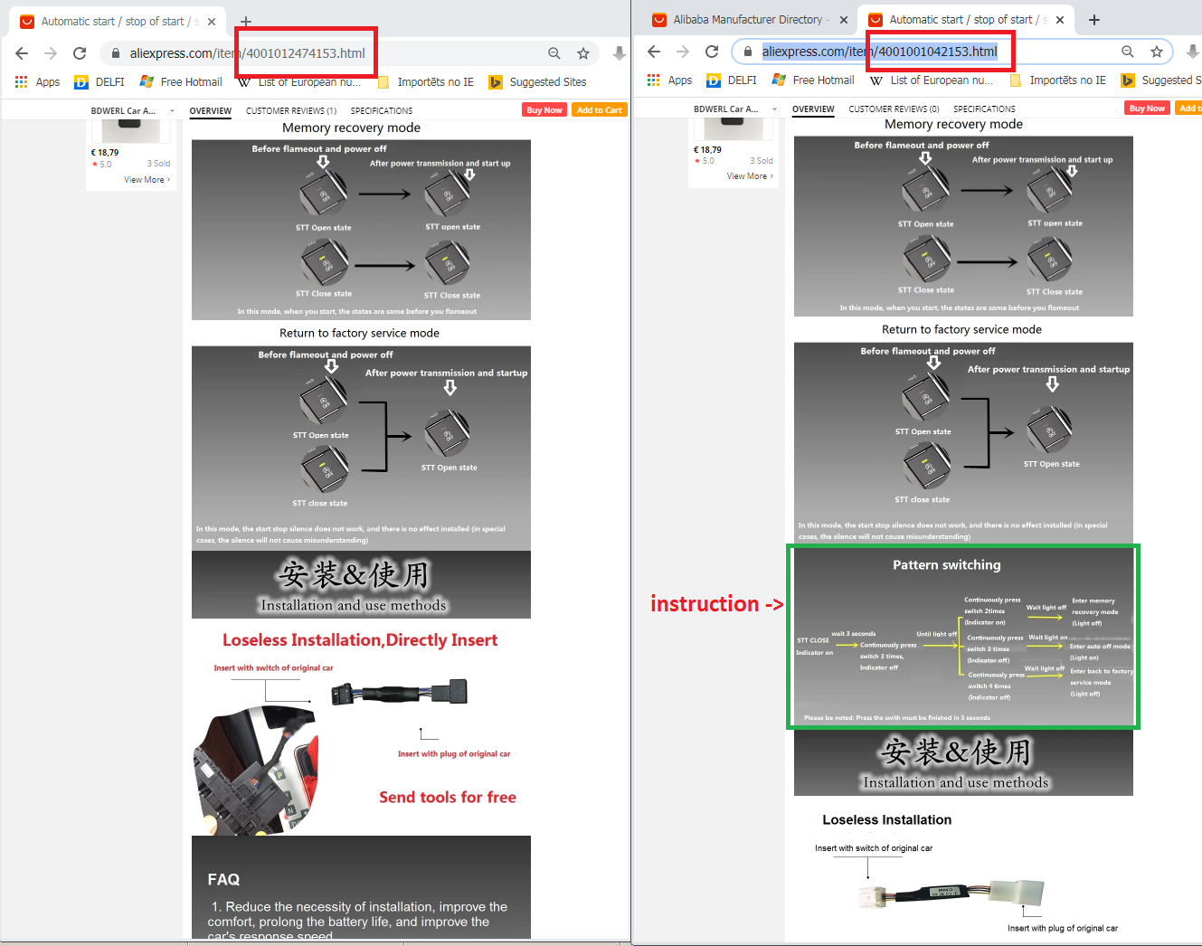

what interesting, there were blinking response on attempts change Memory Module working modes,
which are three (other candidates don't have that):
funny, but how to change working modes
can be read only in description of identical item just for Toyota (same seller)

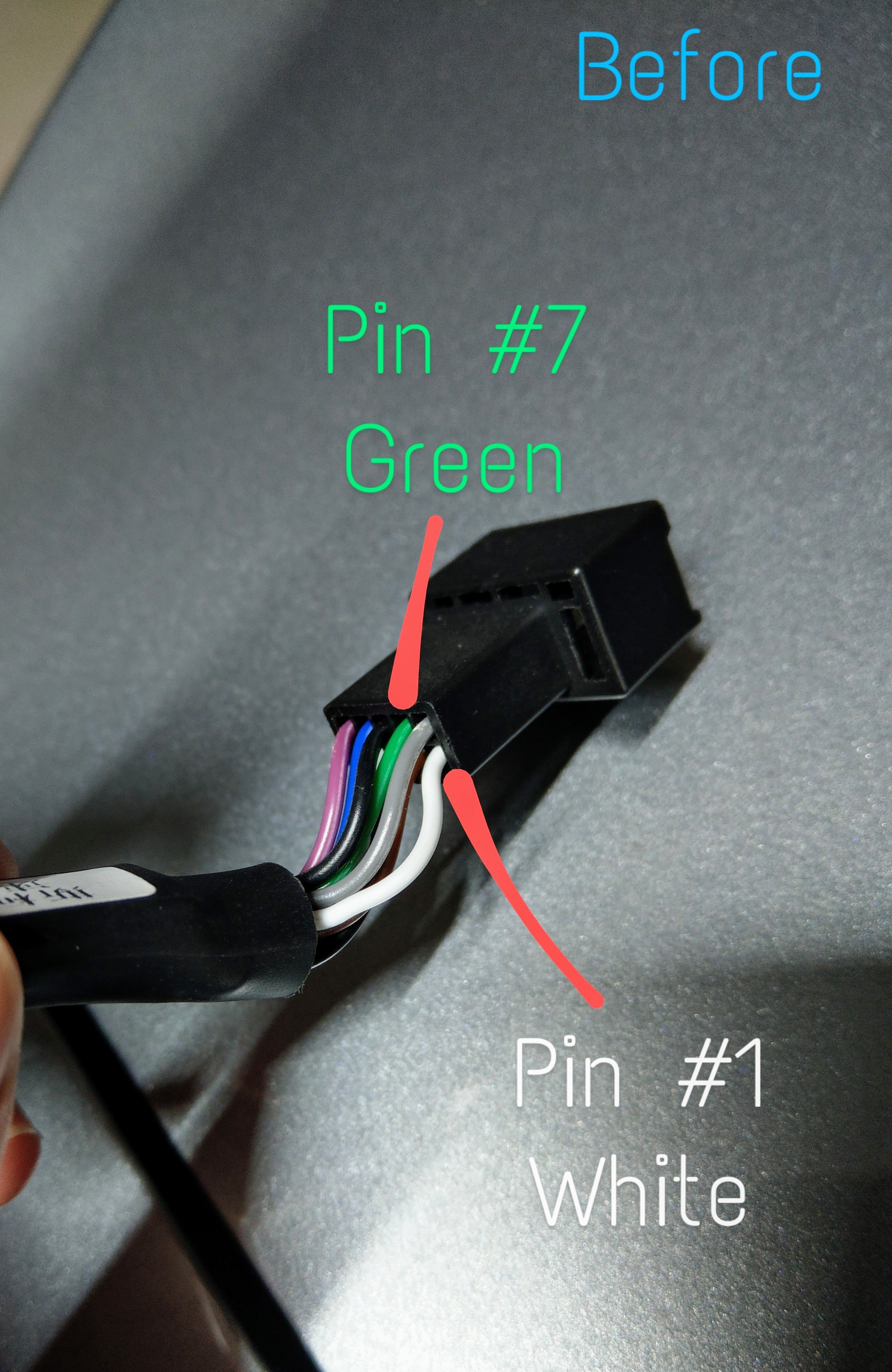

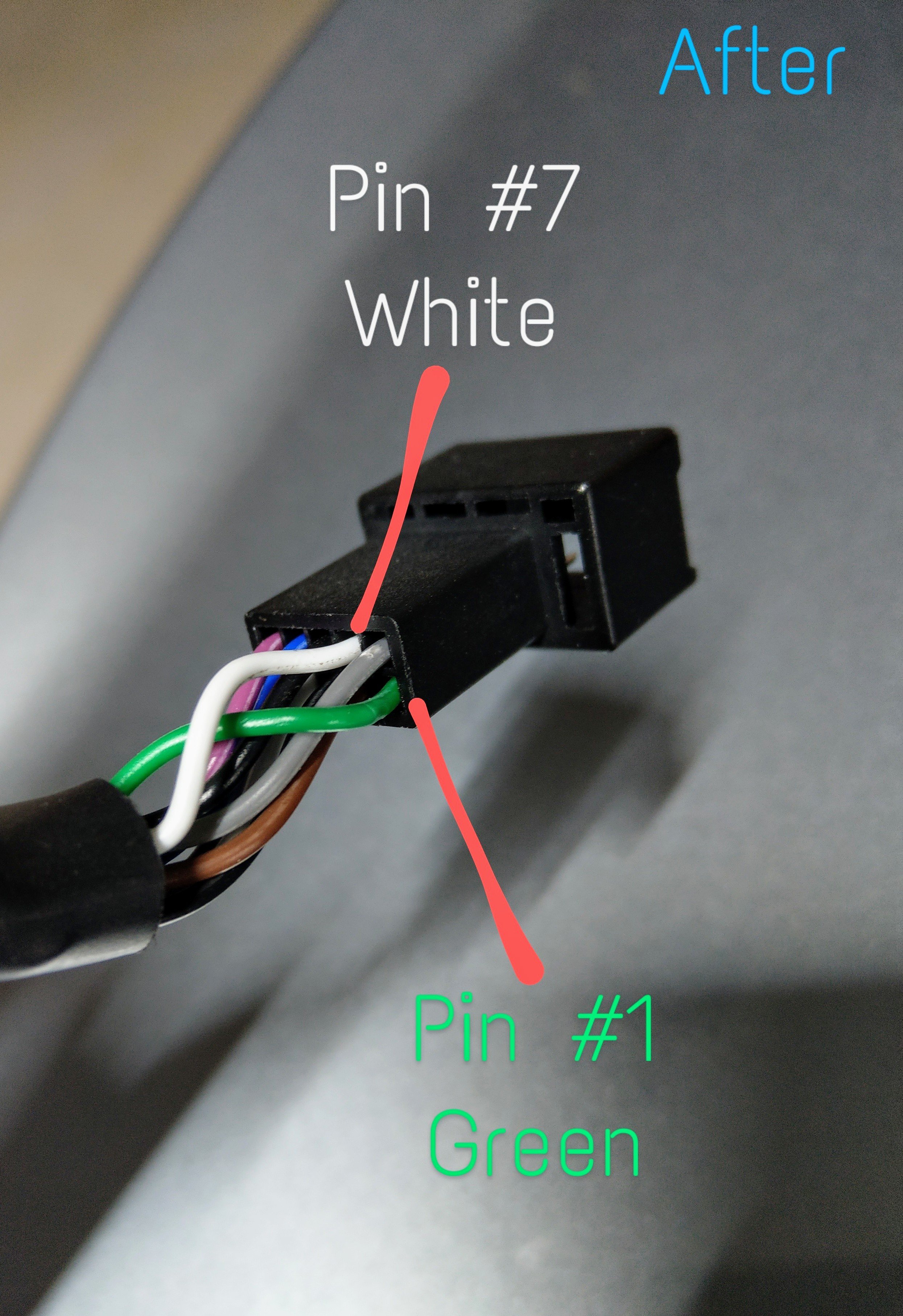

after another 30 days got instruction from seller to swap pins 1. and 7. on both ends:
(have no idea what lives on 7th pin)
HURRAH, that works!
first, memory mode, for 100%
but second, default OFF, just for ~70%.

Spoke to the seller, n they suggested I swap pins 1 & 7 on their device.
Did that, made it worse as start-stop button and Traction Control button stopped working.
Removed the device. Seller asked me to now swap pins 1 & 6.

can't see huge risk on pins swapping, in case all wires goes transit and three have parallel connection to memory module,
just swap must be made on both ends and right pins,
on first attempt i, IDENTICAL AS YOU, wrongly swapped 2<->6, because Ali connector doesn't contain numeration
3V1 927 238 N
note, mine is European, steering wheel on the left side
Ali seller sent me version "Superb taiwan"
wires colors after 1<->7 PINs swap:
1 - Brown
2 - Green
3 - Gray    *
4 - Red 1
5 - Orange 1
6 - White    *
7 - Purple    *
8 - Red 2
9 - Orange 2
10- Yellow
Edited by MartiniB

didn't had errors even with two wrong setups order of wires -
received (SSM not working, but change memory nodule mode were accepted):
1 - Purple    *
2 - Green
3 - Gray    *
4 - Red 1
5 - Orange 1
6 - White    *
7 - Brown
8 - Red 2
9 - Orange 2
10- Yellow
by mistake swapped pins 2<>6 (not working at all):
1 - Purple    *
2 - White    *
3 - Gray    *
4 - Red 1
5 - Orange 1
6 - Green
7 - Brown
8 - Red 2
9 - Orange 2
10- Yellow
swapped pins 1<>7 (working):
1 - Brown
2 - Green
3 - Gray    *
4 - Red 1
5 - Orange 1
6 - White    *
7 - Purple    *
8 - Red 2
9 - Orange 2
10- Yellow

I changed pin 1 and 7. Those mistakes are driving me crazy.
@Jesus98
Sorry, but symptoms sounded so similar.
And that less kms nowadays doesn't mean car without problems,
during first three years i had 34 service visits,
just last two more or less without problems
I didn't get any errors either even when I correctly swapped pins 1 & 7.  Instead certain buttons stopped working.
Will try swapping the correct pins today n see how it goes.
Swapped the pins, as @MartinB explained, n its looking good now!!
woOot.
Haven't gone for an actual drive, but it seems to b remembering the start-stop state.
been 2 days now with the start-stop memory module in place and its been great so far! no errors.
it remembers the last state of the start-stop each time i start up.
i can use start-stop when i'm in heavy traffic.
win-win.....perfect!!

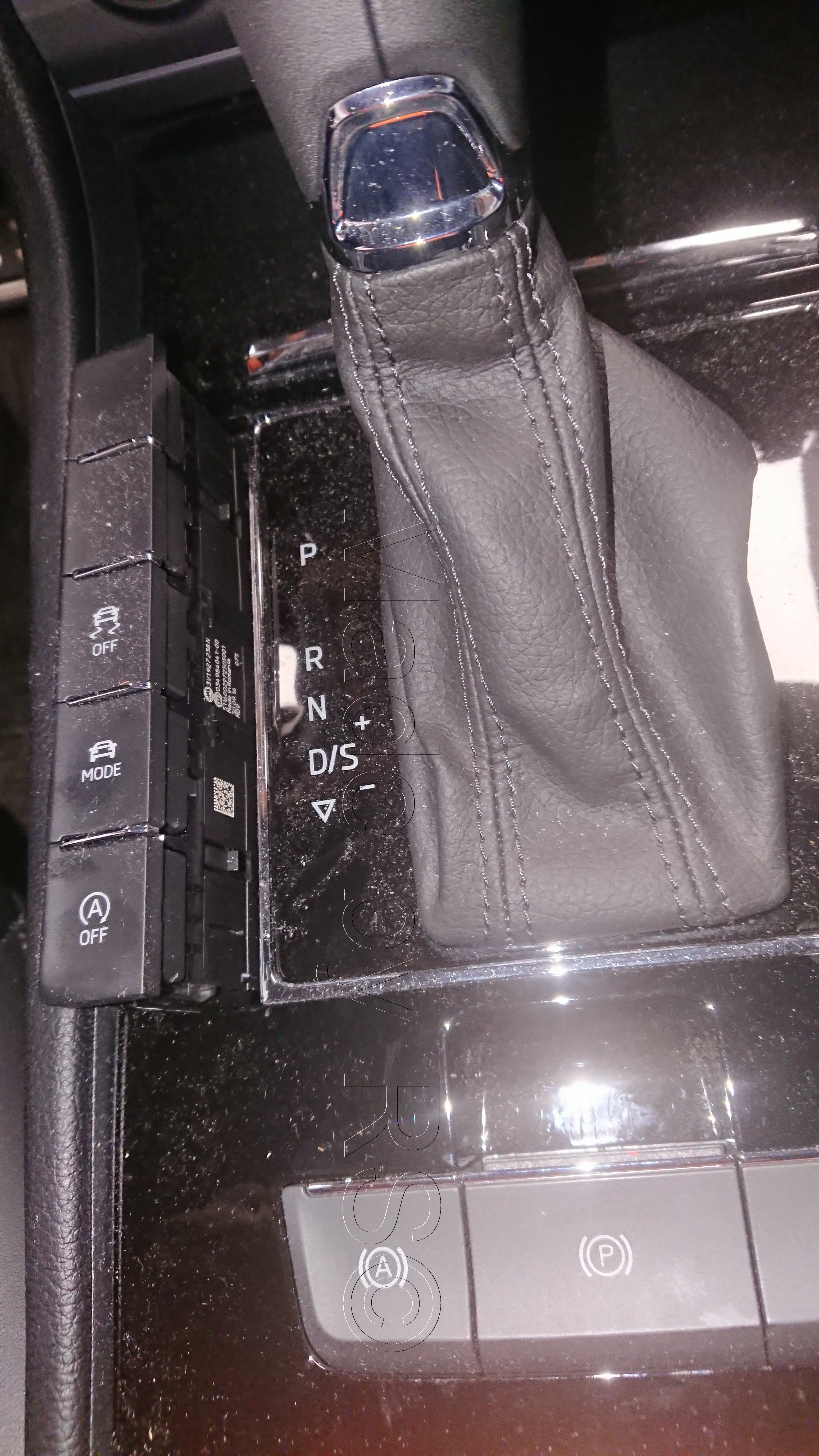

I've got one of these for my new Superb Sportline.
I would like to install it but can't seem to figure out how to get the buttons out to install this.
Use a plastic wedge to carefully pry out the key unit.
Pull out carefully upwards. The cable is relatively short and everything is a bit fiddly.
For my start-stop module, I cut a plastic bar inside so that there is more space under the switch unit.
