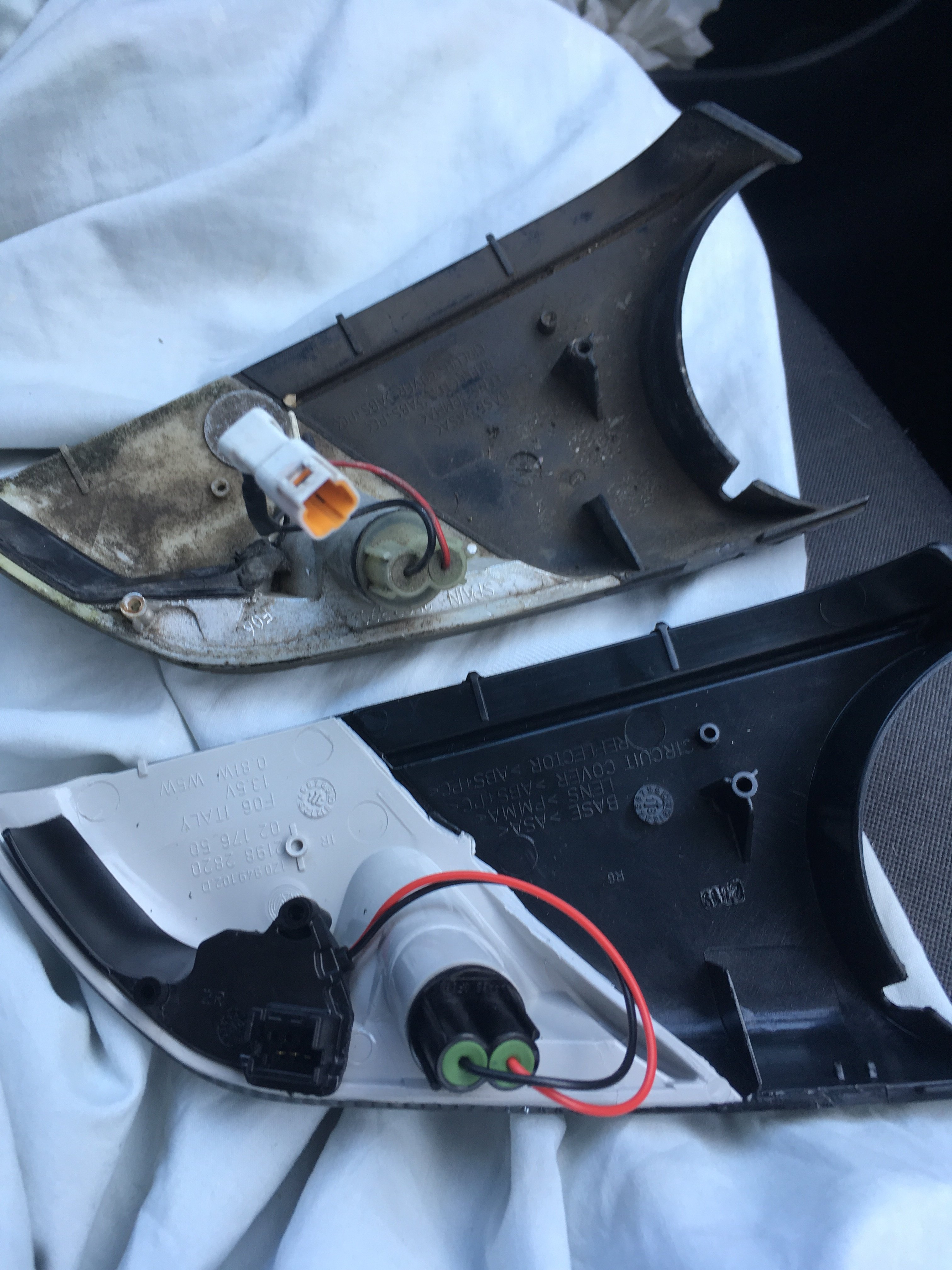

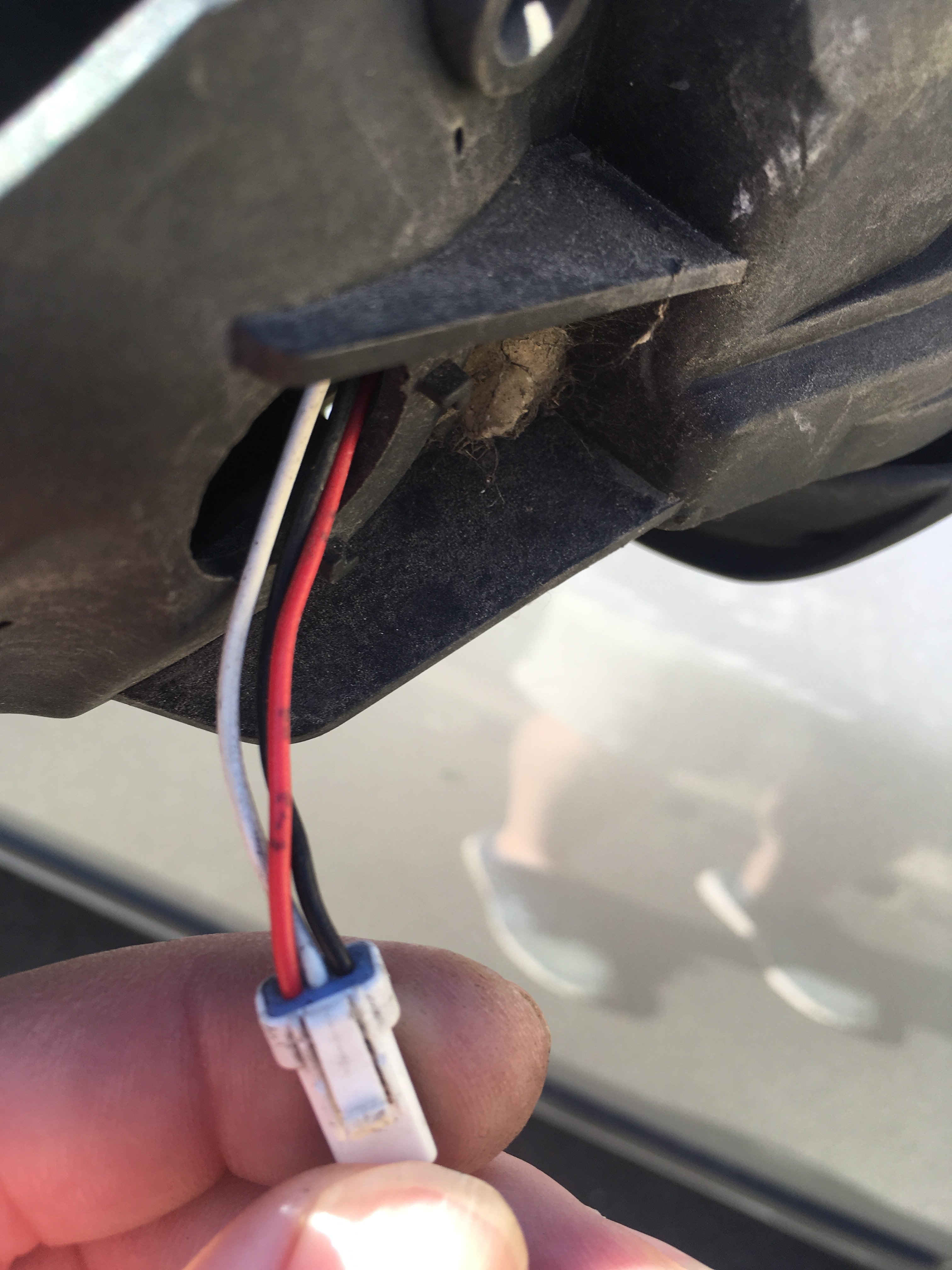

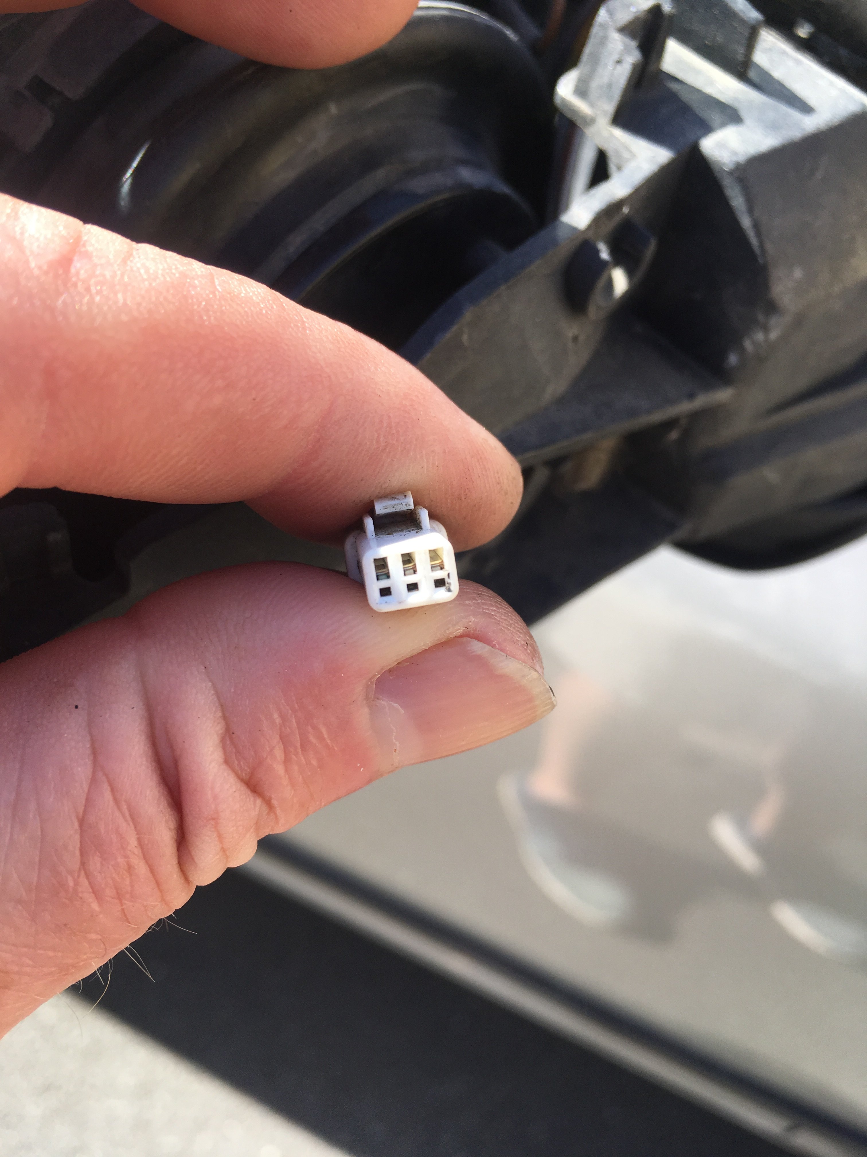

Hi all... having a mare!! The mirror led went on my skoda a while ago with puddle light.... I have since bought two!! Both I thought correct both with the wrong connectors as you will see from the pictures ... my local apd have searched and it appears skoda made a new wire for the more updated mirror led they made ....but nobody knows how to get said connector wire??? Anyone shed any light??
 I had the same problem, You gonna have to buy the new wire extension, About £12 from ebay..
What would I search for on eBay please? Wire extension for skoda led indicator? Thx
Found and ordered one £15 plus 85p postage on e bay....only two others there and in Poland, a lot more expensive .....skoda should provide the part for free if they upgraded the part design or the thousands out there selling the led units should do so with the wire adaptor or atleast warn customers they need the wire to make it work ...cost me a fortune as I ordered a non puddle light one first that came with the wrong connection so assumed I had to have puddle version which was £30 but came with same bloody connector so now another £15 on a bloody wire .... £60 in total spent just for a bloody led indicator to work!!!!! Grrrrr .....now the issue of an airbag light and a sensor apparently buried in the door!!!!! Arrrrrggggghhhh

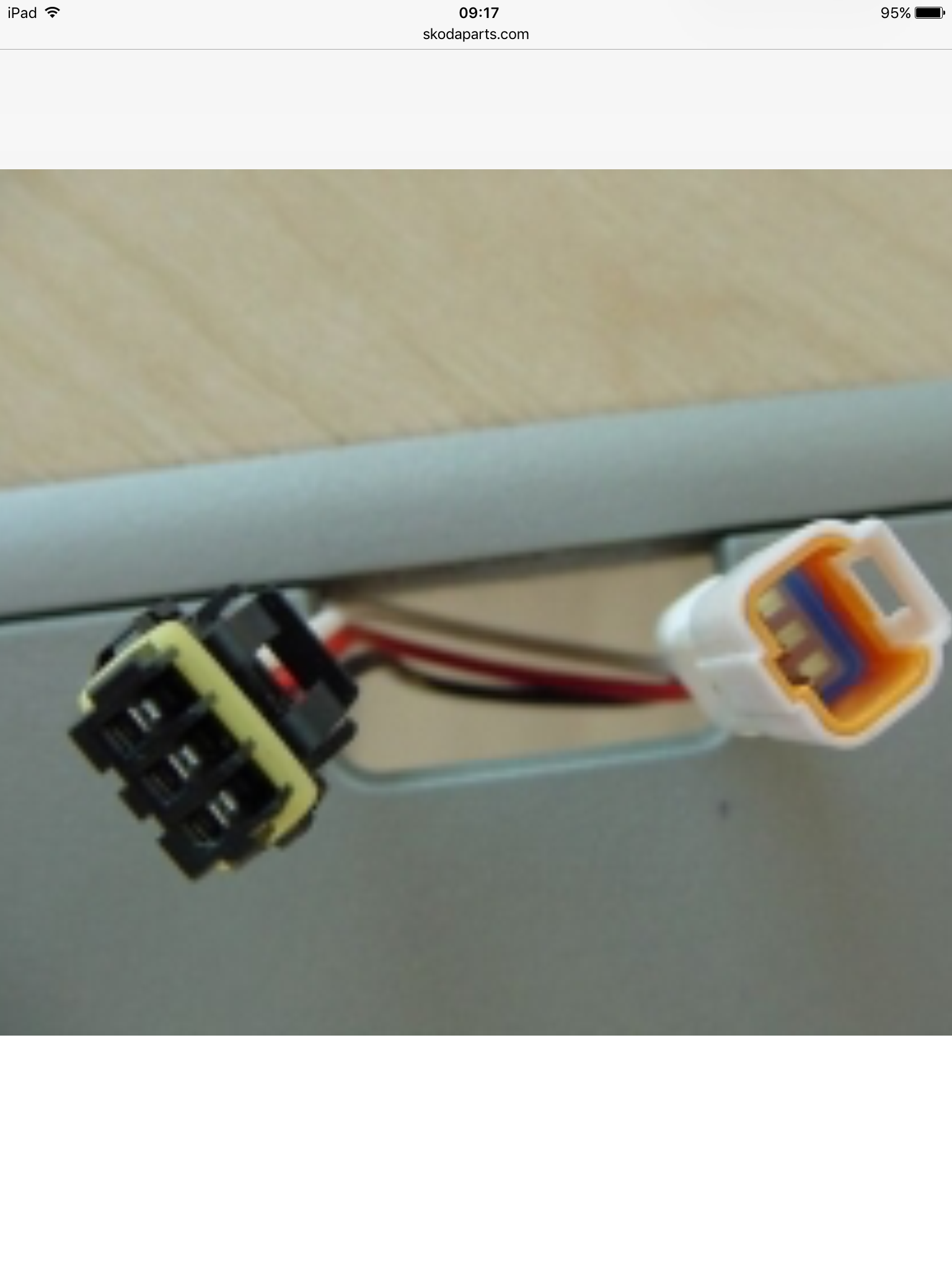

If you get a chance, could you let us know the wiring connections for the patch wire you're buying, please?
Ta.
It's basically this
Cable came, fitted and all works fine ,an expensive replacement in the end and dissapointed with skoda who I contacted directly to ask advice about the old led unit and cable needed to make the newer led's work .......they would not give me any information and would only recommend I take my car to an official dealer for repair ......which no doubt would have cost £100+
