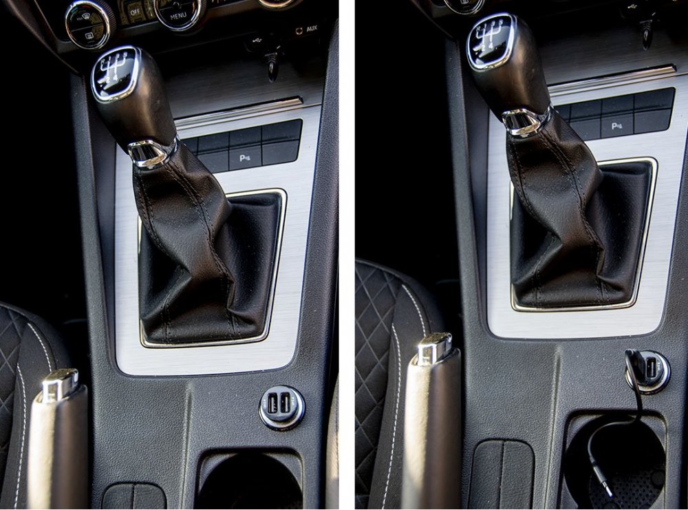

On 16/09/2019 at 16:28, Gasconman said:
Don't suppose you could share a photo of it fitted please?
Cracking thanks, looks decent indeed
