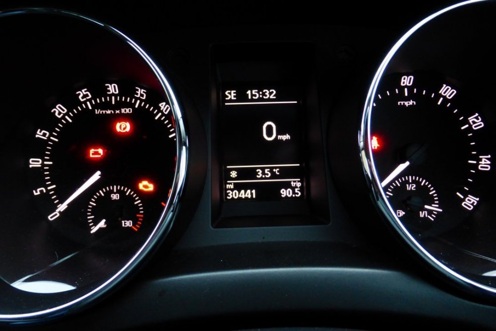

I added it to mine with a Carista OBD2 Bluetooth Adapter.
£15:99 from Amazon with full functionality for a month included.
Also did a few other things like needle sweep etc.
https://caristaapp.com/vehicles
Edited by Urrell

Well, I got the ECU remapped yesterday and the improvement in performance is impressive. The guy who did the remap also put the mph digital display on so I'm really happy. The stop / start has never worked since I got the car which is OK by me because I wanted it disabled. The engineer said best to make sure it's disabled in the ECU & said he'd done it. Driving away from the garage the stop / start worked for the first time! Small hiccup, back to the garage today. Good job it's just around the corner.
The option to show the cruise control setting in numbers (à la Golf, Seat etc) is also available with Carista/OBDeleven.

Not with Carista on my 2015 Greenline Elegance it isn't.
Control unit number 17, adaptations, "GRA High in display"
I'm using OBDeleven, but as I understand it the same long coding and adaptation options should be available regardless of Carista, OBDeleven or VCDS.
Not all engine ECUs support cruise control display so coding the cluster won't help ;)
I'm led to believe that a decent tuner can probably fix it and there are also modified software files for some petrol engines to add support.
AFAIK, only the 1.2 TSI lacks this ability - but of course I could be wrong.
