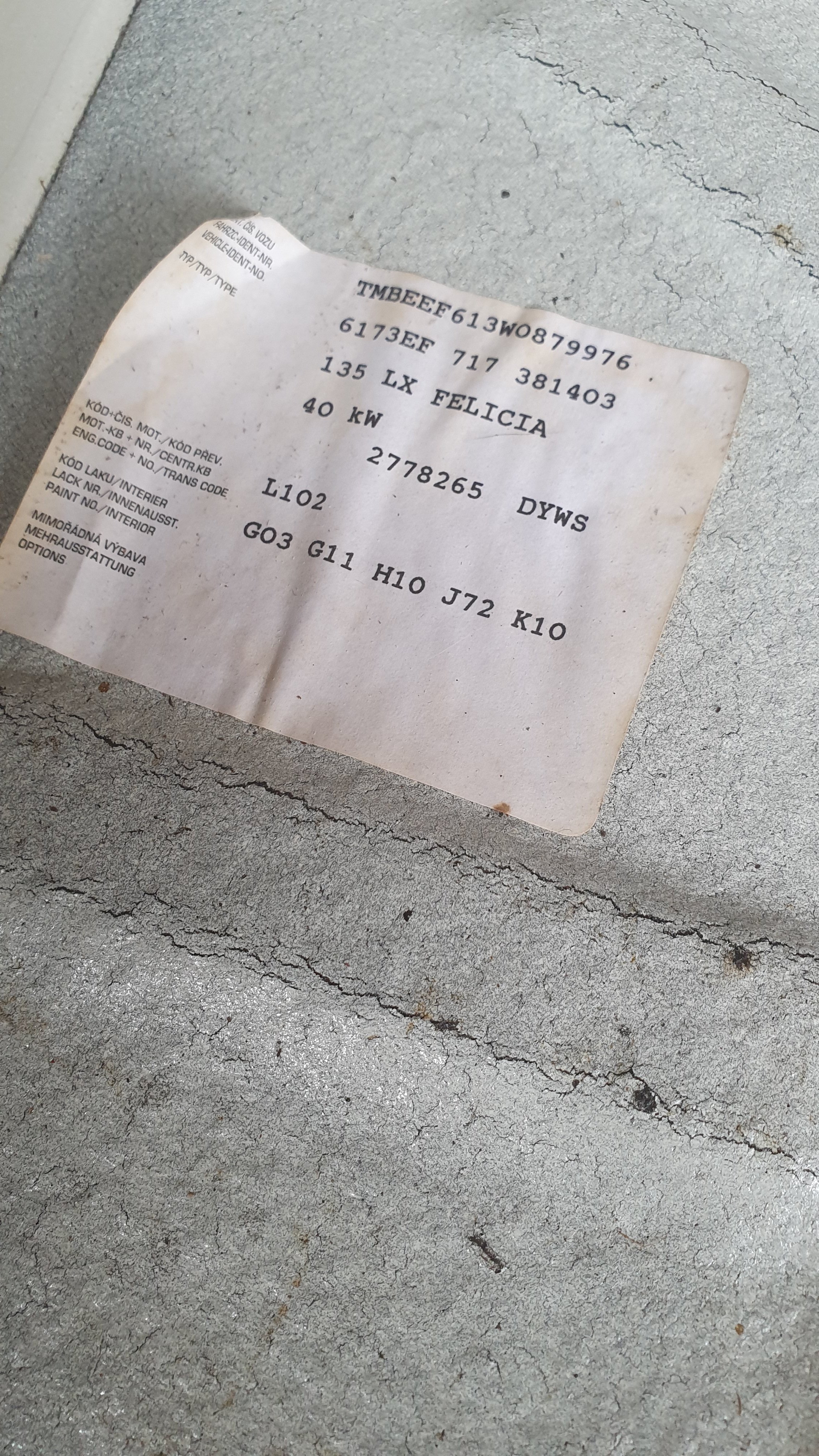

If it helps, I've included the boot sticker to hopefully be able to identify the year of manufacture. I've had so many problems with parts for this car due to it being on the changeover year...

One more thing, your car is nowhere near any confusion for being manufactured in the "changeover year". The facelift started precisely on January 1st 1998 and it wasn't a gradual process.

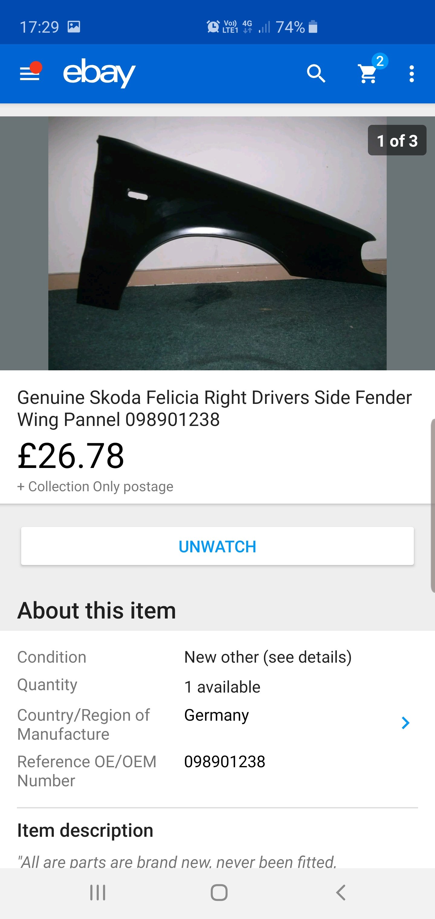

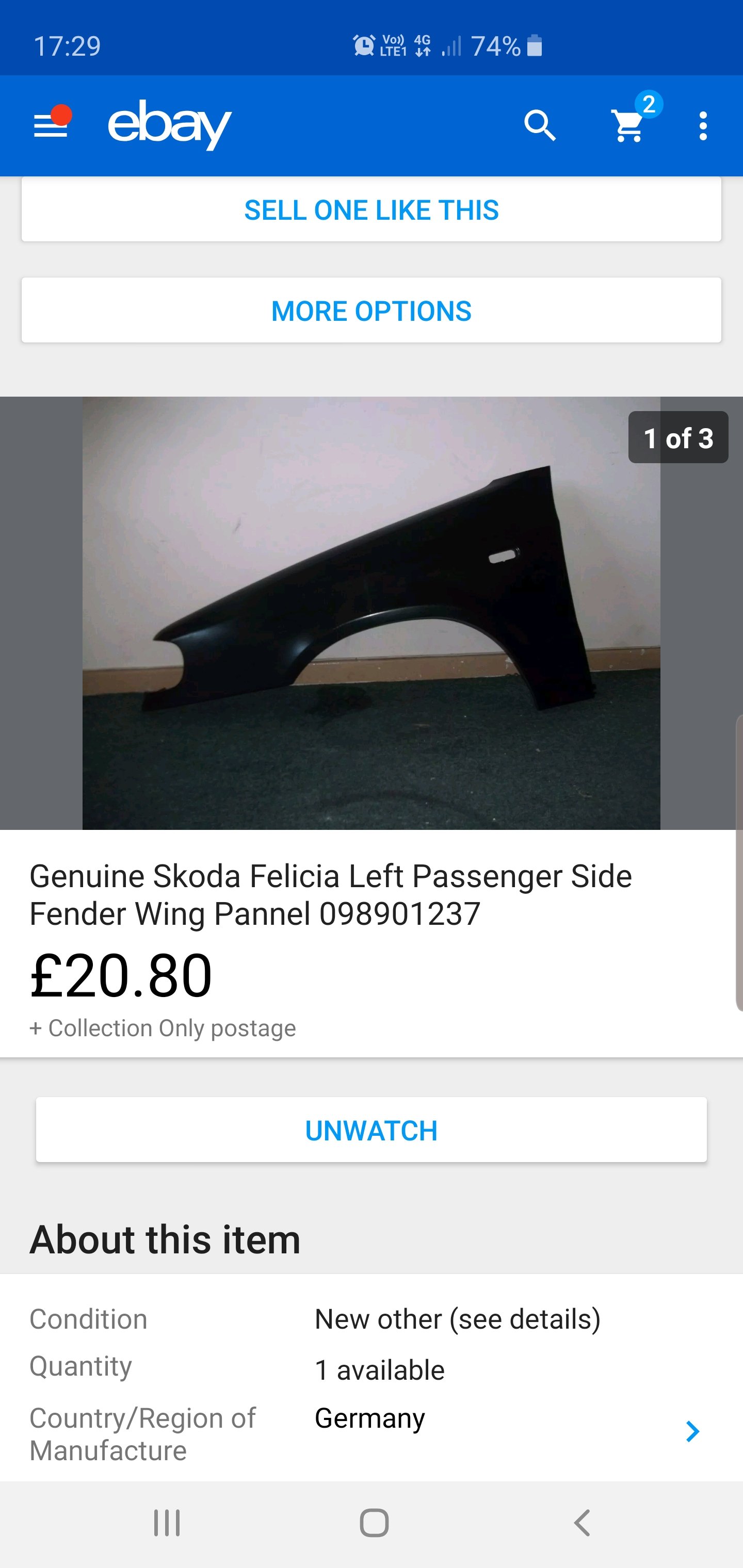

Thanks for that... These are genuine skoda I have committed to which are as images...
Mine is a face-lift... Will these fit?
Minor modifications is fine, I just don't want them no where near.
Nobody can tell you for sure if the wings are OK just looking at those photos. Yeah, part numbers are OK but ultimately it is YOUR call. I hope you understand it is only your responsibility to decide.

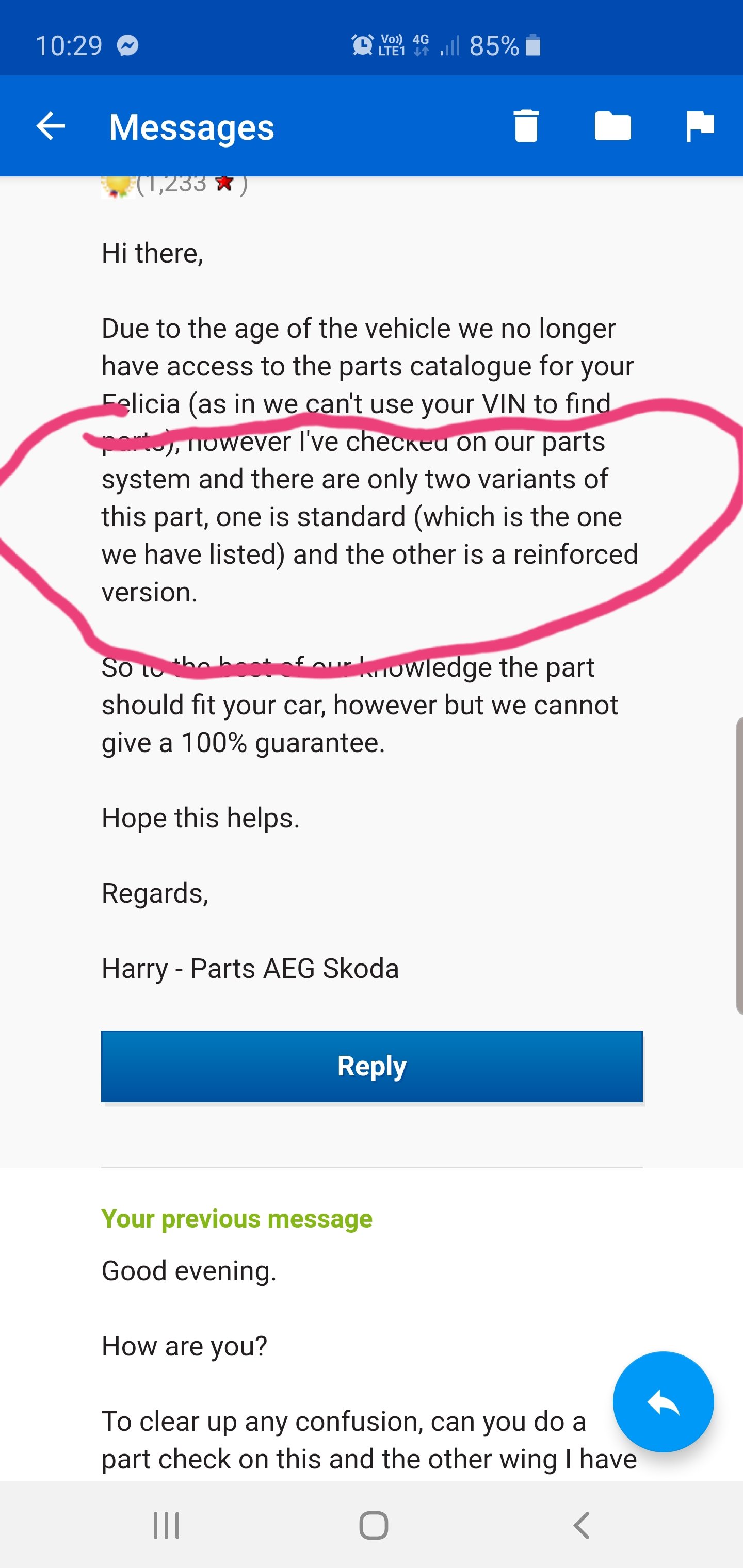

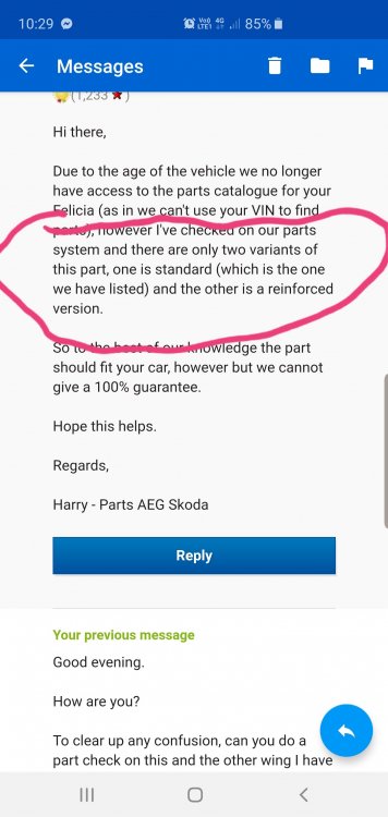

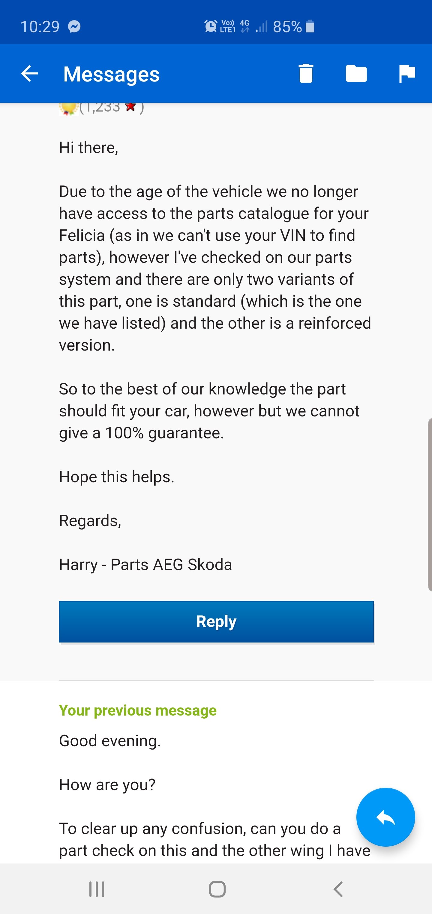

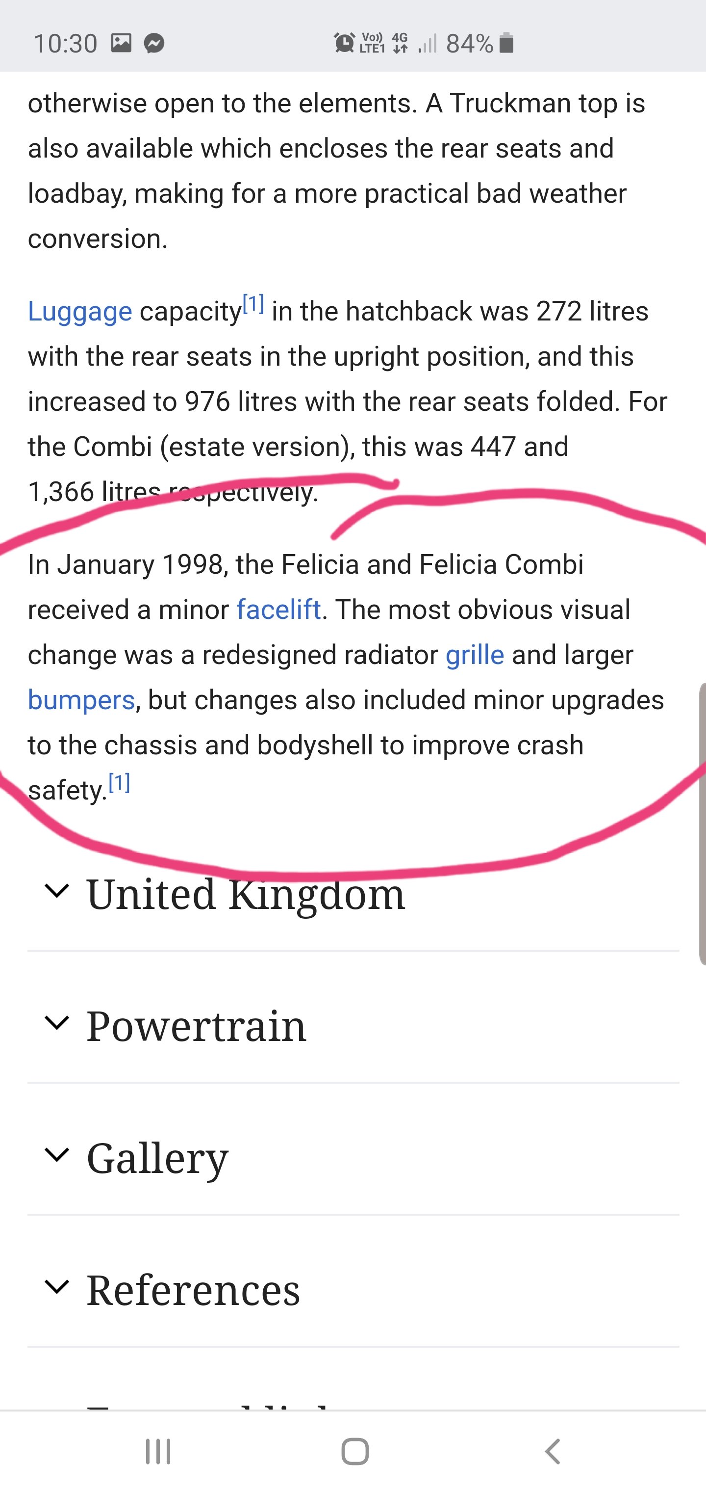

You've already seen this but it contradicts what you are saying.. This is a man from skoda but that doesn't count from hands on experience.
You seem very knowledgeable.
I think I will wait till the winter is over and chuck it in the bodyshop and let them figure it out.  I know the ebay part finder isn't always accurate but hey ho.
Thanks for your help.
Benjamin

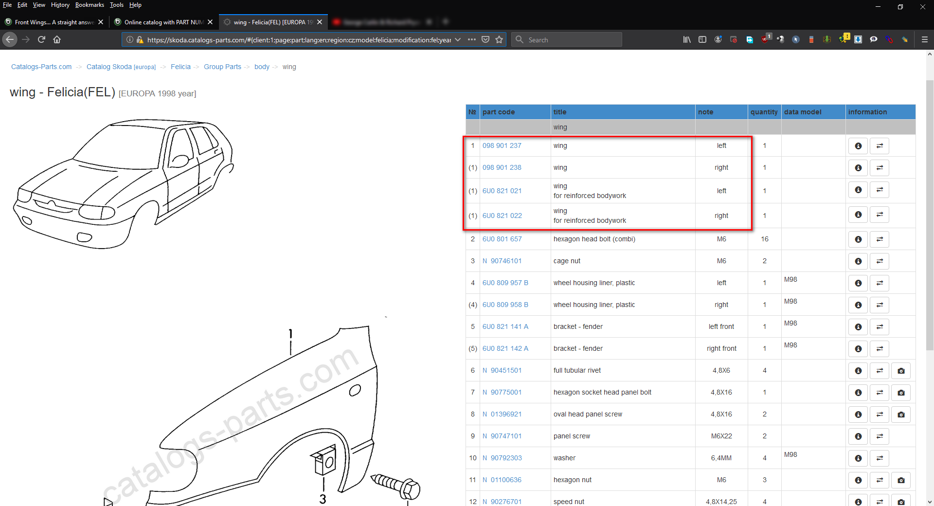

I've read what that ''knowledgeable" man from Skoda had to say. But when he mentioned he has no longer access to Felicia parts catalogue, his knowledge/will to help dropped to zero. Why? Because there are dozens of websites that have all the information readily available for any Felicia. In fact we have a pinned topic Online catalog with PART NUMBERS and ILLUSTRATIONS right in this section of the forum. I created that topic more than 4 years ago to help other fellow members. Many other members helped with updated links.
Here is the proof.

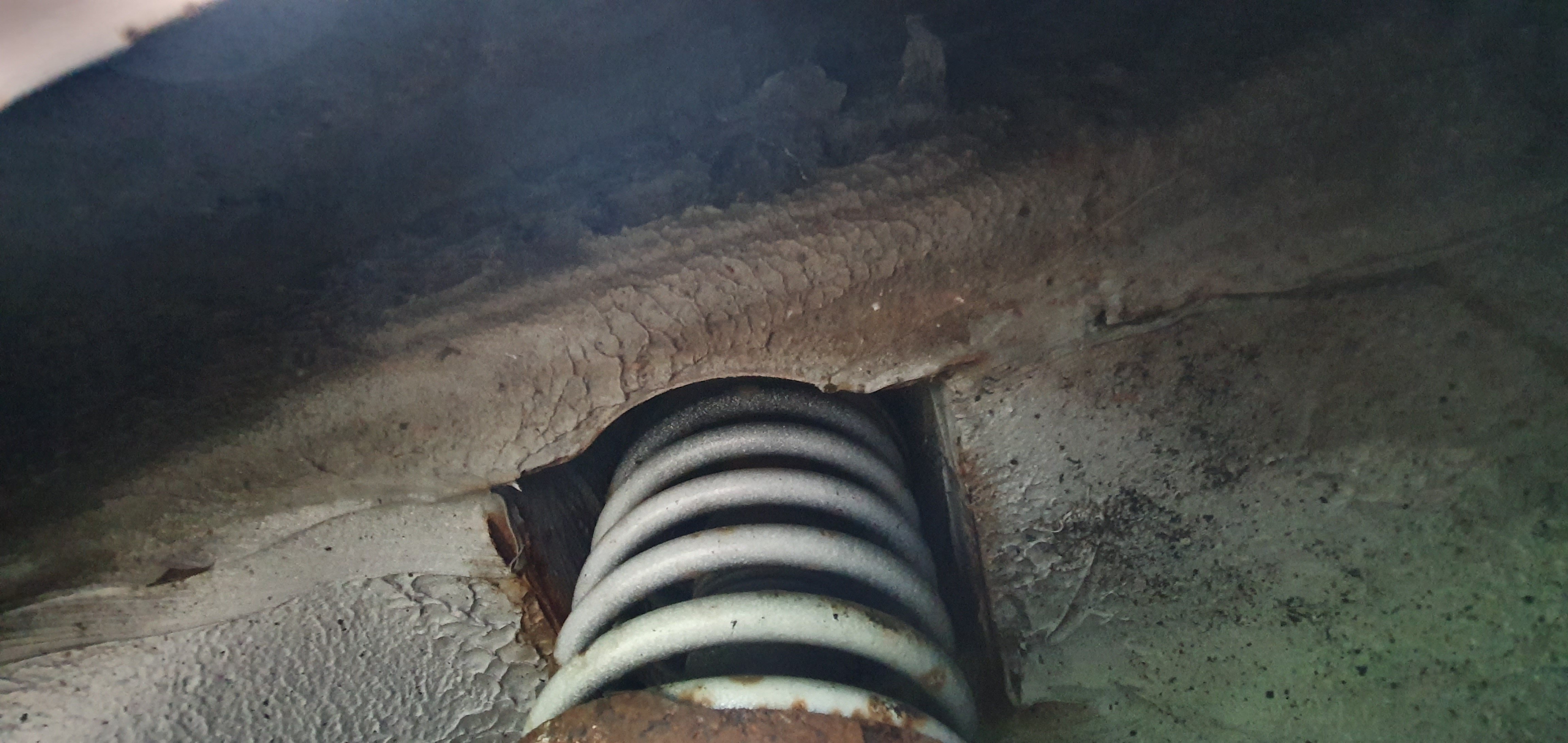

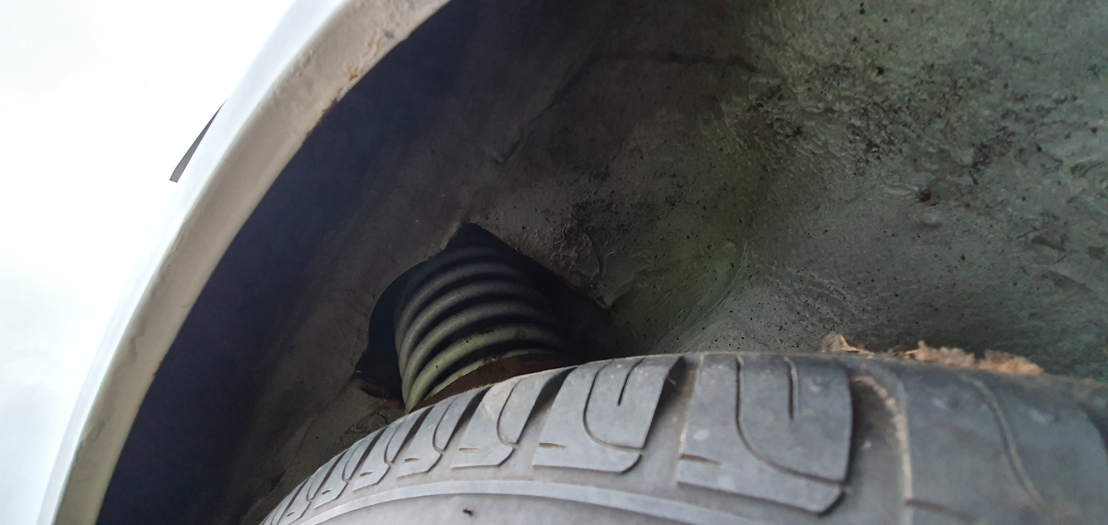

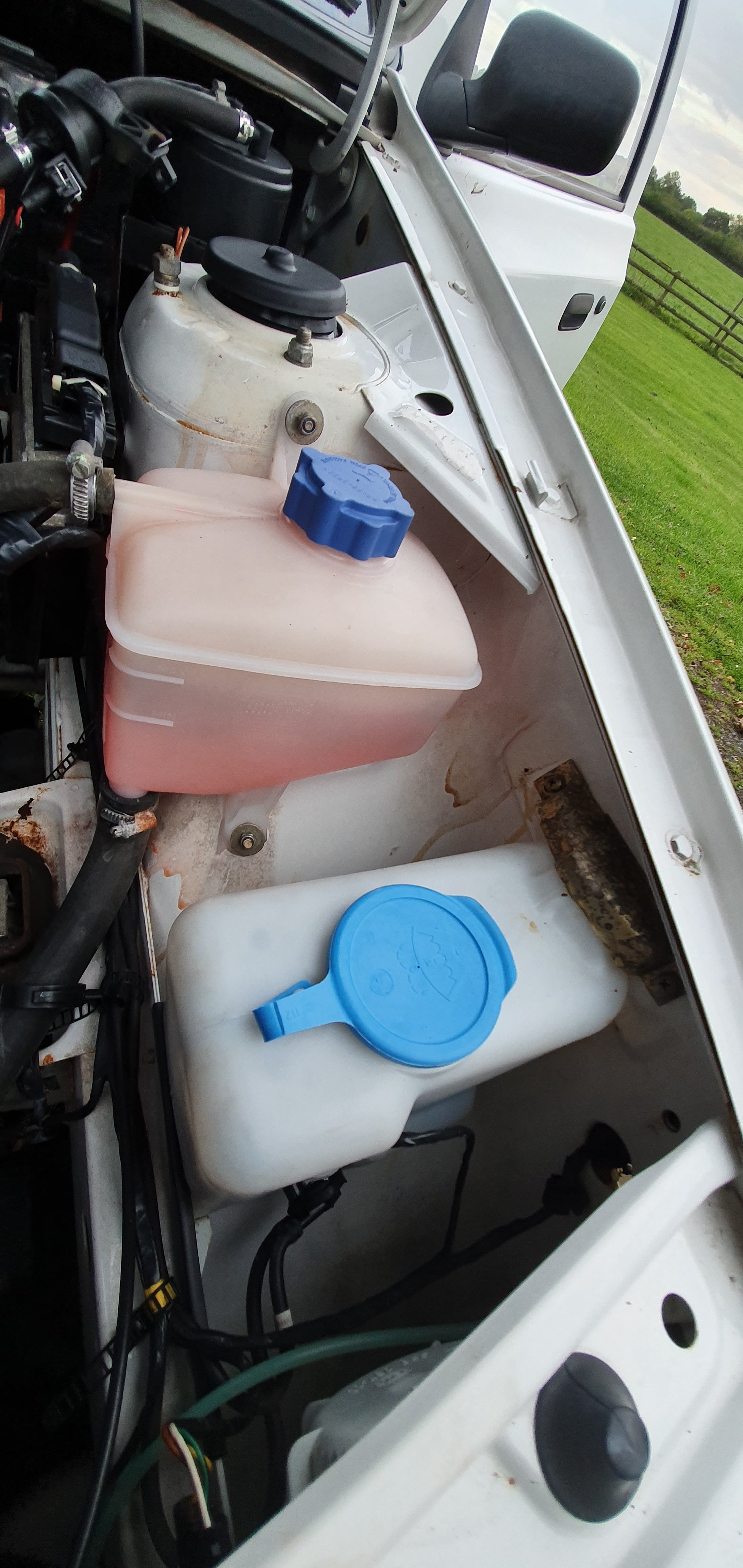

Seeing as you know your stuff, can you identify if this is reinforced from these images.. Best I can get.
If I put my hand up under wing there are 3 grommets corresponding to the holes on the shell image you posted. If I pull a grommet out and poke inside, there is a fresh metal skin. Am I right in thinking that if this wasn't a reinforced chassis, without these grommets I'd be directly under the hood somewhere around the top of the strut?
See what you think..
Your car has reinforced chassis 1,000 %.
