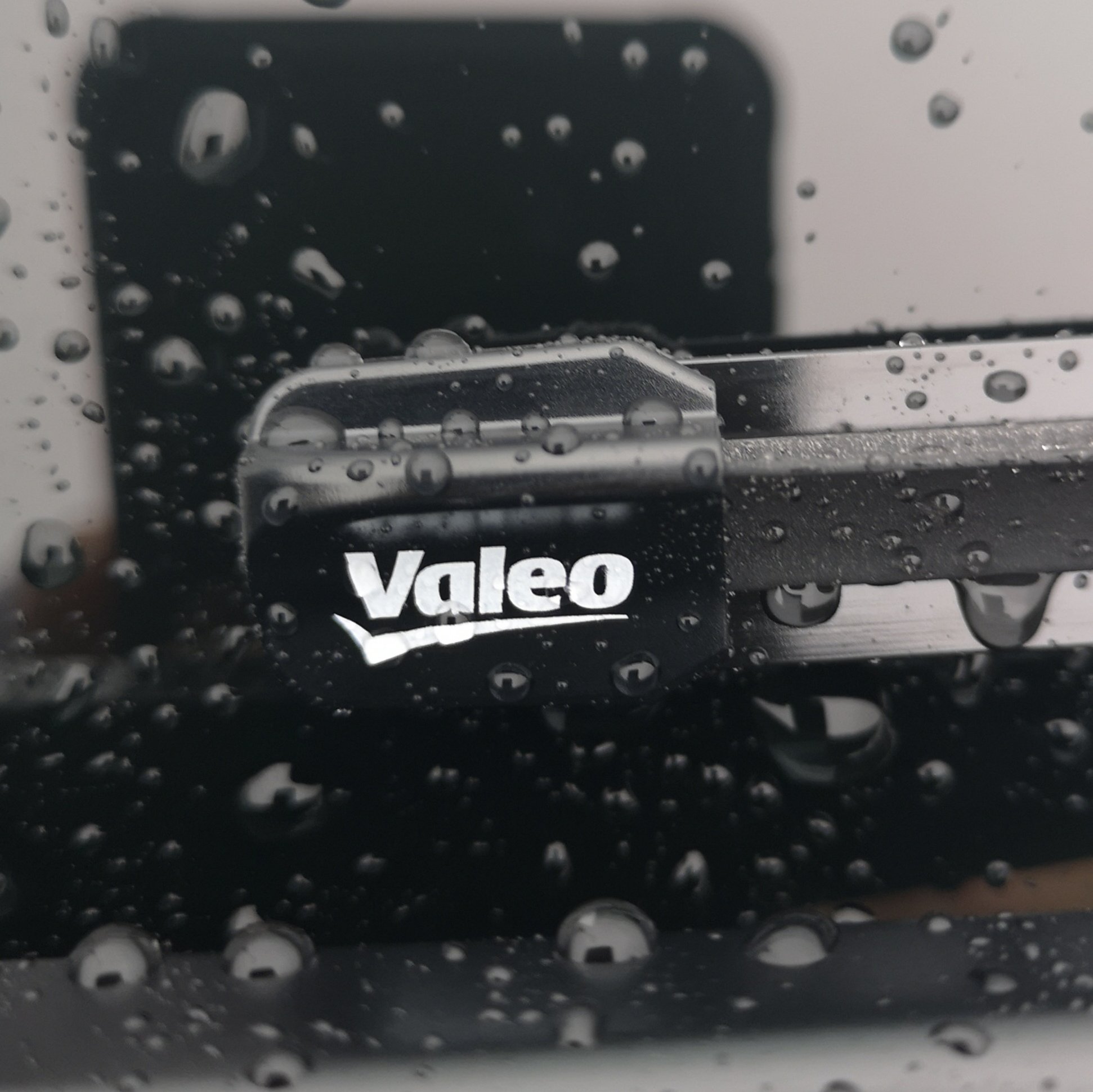

Given all the recent rain this has become a major irritation, so I now plan on swapping to Valeo Silencio blades, despite the car only being 6 months old🤞

After trying many options for cleaning both the wipers and the screen - new (Valeo Silencio) blades are now fitted and are working well. Hoping they stay quiet🤞
