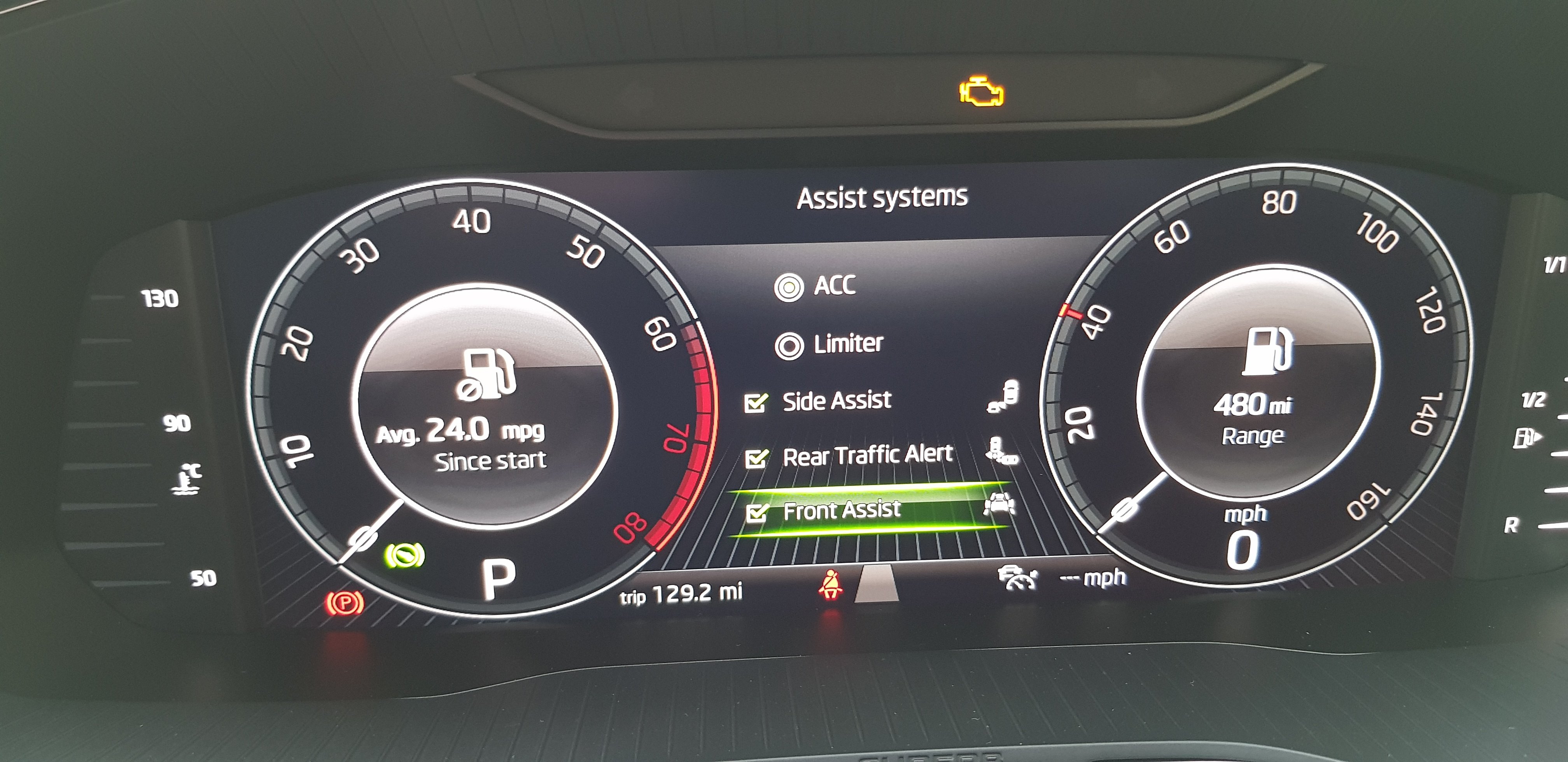

Out of curiosity I can't remember seeing this setting on MY17 either ACC or Limiter
Can anyone confirm this
My MY17 L&K has the ACC setting but I don't remember seeing a "Limiter" setting.
On the LA front, I too thought it was standard on the L&K (which your screen-shot seems to confirm). Is there anything else "missing"?

Thanks. Yes I know about that one (geek cloak returned to shouldersB)) but don't remember a limiter setting in the infotainment. @panmat does yours allow you to disable ACC and have speed limiter as default setting? (I did an Elise track day last weekend so my brain focused on rev limiter rather than speed limiter when I saw your photo, so was intrigued). If not, what does it do?

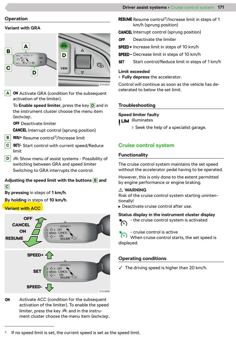

IIRC it toggles between ACC in conventional mode and the speed limiter setting. Possibly..... 😀
That's correct..... functions as handbook states if you can understand it
3 hours ago, penguin17 said:
Can you see the limiter setting if you press the ‘Mode’ button on the underside of ACC stalk?
 I only have the button on steering wheel not on stalk, which then gives you the option to set the limits

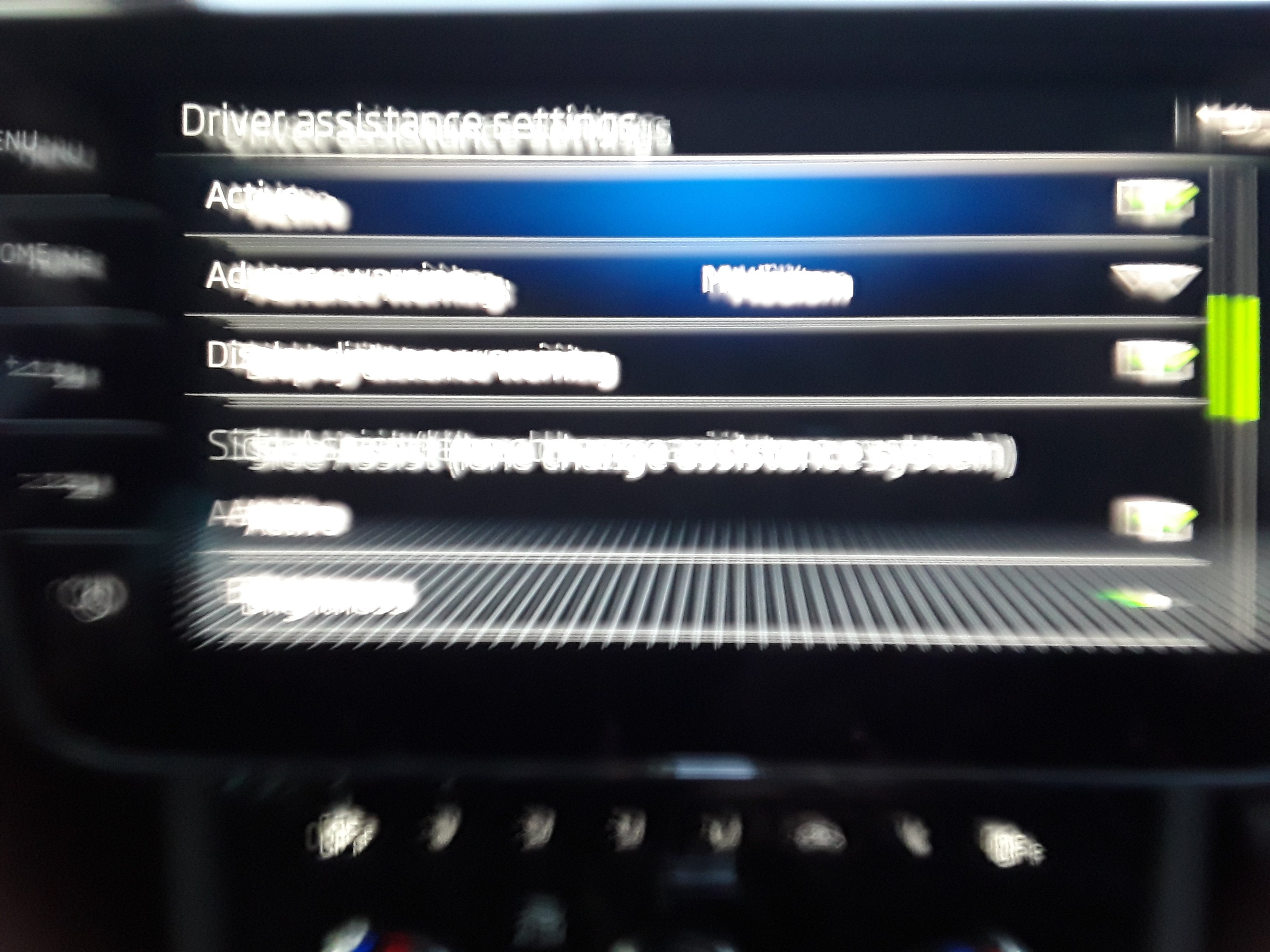

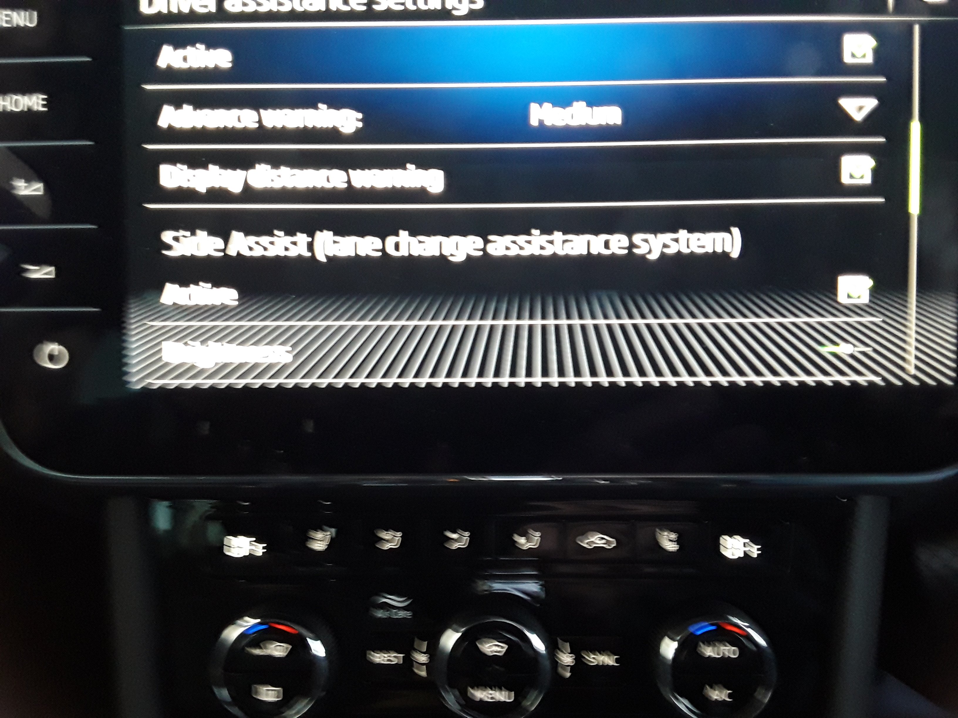

MY19 onwards Skodas with ACC shouldn't have the mode button anymore to change from ACC to LIM. Done in the infotainment/maxidot now.
This option on my facelift L&K, but not done enough yet to test everything out

Bad photo
