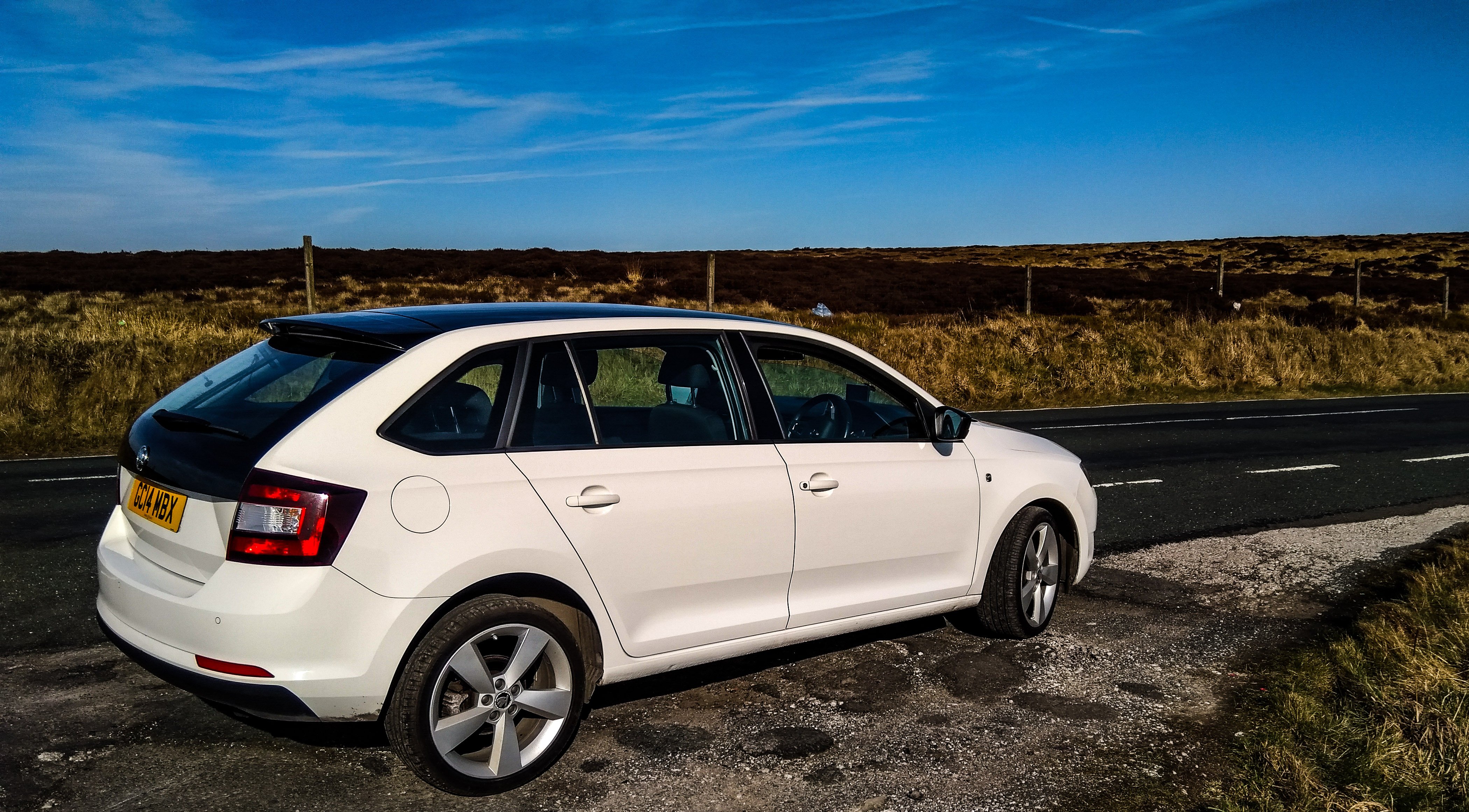

I'm looking to spruce up my Rapid Spaceback with different colour wheels. I'm stuck between buying a set of VW-group ones similar to those already on the car in a different colour (as it won't affect the car insurance) or getting my existing ones powder-coated.

The wheels on it have been re-conditioned before I bought it in Feb this year, so they're completely undamaged.
