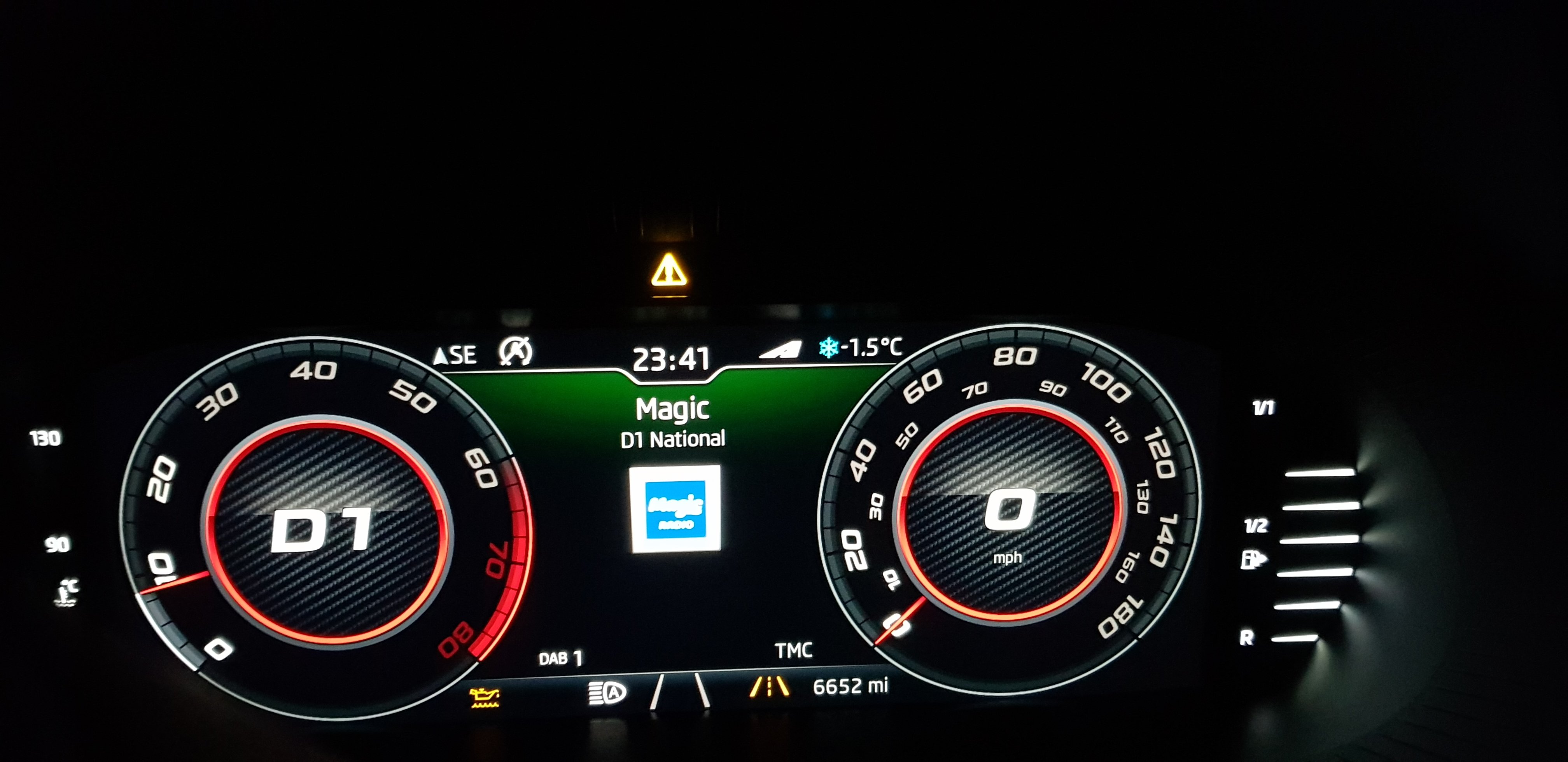

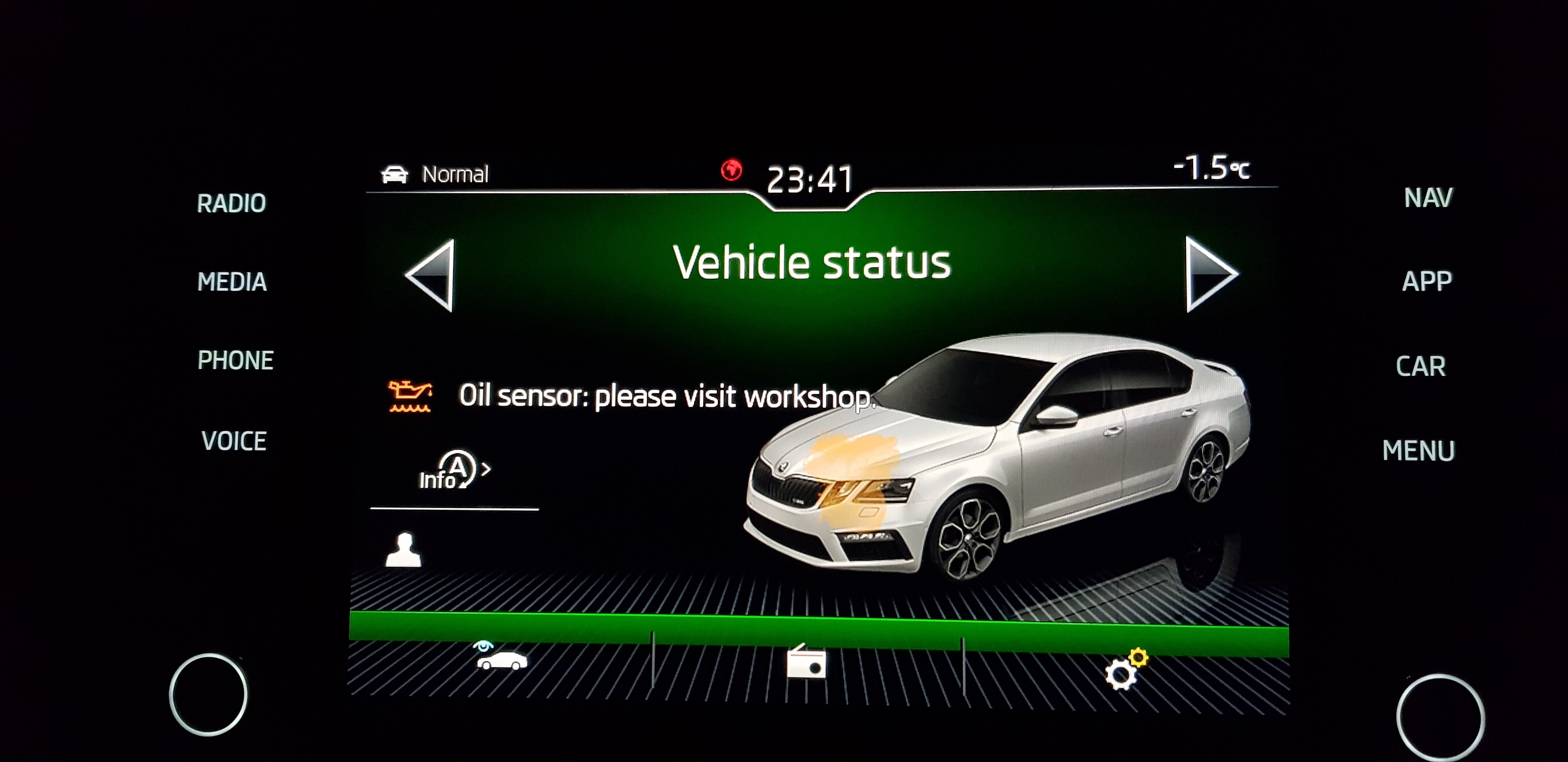

Here we go. The fault that keeps driving me nuts.
A fault that Skoda says doesn't exist and they can't trace. Well here's the proof that it's happening and this is the 3rd or 4th time in a week and the duration of the warning is increasing slowly but surely.
If anyone has any ideas why this fault keeps occurring can you let me know so that I can tell the dealer what to look for, because it seems that they're completely baffled by it too.
I still think that it's the sensor that is at fault, that or the oil which is the 0W20 stuff that they're now recommending could be causing the issue, or that there's something inside the engine that's floating around in the oil and every so often it either touches the sensor or goes past it, triggering it to show a fault.
I get no reduction in performance, just the warning lights and messages. 😞 🤔

It’s a long time since I did auto electrical work, but for it to flag the oil sensor as faulty  “ Engine Oil Temperature Sensor Circuit high “, there are only essentially 3 possibilities - The sensor is faulty, there is a break in the wiring between the sensor and the control unit (pcm), or there is a fault within the pcm.
Faults like these need a very methodical approach to diagnose and obviously a technician who knows what they’re doing. I used to love sorting stuff out like this, but it is very time consuming and the dealer is probably going to have to put a good tech on it for several hours and that is going to cost them a lot of money, and they clearly haven’t done that yet.....
The absolute first, cheapest ,and easiest test would be to swap the sensor with a known good one from another car, give you it back and see if that cures it.
Can you get it to keep the oil temp displayed on the dash and watch what happens to it when the sensor fault occurs. It would be interesting to know if it always happens at a particular temp, or the oil temp keeps displaying as normal despite the sensor fault, or if it suddenly loses the oil temp altogether.
From the symptoms you describe I personally suspect a loose/bad connection in a multiplug somewhere. If I was working on it I’d concentrate on that oil sensor fault as if it leads to a bad earth or connection that could also be the cause of the locking issues.
