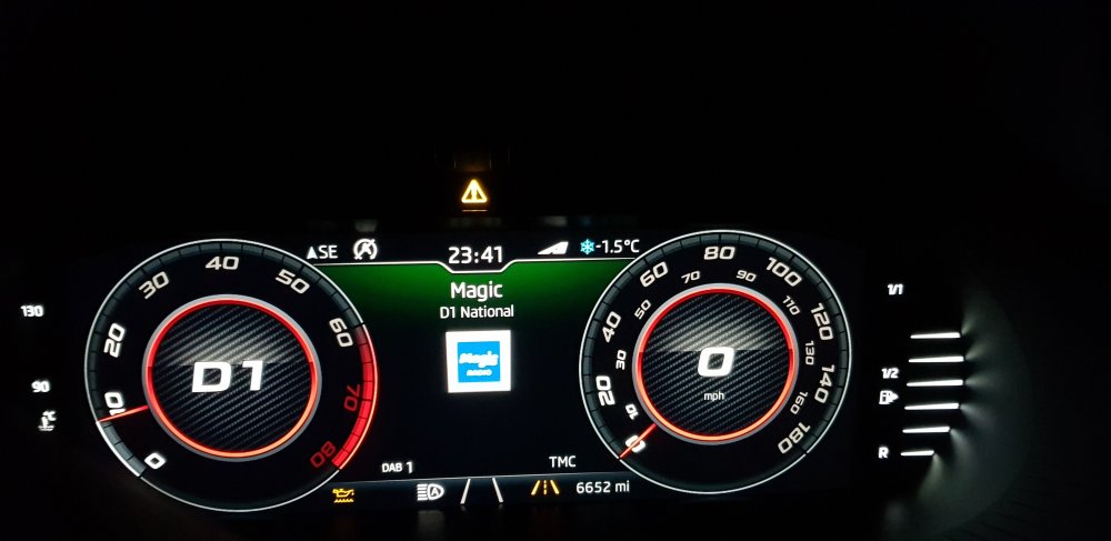

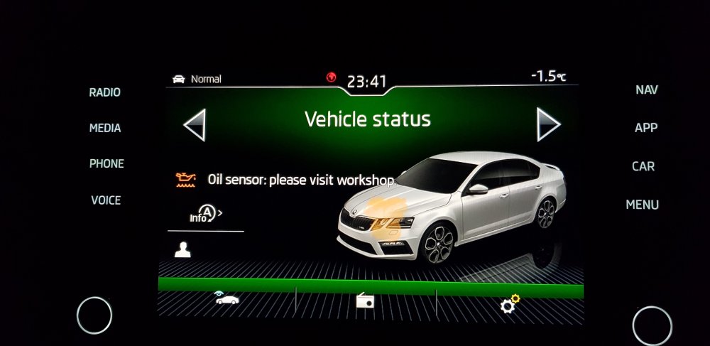

Today has been a dark day for my wagon and its becoming a liability and embarrassment.
Not only has the oil sensor failure made an appearance yet again at the last minute but...
The central door locking decided to play up and locked the driver side door temporarily despite unlocking the rest of the car, my mate had to open it from the inside, after locking and unlocking it a couple of times it cleared.
The infotainment system froze and neither radio or satellite navigation system would work, did a reset on it only for it to do it again and only for it to come back online when I shut the car down and restarted it.
The tourist lighting system caused an error when it was deactivated and it took two attempts to get rid of it by playing with the lighting control switch off-auto-off-auto.
The alarm sensor failure has also reared its head yet again...
Obdeleven has been utterly invaluable to me and has got the infotainment system working again, I managed to get it to reset the locking fault as well, but this is becoming a £32k joke.
