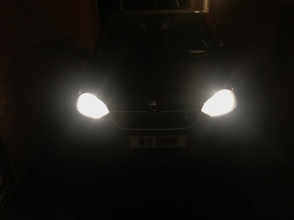

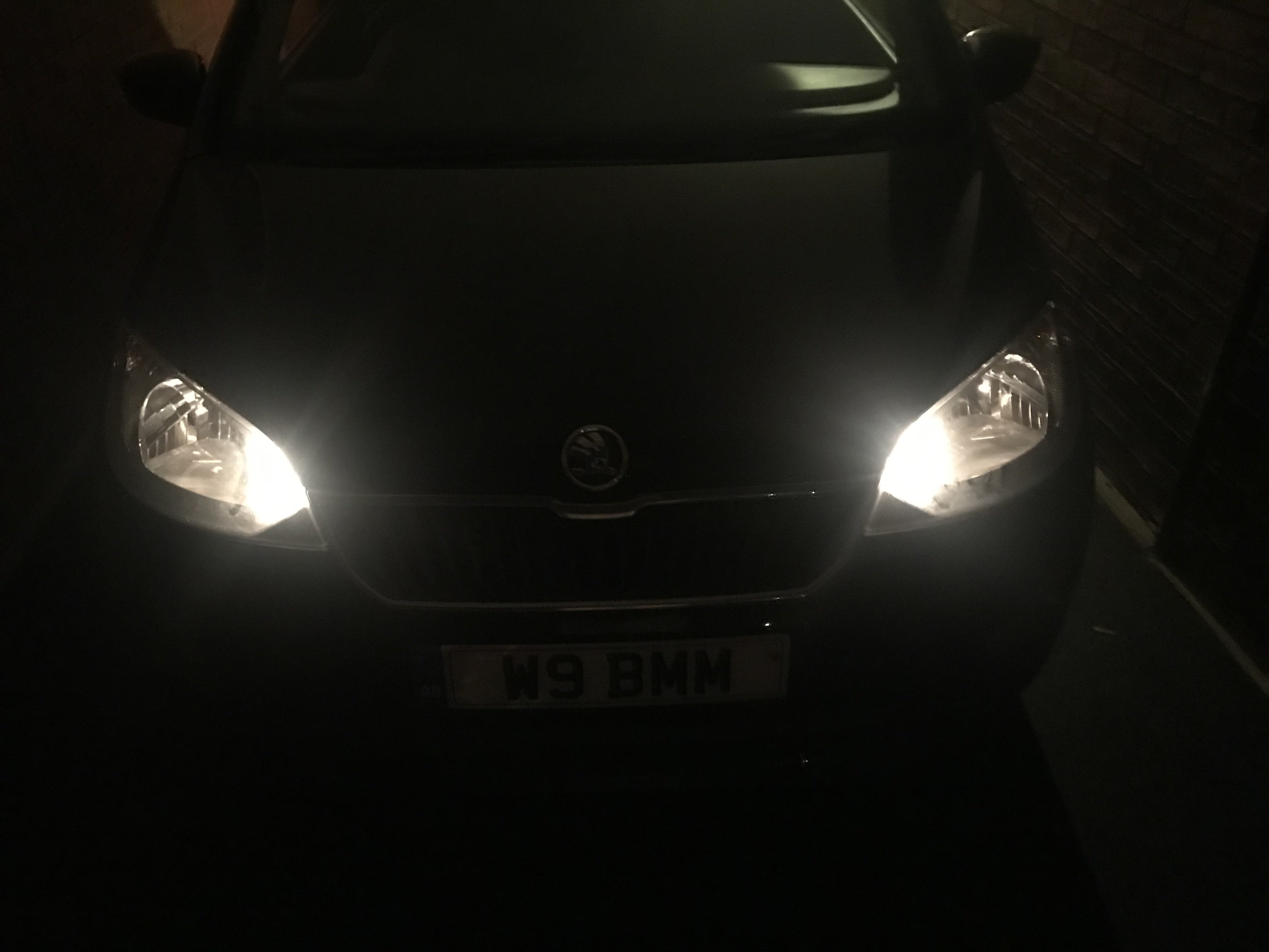

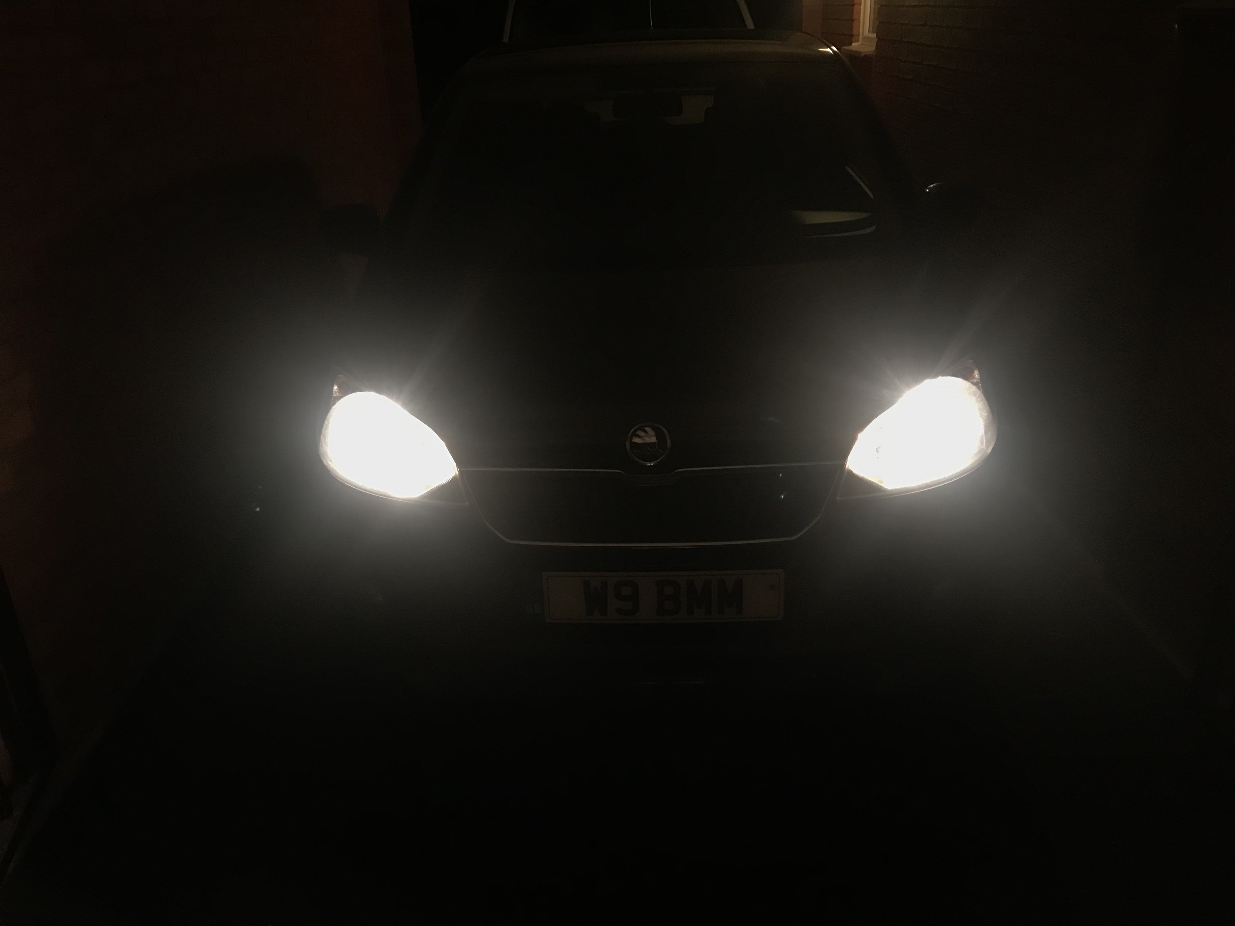

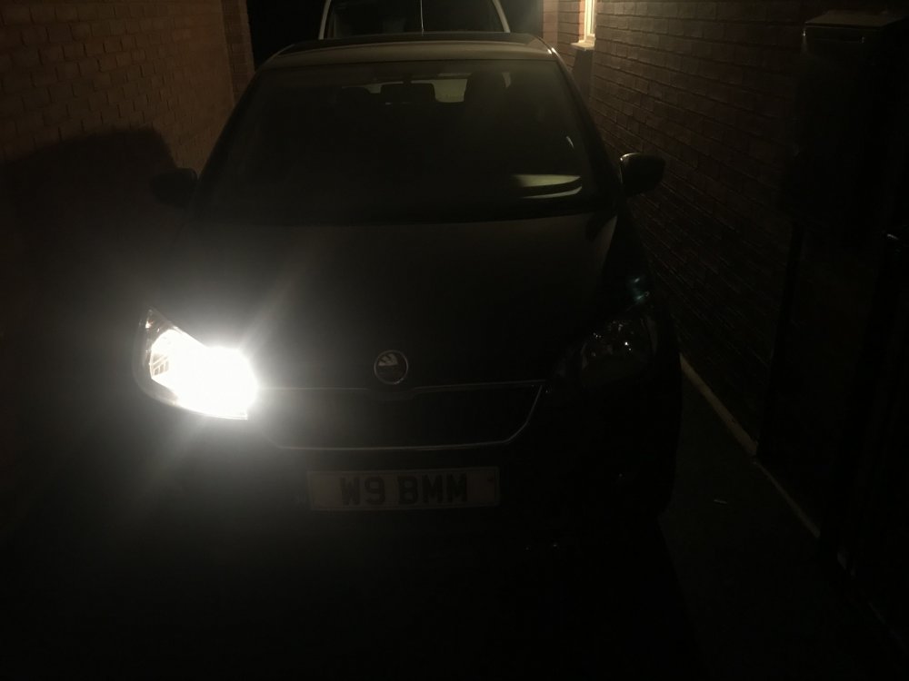

Hi all - I’ve got a 2014 citigo and there’s an issue with the daylight running lights. Basically, one of them is on full (as if I’ve got them on for night running) and one doesn’t switch on at all. When I turn them on for night running they both work, I’ve tried pulling out fuse 22 and checking it and it’s fine. Any suggestions on what’s going wrong and how to fix would be appreciated. Thanks in advance
I’m a bit useless with cars (YouTube mechanic) so sorry if I’m being dense...

1) daytime running (lights in off position)
2) sidelights switched on
3) lights switched on fully
I guess you need a new bulb for drl. Otherwise looks good to me.
It is a dual-filament bulb which works as drl and sidelight.
