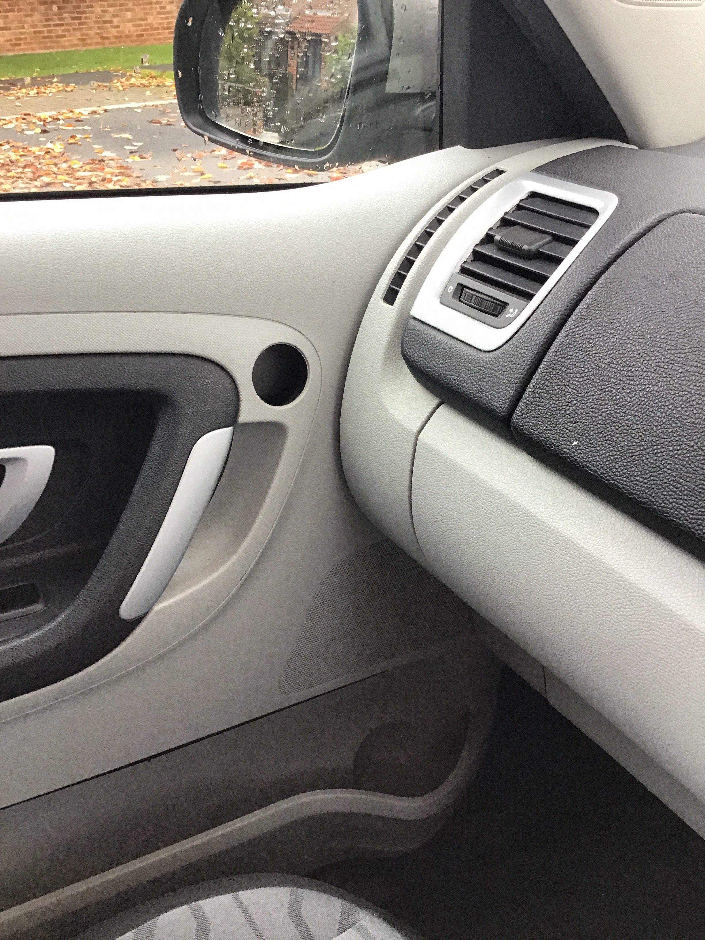

Does anyone know where i can buy a circular replacement filler piece ( on web) for the passenger side door ( where the mirror adjuster is on drivers side )
if i knew what the official name or part number was , that would be a good help
thanks

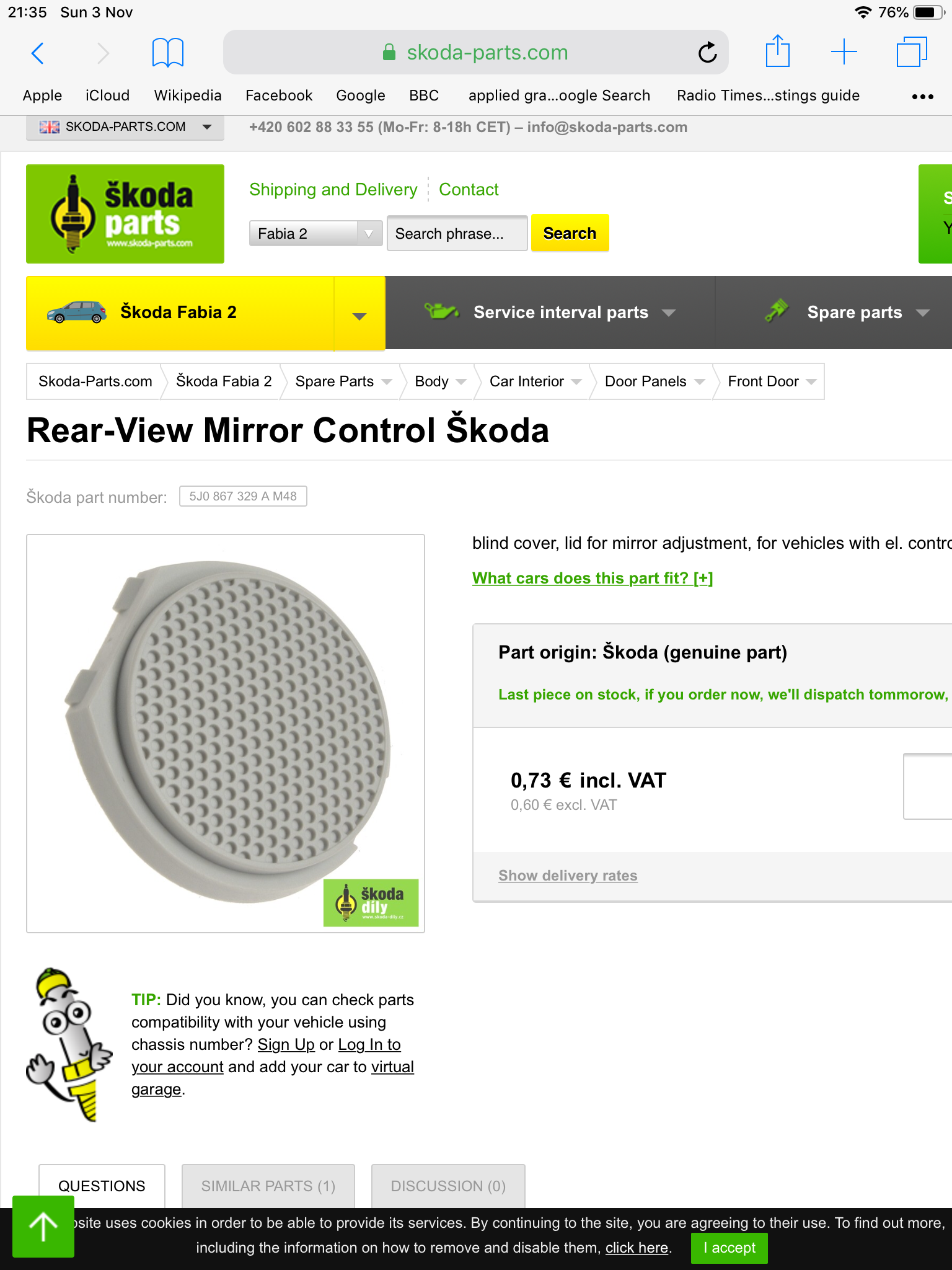

Thanks for your responses . Cs24 your idea is very inventive!
Now i have the part number hopefully i can make some progress, thanks to urbanpanzer.
This is the jobby , but looking at the way its fixed from inside  of the door panel , i fear it may just have been accidentally pushed inside and is lying at the bottom !8362E99E-83C9-4227-B0FB-CF7911DC85D5.thumb.png.c6bf9c9314c63b09cac6994eda88c42a.png

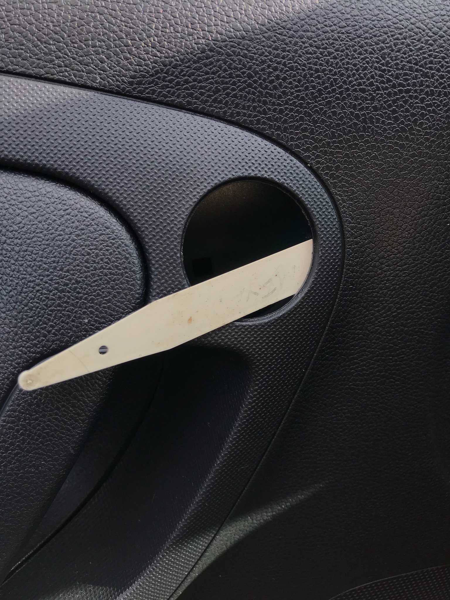

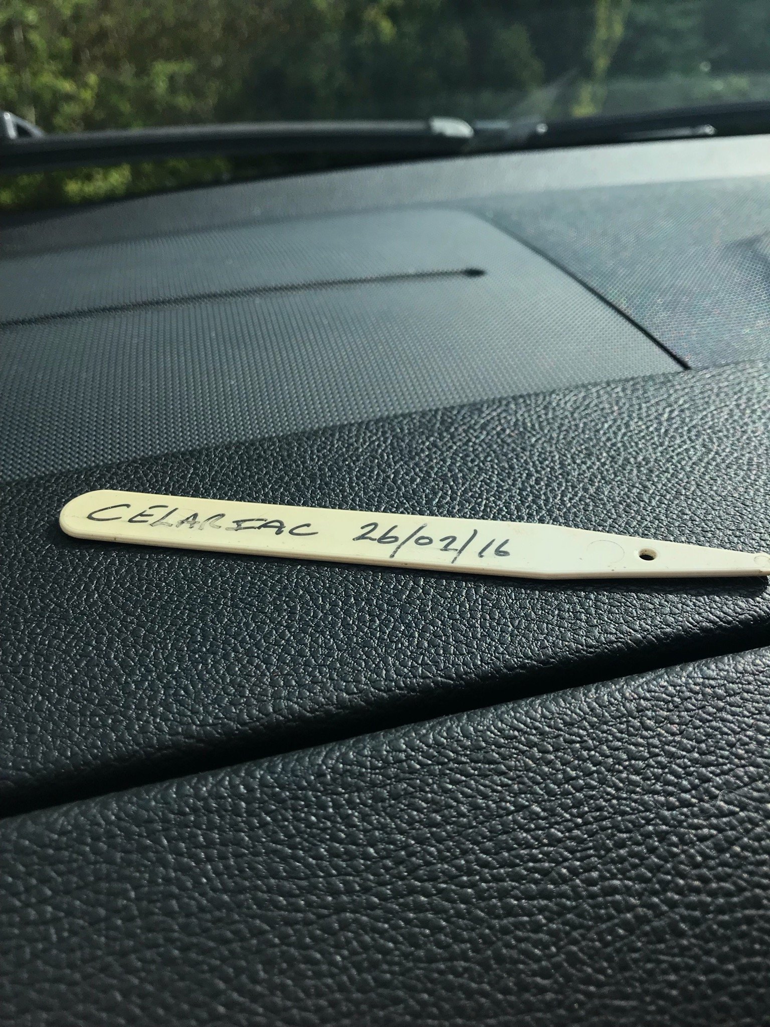

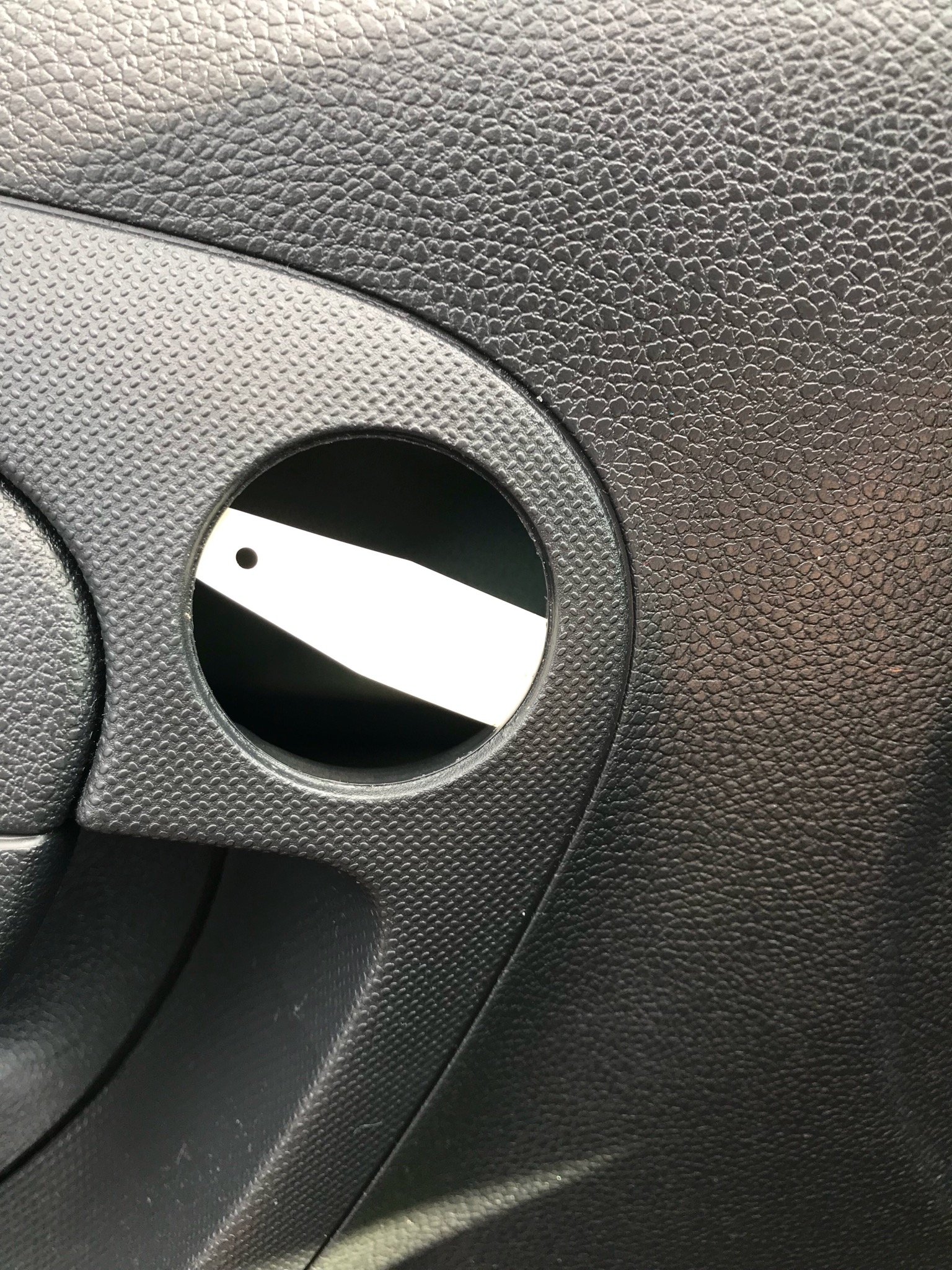

To stop it falling inside again you could put one of these plant labels in, although I’m not sure whether that would affect your ability to fit the part properly. 01AF2352-016B-431B-A843-649F618A27CE.thumb.jpeg.a3c1c8b92e284204bd469e1b293b053a.jpegA474DC94-096C-4DEF-92F8-CFC63BED6346.thumb.jpeg.3b8f786d21af8a11c51541a5bf44973a.jpegB3E905B4-E55E-473B-918F-D3CC0FDF8039.thumb.jpeg.0f78e9af171ae5f5e71fb0255fef3bbc.jpeg
Great idea thanks i'll have a go at that.
I was thinking maybe drill a small hole in it and attach a piece of fishing line or something. But that would spoil the look of it so ill try your idea first.

Thanks for all your ideas.   Just an update:  In the end i decided to remove the 2 small torx screws at the bottom of the door panel, and prise a few clips off just enough to feel around.   Sure enough it was lying at the bottom so it fell out!
I did actually glue it in this time . A good cheap job !!
