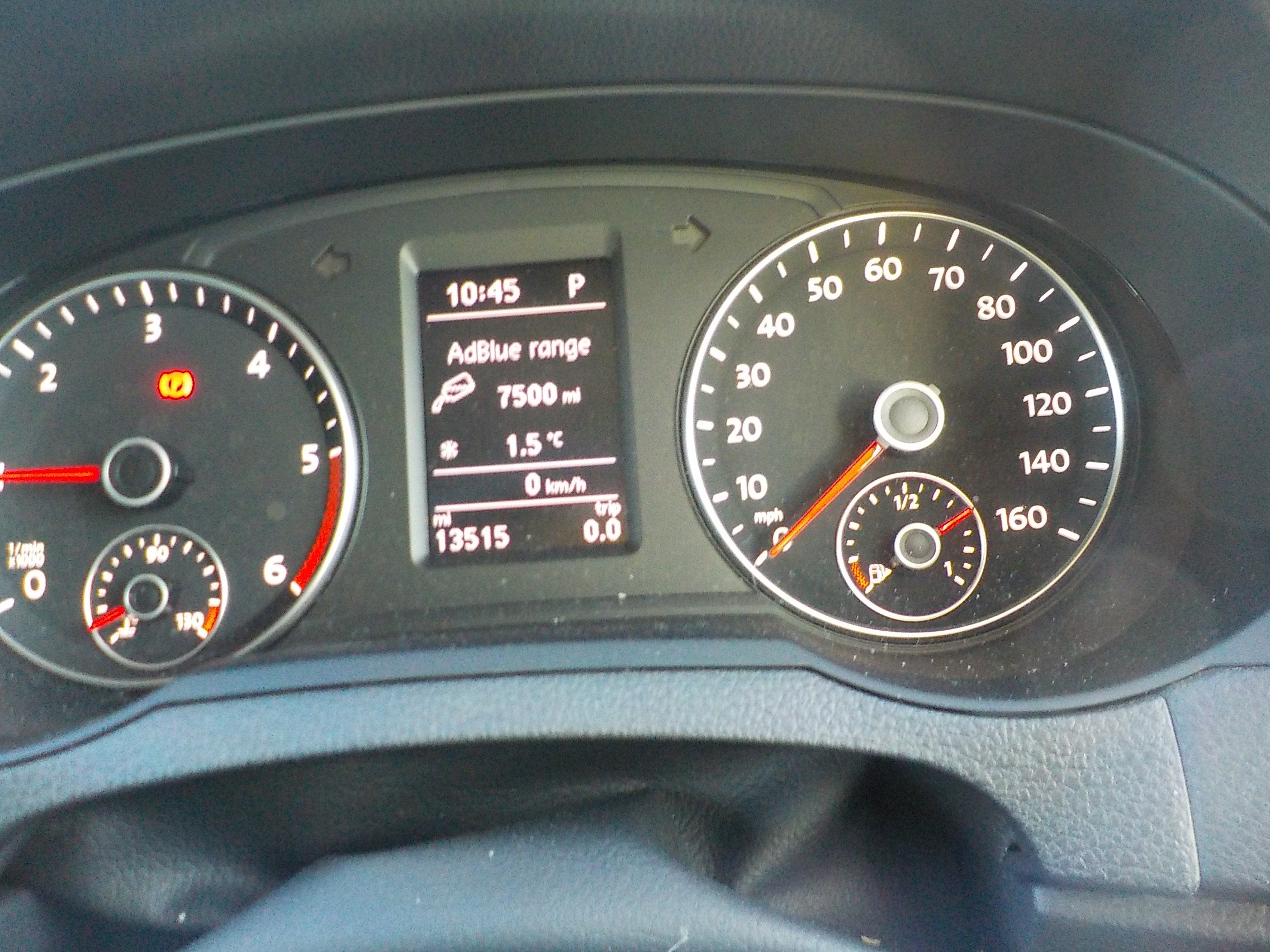

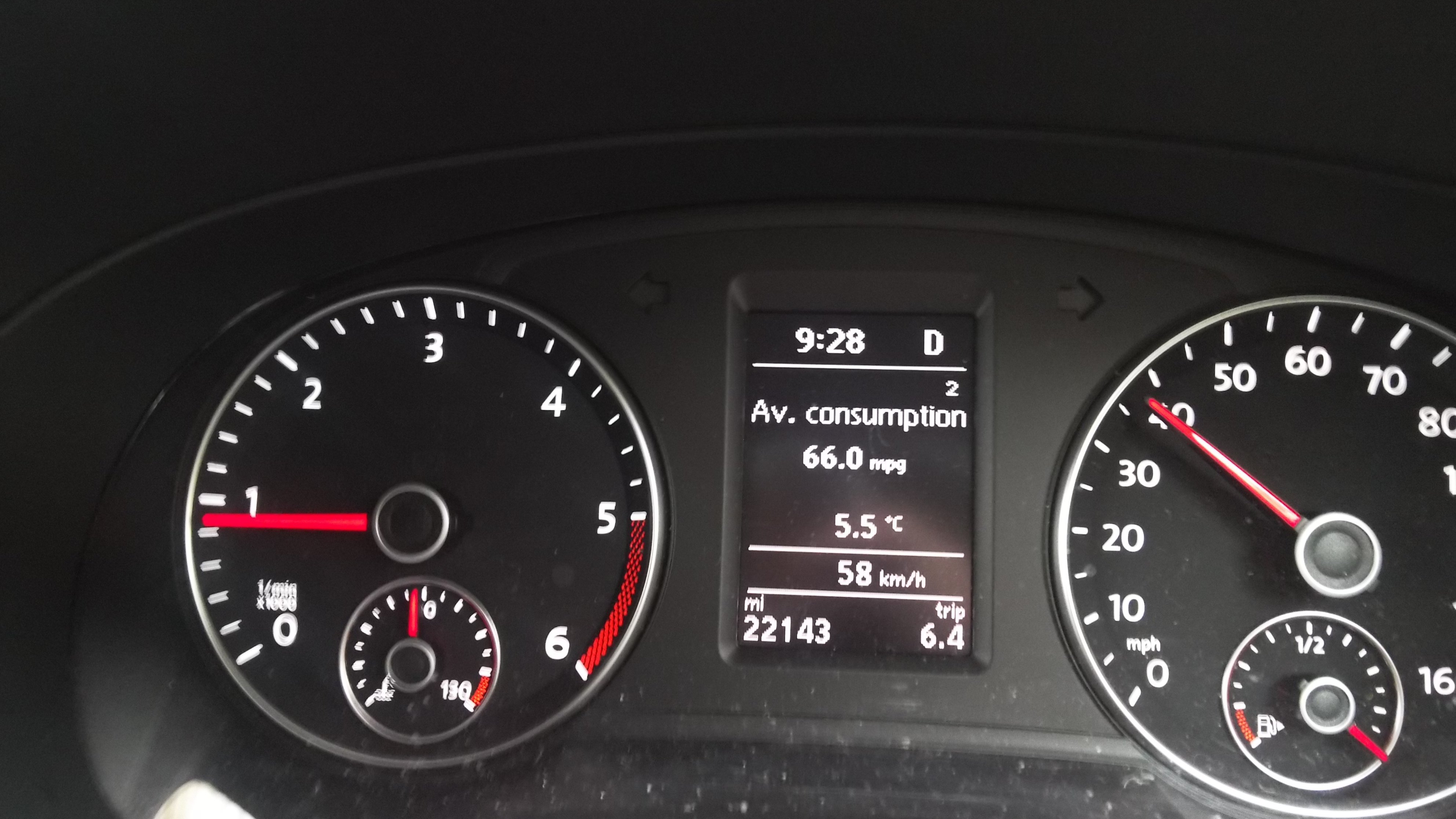

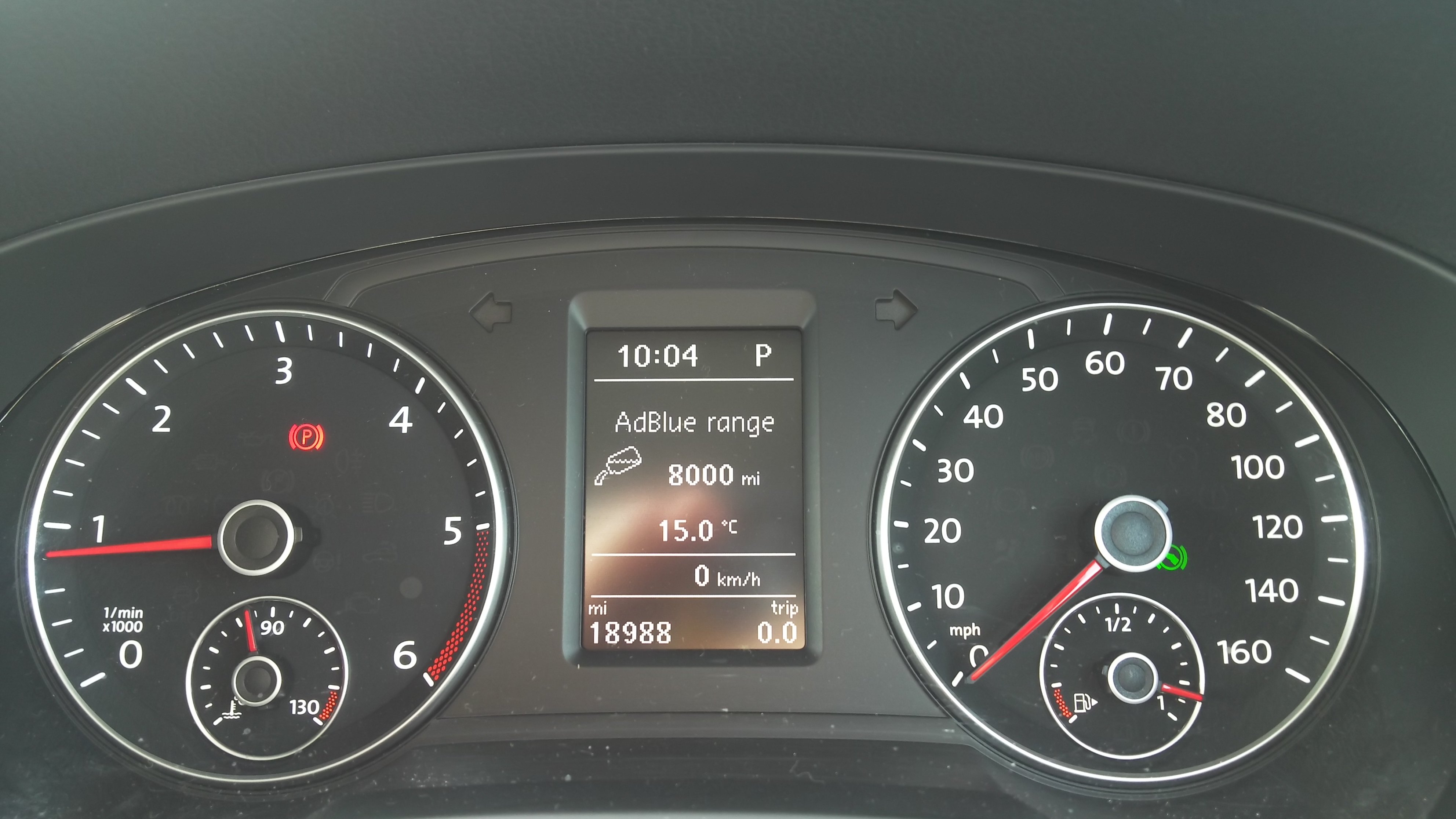

Personally i make sure i know exactly what the fuel consumption is of every vehicle i drive,
empty with me or loaded, and just driving or hypermileing,
and with DSG's / SCR what difference Coasting makes when available or suitable,
also the affect of driving useage on the AdBlue use.
DSCN2349.JPG.e71cc2e8522beae0d2baea6e1a195f4f.JPG.f935b4b0e6e00084fa94cd5455a8f35a.jpeg
DSCN2359.JPG.fe80e256a70b94c45b7ac5969d1b5653.JPG.fbb97b9f8bb3a92c9a2381268766baa2.jpeg
