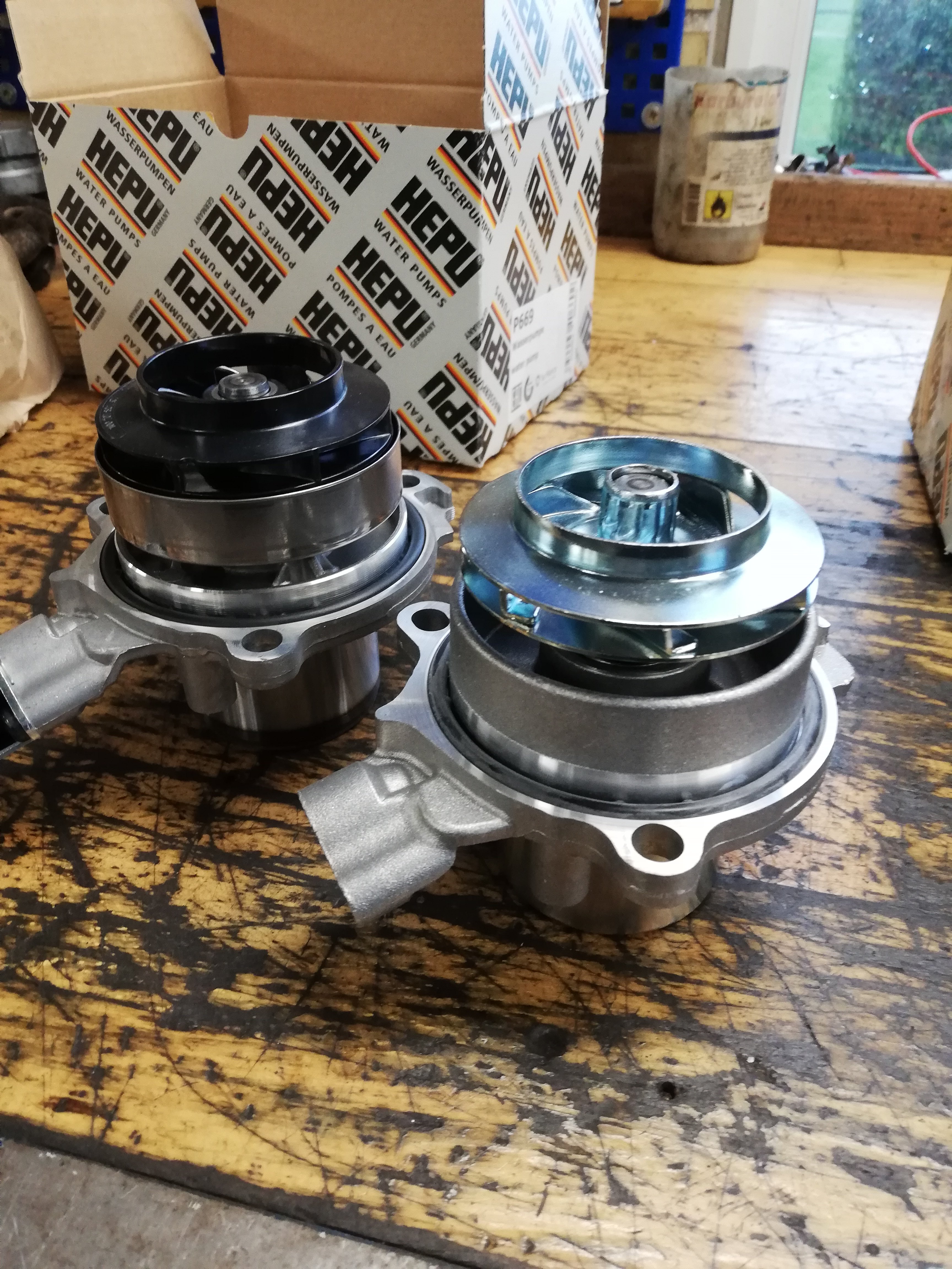

My waterpump are stucked and the car is overheating, it my second pump now on the 160000 km so I was thinking off buying a hepu waterpump with out the open/close wheel cover,
Anyone tried one or another that isn't original to see if the last
Not yet had any overheating  but I'm interested in the potential problems.
I see the pictures show pumps with plastic and metal impellers. Is there any problem with fitting a water pump without this open/close cover affair, if one is available.
No it's all the same as original but with out the cover,

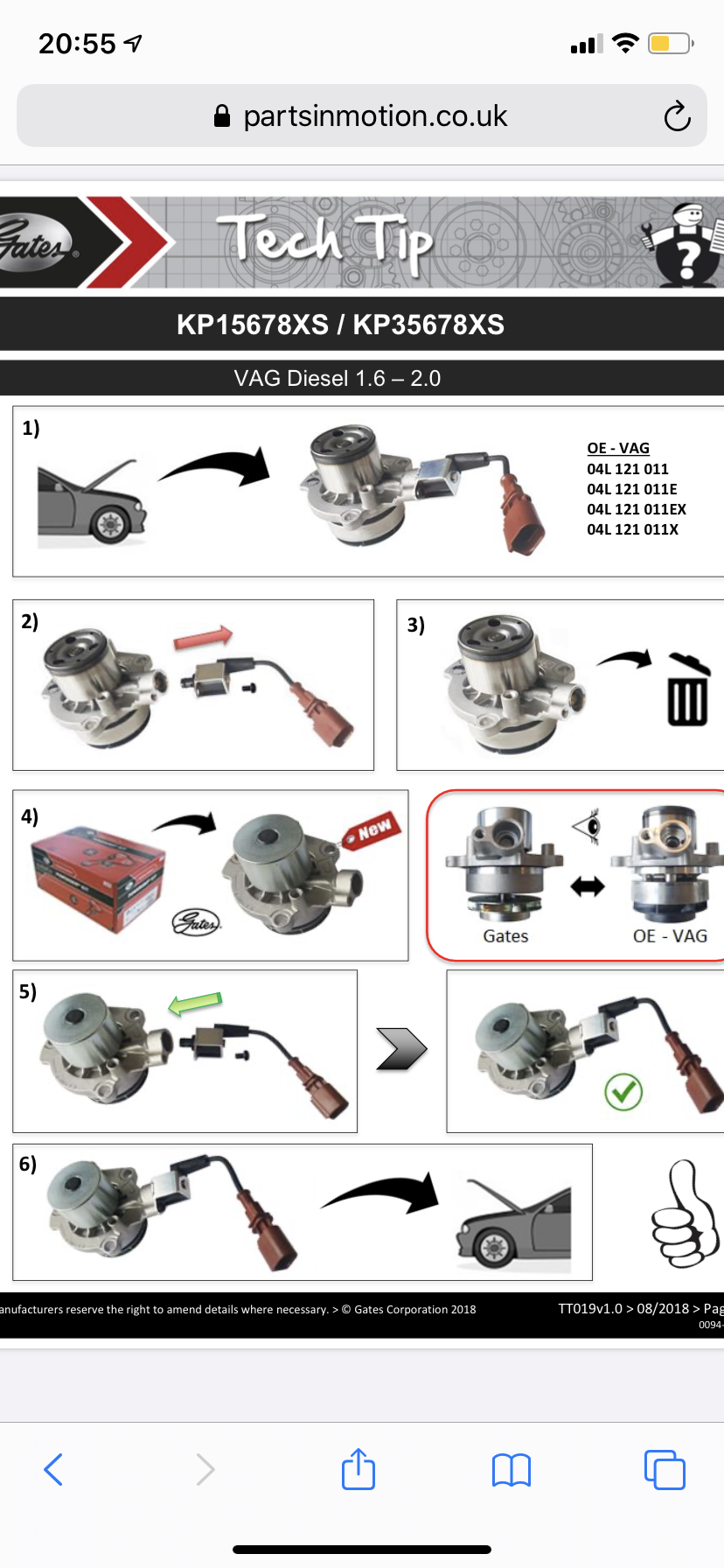

The newest pump from vw is fra the 01/09_19 and ends with the letter p
From what I can seen the after market has deleted the sleave  this could be eader a improvement or a work around for the pump sleave set up is a pierberg design they don’t have rights for . Appears you transfer the control solenoid from the old pump and doing so car thinks the sleave is been activated Octaviadk when was your second pump fitted ?
