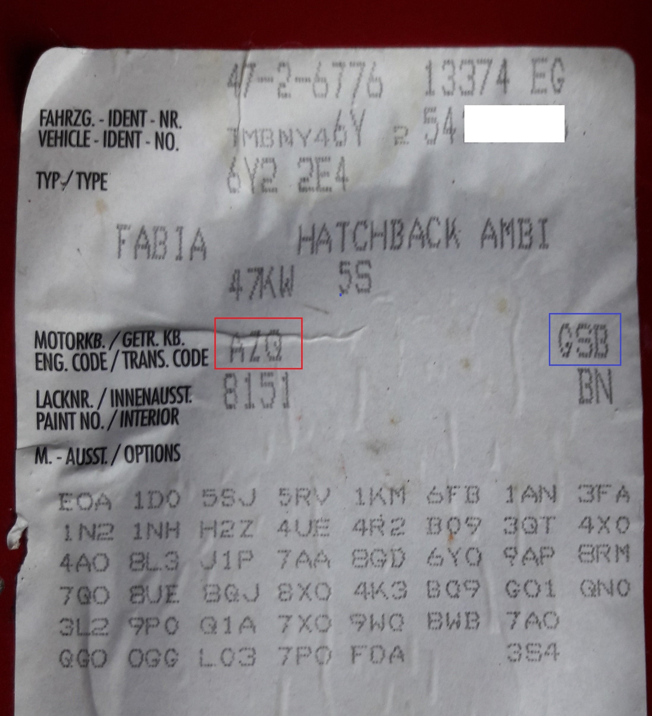

Guys,
Is there an easy way of knowing which gearbox you have?
Cheers,
Rob
  • Sponsor
^ Yep, look at the data sticker in the boot or service book. In blue square on this one:
