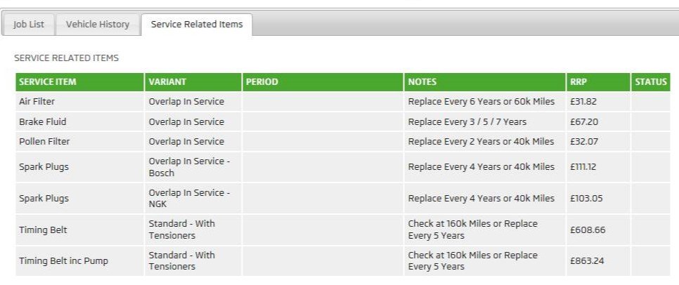

The picture below is what I was given from the dealer I purchased the car from at the time, 2018.
Cambelt is showing as this price now.
Cambelt change
Click for more information about this job
£429.00
Edited by Plantman
Plantman - yours is as clear cut a case as I've ever seen - wish everyone had a dealer like that.
The supplying dealer has told you every 160k miles or every 5yr ( whichever is sooner ) and in truth that's all that matters to you.  If the belt snapped at 150k miles or 4.9 months and the car was serviced by Skoda ( or you could prove the belt had been checked by someone else who serviced it ) then you have a legit claim against the dealer. If the belt broke at 161k miles or at 5.5 years and you said " but an independent american magazine says..."  or  " the Irish Skoda website says... "  or  " that bloke on Briskoda says... "  then Skoda would rightly tell you to get stuffed.
