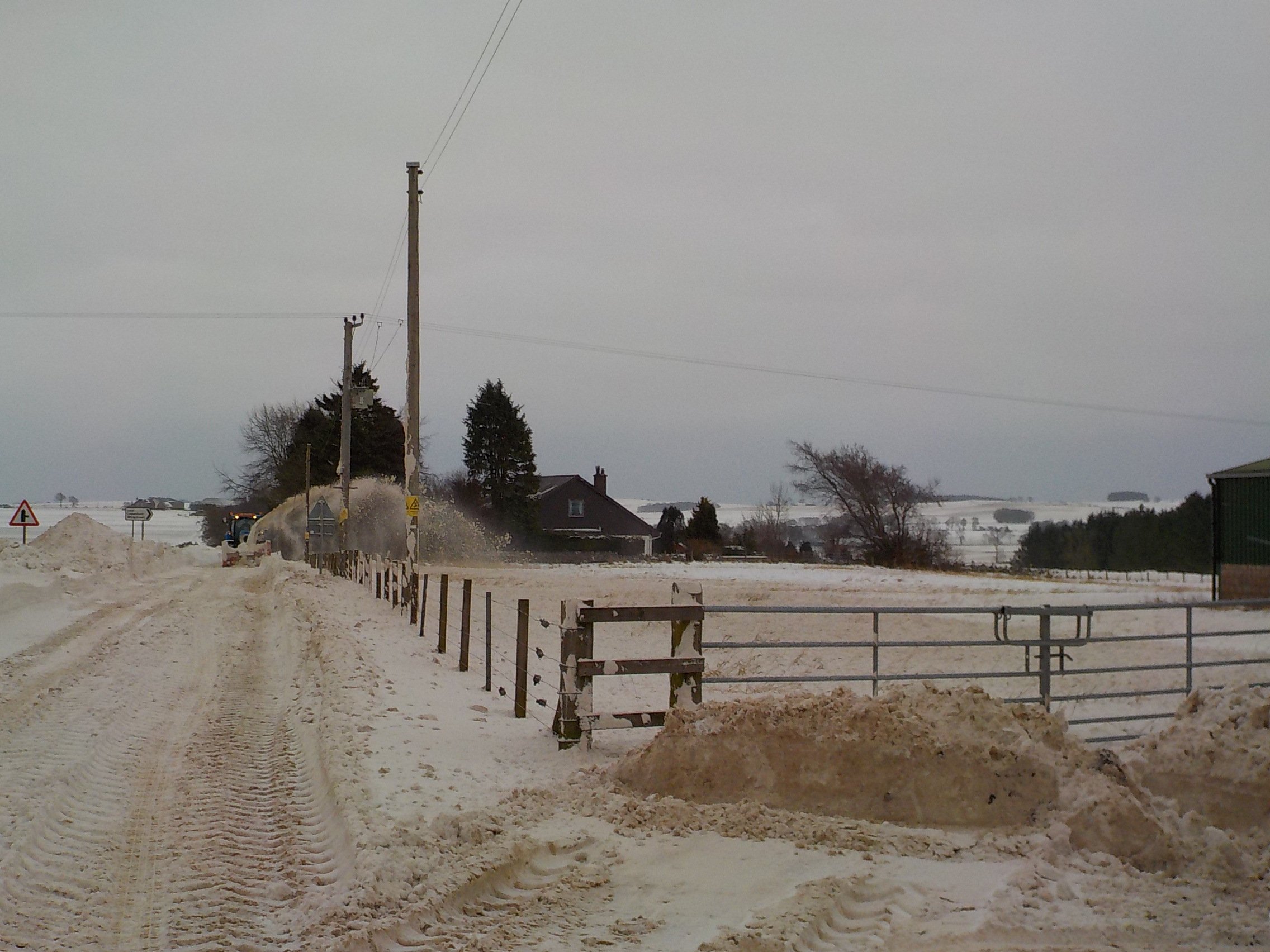

DSCN3136.JPG.88cc411f936ee4ebffd08884229a87c6.JPG.cb5bc46aa51792465da7ddcc0855071f.jpeg

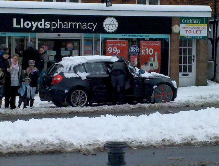

Funny seeing Snow Socks on the Front of rear wheel drive cars, or the rear of FWD's.
I mean where there is just a pair fitted.
That is not just seeing the ever green annual pic of the 1 series BMW with snow socks on the front.

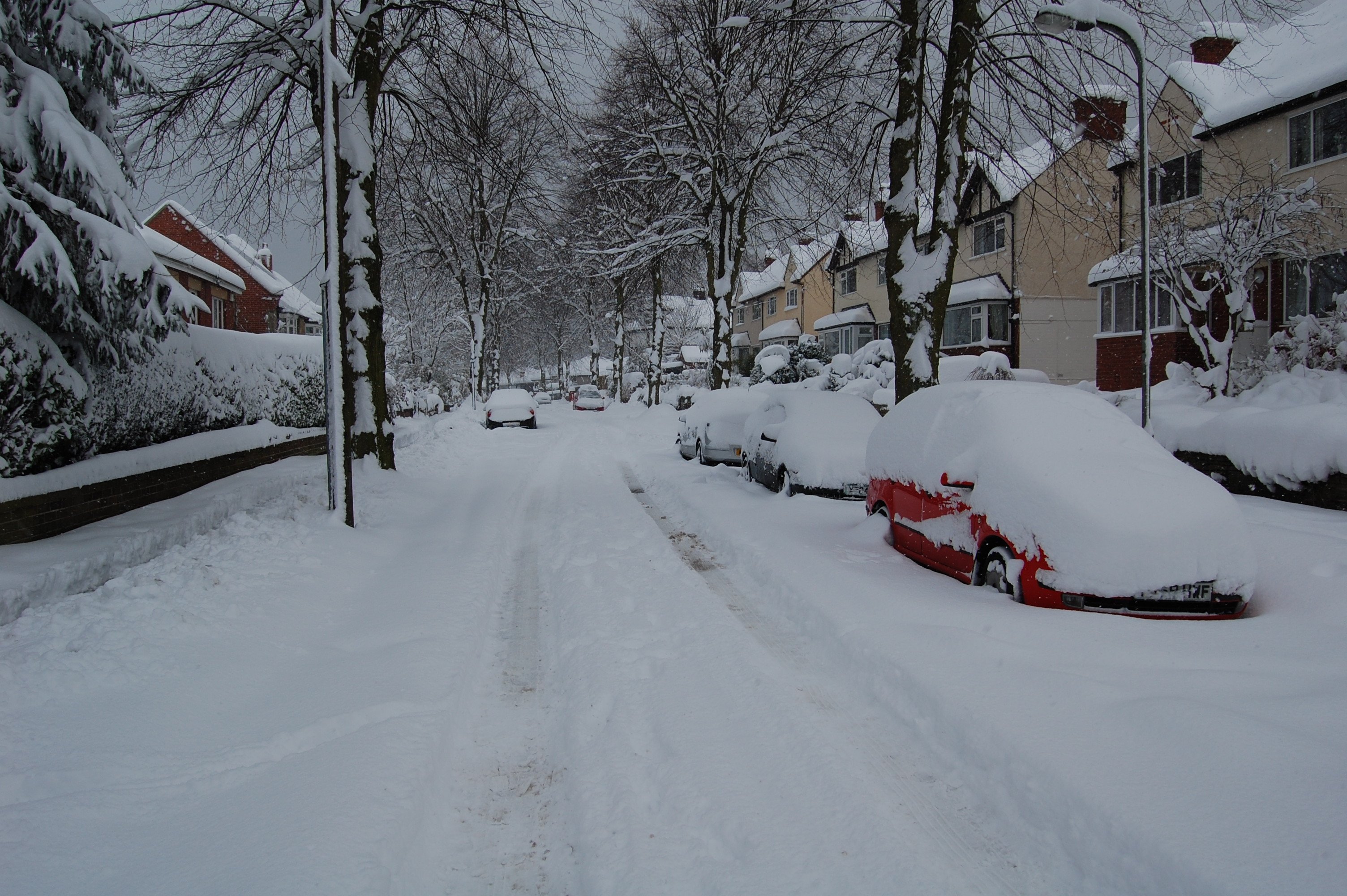

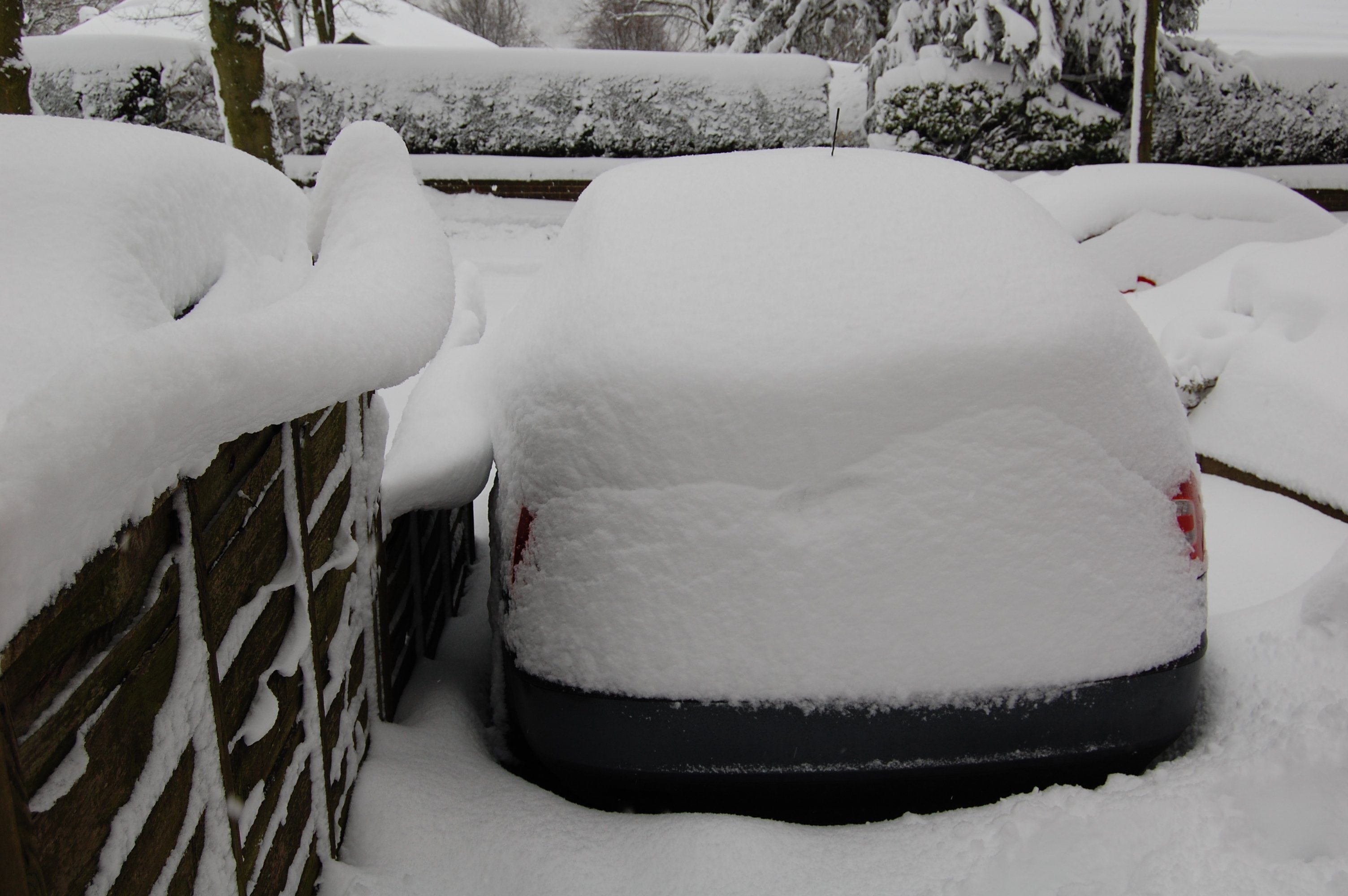

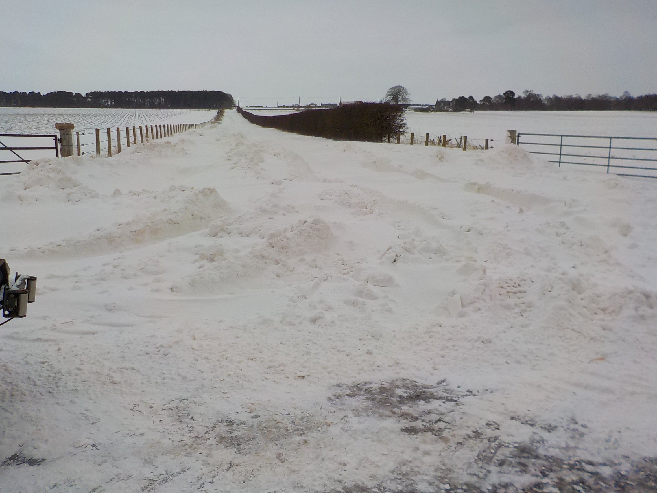

1 1/2 foot of fallen or windblown / drifted snow is not easy to drive through.

In terms of the stuff you've shown above that's typical for round here and I've not had any problems getting about:
the newer model of the 1 series is FWD
But it is not a new one, well maybe it was 6 years ago.
