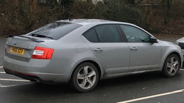

17s do fit, I am currently running my 17 inch Dezent TD with winter tyres.
I think the official ET number is ET49 in 17 fitment but I could be wrong.
