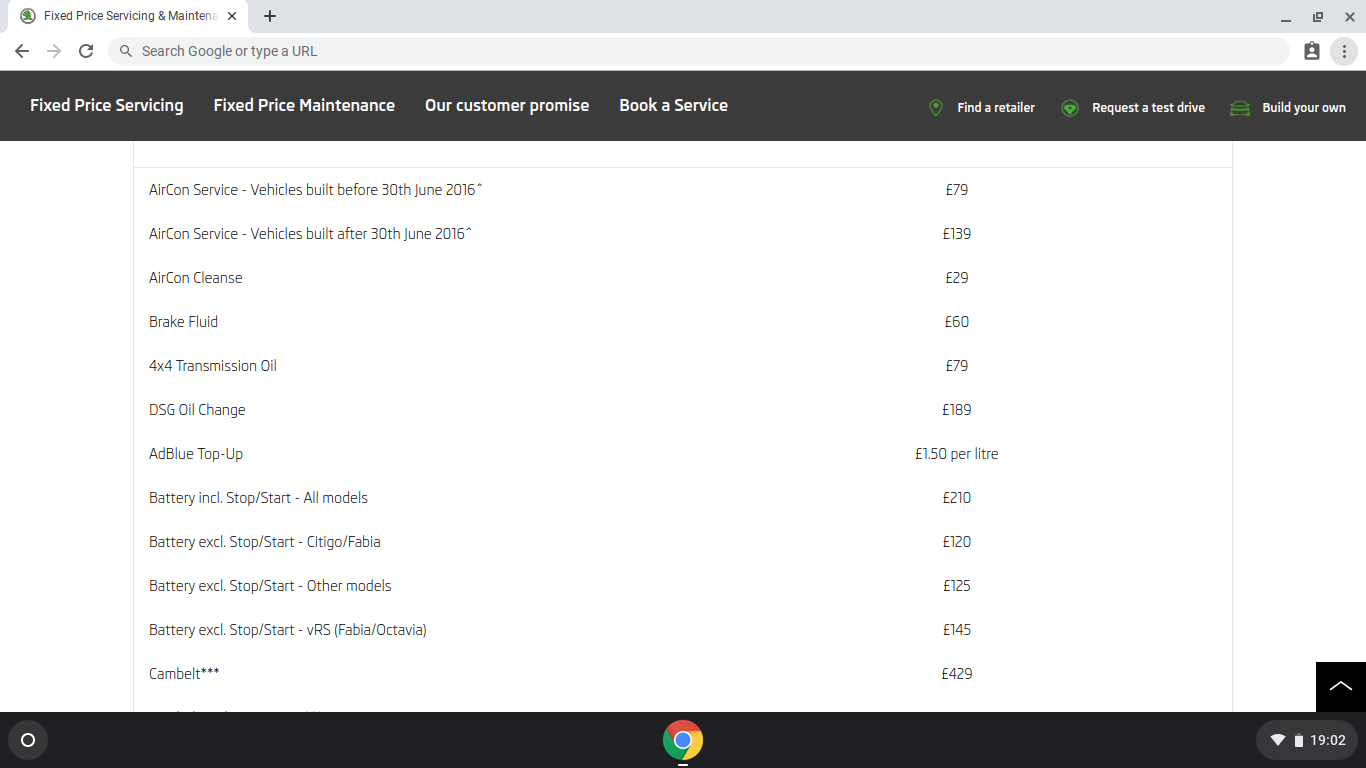

Good advice, I've used it in the past but for some reason not on the Skoda. Will start tomorrow. By the way, does anyone know how much the aircon service is?

It's listed on the Skoda UK website as £120.   I think I'll not bother!

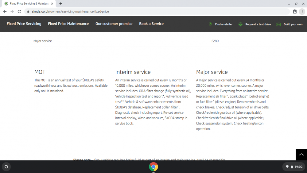

As it is Heating and A/C operation is supposed to be getting checked at Major Services.   That is not a how cool is it cooling...
That getting done is more likely than the Removing of wheels.
Maybe on a par with Body Inspection for the Paint and Corrosion Warranty.

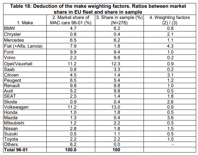

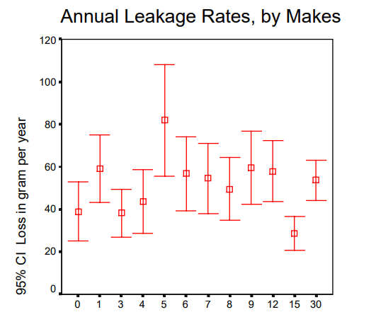

Interesting report.
Unless I'm reading it wrong the average annual loss appears to be under 7%.
There are also some quite wide variances in the losses by manufacturer, the report rather unhelpfully hiding the best and worst performers.
Skoda vehicles however only formed 0.4% of the total percentage of vehicles tested...
Let's hope their system is one of the better performers.
Lets hope there is something from more recent than 2003.
And all listed VAG (which will use the same A/C when fitted) more like 20%,
I'm not so sure, yes there is a lot of component sharing going on across VAG, but there is also a lot of locally sourced components and various different assembly locations and processes accompanied by varying levels of quality.
Using that approach you'd also potentially group together Peugeot with Citroen, Renault with Nissan, JLR with Ford etc. which I don't beleive would be accurate.
