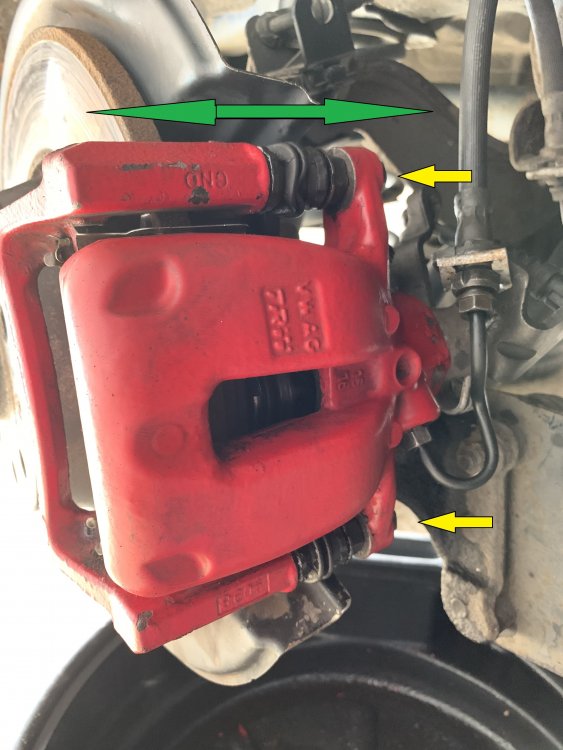

So, I did a further investigation of my break caliper problem and I found that in compare with left side, the break caliper is much tougher to move*green arrow* on those carrier sliders *yellow arrow* once tightened.  I have cleared and lubricate those sliders, but it didn't help so I guess, need replacement. Question is if the break caliper should be replaced too?

Have you tried the slider pins individually in the carrier/flushed the holes with WD-40 or similar and cleaned with a cotton bud?
Could be burned/dried old grease deposits inside or bent pins from a previous spanner monkey.
@MicMac Yes, bent pins is the only thing that makes sense to me at this point, though how someone would bend them accidentally, No idea.
Cleaning and lubricating the sliders and rubbers should be a given really when replacing a caliper.
@Nosnx As an aside, what grease did you use. And I thought you already had a new caliper? Which caliper is in your photo?

The break caliper on the picture is the refurbished/old one. Swapped it back to check if the new one isn’t faulty but old is sticking in same way as a the new one now after I assembled everything together.

I did that many times. The disc is moving freely with fitted caliper and rewinded piston fully in. What is sticking is caliper on those sliders if tightened and once the piston is pumped into position to break it’s stuck completely. Must by bend pins, it’s only logical explanation to me...what isn’t is how I bend them 😃
Hopefully the set of a new ones will sort it, otherwise I’m looking on faulty break line or break cylinder 🤔?
