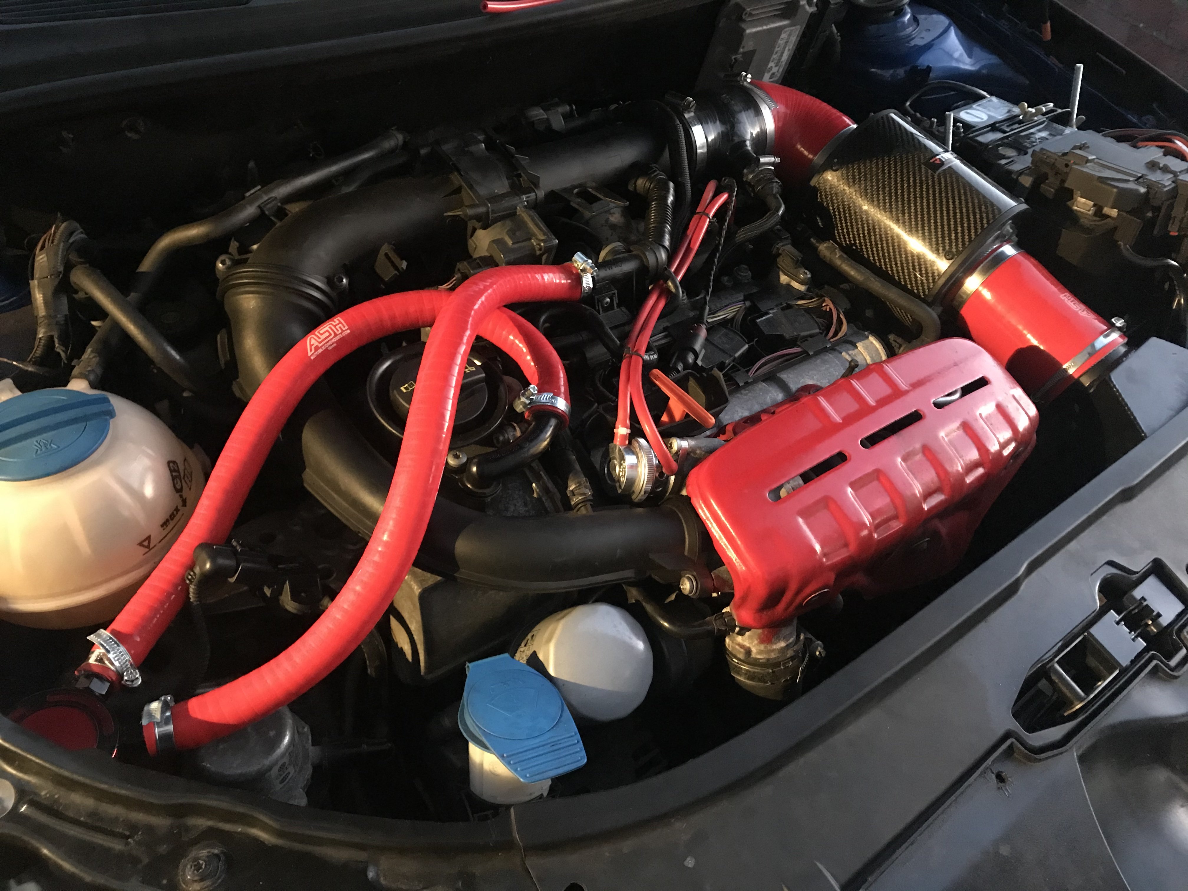

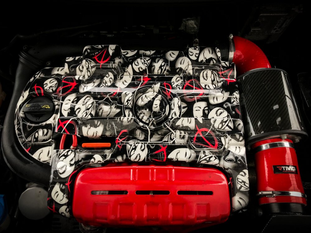

Heres how mine currently sits:
It did look a lot neater with the engine cover on, Due to installing an oil catch an I had to remove the cover.

Wow looks awesome so from what I can see you have just turned it over from what I remember the filter was up the top, did you have any issues getting it along side your battery?

Yeah it basically flips the filter 90 degrees and gives you a more direct/straight air flow, To flip it you need to buy a battery relocation tray either from RTMG for £70 or make on yourself like I did albeit it took me a weekend.

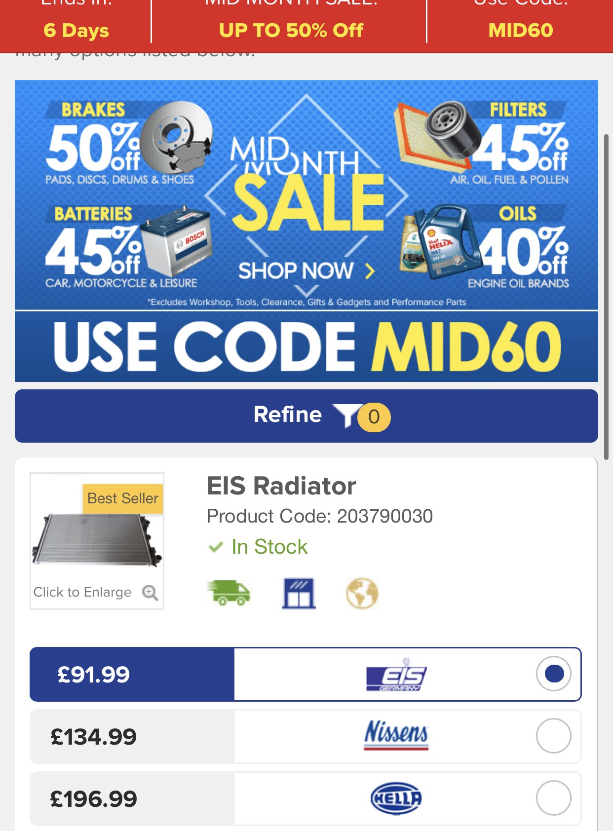

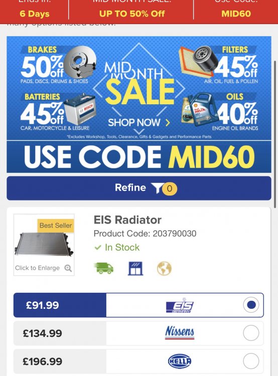

Its £92 for the radiator just now without the discount , I’ve ran that radiator for a couple of years and it’s been sound.
