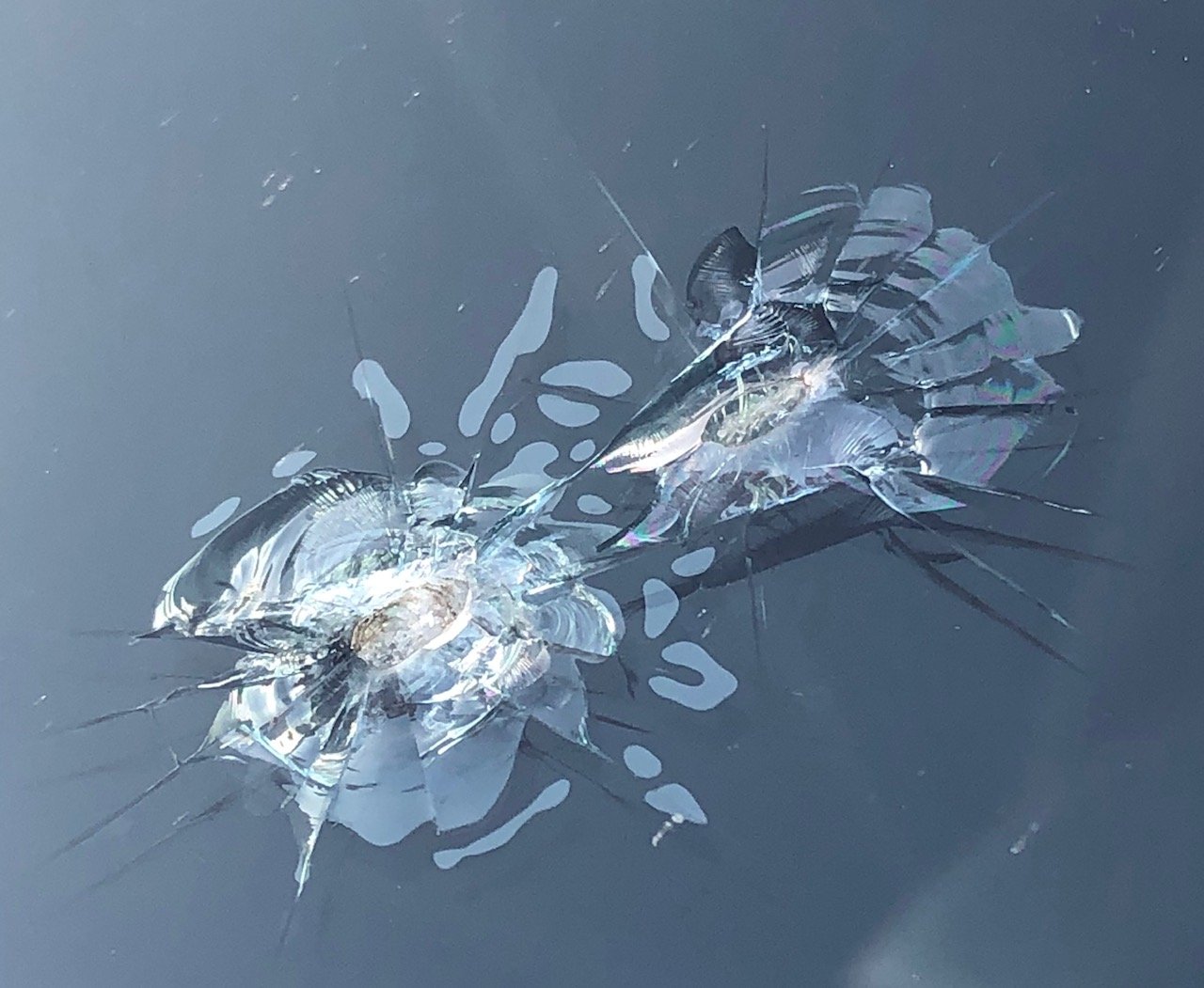

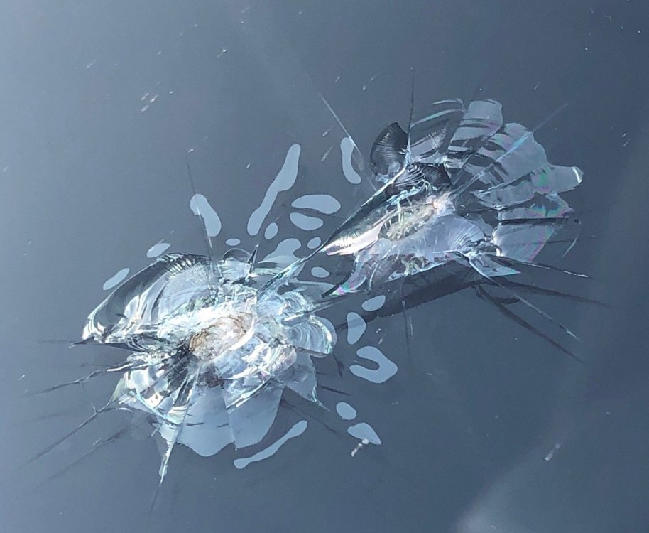

Why not just send a photo of the damage to autoglass. They will advise if the damage is repairable. I recently damaged my windscreen, see picture. Autoglass did a good job. Can hardly see the damage now and it passed mot.

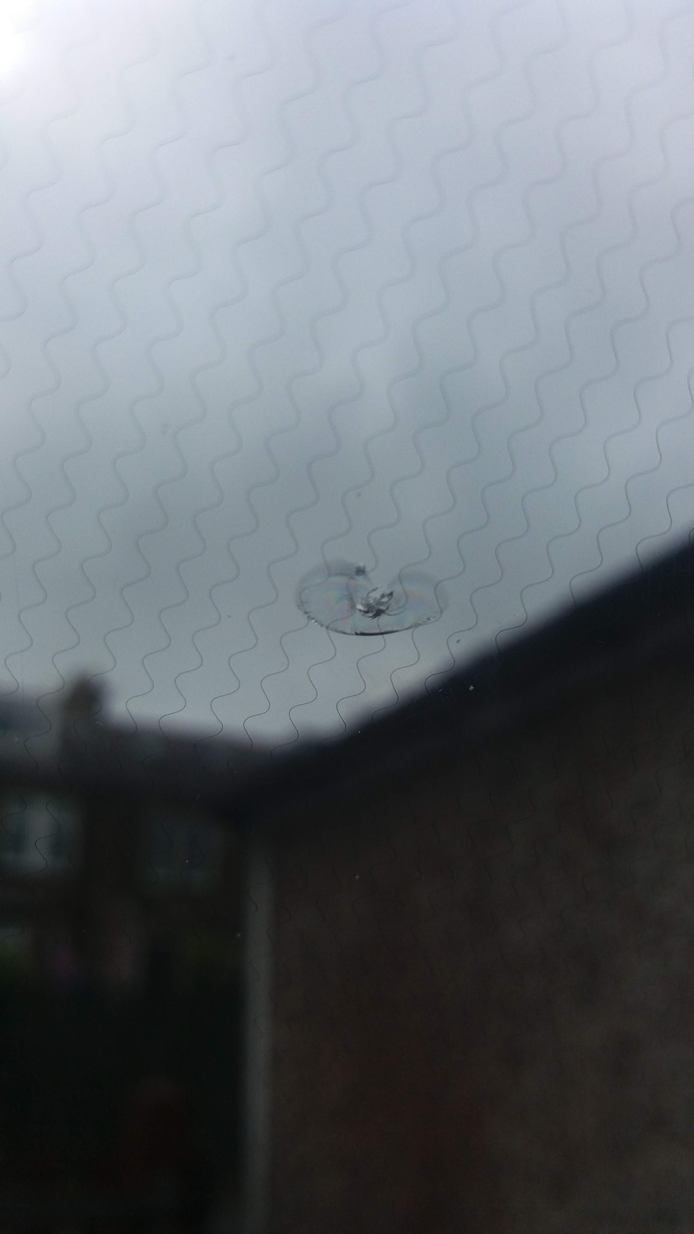

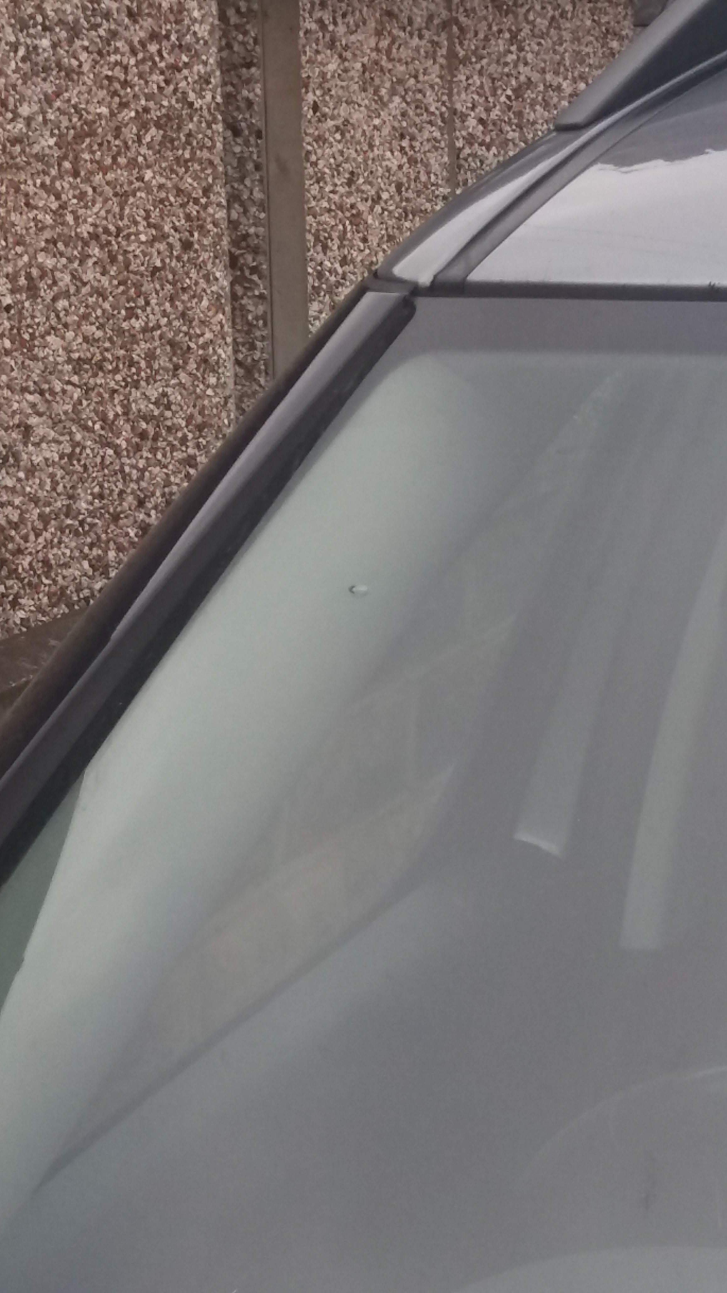

I have a tiny surface only chip right in the drivers view, its tiny and is smaller than a bug splat or bit of dirt on the windscreen. I didn't even know it was there until I had an MOT. It came back as:
Quote
Repair as soon as possible (minor defects):
  • Windscreen damaged but not adversely affecting driver's view (3.2 (a) (i))
Autoglass said they couldn't repair it. I've only had the car a year and I've had 3 stone chips already, one that was repaired two that are surface only (only one in drivers view). After 9 years with my previous car having only one this car seems like a stone magnet.
Will probably get it replaced before the next MOT.
