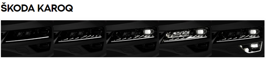

All Karoq's have LED DRL's.
Karoq's with full LED headlights have an LED strip that runs along the bottom of the headlight. It performs the role of DRL, side light, parking light and indicator...
DRL - full brightness.
Side Light - full brightness (this is relatively new, the DRL's no longer dim in side light mode), the additional LED eyelashes also illuminate.
Parking Light - full brightness (this is relatively new, the DRL's no longer dim in parking light mode),  the additional LED eyelashes also illuminate.
Indicator - clear light output replaced with orange.
From left to right...
1) DRL.
2) Side lights and parking lights.
3) Dipped headlights.
4) Dipped headlights and high beam.
5) Dipped headlights and fog light.
On Karoq's with non-LED headlights i.e. the OP's SE the LED DRL's are in the upper section of the fog light, instead of the main headlight...
Image result for skoda karoq headlights
They do not dim, they perform the role of DRL and side light and parking light, and unlike the full LED headlights they turn off completely when the dipped headlights are on.
