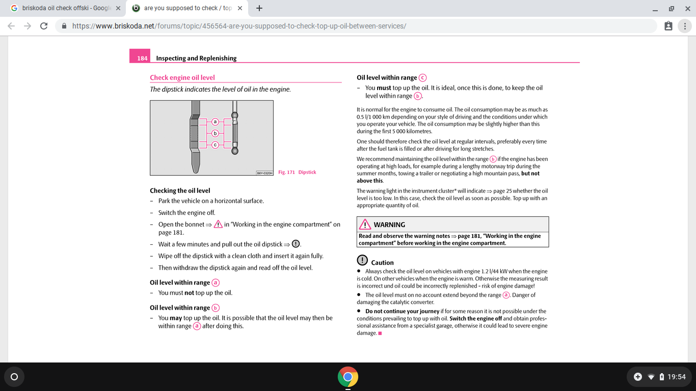

Only the 1.2 44 Kw engine is supposed to have the Oil checked when cold, all the others should be checked at Operating temp.  So high enough then.
Obviously you should know where that mark will be when cold so you can check before driving.

Only the 44Kw 1.2 should be on the Max mark when cold.  Your 51Kw / 70 ps should be there at operating temperature.

The 'Warm' in that Owners manual was a Skoda error.   VW, SEAT & Audi said Hot or at Normal Operating temp.
So many cars leave workshops from a service because a fitter, tech or mechanic warms the engine and oil.
If it is at operating temp for an oil check that is going to be above 80*oC, and better near 90*oC.     Especially with low capacity sumps.
Then when you know where the oil is after stopping a few minutes. (VW do not say many minutes, or 5 or 10 or 30)
you can know when the oil cools and all drains to the sump where that shows.
Crap system really.  I never designed it, just made sure i understood it.  Pity VW Factory trained techs never bothered.

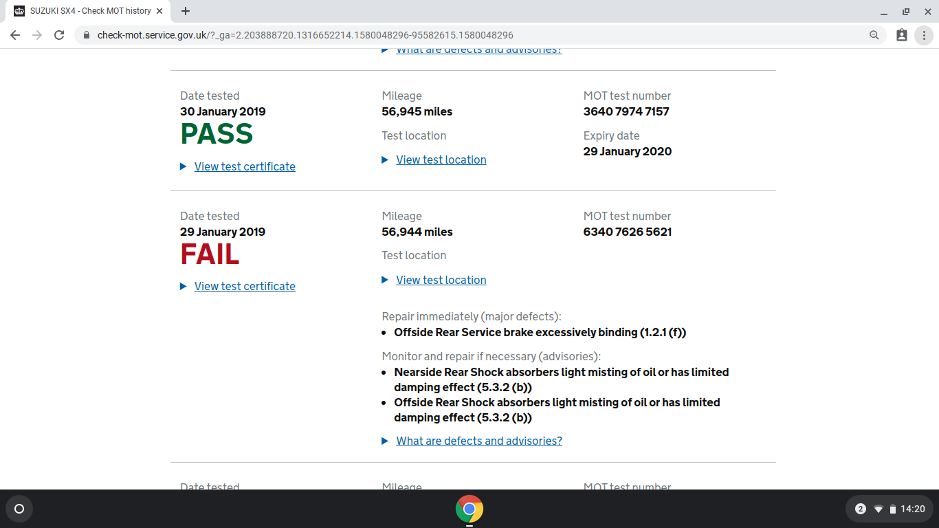

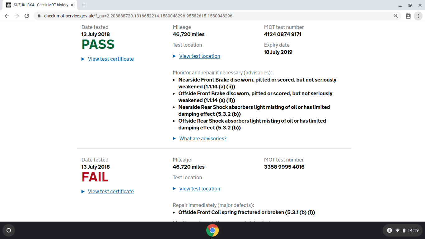

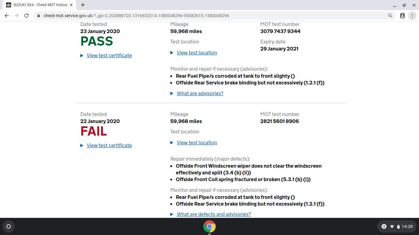

OT,  but i had a car in for a Service plan service and MOT with ARNOLD CLARK this week.
It drove just fine and 18 months ago failed on a 'fractured or broken front spring', passed a retest the same day.
then passed a MOT 12 months ago. I bought it just after it was MOT'd last year.
New Discs and Pads on last year before i bought the car.
They do a service this year and advise a brake fluid change. Service does not include dealing with binding brakes.
And they can not test the brake fluid, they have no tester....
This time failed on a broken spring.  Same side and position.

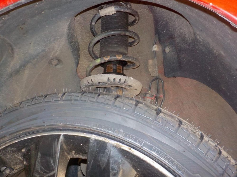

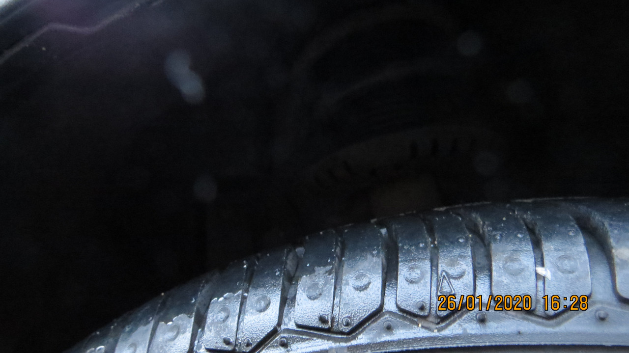

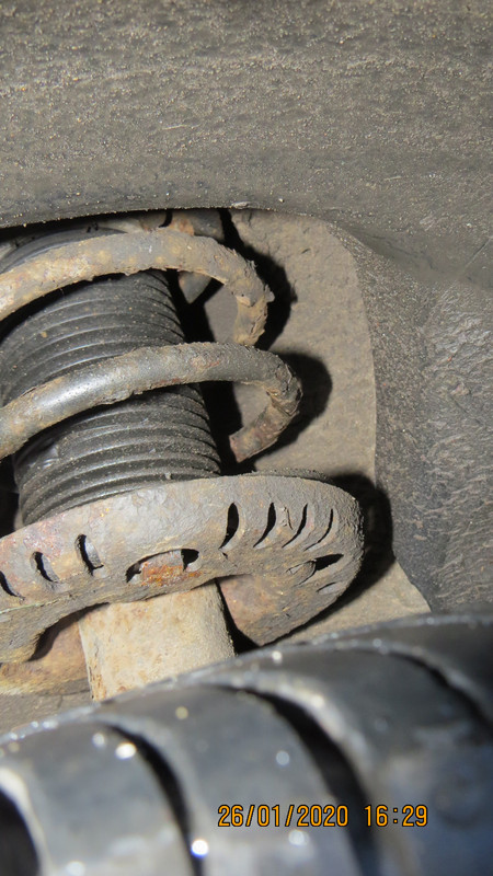

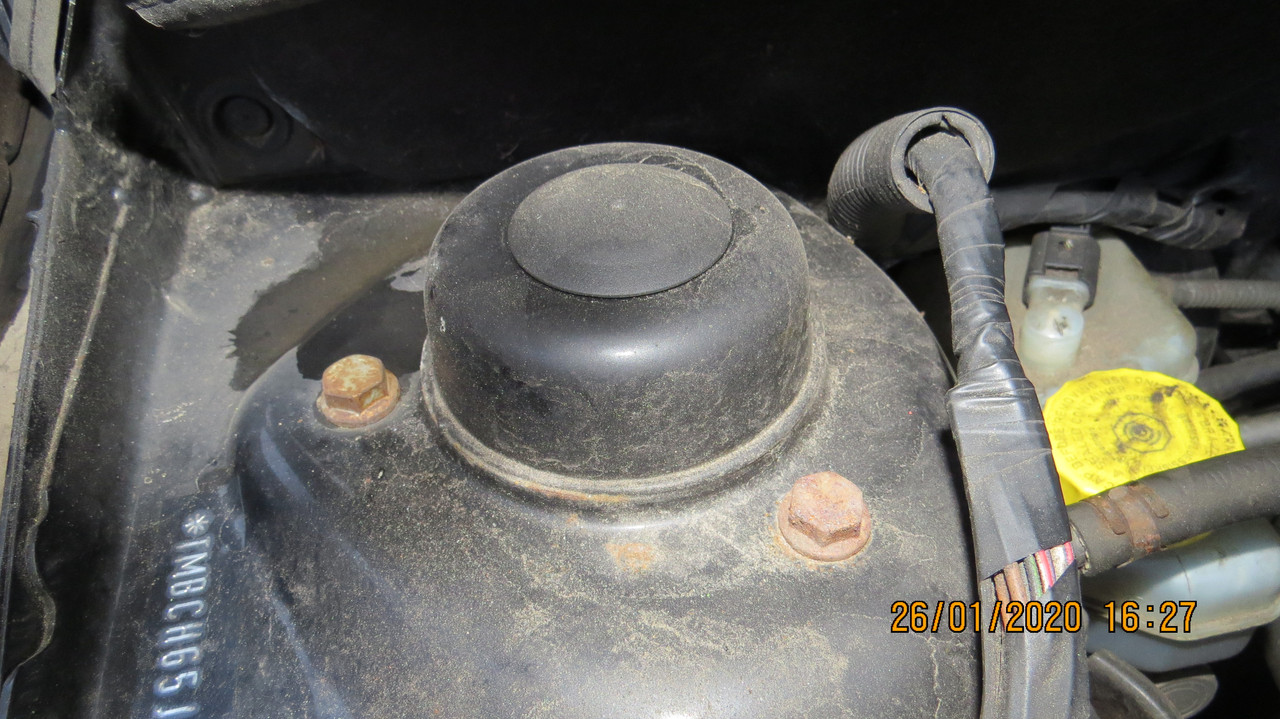

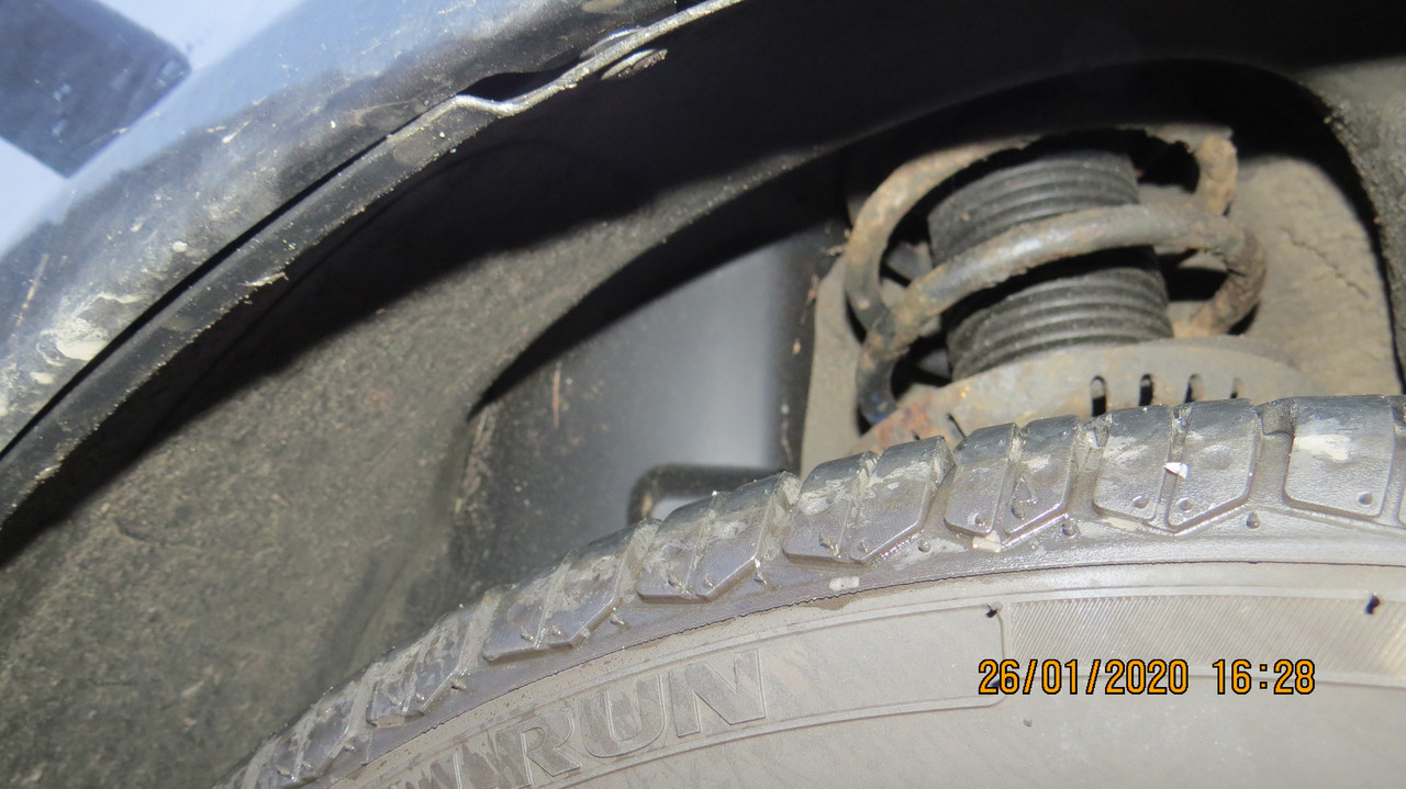

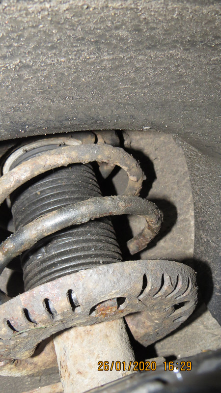

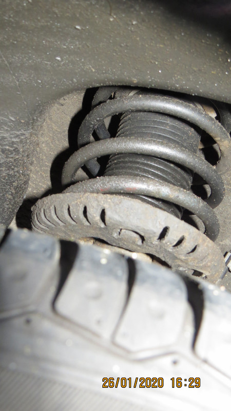

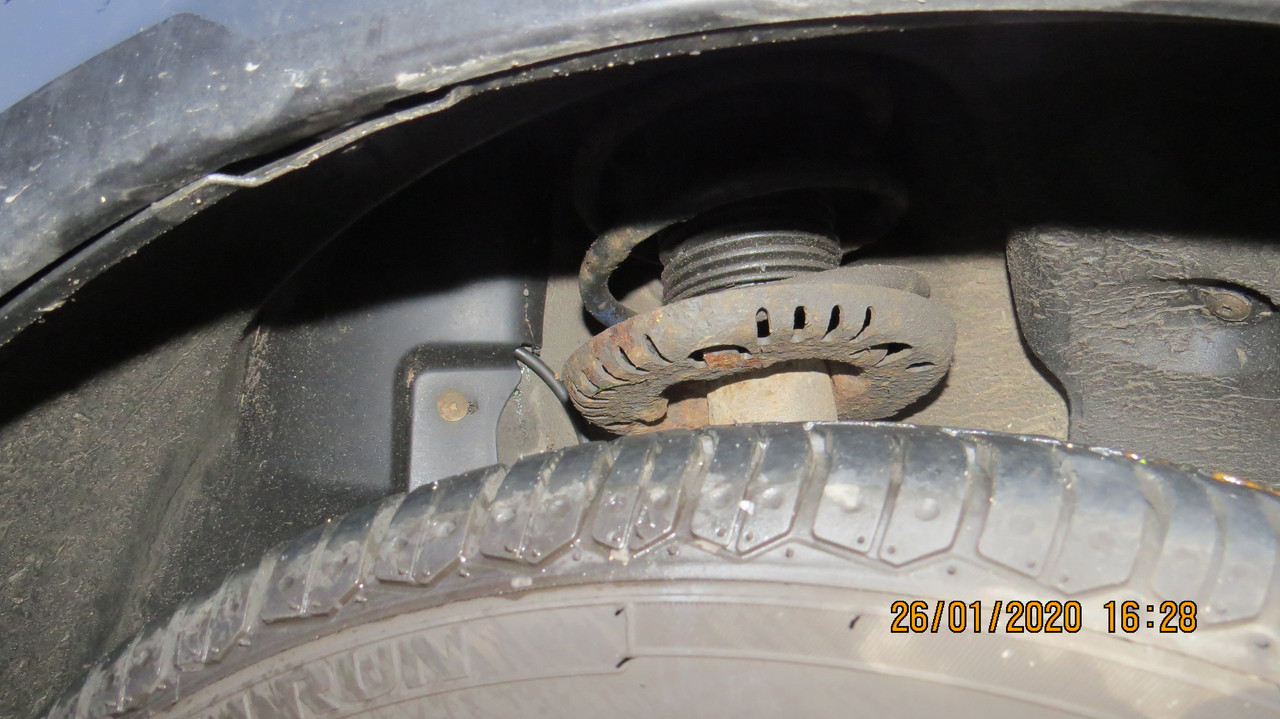

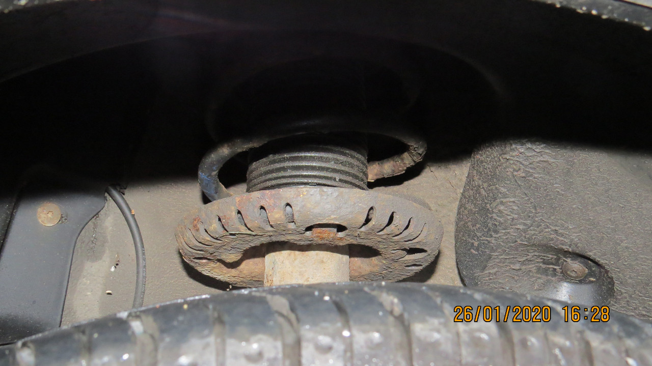

just going out to check the springs now.
took a few pics, couldnt see any broken part on my springs though
