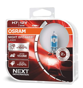

Exactly, there is no such thing in practice as an LED or plasma discharge unit that will give a proper beam in a halogen shell. Despite some people's claims, I'd recommend Osram Nightbreaker +(+) .

As mentioned the best option for her now is to try either the Philips X-treme or OSRAM Nightbreakers...
image.png.15077cb9caa1cb8c4b9c9cd09cc05cc6.pngimage.png.5dd4cf034443359462e5d8afcd84e1e3.png
They can be picked up on Amazon for around £20 per pair.

The problem with the Osram Nightbraker bulbs is they sacrifice output over longevity, it states something along those lines on the packaging.  I used them for about 3 or 4 years but reverted back to  normal bulbs as I was getting tired of replacing them every 12 months or so, normally late at night and when it was pouring down.  Up until I replaced a headlamp bulb last week, I cannot remember the last time I had replace one.
Another option is to check the headlights are aligned/set up correctly.  I was initially impressed with the light output on my vechicle compared to the car it replaced, however, that changed after I had a warranty repair carried out on the headlights.  After that it appeared to me the light output, and more importantly, range was severely diminished, hence using the Nightbreakers.  Practically every service after that  I asked them to check the lights were set up/aligned correctly and everytime I was told they were well within MoT tolerances. I recently took the car to a an indy for some other work to be carried out and asked if he could also have a look at the lights.  When I got the car back he said he had made a few adjustments, nothing major.  Whatever he did I felt there was a noticeable improvement to both output and range, I no longer felt I needed to use full beam on some of the local country roads which I used to have to do.
