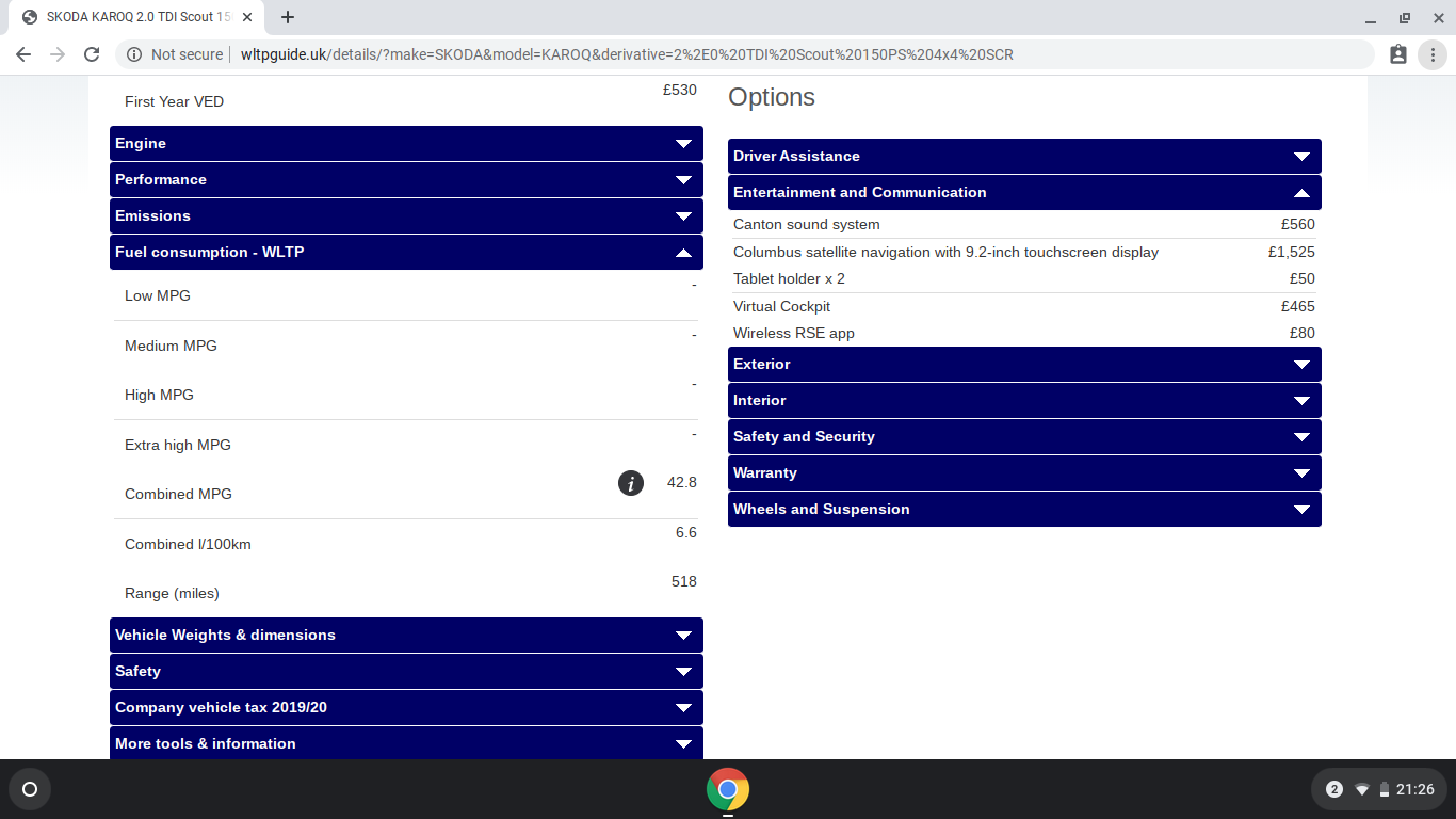

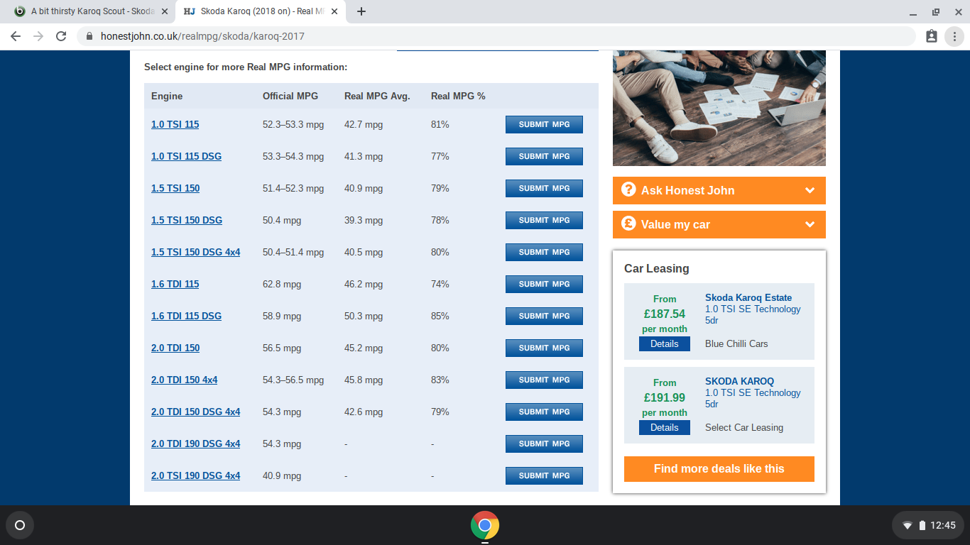

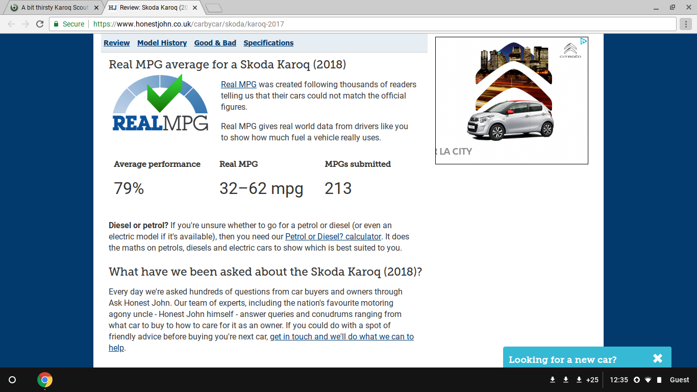

Root - Is there any particular reason you've published those figures from HJ ?
Yes.
The OP's thread and mention of HJ and 45.8.
So as well that anyone looks at what 45.8 appears against and is it a 2019 model.
Averages are achieved with lows and highs.  Somebody must log the lows.
If the OP logs their MPG figures that might well change the average, as if someone logs a very good mpg figure they are getting.

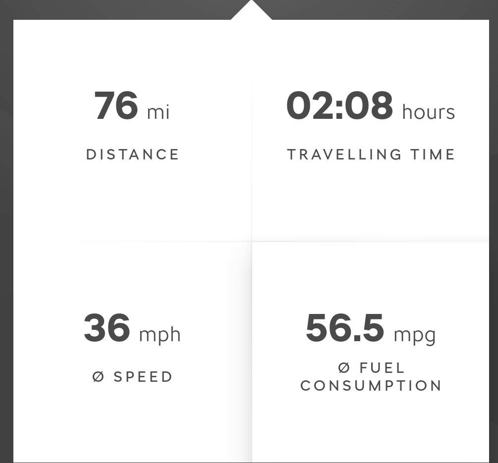

This my best consumption with my 2.0 TDI DSG. 26000 km so far.
