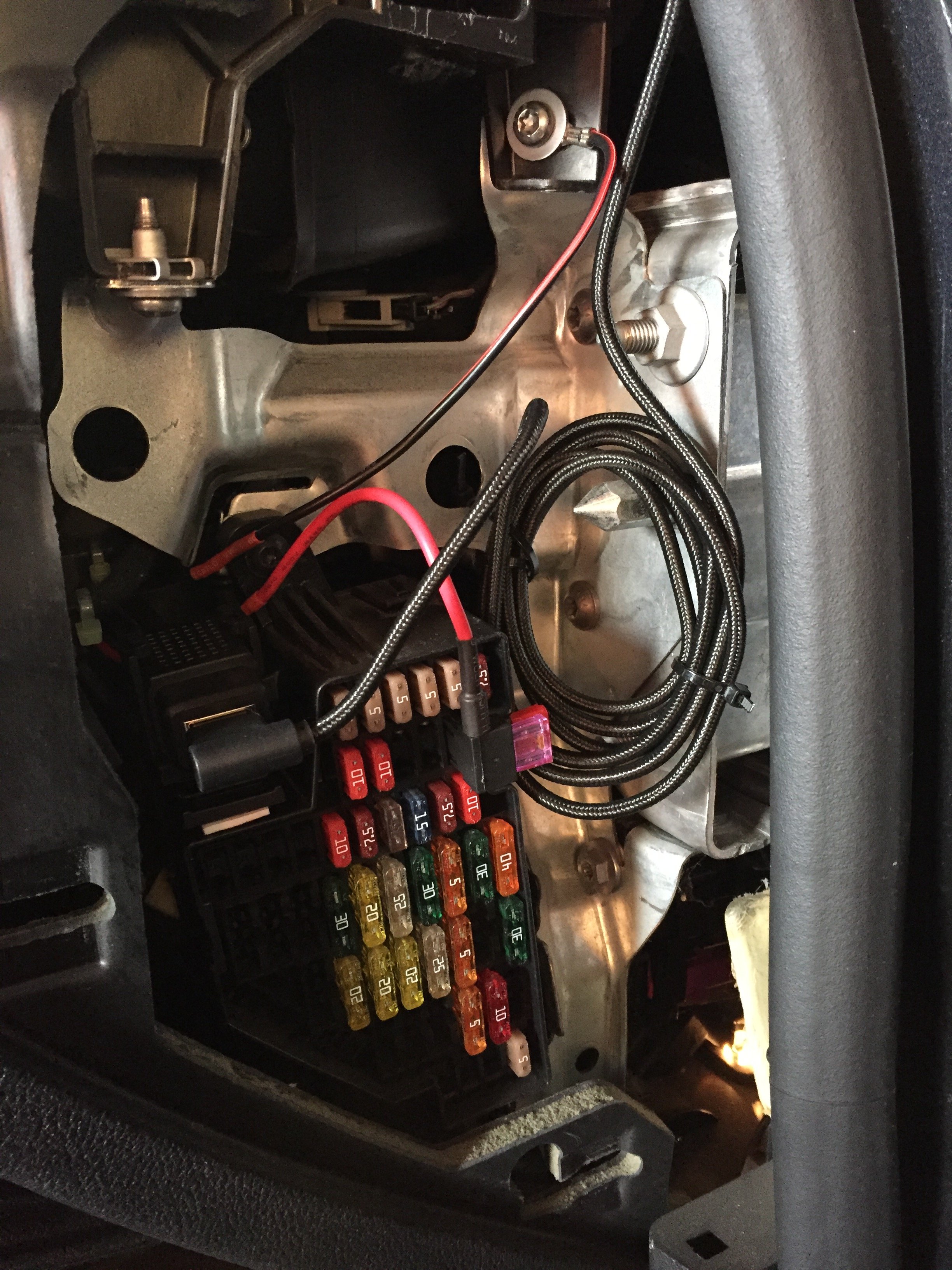

I've got a funny situation here trying to hard wire my dash cam. I have tried fuses that in theory should only be powered after ingintion is turned on eg. Heated seats, rear screen defrost and unless I'm doing something wrong the dash cam is charging all the time regardless if the ignition is on or not. Can anyone help? TIA
@Stefan_Siarzewski - use a multimeter to find an appropriate fuse?
Believe me or not that's  what I did. None of the fuses is showing any voltage. Tried battery terminals to make sure multimeter is ok. They are all ok for continuity but can't measure any voltage either with ignition on or off. Tried plugging the dash cam tap and every single fuse I tap into powers the dashcam even with ignition off. I feel extremely dumb. I must have missed something very simple...
Which fuse terminal are you using with the multimeter? The top terminal of the two is the battery side and the bottom one is the load side. When checking the voltage, put one probe on the upper fuse terminal and the other on the metal frame the fusebox is attached to (it's a good ground).
Is the multimeter in DC voltage mode, the correct range and the leads in the correct sockets?
If it's not showing any voltage when you put the multimeter across the car battery, that suggests the multimeter is either broken or not in the right mode.
hi,
@Stefan_Siarzewski if you are in Andover Hampshire give me a PM and I will be happy to assist 🙂
John
Hi all and thanks for help and suggestions. I have successfully fitted and hardwired the dash cam. My multimeter was fine and @chimaera was right. I was dumb enough to measure the fuses on wrong terminals 🤭. Also my dash cam settings caused a little confusion. jjc thank you kindly for your offer 👍🏻.
