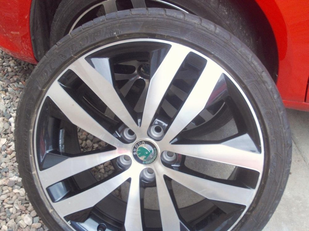

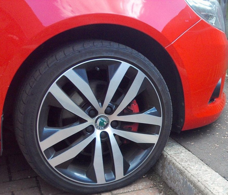

215/45 R 16  is not really 'Low Profile'.
 The Sport Maxx on a Mk2 Fabia Monte Carlo or vRS were 205/ 40 R 17 ZR and were 'low profile.
They could wear quickly and are rather different.   Also mis-shape easily, get sidewall damage as well.
When reading reviews you need to be looking at the same and not just similar.

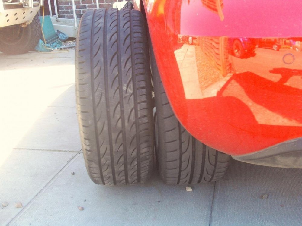

on the car here are Dunlop Sport Maxx in 205/40 R 17 which on the front could wear quite quick but had good grip in the summer and so so in the wet, cold.
next to are the Pirelli Zero Nero in the same size that Skoda used to fit when owners had Pulling to the left and the Dealership could not fix.
They had stronger sidewalls but also a different compound and lasted longer but were and are crap and have the TC light flash more often in damp / wet roads.
Bottom pics. 205/40 R 17 Dunlop Sport Maxx as was Standard fit on the Mk2's with 17" wheels.
post-86161-0-97650900-1459325208.jpg.ca44cbf95b8c6919857988bc80fd0956.jpg.52d030a2d61a00f64893a423592c15d3.jpg
