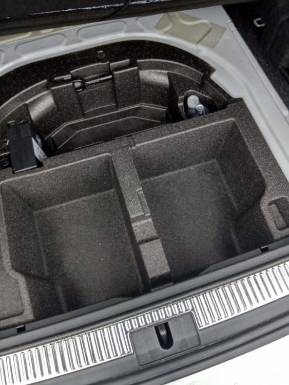

I've just taken delivery of a 2019 Superb Estate and plan to replace the wheel repair kit with a spacesaver wheel. Does anyone have any advice for changing or modifying the plastic molding under the boot floor so that the spacesaver will fit ? Anyone had previous experience of this ? Any advice greatly appreciated.

Can anyone who has a Superb Estate with a spacesaver spare take a photo of the spare wheel well, please, so that I can see what sort of moulding is actually supposed to be in there ?

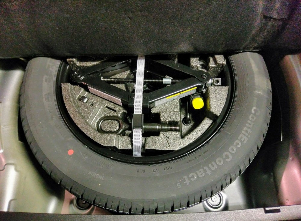

I bought a 125/70/18 space saver as told that’s what’s fitted by Skoda and it fills the space,Sry I can’t show you a pic as ..well had a pothole blowout and had to use the spare as sidewall split.
The moulding for the jack and tools comes with a plastic screw fixing that clips into the wheel base to secure the wheel in place.
This is how it looks like in mine.
It has a 16" not-skinny spare tyre.

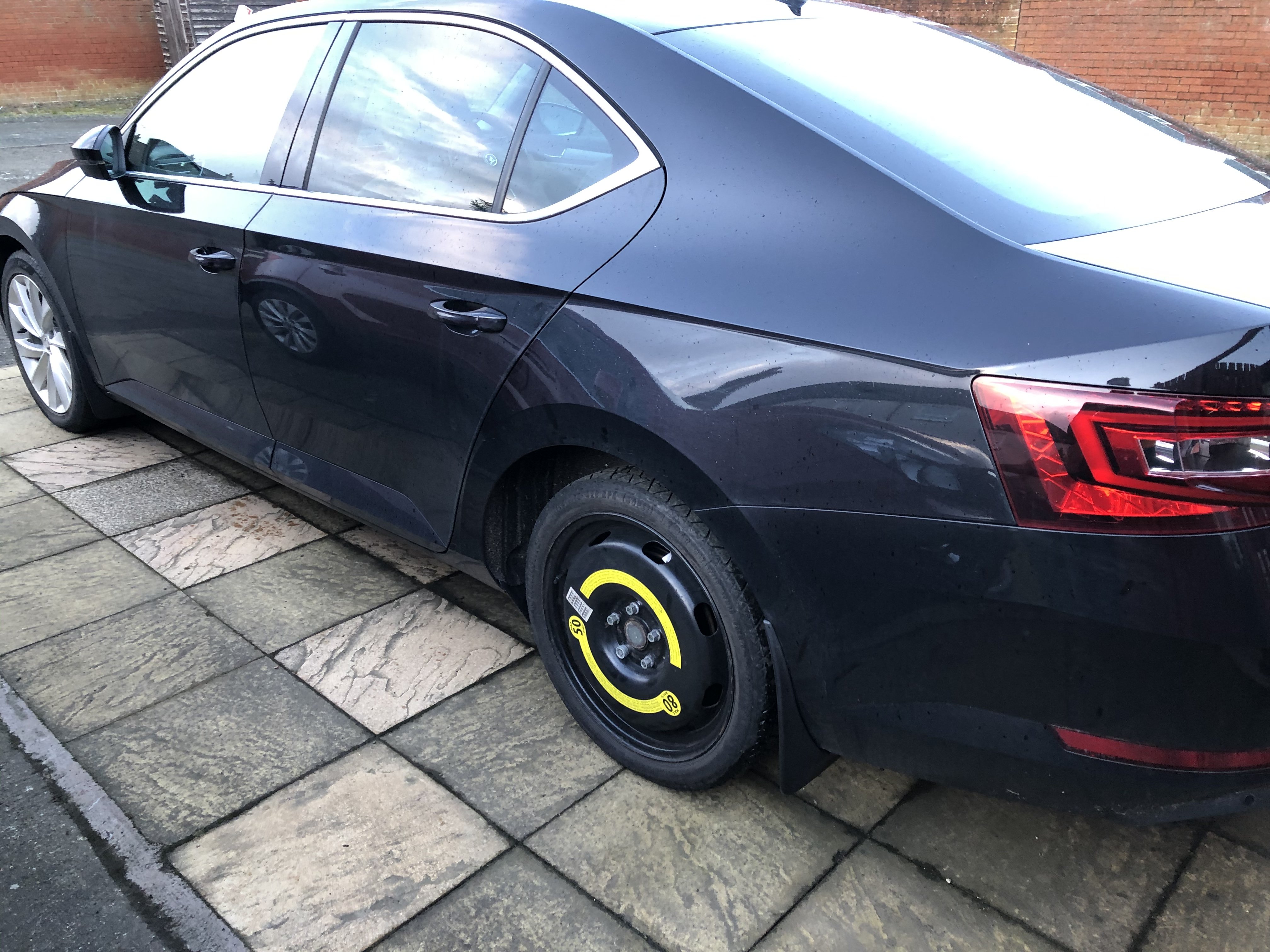

I never put my spare tyre on the front.
If it's my front that's flat, I put the good rear one at the front, and place the spare on the rear, as shown in the pic.
I wouldn't put two different sized tyres on my front driving wheels.

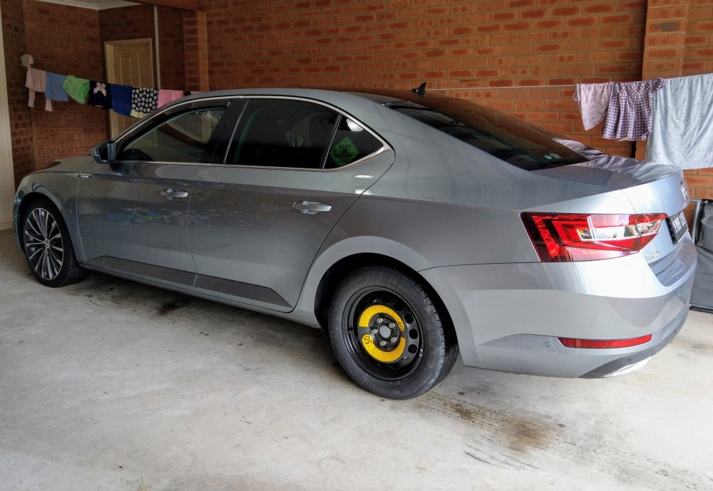

the 162kW (220) comes with the normal 205/55/16 spare tyre, if specc'ed (its standard fitment here in Oz).
the 206kW (280) comes with the skinny bicycle 17" spare tyre, again, if specc'ed.  two reasons for that, 1) AWD system compromises boot floor; 2) the 280 has bigger brakes, hence the 16" spare won't cut it.
yup, mine has the 235/40/19s.

I have an L&K hatch which came with a foam insert and the spray can, compressor and so on. I took the whole thing out and replaced it with an 18-inch Pegasus alloy wearing a Michelin Pilot Alpin PA4 winter tyre, along with a Skoda jack in the boot-side compartment. I figured that a winter tyre would be a better all-year spare than a summer one. It was all very expensive indeed, but if I ever need it I will be very glad not to be stranded in what would almost certainly be the middle of nowhere!
It is a tight fit in the wheel well, and I had to remove the plastic trim strip from the rear end of the boot, snip away enough to let the tyre fit and then screw it back in - when you look at it, it's obvious where I mean. The wheel/tyre sits a bit proud of the boot floor but some old towels around it make up the difference so that the boot carpet sits near enough flat. Given that, in the event of a puncture where you have a space-saver spare, the full-sized damaged one has to go in the boot,  it's odd that Skoda didn't make the well deep enough   - just another example of "simply clever", I suppose.
