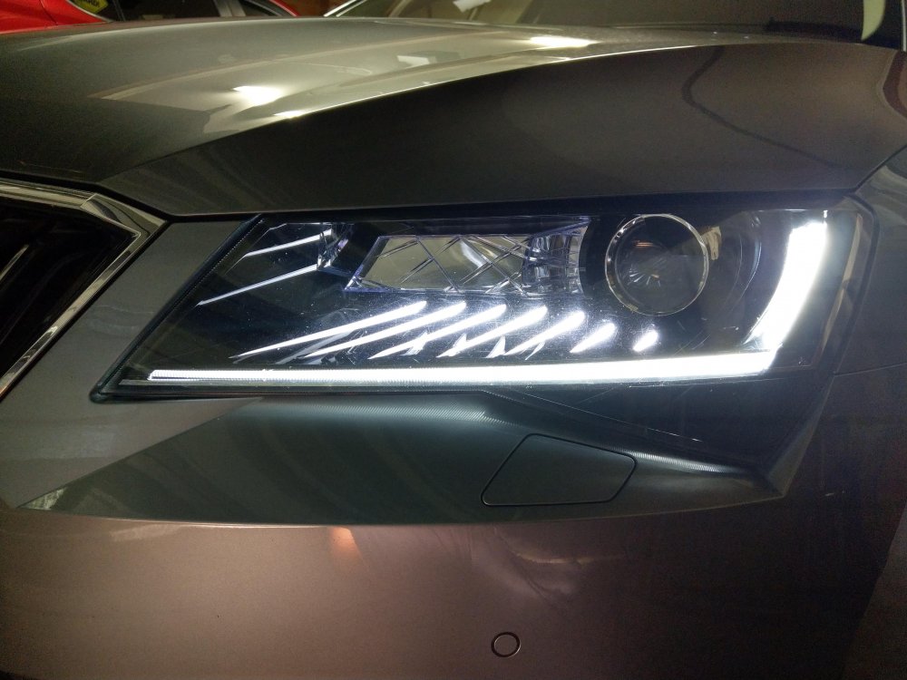

The eyelashes are the lights within the headlight that radiate from the rear for want of a better description.

This is wat SLA eyelashes look like.....

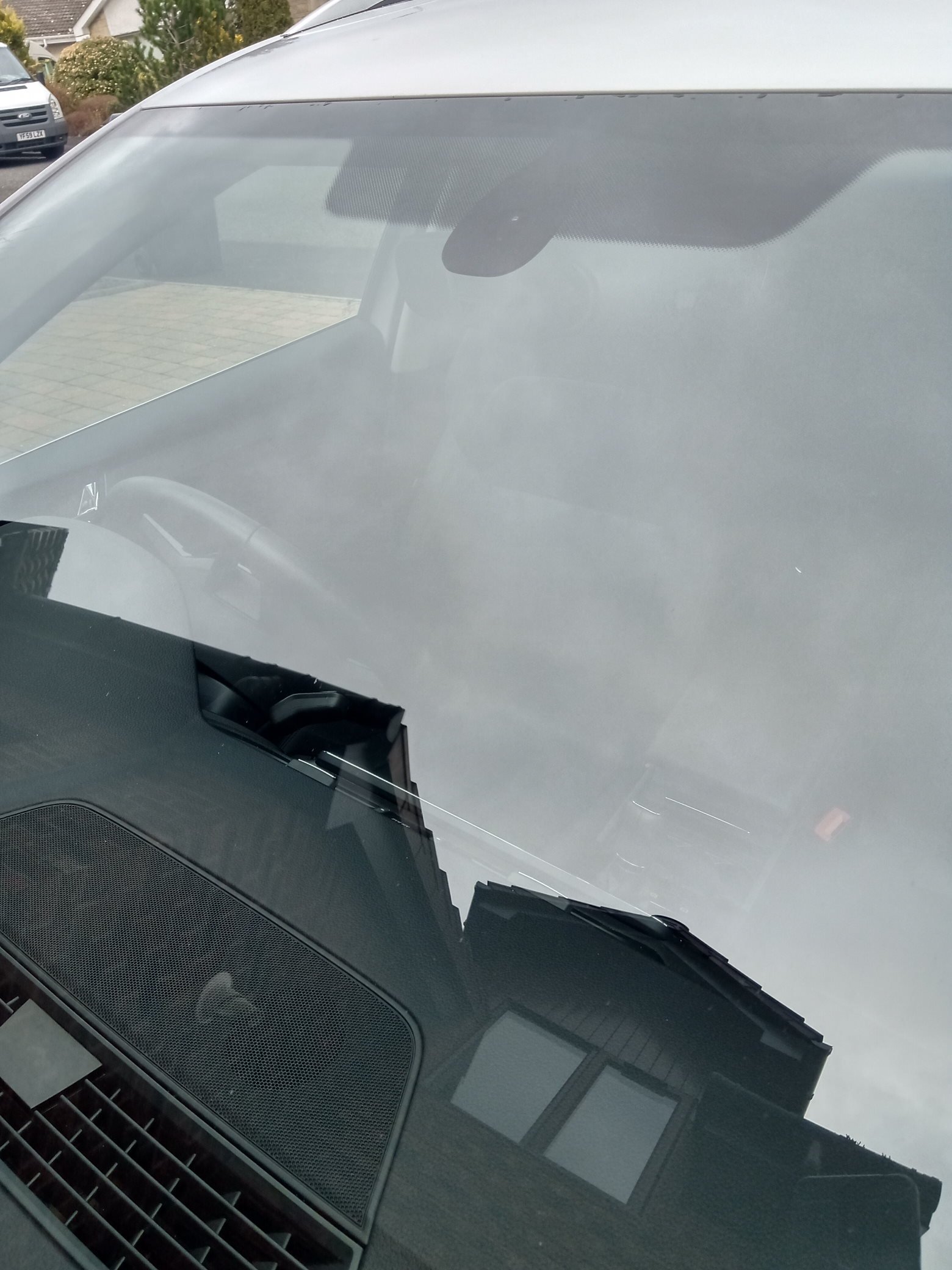

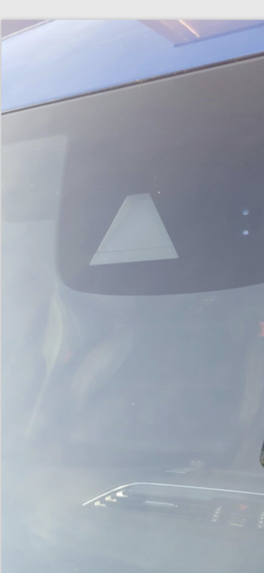

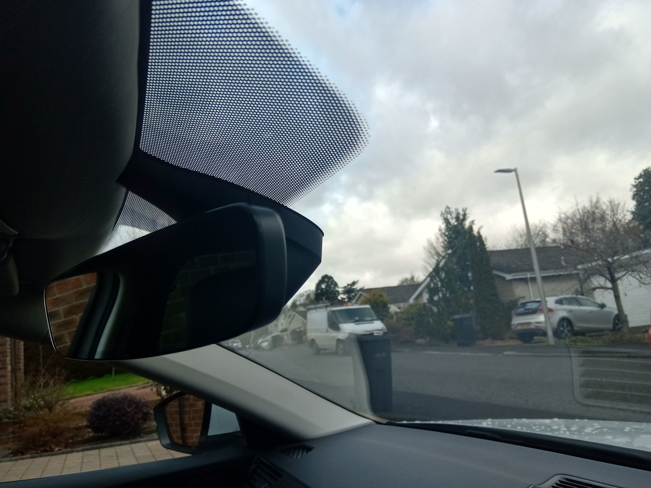

So I don't have the A5 camera (see photos)  which is fair enough.
Does that mean I don't have any "Light Assist" features or just a more basic one ?
AFAIK the A5 camera is needed with the expensive fancy SLA (Selective Light Assist) option.....which comes with the A5 camera! Not to be confused with AFS which is what my 2018 SEL has as standard. My SEL doesn't have HBA, it was an extra cost option. I wouldn't want it anyway, I also think the rain sensor is a waste of money. Wipers and lights are better under manual control IMO.
HBA just requires a camera of any type. Check your infotainment/maxidot menus for the HBA option, if it's greyed out it's not available without extra coding.

Both HBA and SLA use the same A5 camera - there is no "higher" version required for SLA headlights.
Based on the pics, @BOD20 does not have the required camera for HBA.
