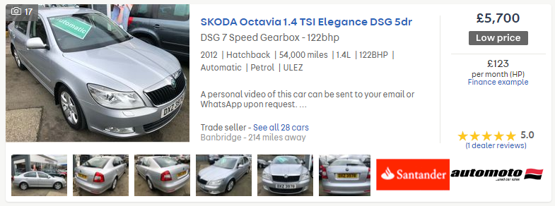

Here is a MkII facelift Octavia, 1.4 TSI, Elegance spec (more sparse than an equivalent Superb, but still well fairly well specced as standard), DSG too and low mileage...

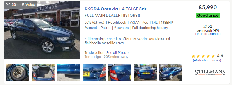

You can even get a MkIII if you prefer the looks...

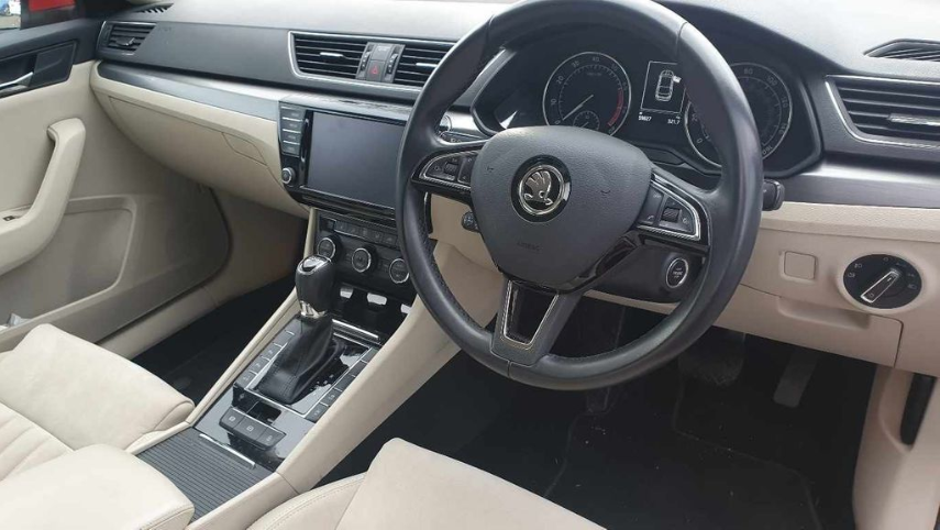

I'm not trying to put you off the Superb, I ran a MkII for 8 years and close to 200,000 miles, they really are fantastic cars, but I honestly believe your journey types and annual mileage is asking for trouble, especially on a well used diesel version.

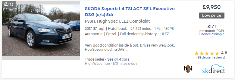

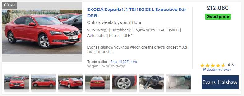

I'd be tempted to squeeze the budget by another £500 and go for the MkIII...
Thanks, I appreciate it.. Doesn't have the interior I want to be in, though 😉 As far as I can tell, cream leather means a II.

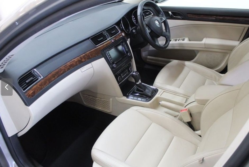

This is the cheapest petrol Superb I can find with the lighter interior...
Edited by silver1011
It's got the silver trim though.
