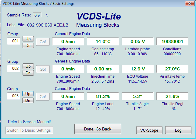

I got my hands on a ODB cable and VCDS-Lite, and hooked it up and did some tests.
- "Coolant temp" in group 001 went between 7º (cold) och 18º (warm)
     According to VCDS it should be between 85 - 110º
- "Air intake temp" i group 002 went between - 40º (cold) och 17º (warm) at a outside of 5º.
     According to VCDS it should be between 17 - 70º

During the first testrun I noticed that the temp gauge was higher than normal, so hooked up VCDS again and noticed that the "Air intake temp" was around 88 – 90º and the "Coolant temp" only had increased to 18º? The radiator fan did not run, and I guess that the ECU is a Magnet Marelli.
