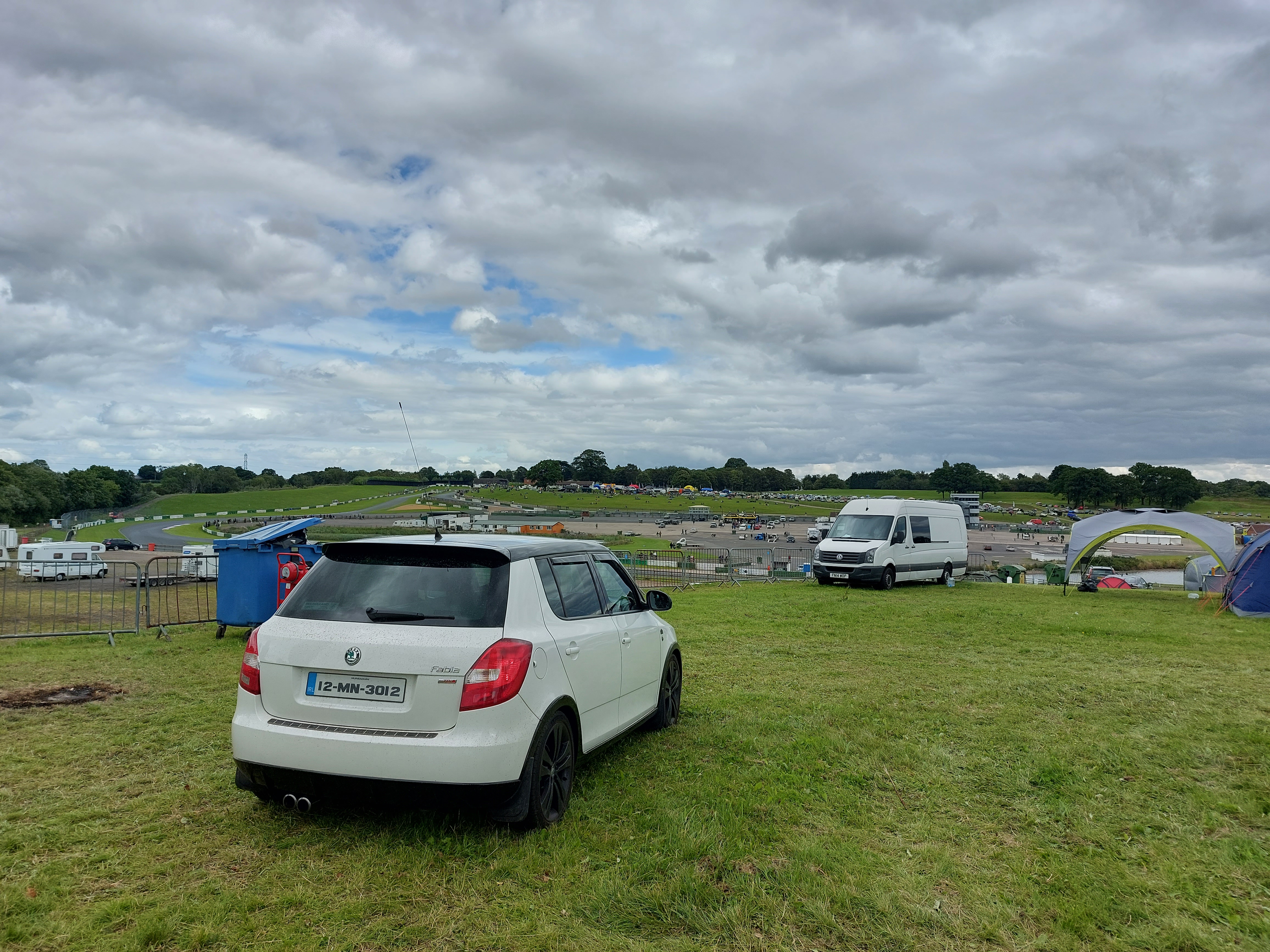

Having said all this you'll be surprised to hear that It's been back in England. Retrorides was on and it was the event I have been getting the justy ready for. The justy was running perfect right up until I left town, then it wasn't anymore. Limped it home, dumped the luggage into this and flew down to the ferry terminal, no checks, no prep to it just went.
Fair play to it, it didnt miss a beat. Made me feel a bit bad about neglecting it in favour of the justy.
Some interesting stuff there,
Not happy the justy failed but I still got there. And it was nice to be able to cruise at 70 and still get over 65mpg. Writing this on the ferry back so not done yet. Figure it'll have done just shy of 700 miles this weekend.
And even though I really have been trying to avoid driving it, for the time being I've been commuting in it. I'm temporarily doing a 50 mile a day commute, vs where I normally work being a 6 mile commute.

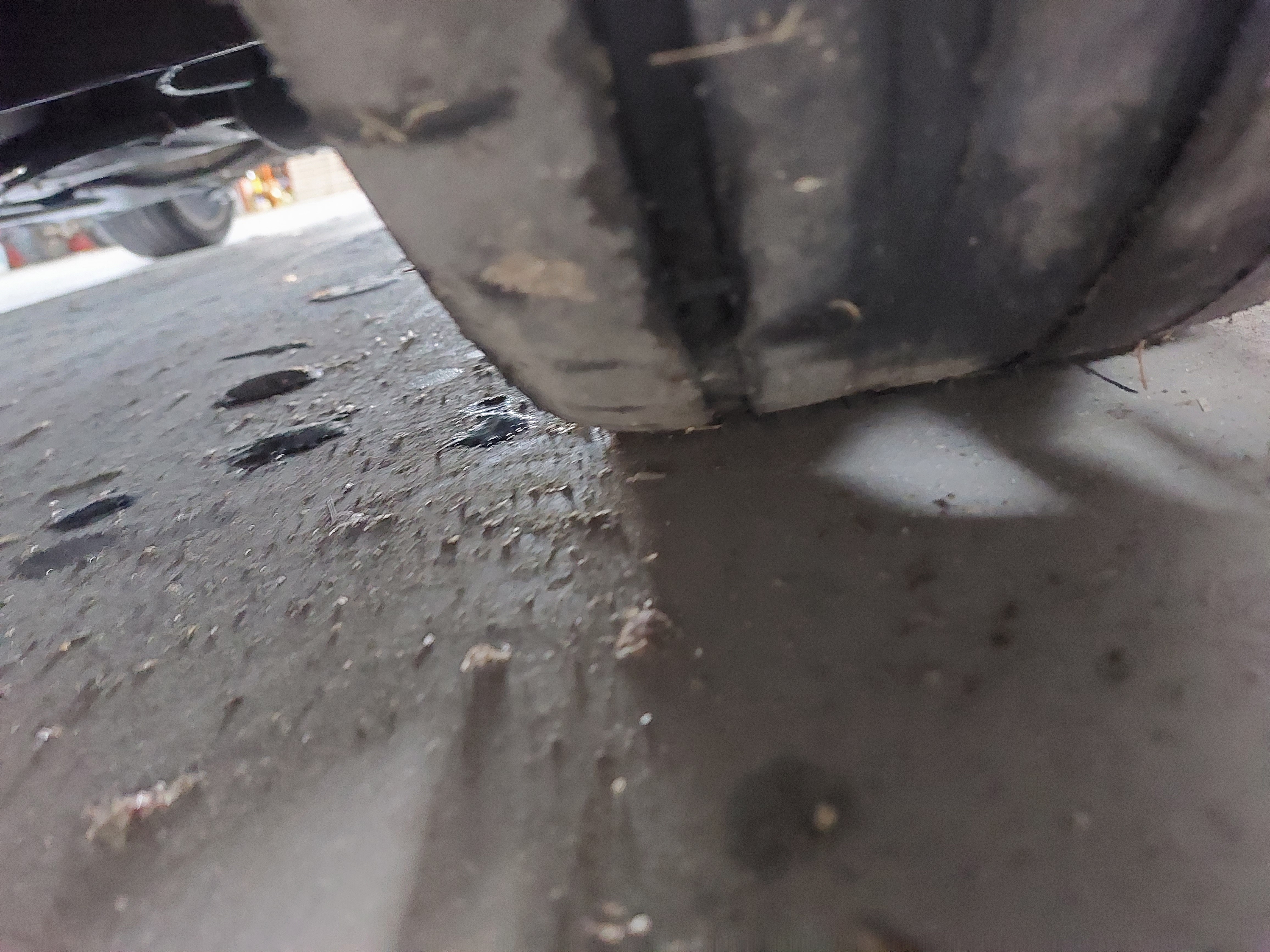

4 tyres ordered, won't be in to the 11th of next month. All my tyres are looking like this so I've put the winter wheels on it since.

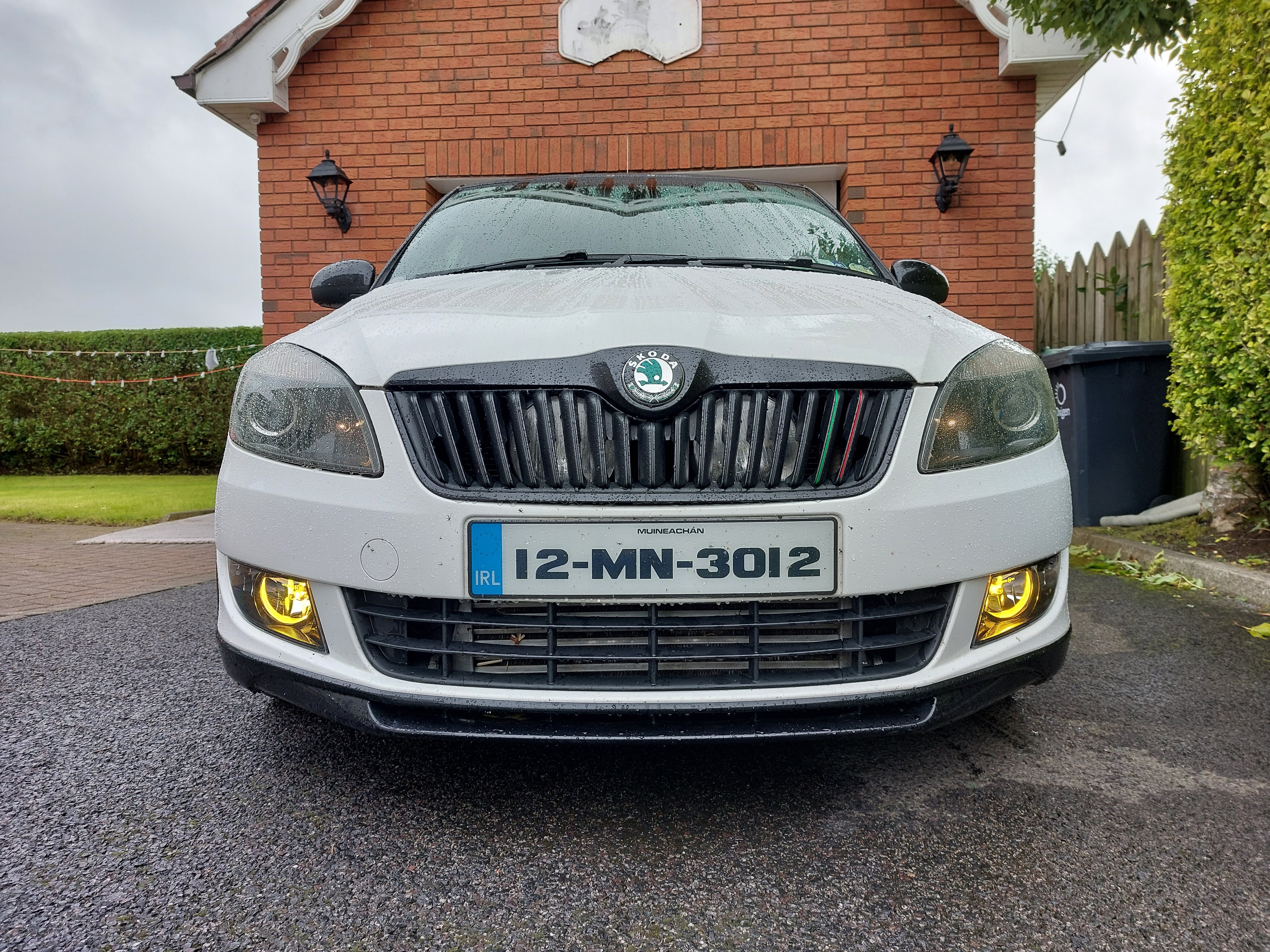

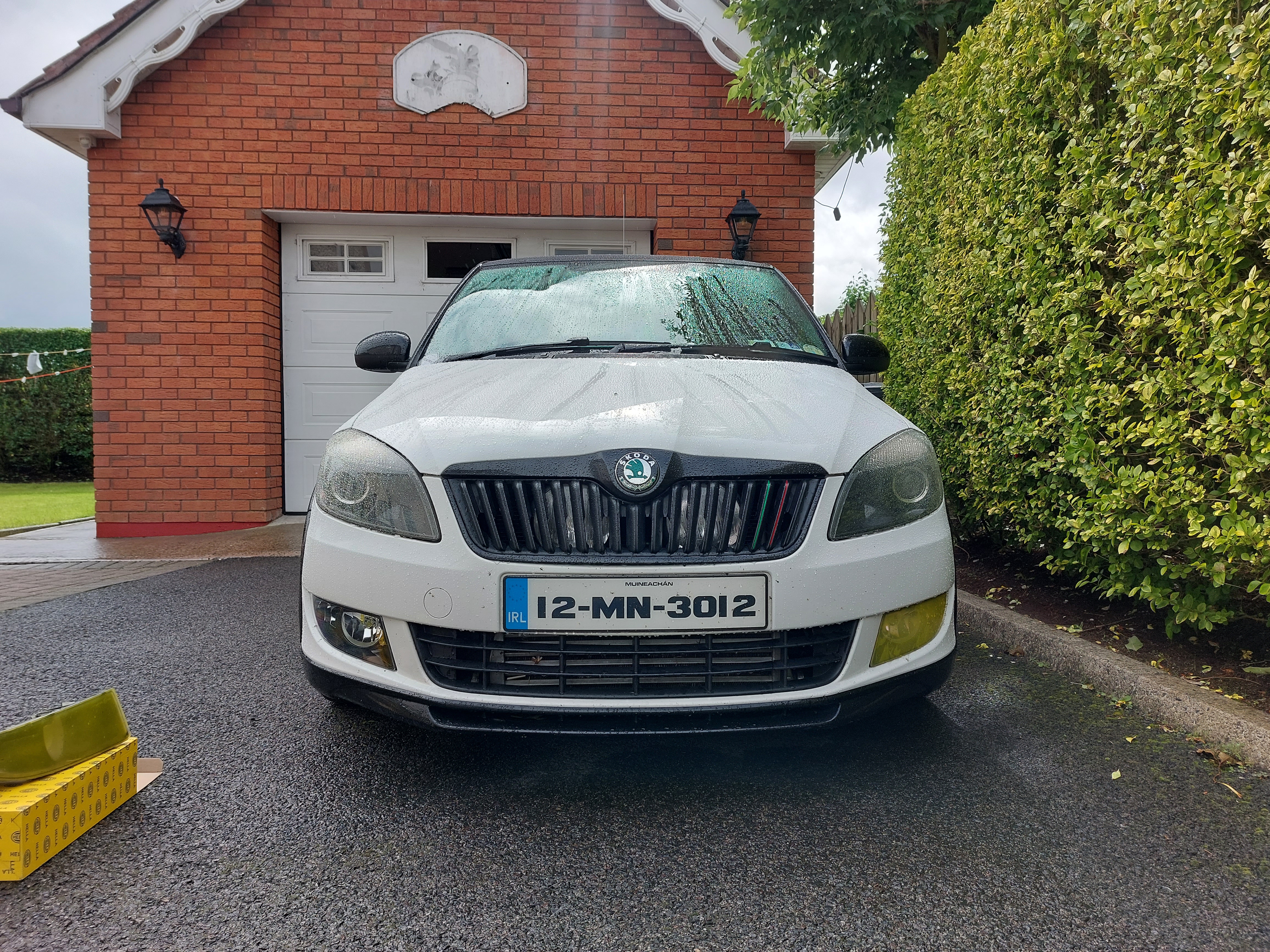

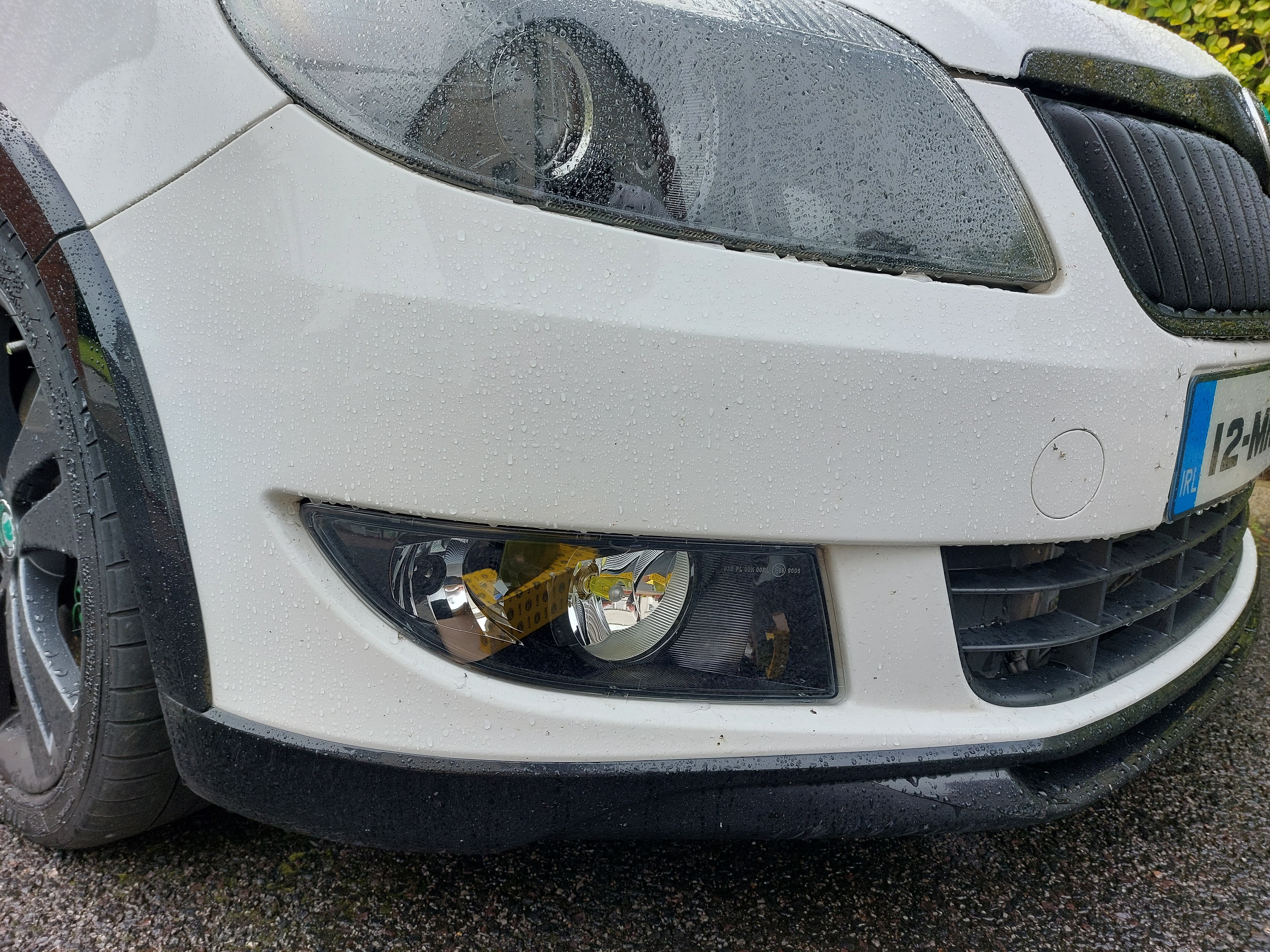

New fogs bought and fitted.
Hella ones £45 each. Have the oe numbers on them and all.
Will still probably tint them again.

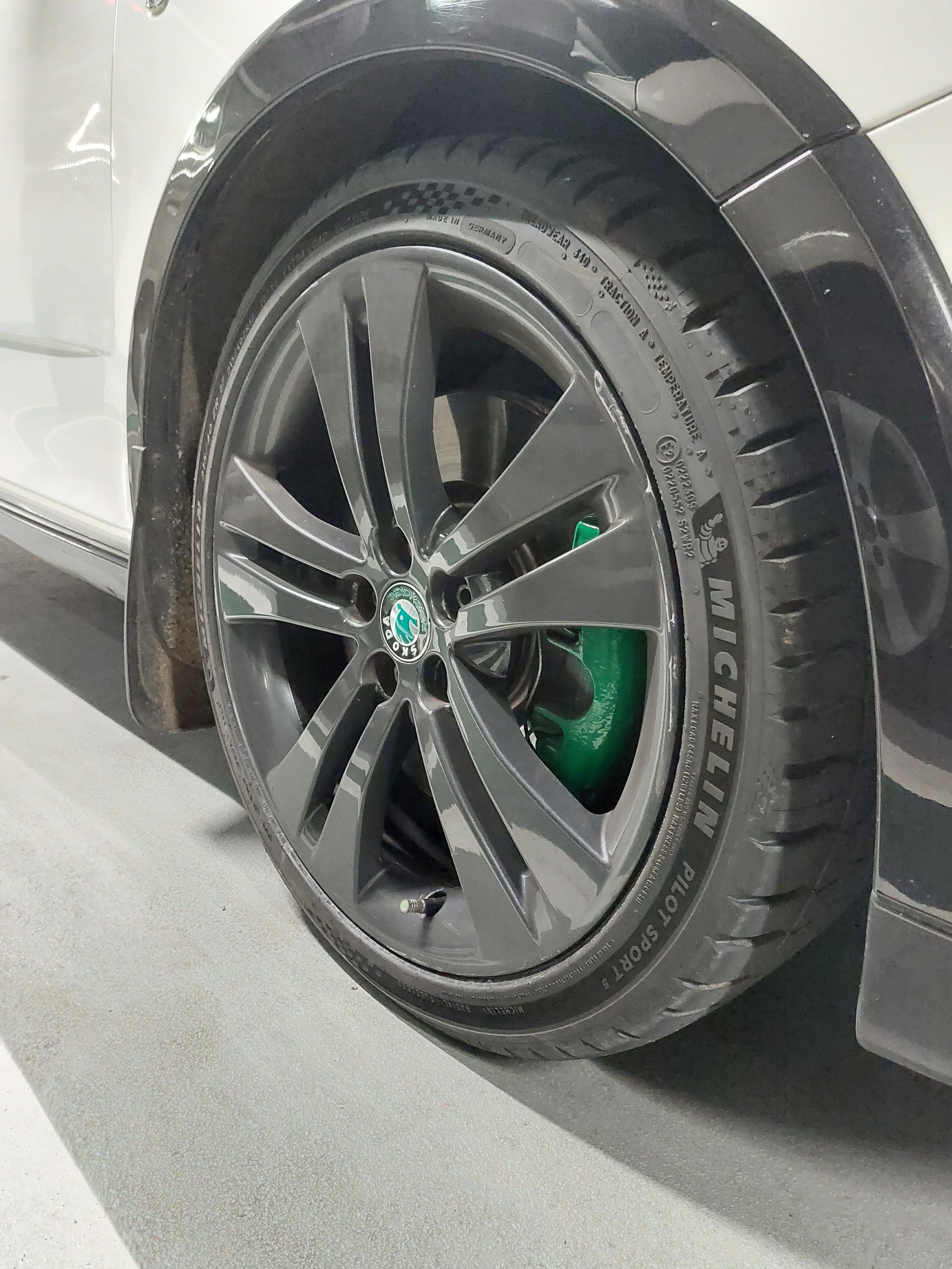

New tyre time.
4 new Pilot Sport 5's.
Like a new car again.

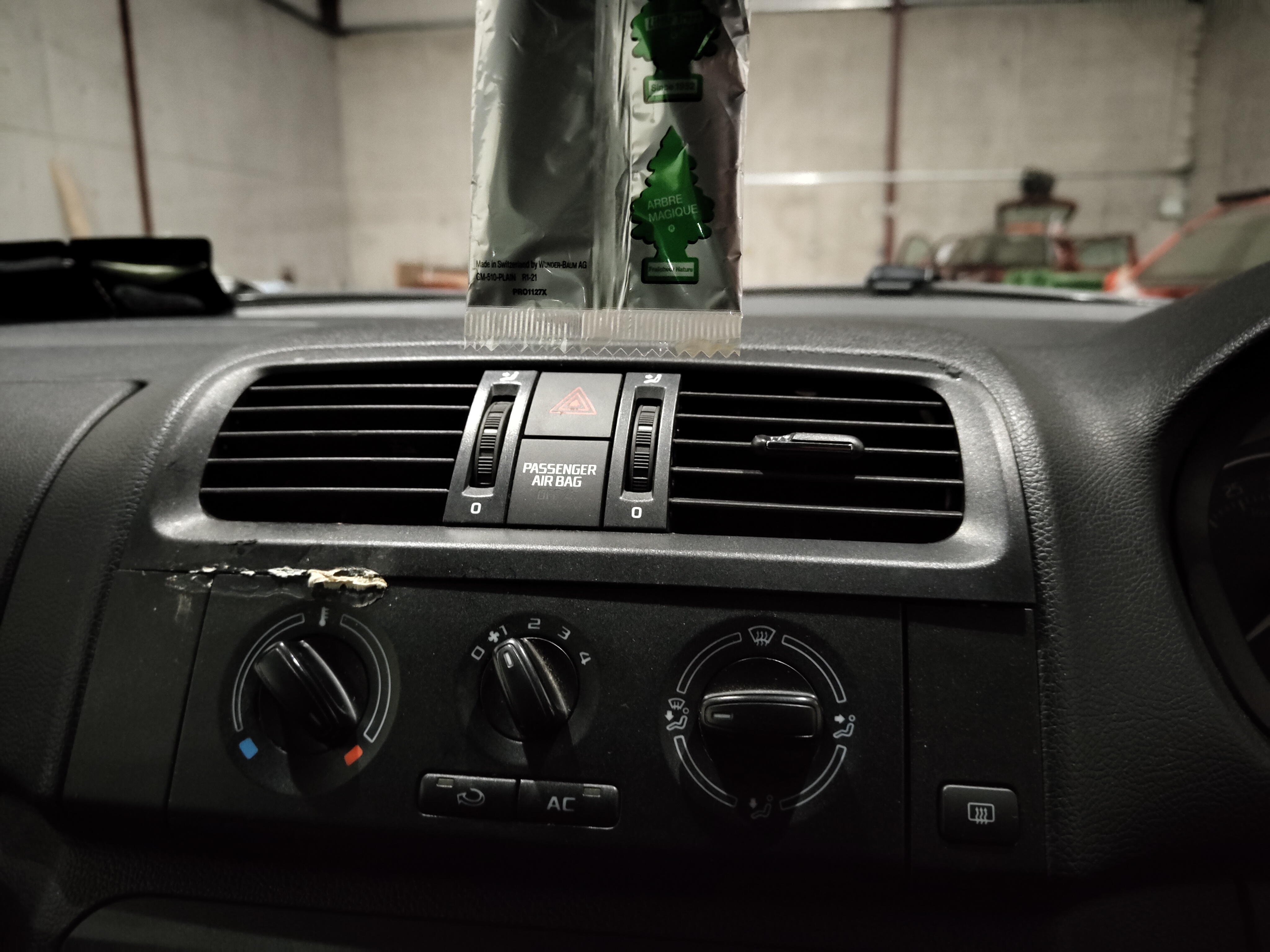

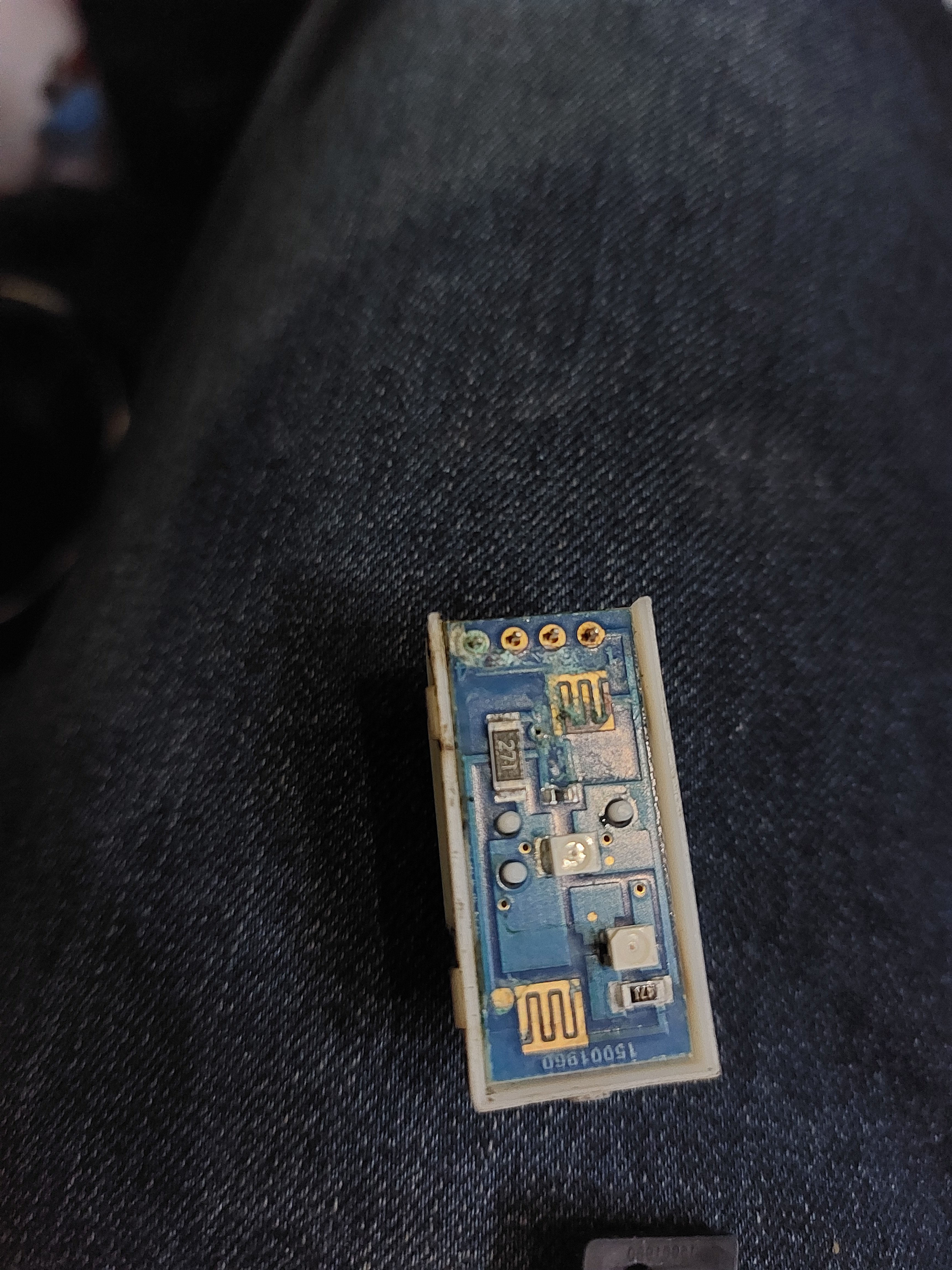

Then not long after the doors started locking and unlocking constantly.
So took the switch apart and found corrosion. Cleaned it up. Works fine now.

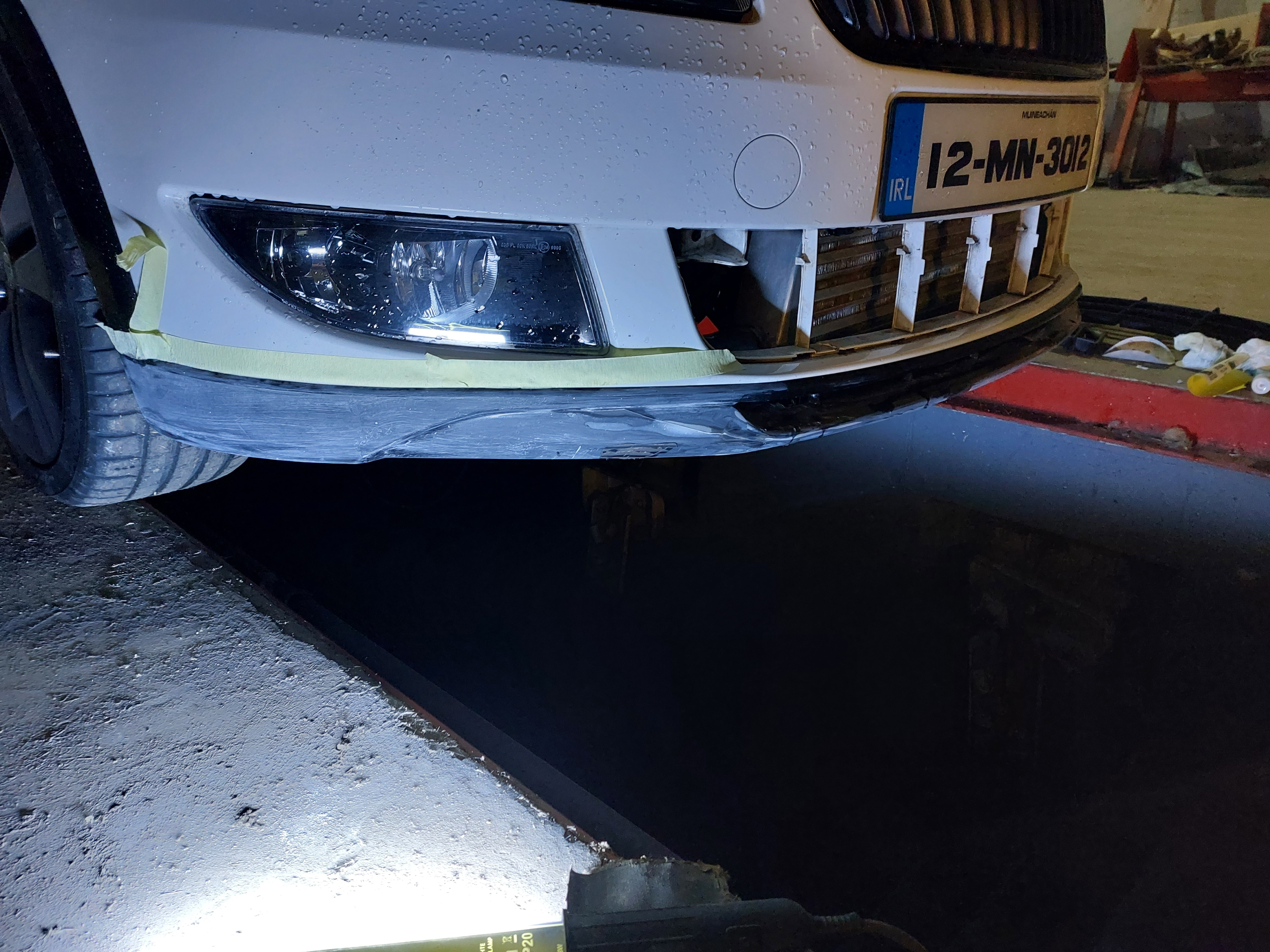

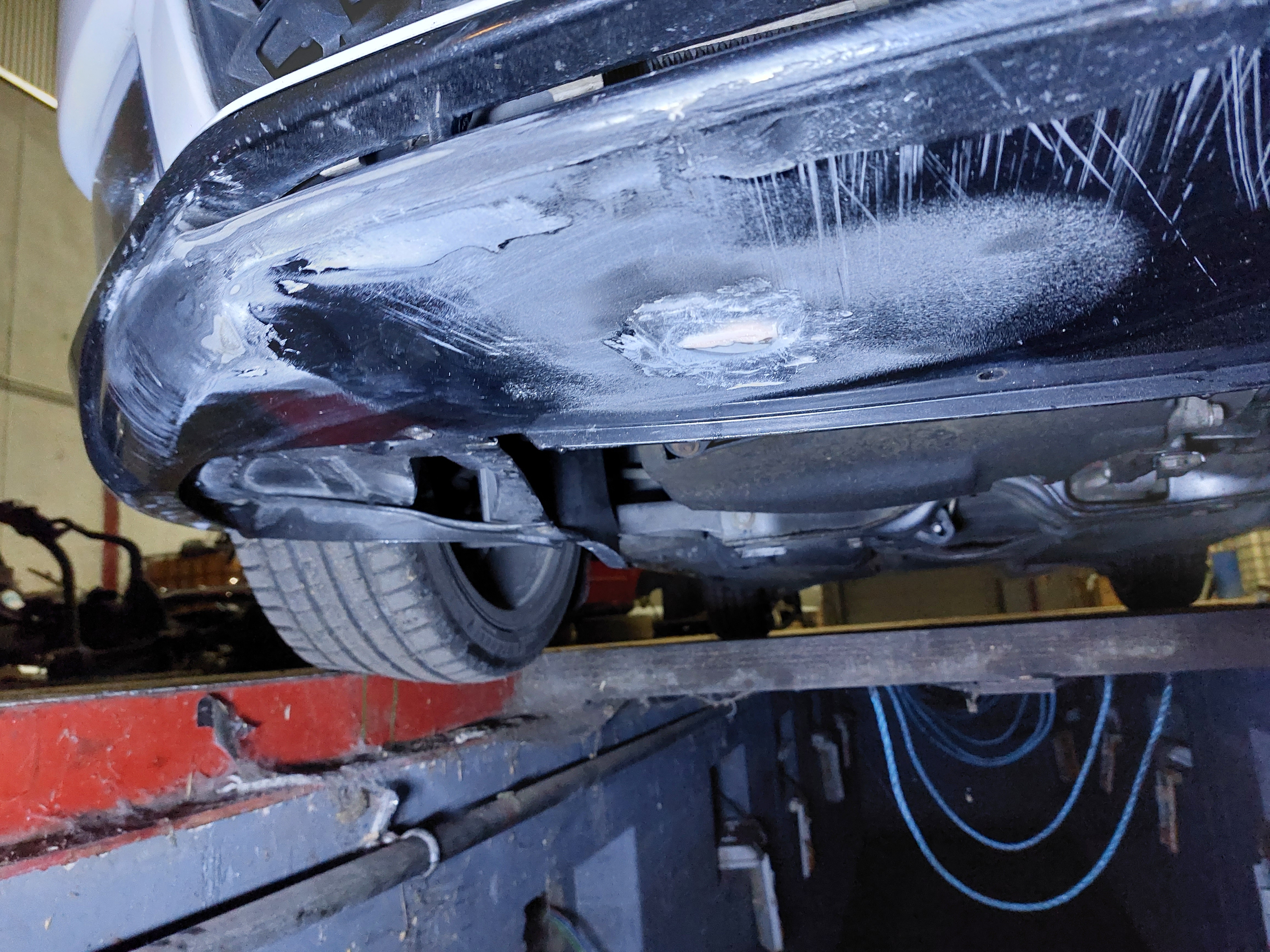

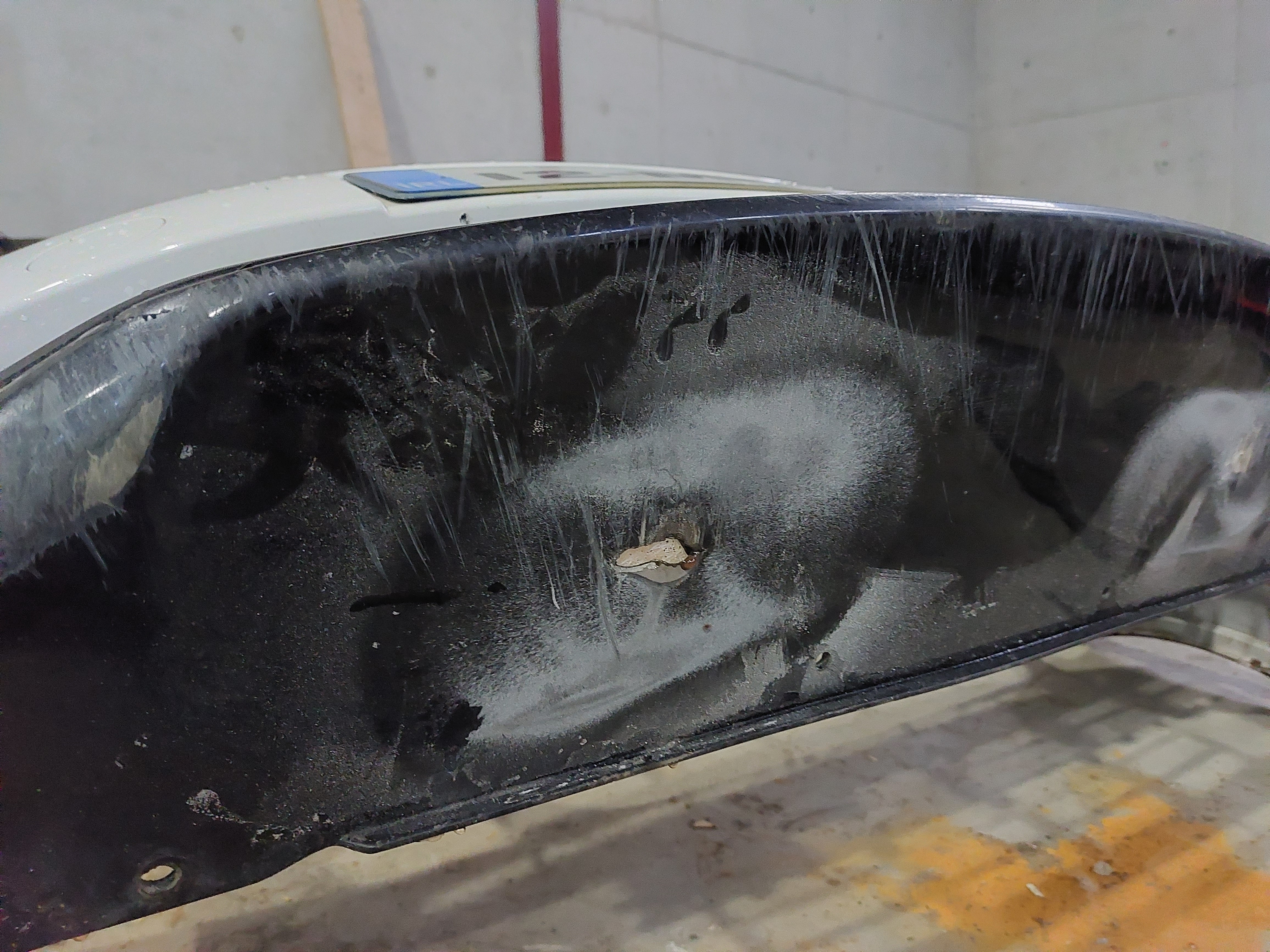

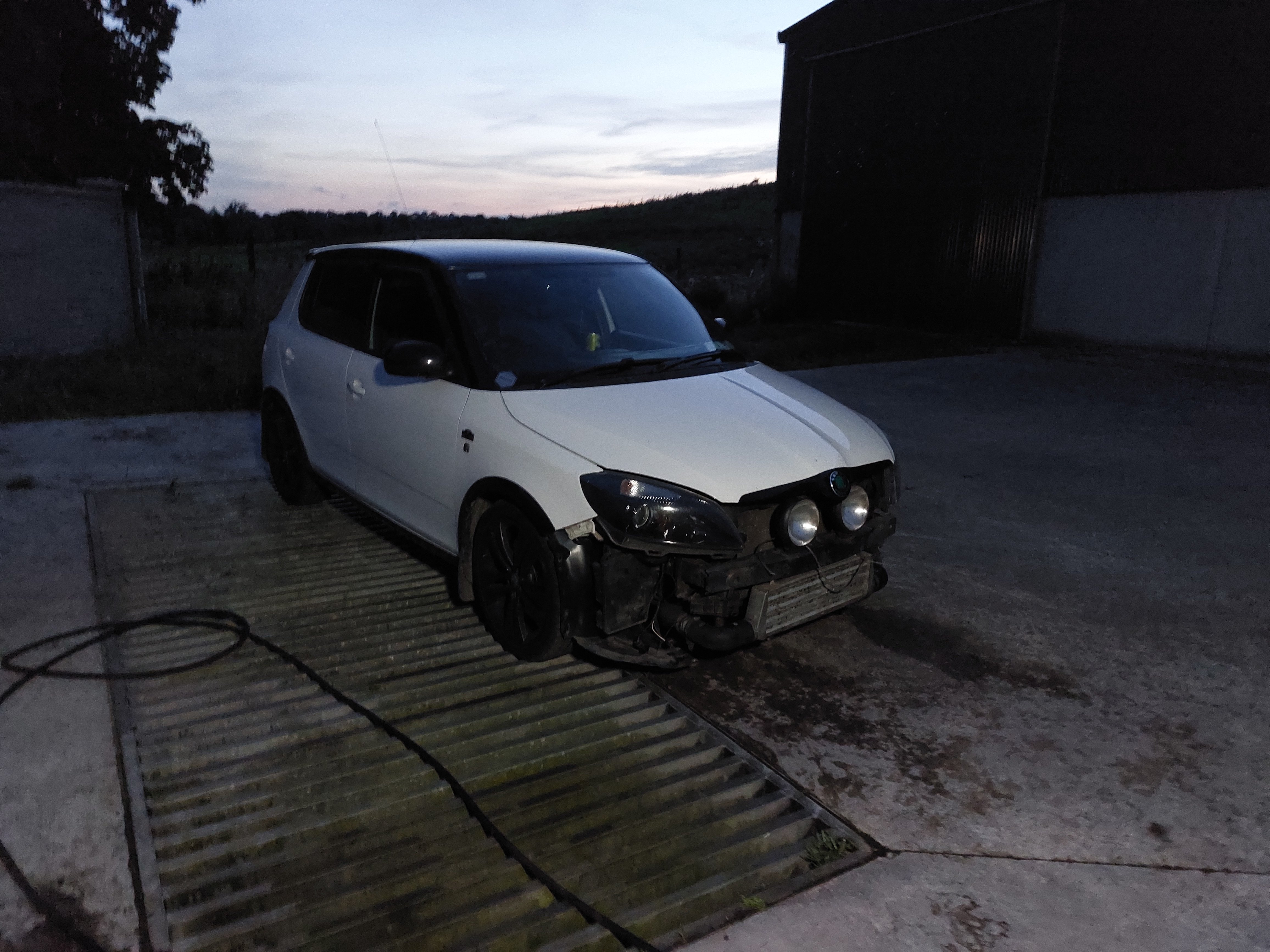

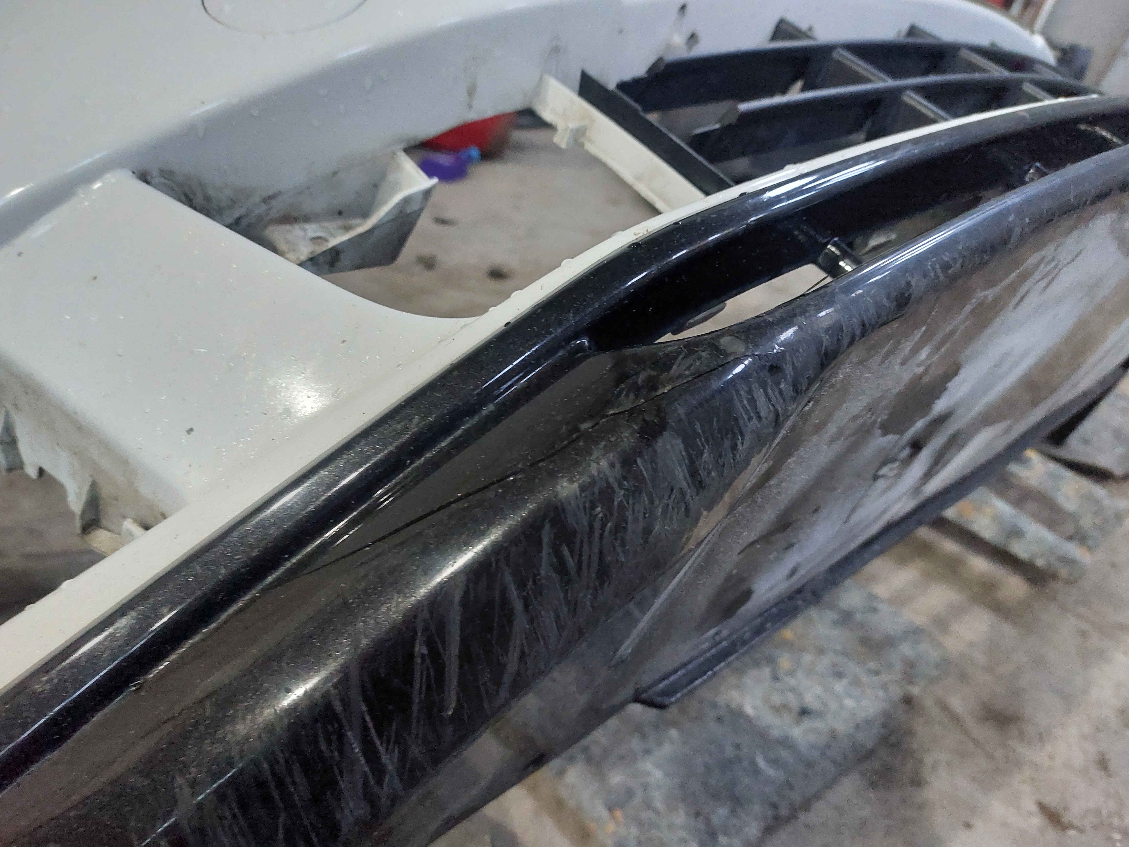

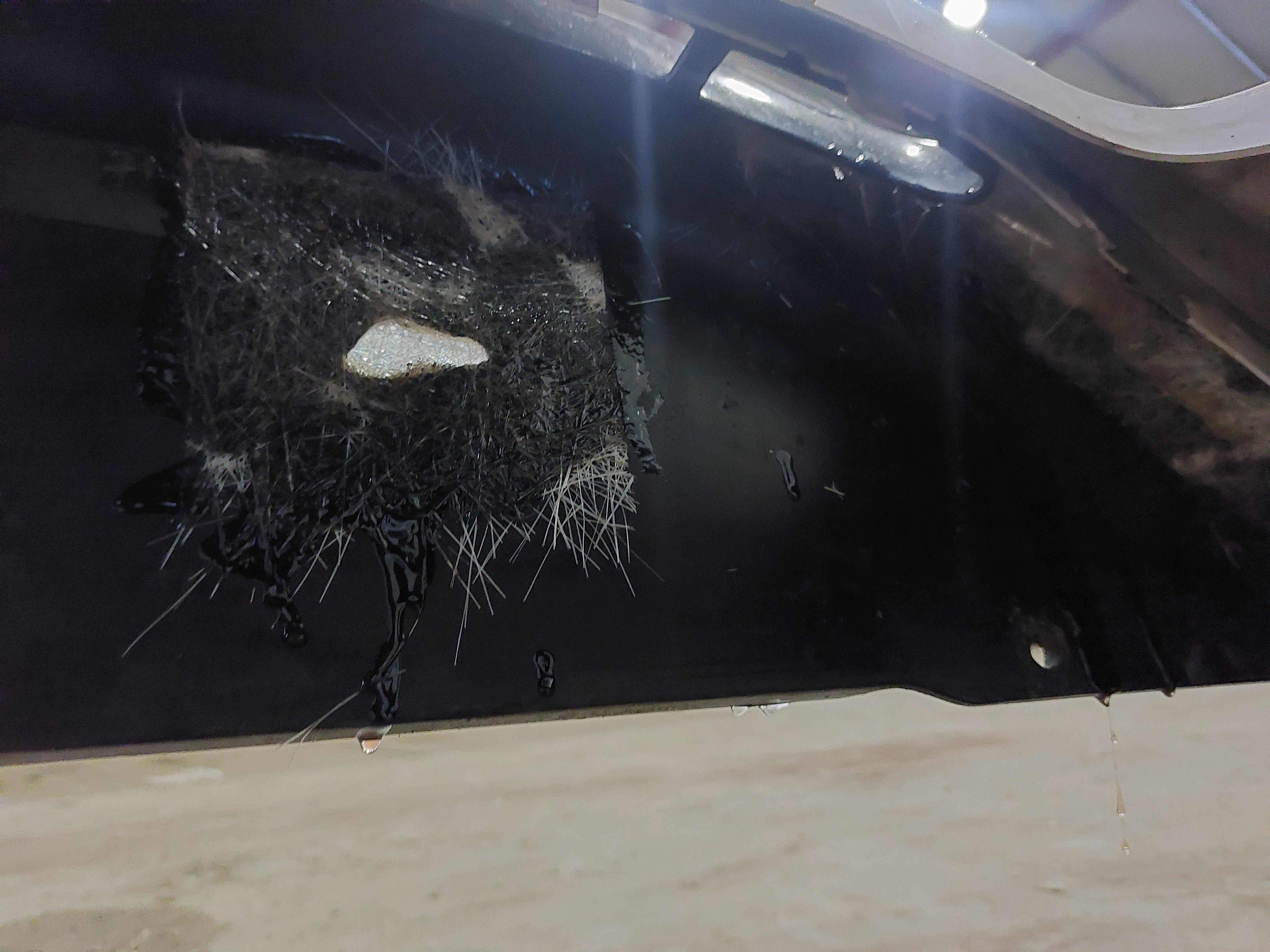

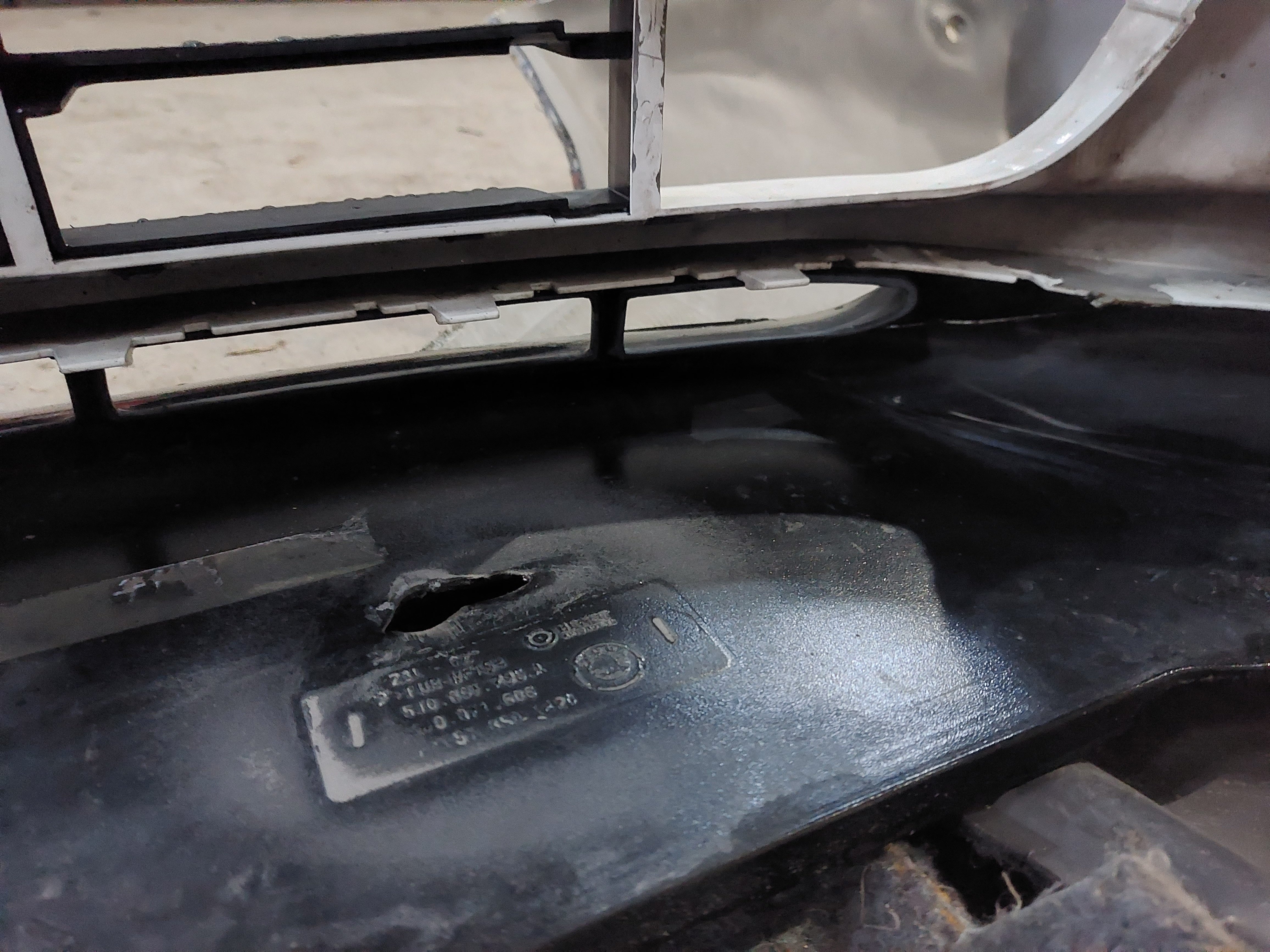

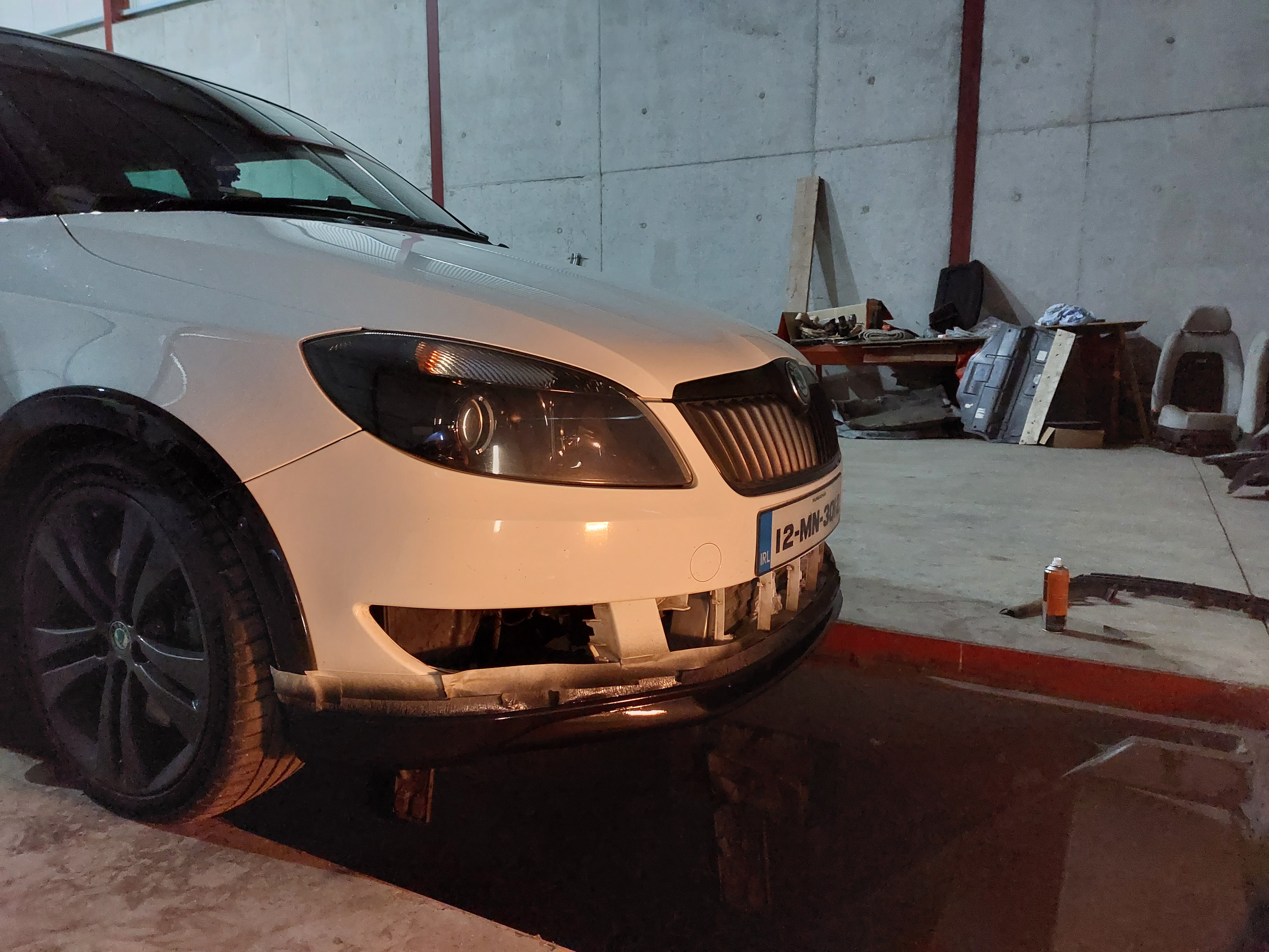

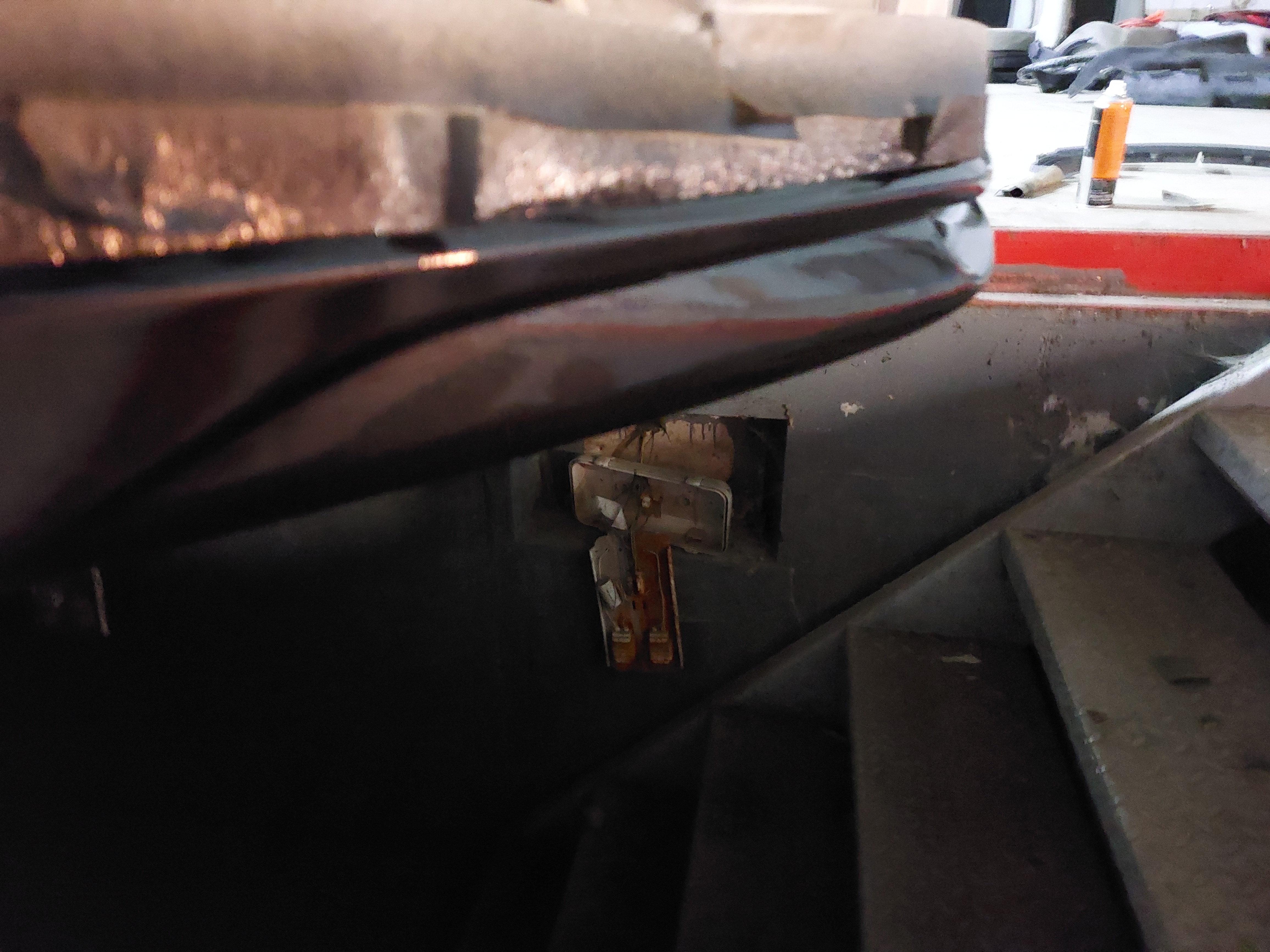

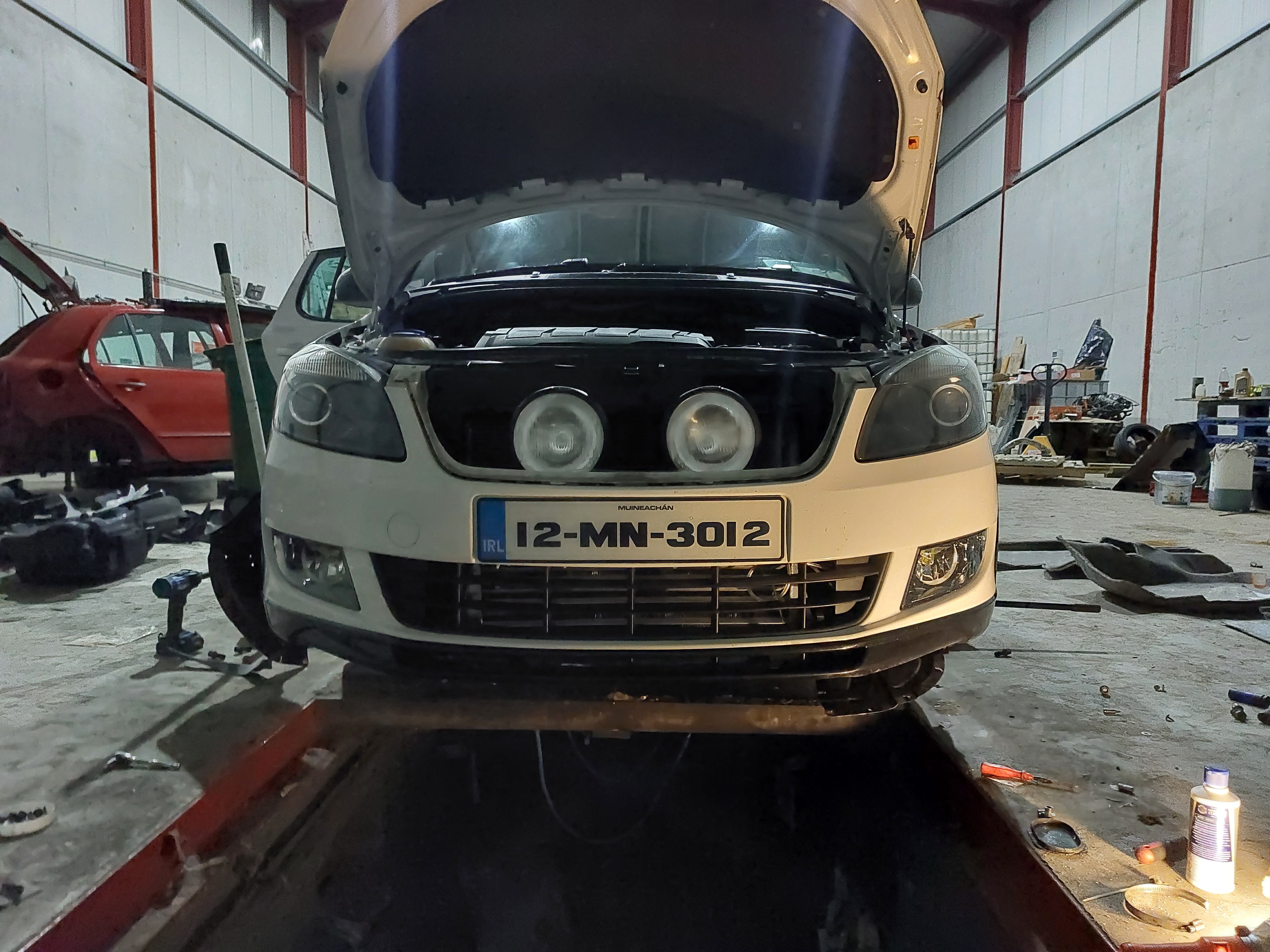

Bumper off to finally fix the damaged lip.
Got a small fibreglass repair kit from halfords and set about fixing it.
Not too hard actually. Kit had a lot more stuff than I needed so I have lots spare for the vRSDI.
Only trouble I had was the resin set VERY quick. The way it was setting it was turning into jelly in the cup, so I ended up dumping that out in a lump and making more.
Did 2 layers, Seems to have set very hard. Looks bad, but the patches are behind the bumper and the bottom of the splitter can't be seen.

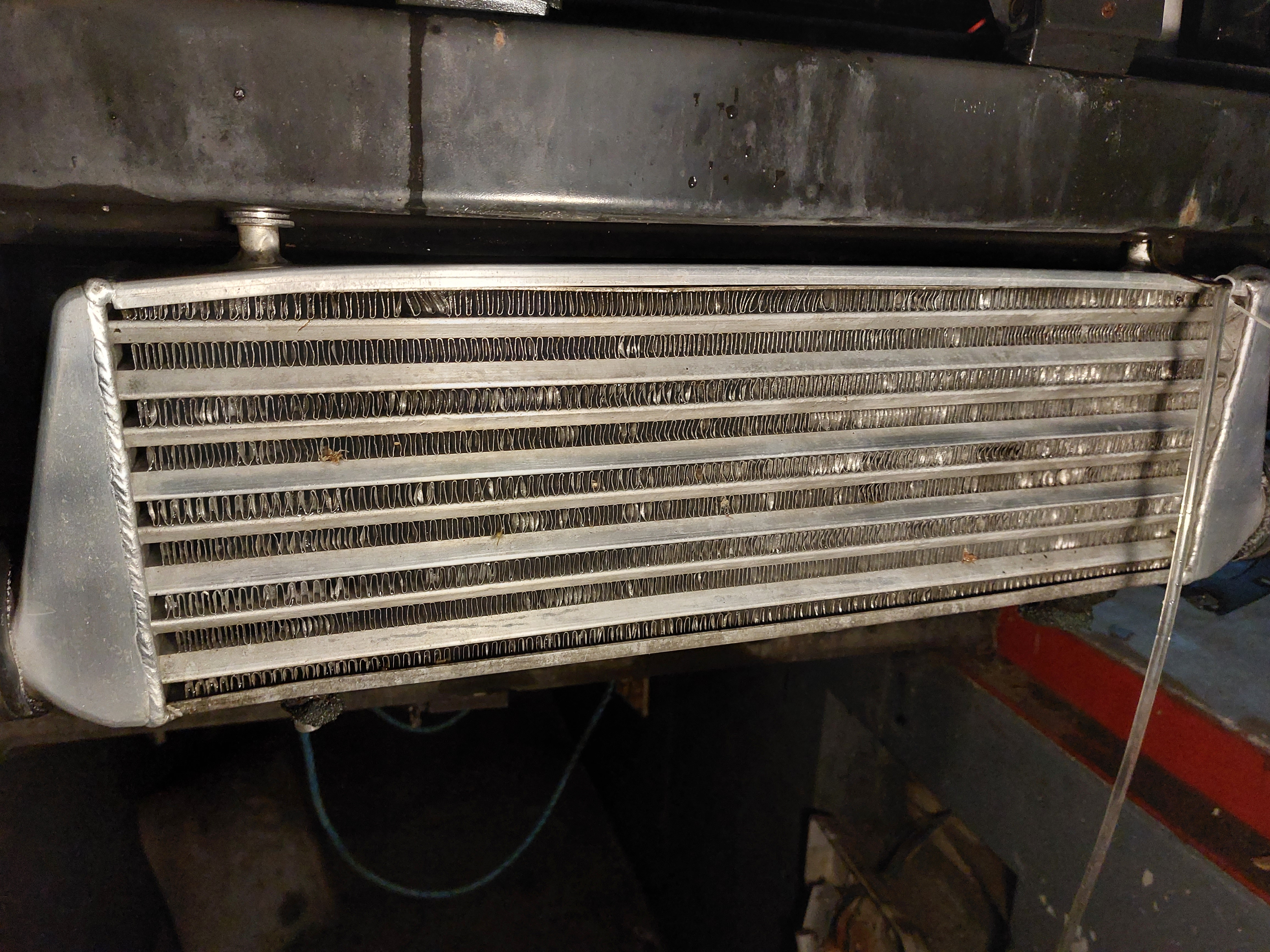

Gave it a clean waiting for the resin to set. Gave the intercooler and the spotlamps a good clean since I had access.
Also tightened up the intercooler for hopefully the last time. Gave it a good polish too.
All together.
I'll just paint it on the car. Everything behind the bumper is fixed so no point taking it off again.
Too hot in the workshop and/or using too much hardener.
Probably both
Place was a furnace

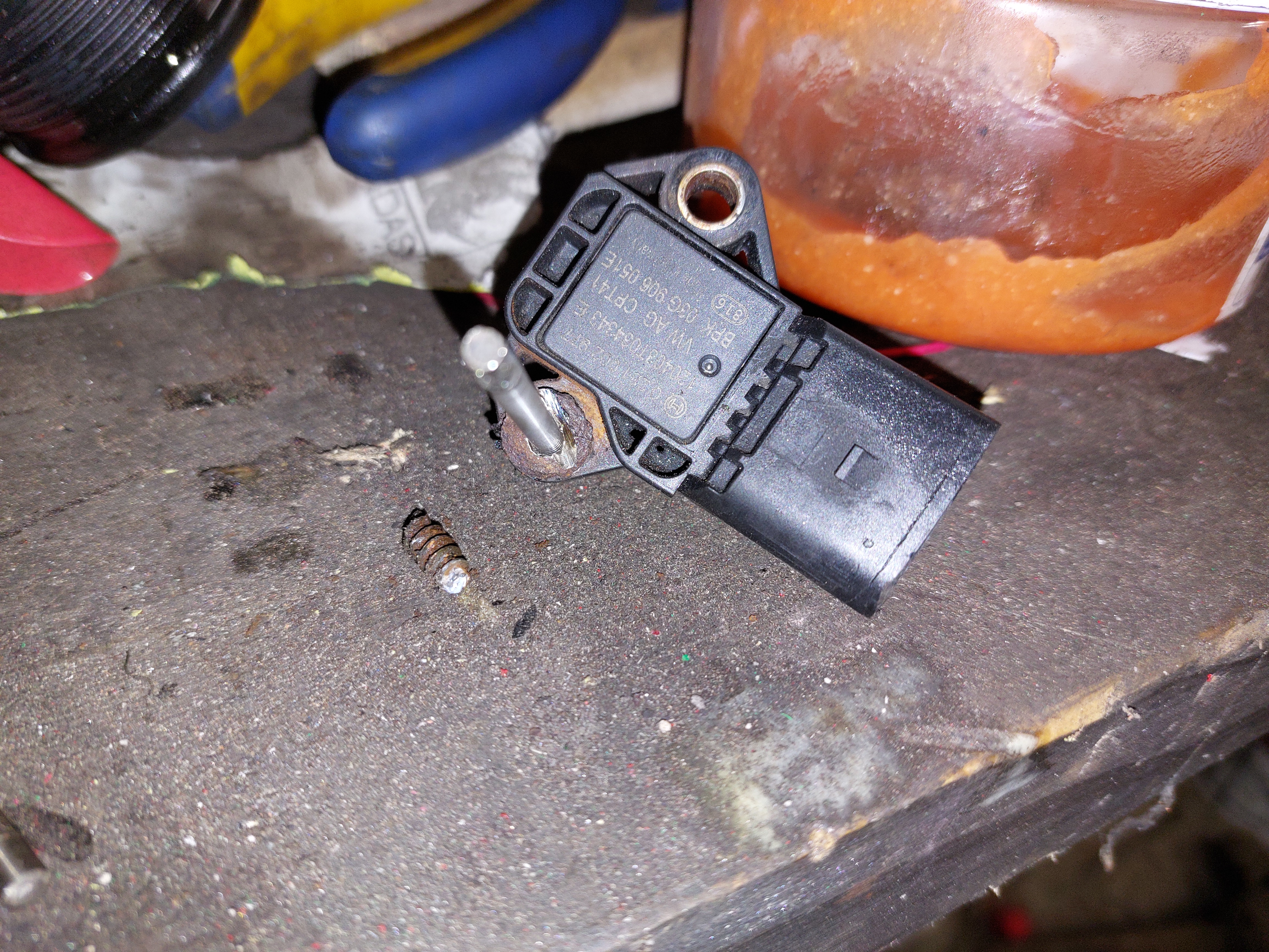

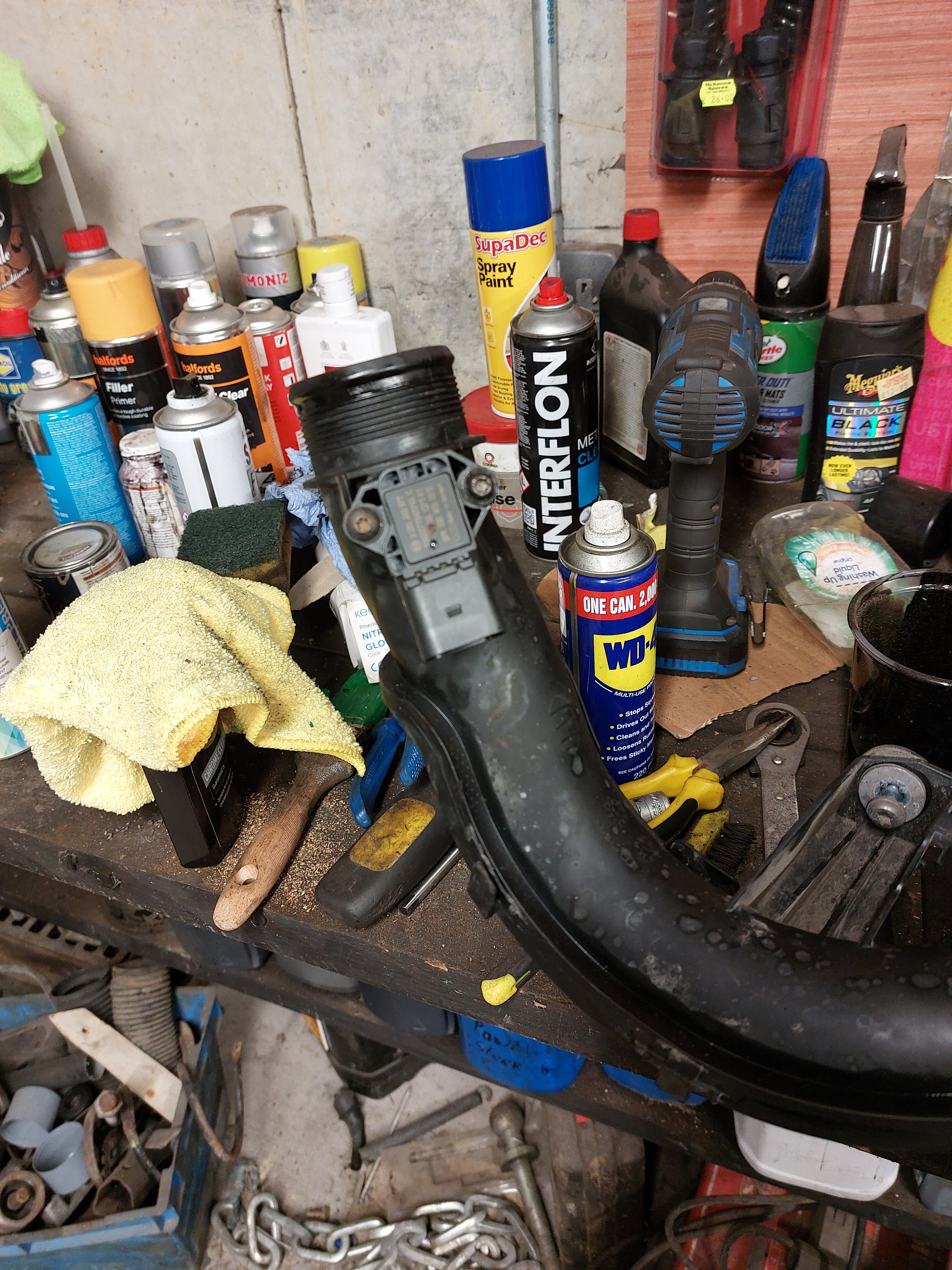

New map sensor installed. Bolts were rusted beyond recognition so had to take the pipe off and try remove the bolts. Ez outs worked pretty well.
New one in with bolts I had laying around.
Didn't fix the code I was getting oh well.

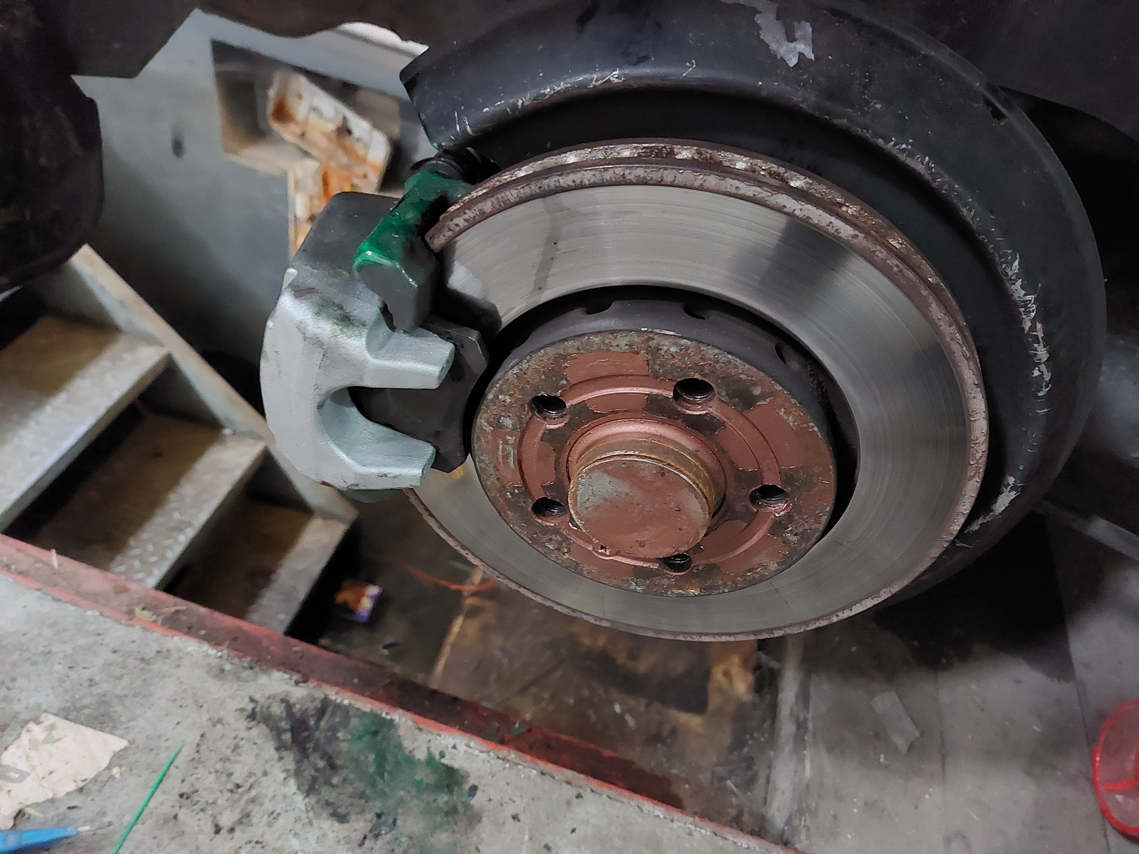

New Rear right caliper, refreshed the brake fluid too. Old caliper was beat.

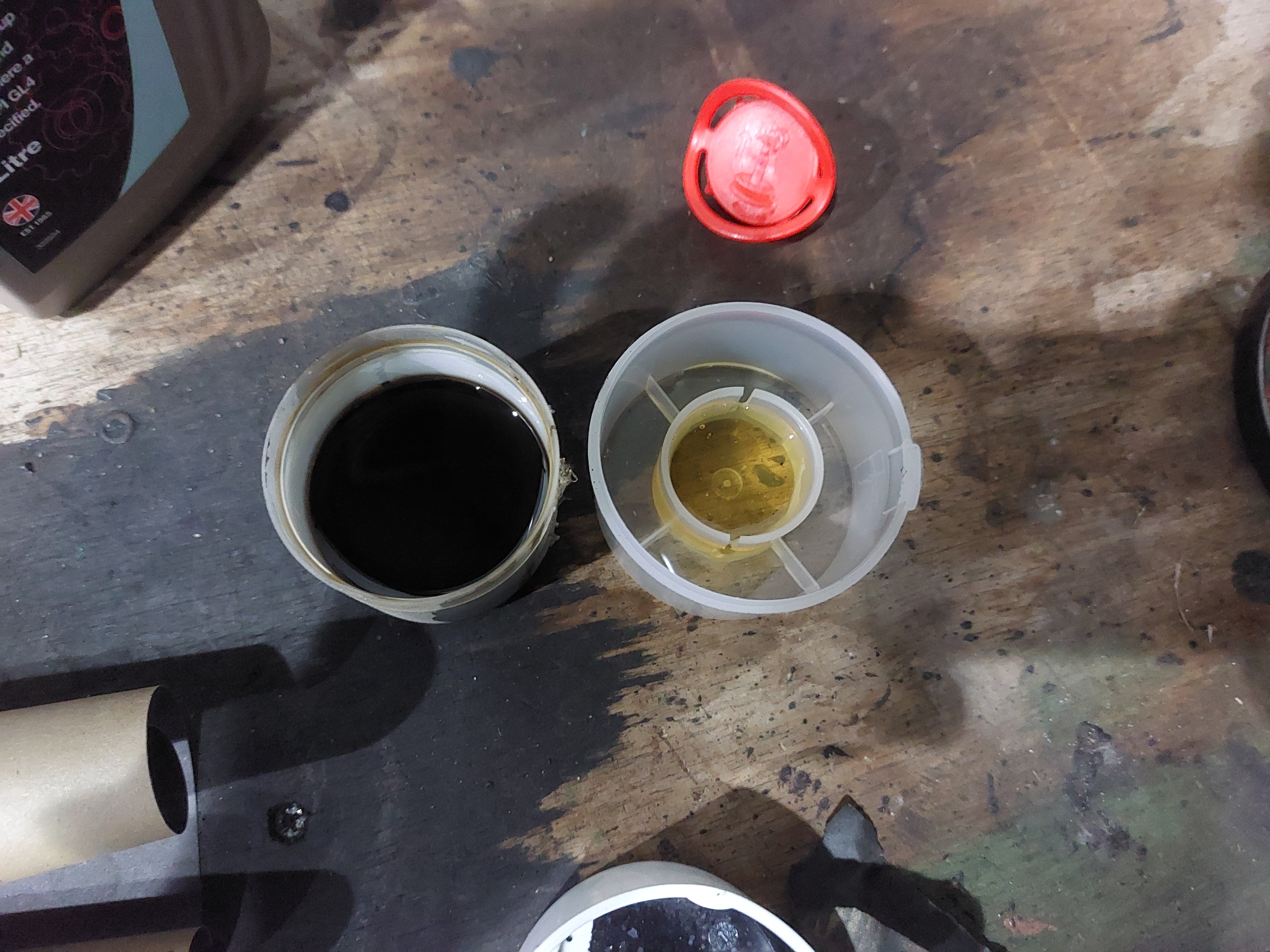

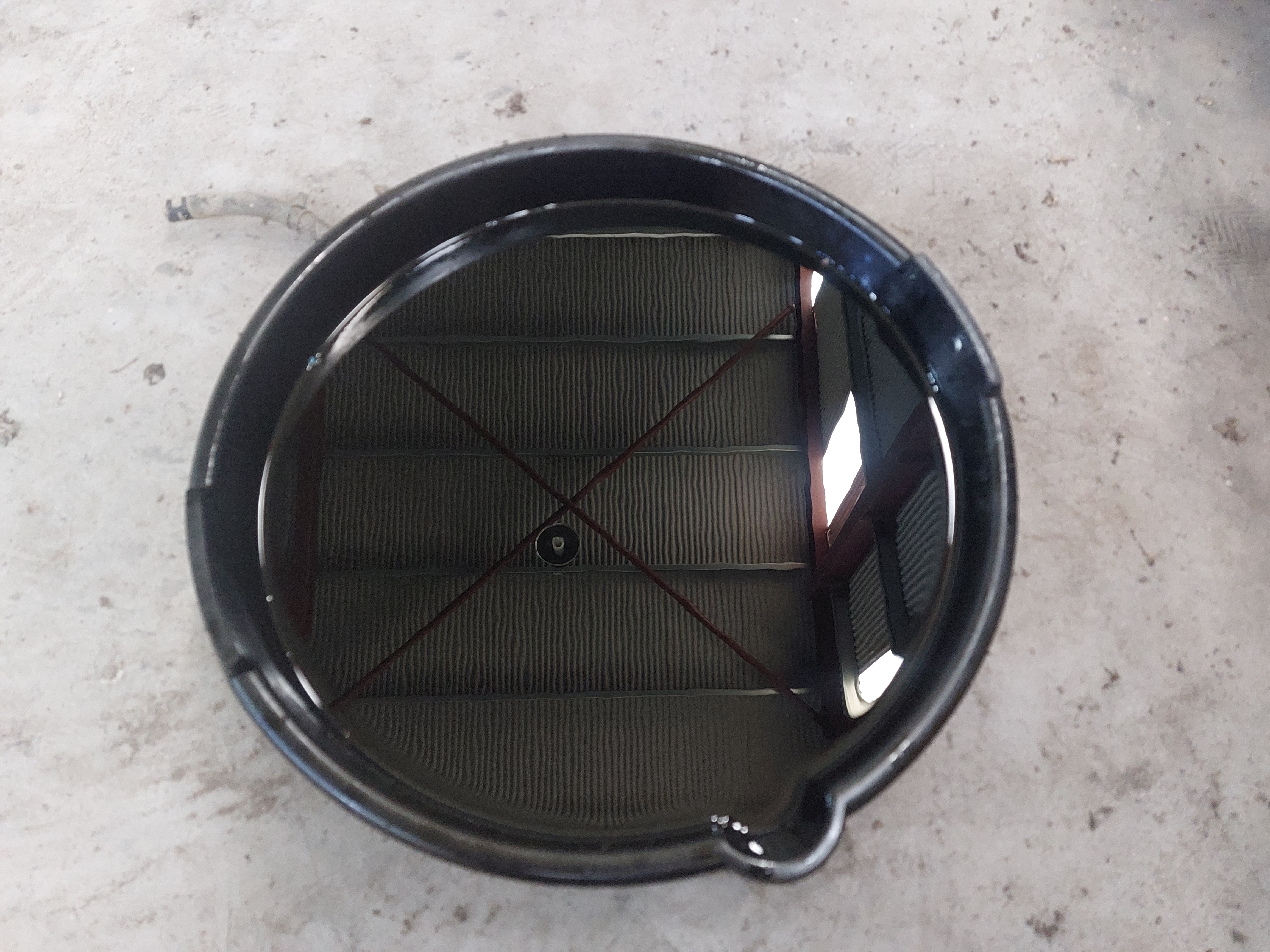

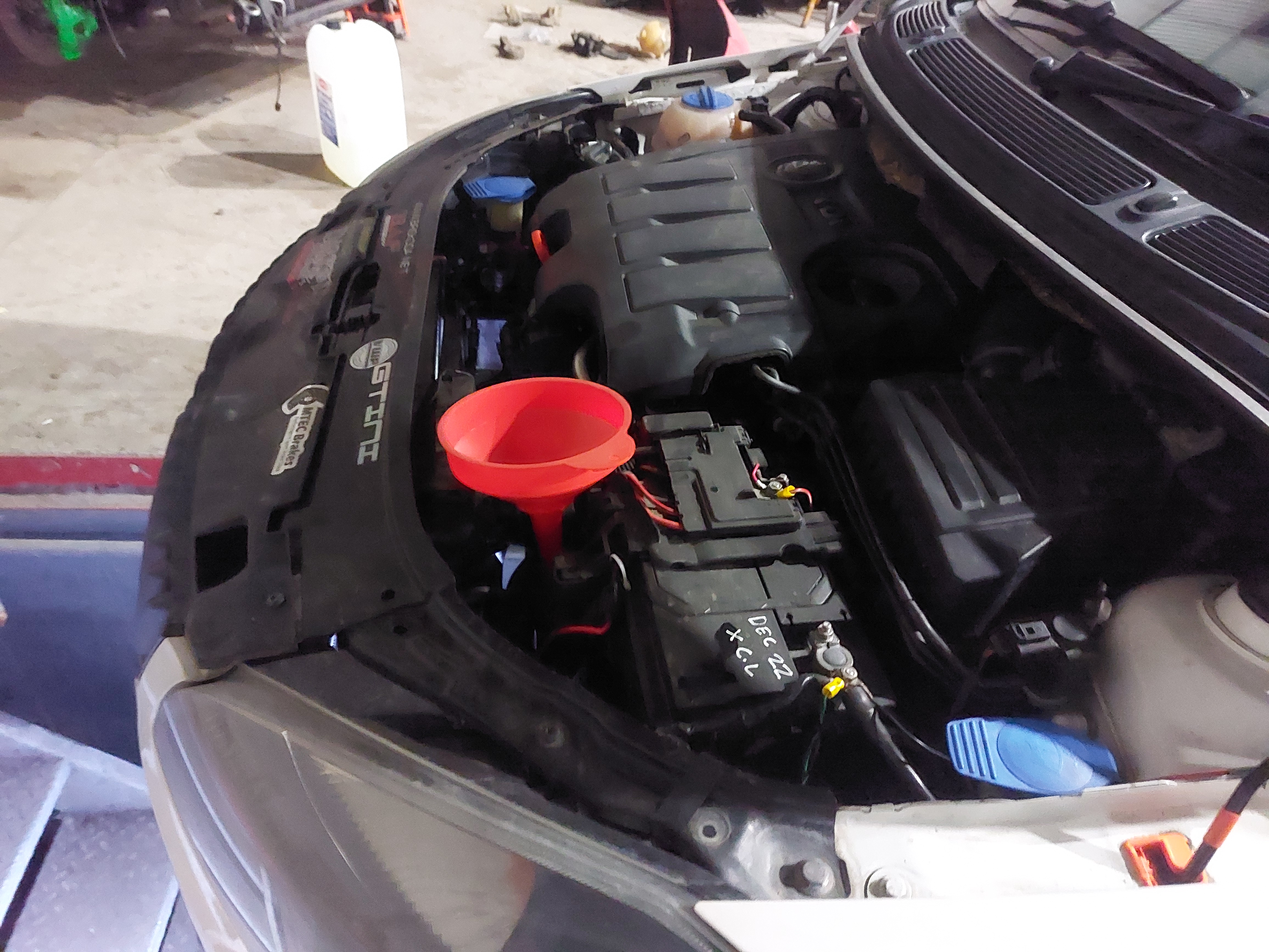

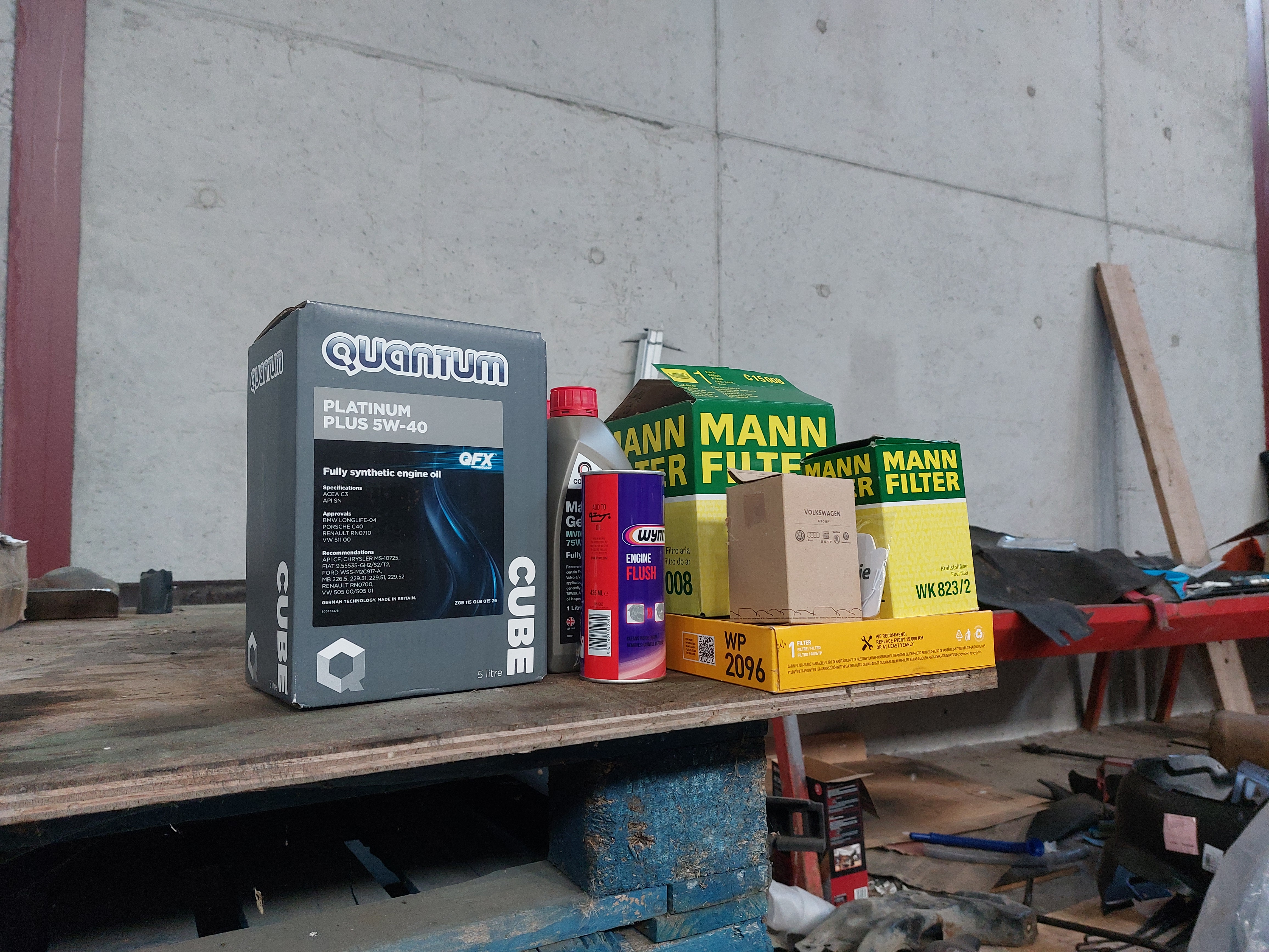

So due another service again. Ordered quantum oil online. Very impressed how well it was packaged, wrapped twice and boxed. Pretty cheap too, and quantum is genuine for VW afaik. Stepped up to 5w40, figure a thicker oil would be no harm given its getting up the miles.20231013_191055.thumb.jpg.193b70ae2c38075b211880735b79b5cd.jpg

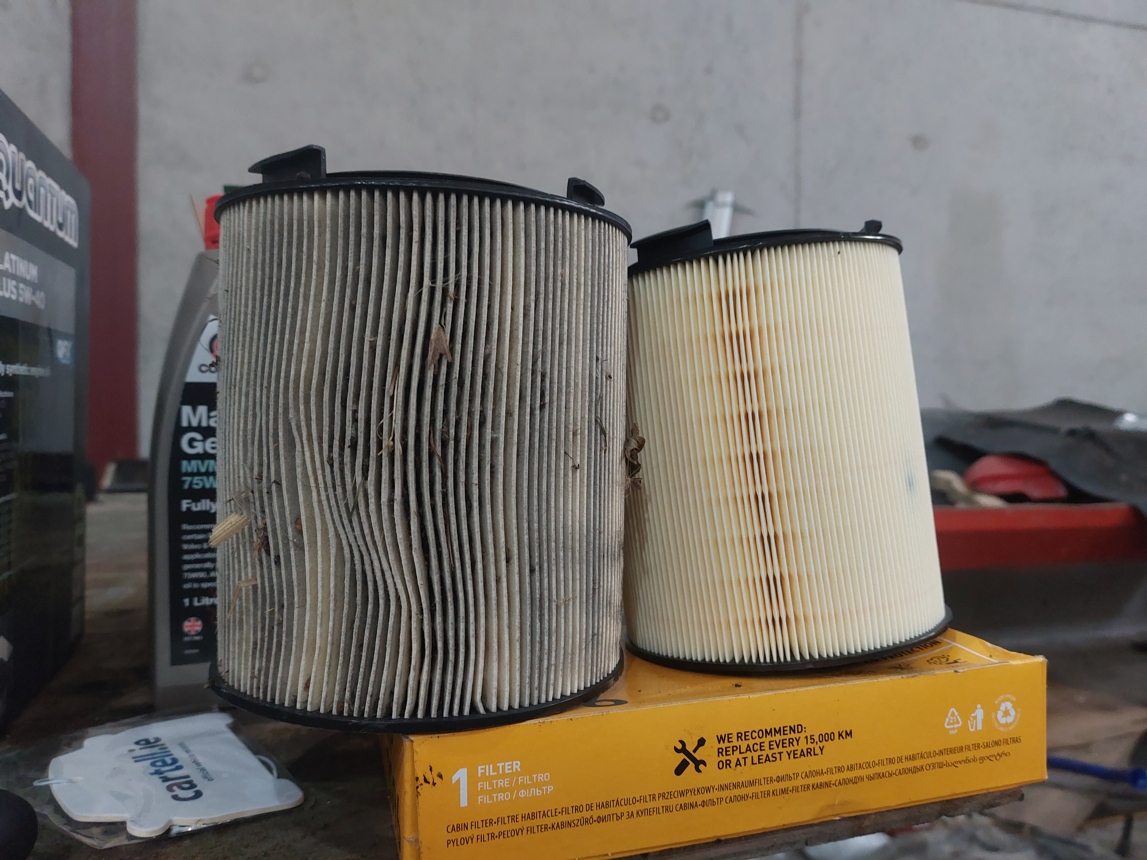

Full kit assembled. Air, Oil, Fuel, Pollen, engine flush (why not) and Gear oil. Didn't get to do the gear oil as I ran out of time.
Used the engine flush as instructed and the oil drained like water.
Air filter rotten again

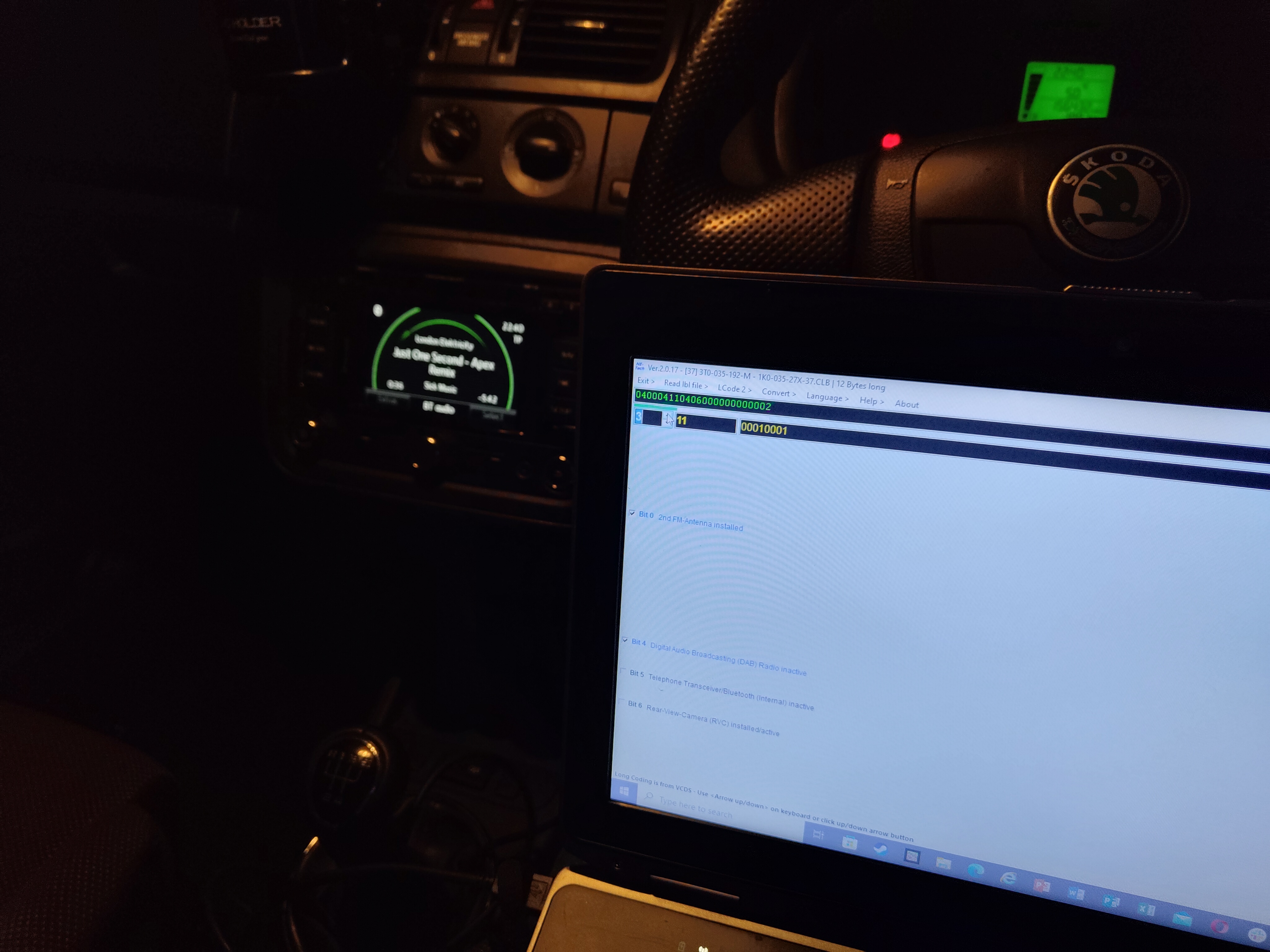

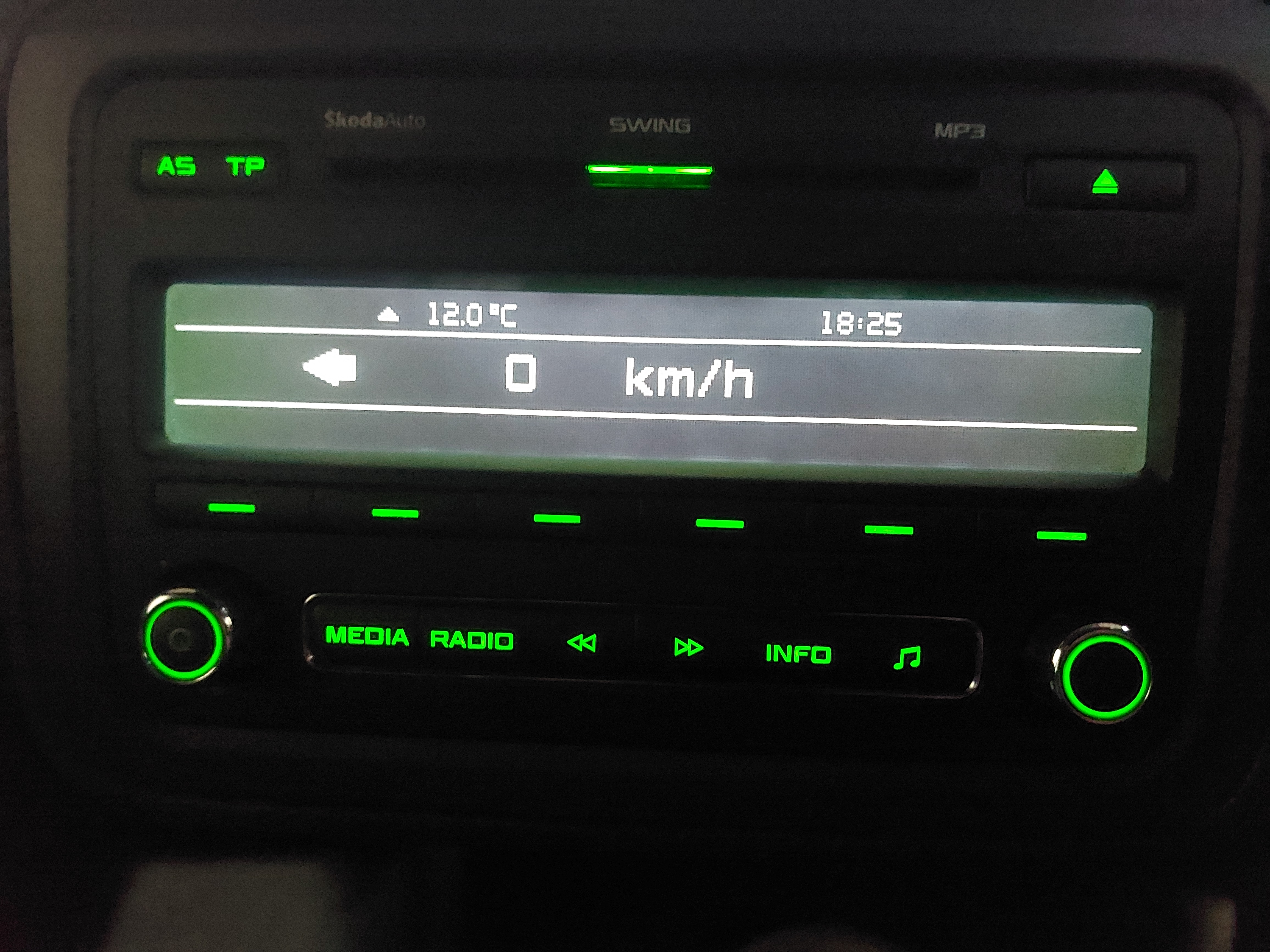

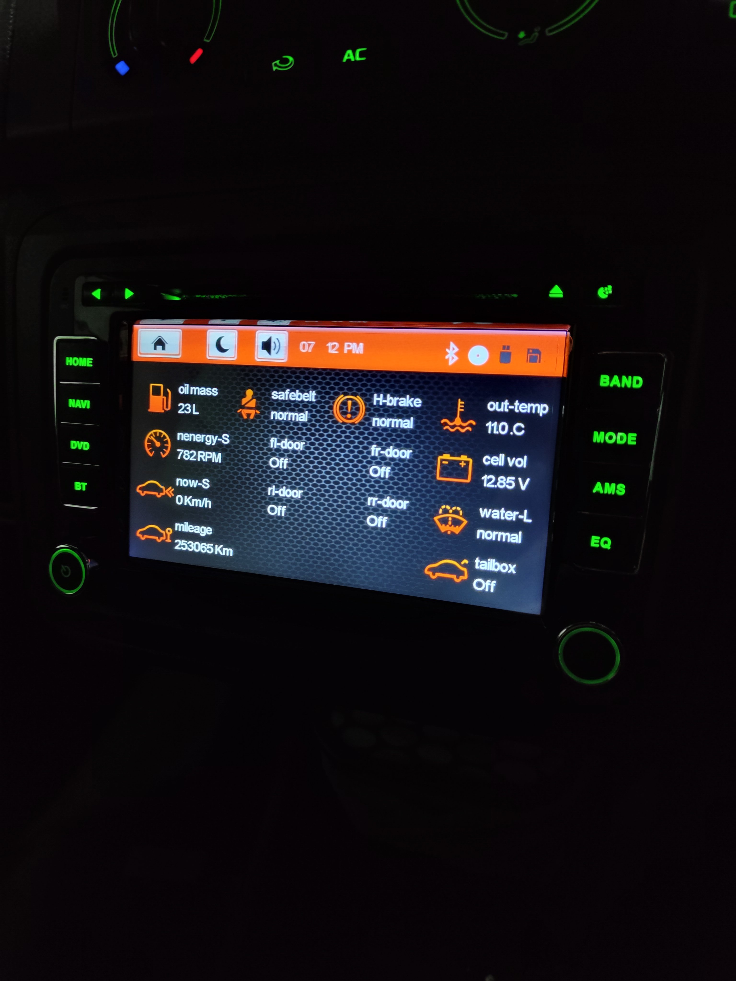

Serviced up, primed the fuel system with vcds and did some tweaks while I was in there.
Figured out how to get speedo readings on the radio, which was cool.
And said I'd try the needle sweep function.
 Ready to go another bit I reckon.

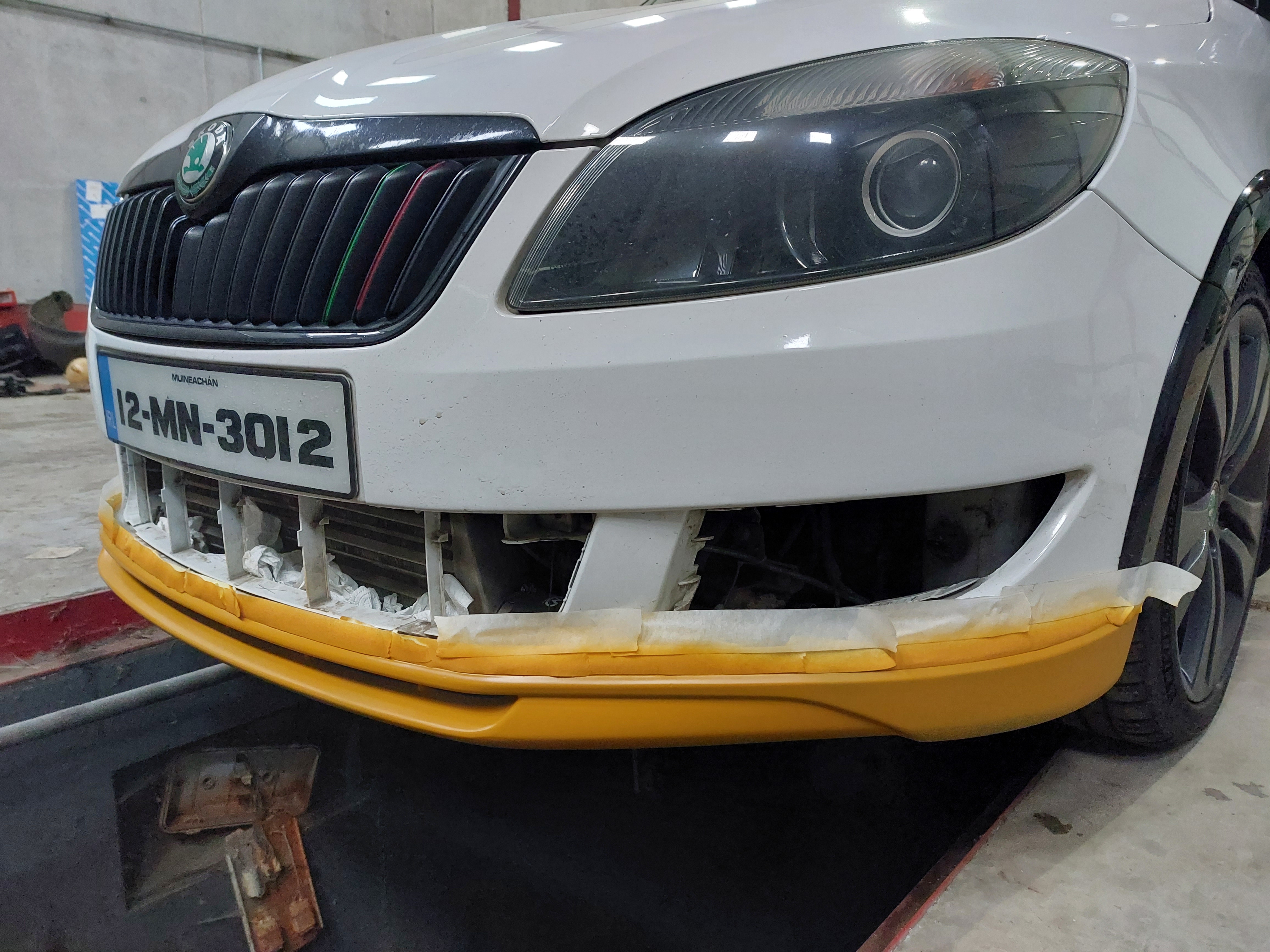

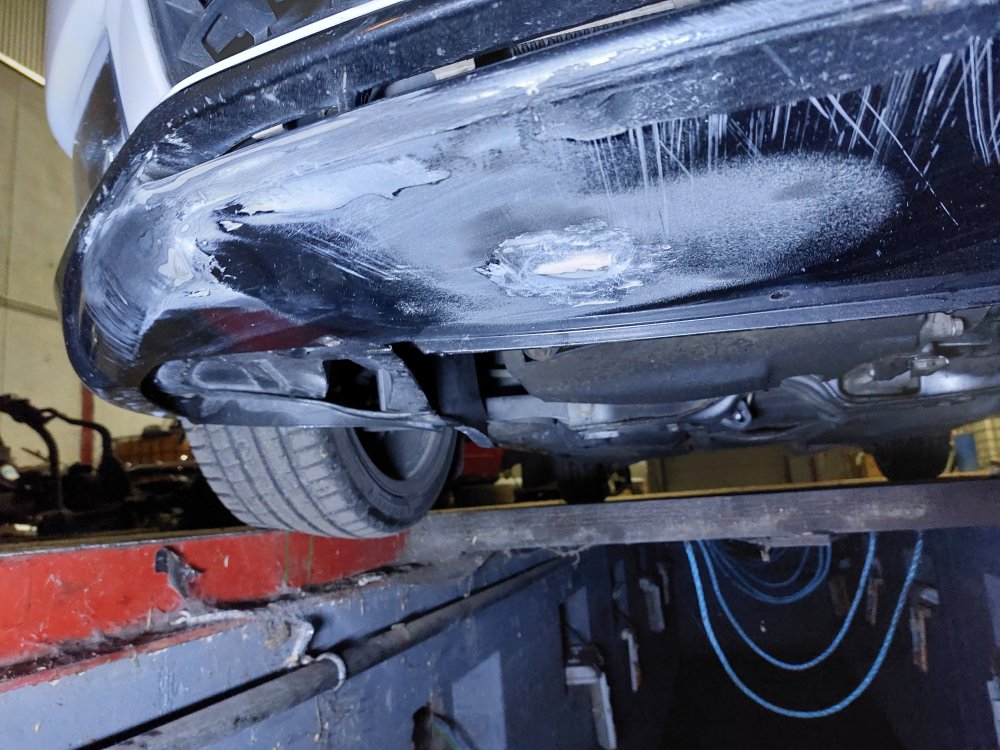

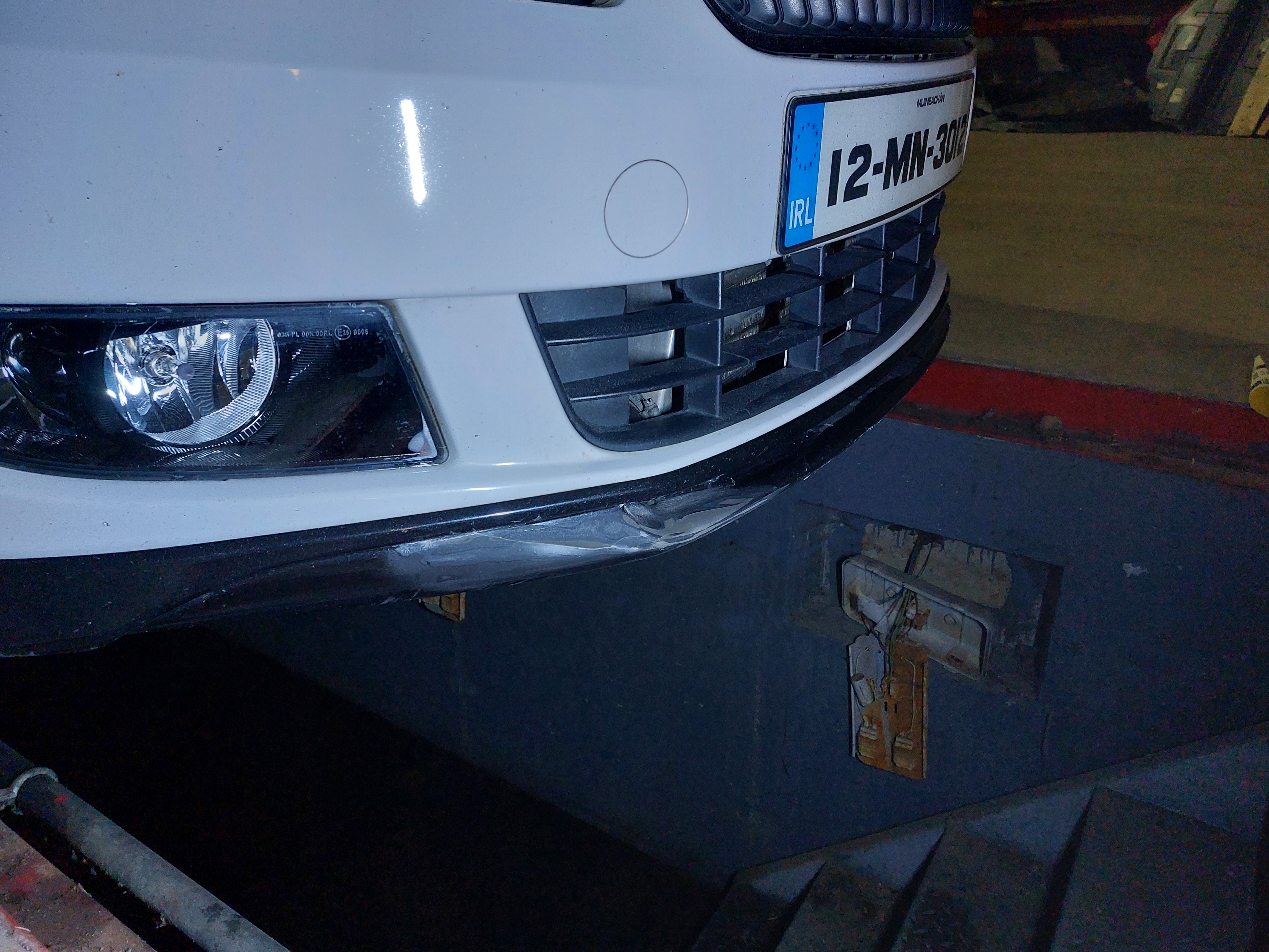

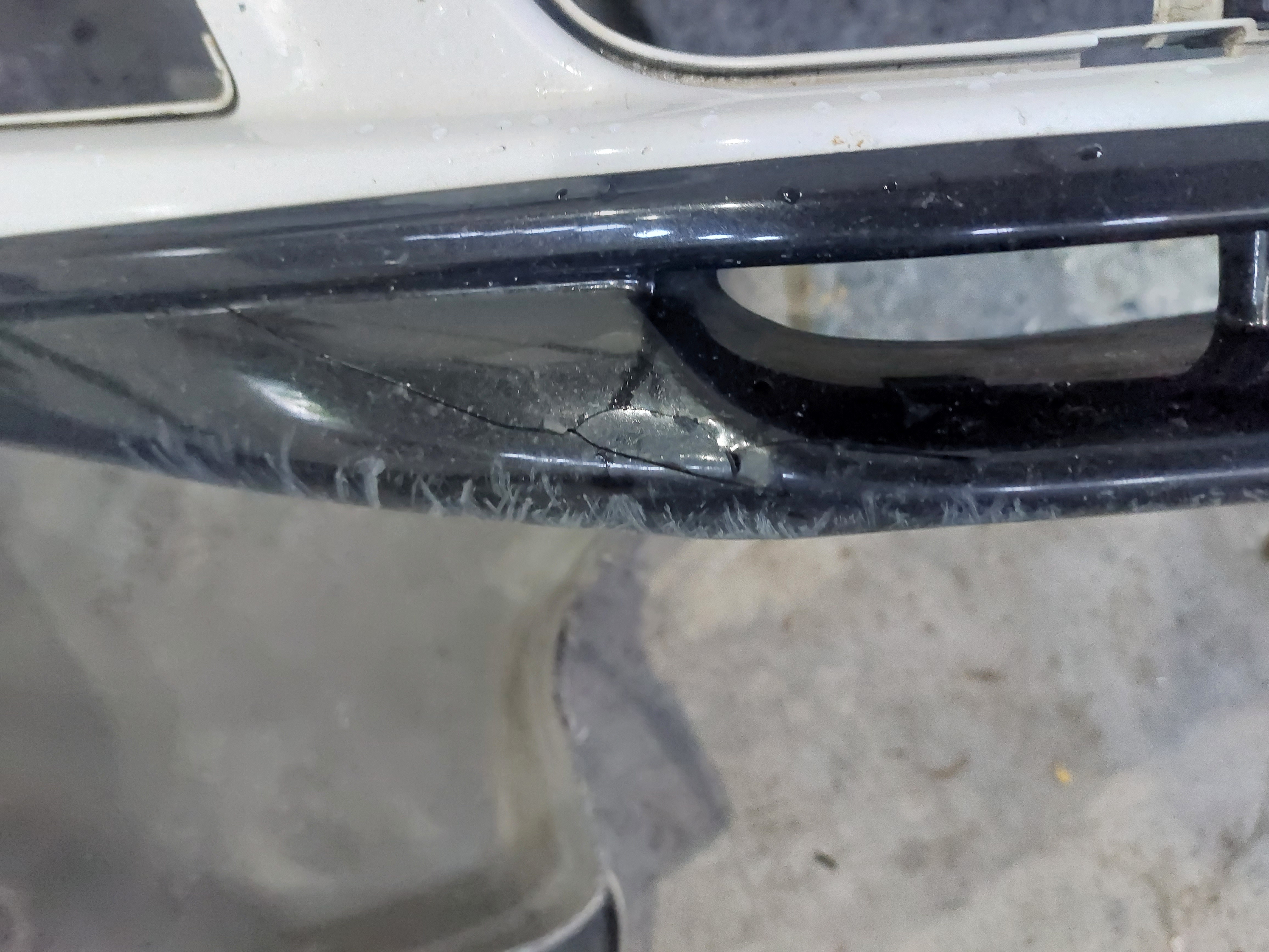

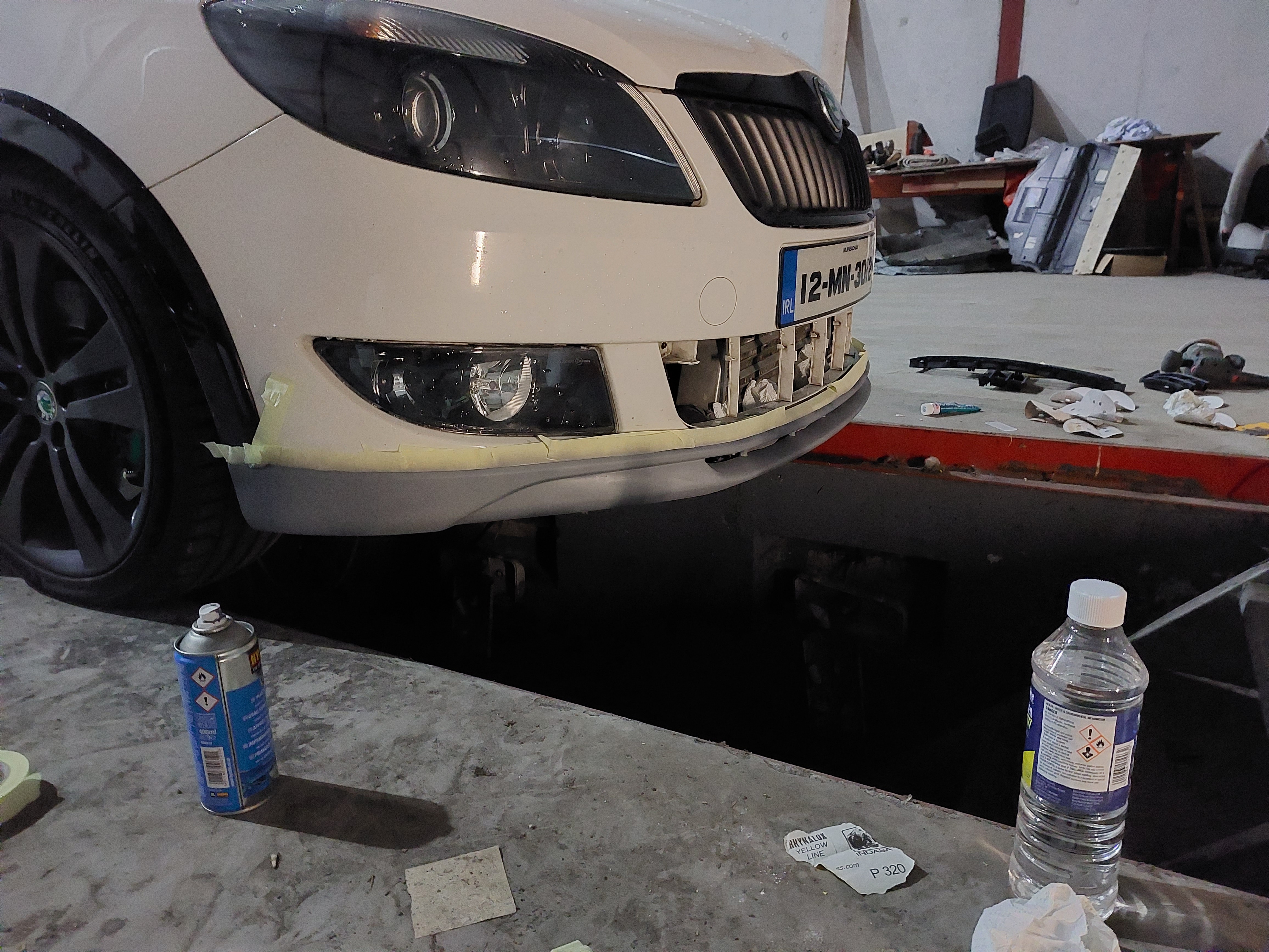

So finally took the time to fix the splitter
Took a fair bit of sanding and filling to get the worst out of it.
Primed
Filler Primed
And Painted.
Complete rattle can jobbie from start to finish. So far from perfect.
I'd rather have been able to take it off. But it's a lot of hassle and I'd have probably broken it. Tape was less than stellar and got a fair bit of overspray. To say I'm rusty would be putting it lightly.
 That pic is of it freshly painted. Came out fairly well over all. Since wetsanded it and buffed it but there's a bit more to be done, anyhow. Better than paying 350 plus vat for one of the few NOS ones, and still need to paint it anyway.

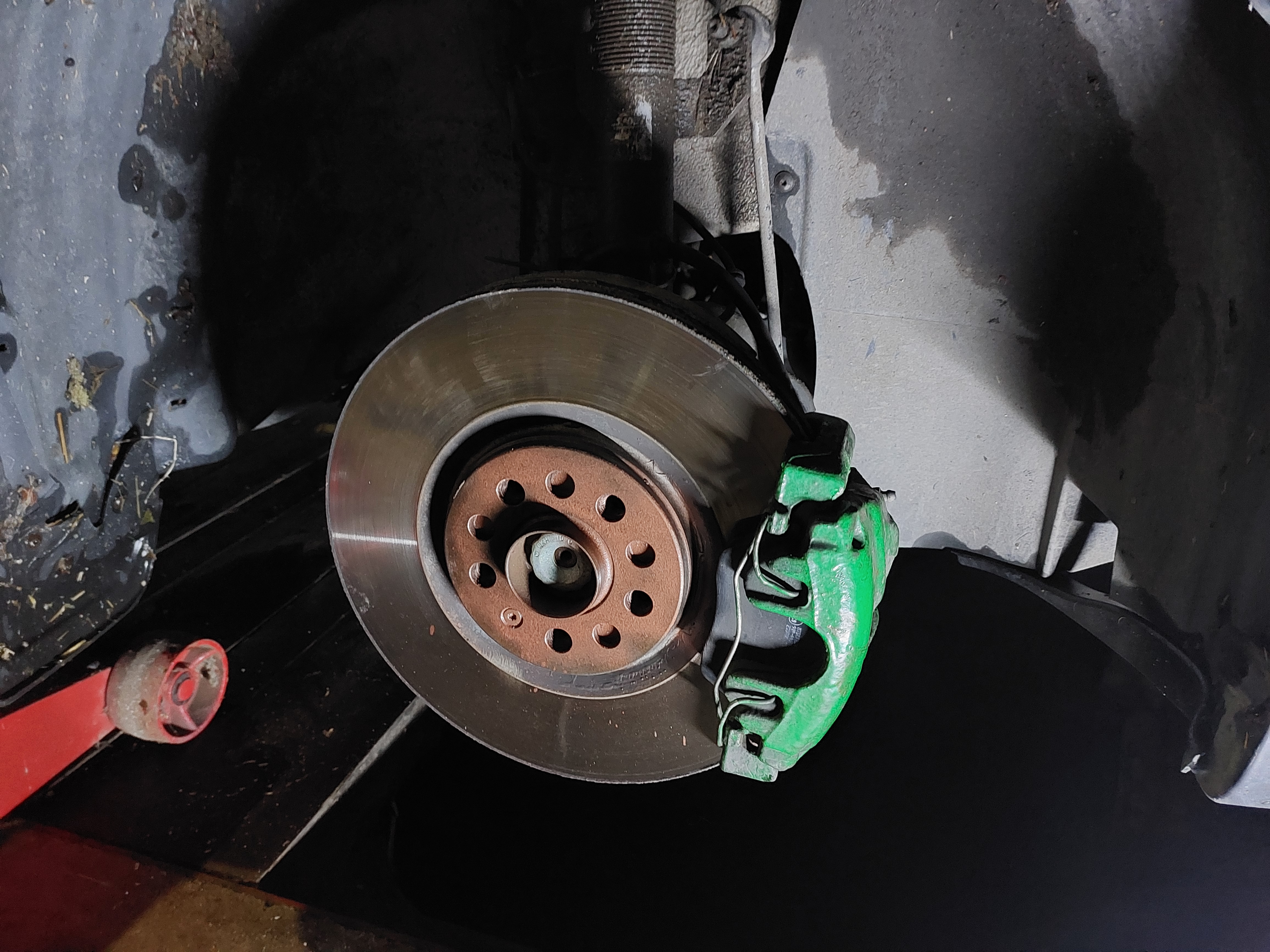

Also have NCT soon so took some time looking it over. Stripped all the brakes, deglazed the pads, cleaned the sliders and rebled. Front discs are a bit low, would have changed them when I did pads only they got lost in transit.
Checked over the suspension, all seems fine but I have noticed an occasional knock. Which I can't figure out.
Changed the gear oil too as I didn't get doing it when I serviced it.
"Only" 50k miles on it from the last time I did it. Still probably fine I imagine but seems gear changes are a bit slicker and I've not gotten the typical crunch into reverse since.
Not much else. Imagine it'll fail on something stupid again.

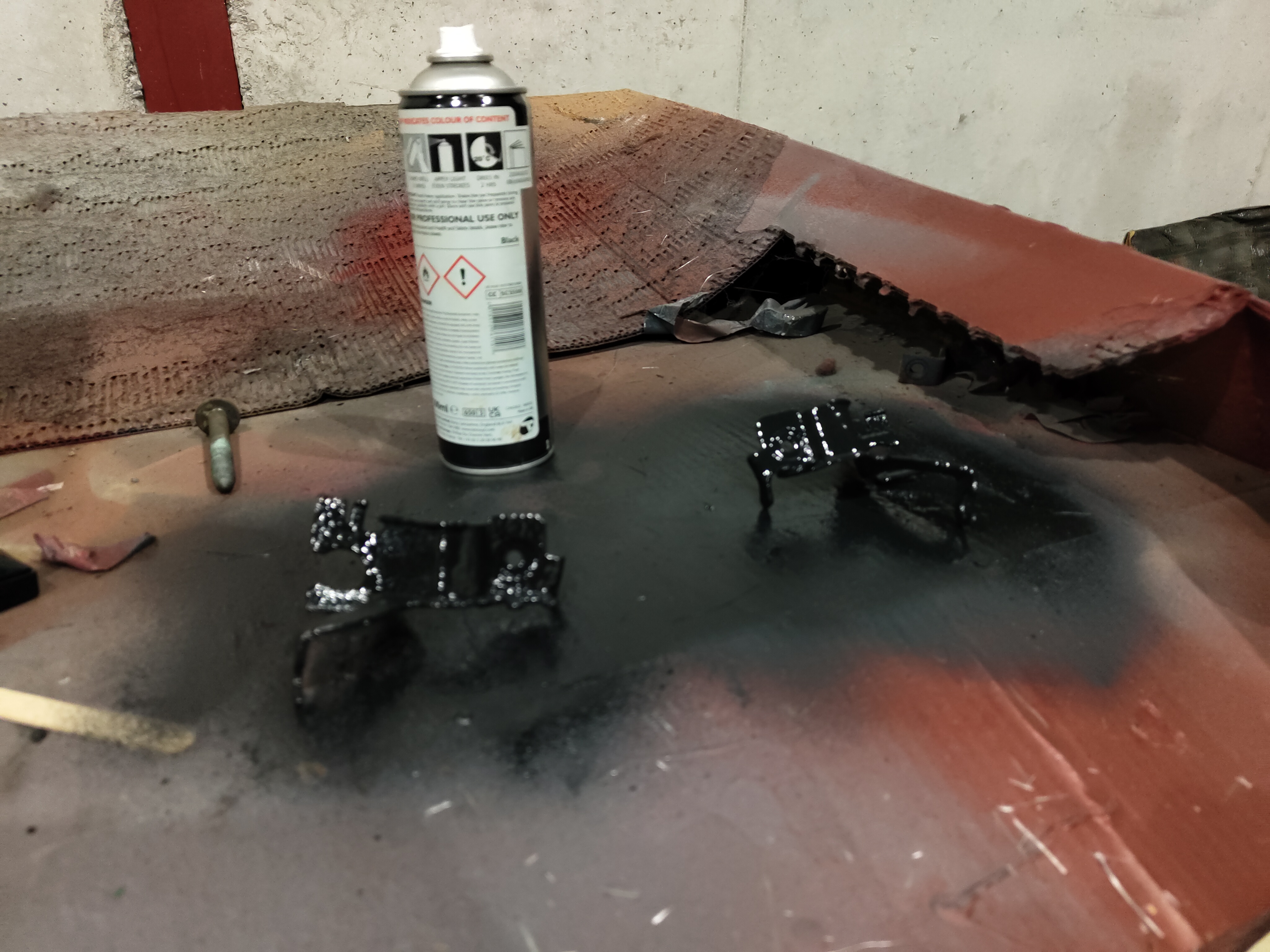

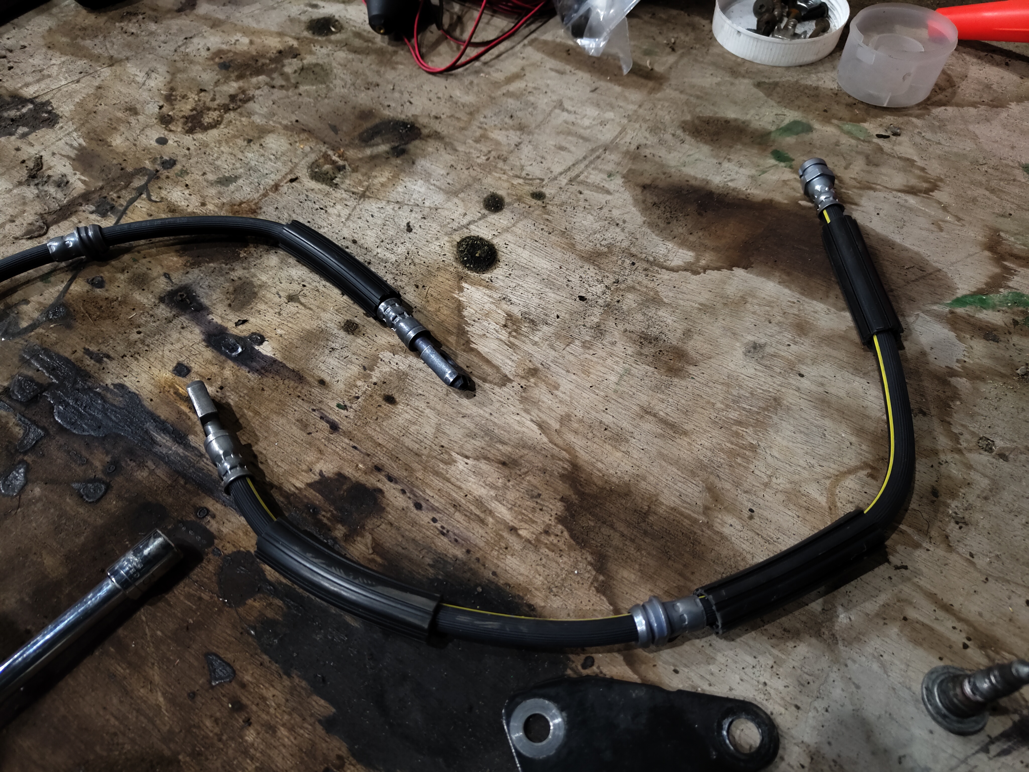

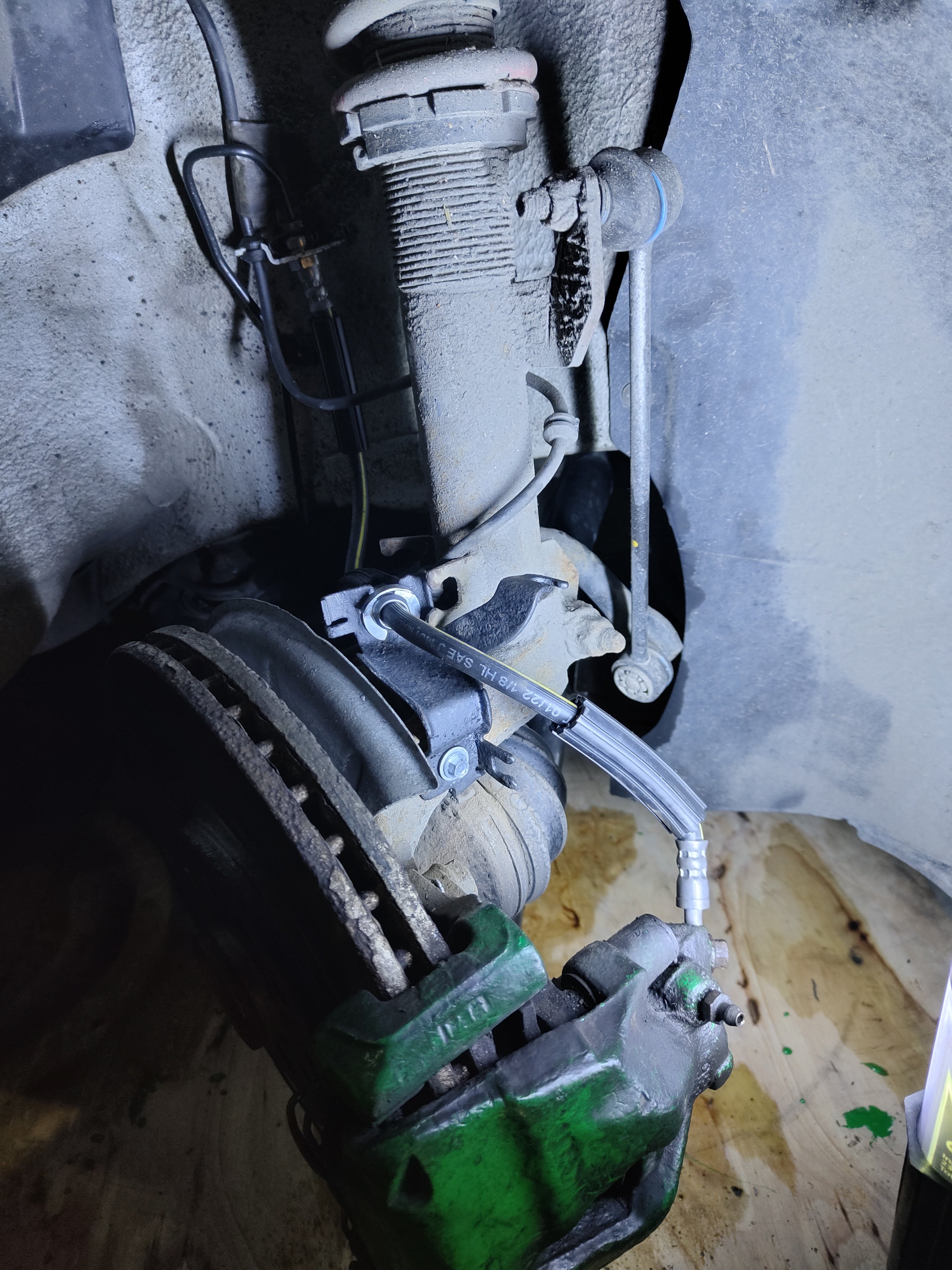

Failed on front brake pipes fouling (they weren't) was told it needed a bracket (It didn't the bracket is on the shock), they failed it then your man took it BACK in for a retest on the spot because it didn't print an emissions reading. It passed that with flying colours.
Retested it failed again, so to appease the sour bastards I robbed some brackets off one of the Mk1s and cleaned them up.
Also got new brake lines which ended up not even working, would not seal on the caliper. So used the old lines which I am NOT happy about.
Did come out pretty slick.

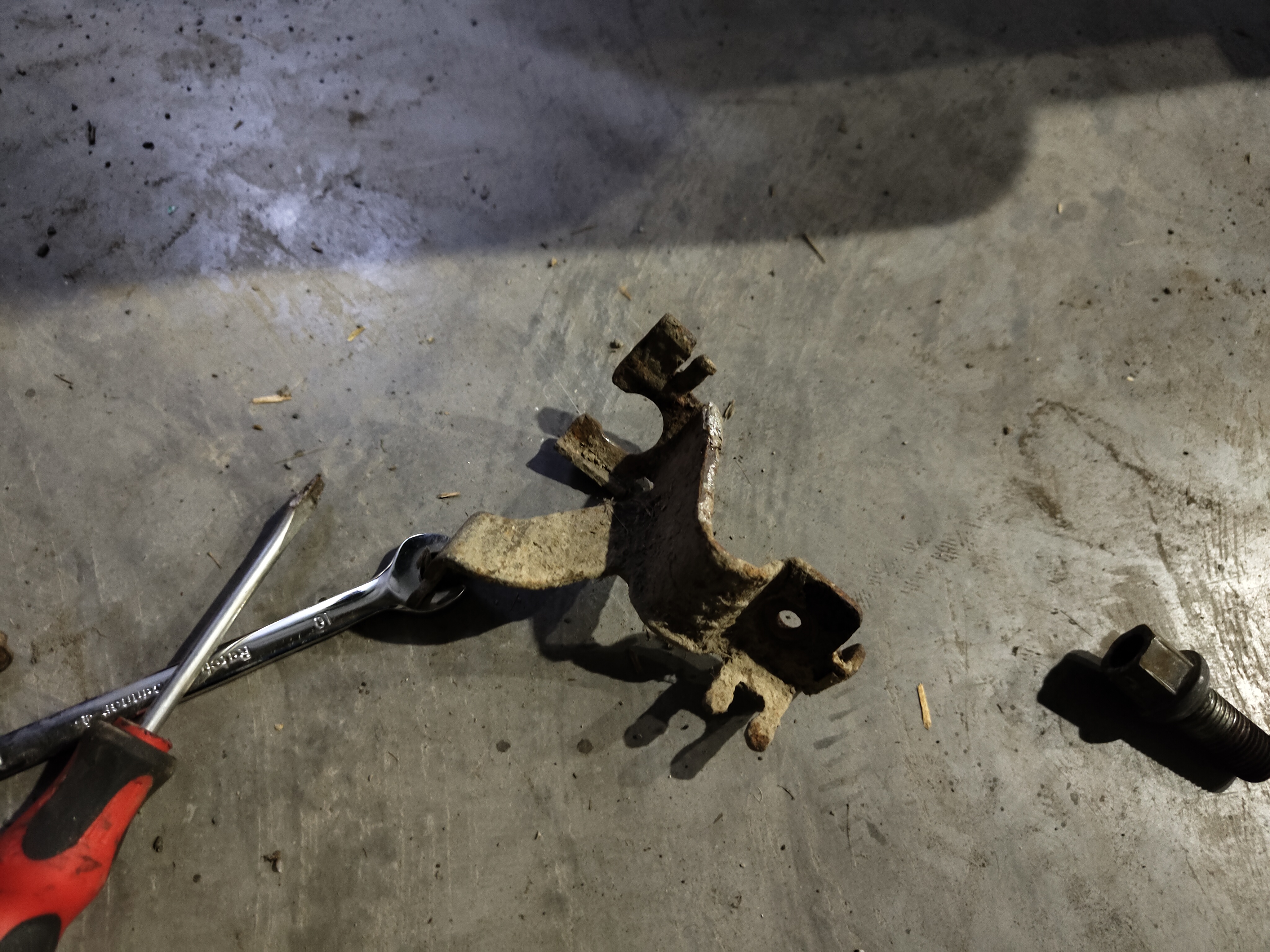

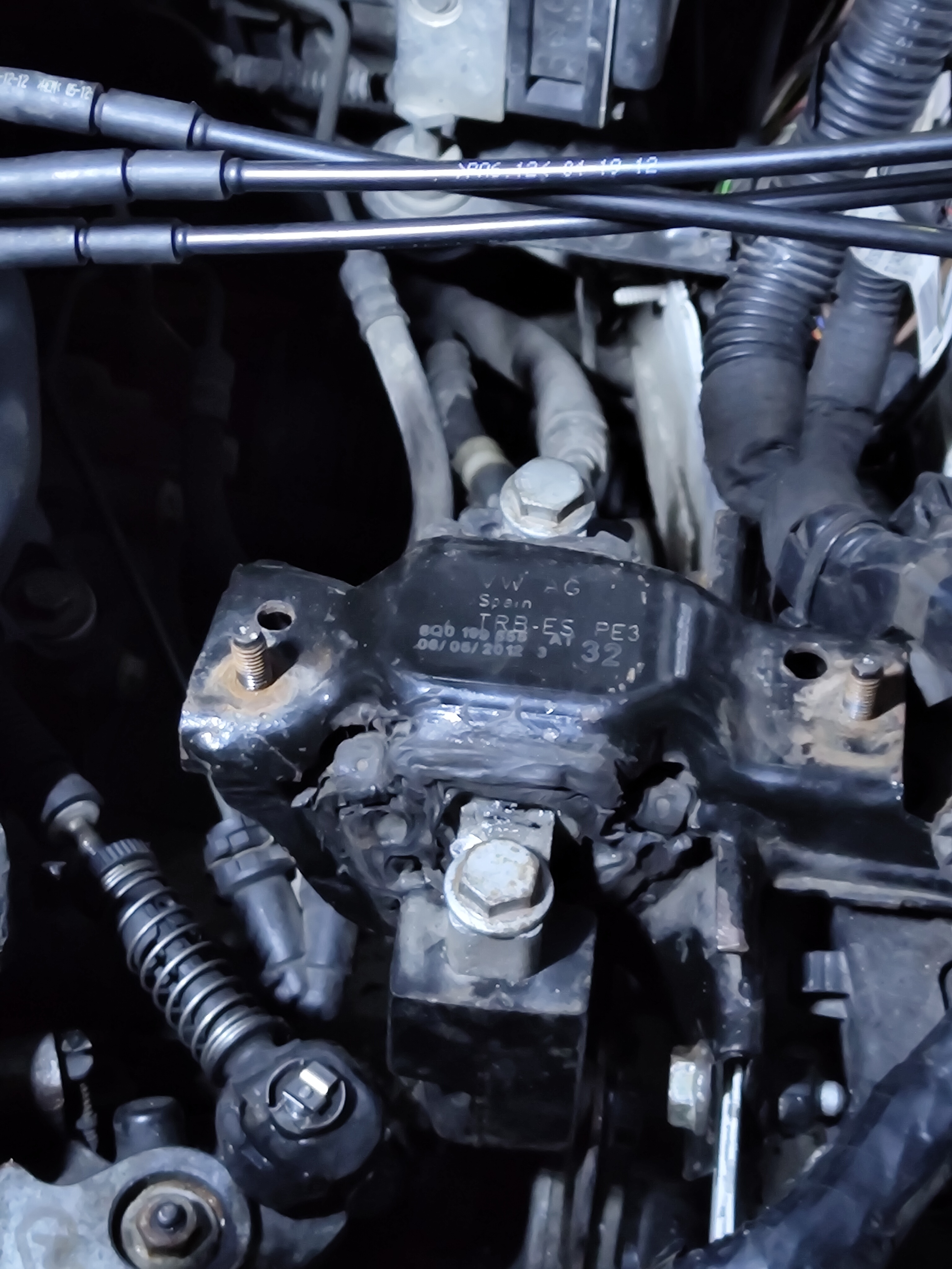

While all that was going down I wanted to swap the gearbox mount as it was poorly.
Then broke a bolt.
Was over Christmas, Ordered a new one and it didn't come to January 3rd. So was out of it for a week or so.
Sorted through other means but I now have a spare bracket brand new just sitting there.

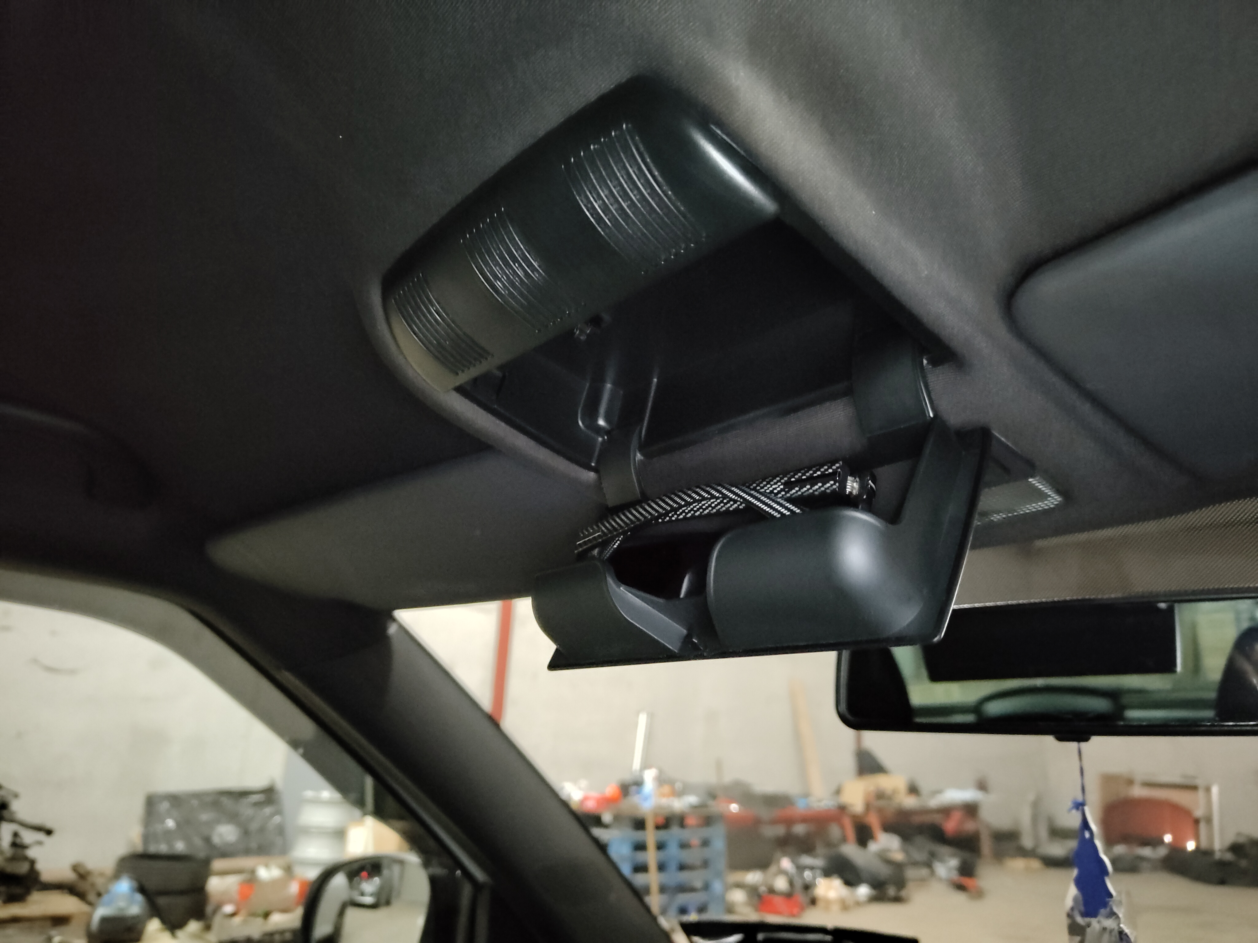

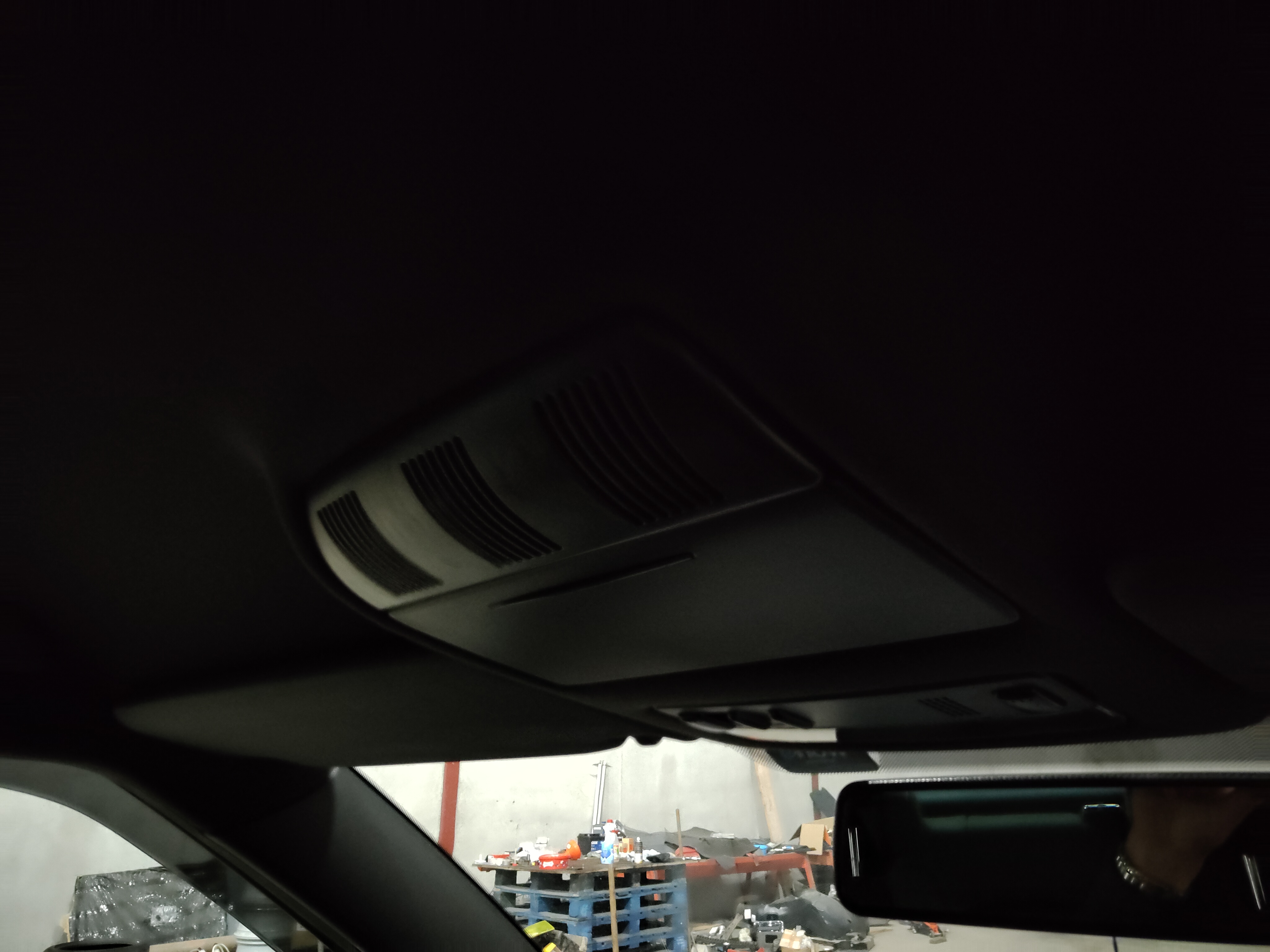

First one being a sunglasses holder. New old stock genuine Skoda oneIMG_20240110_125029241.thumb.jpg.d4a7a3b0e63be11ff4db8ec0ff17aa4e.jpg
Believe it or not a fair bit cheaper genuine than on eBay.
Nice and cheap.

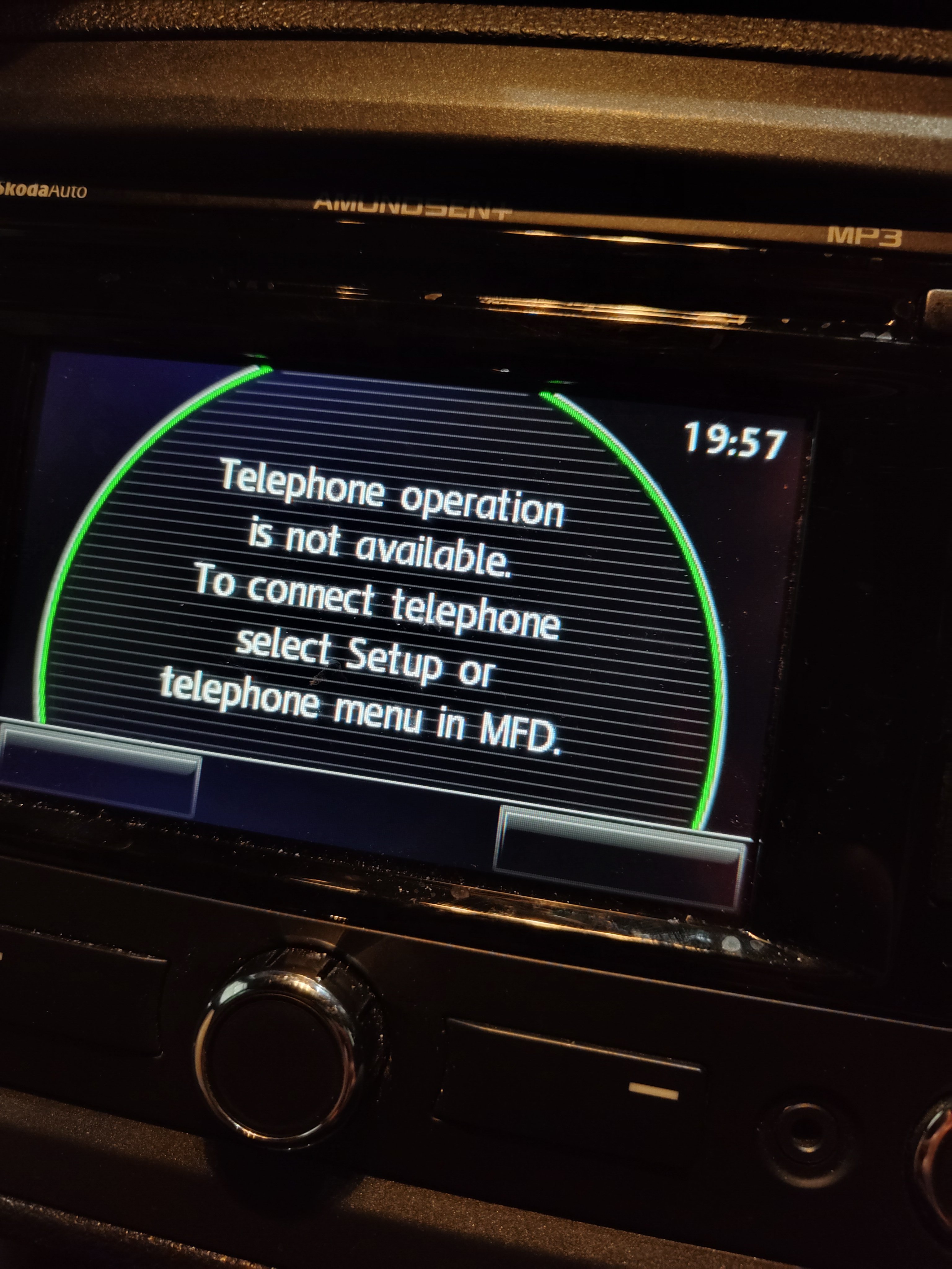

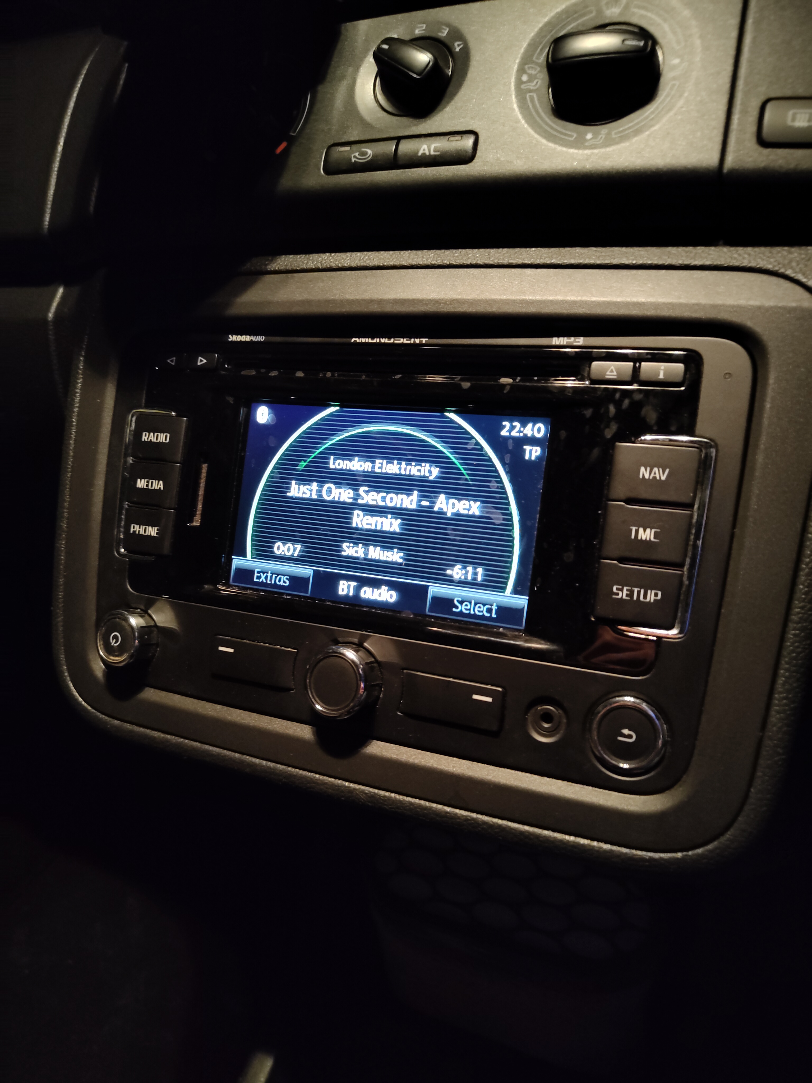

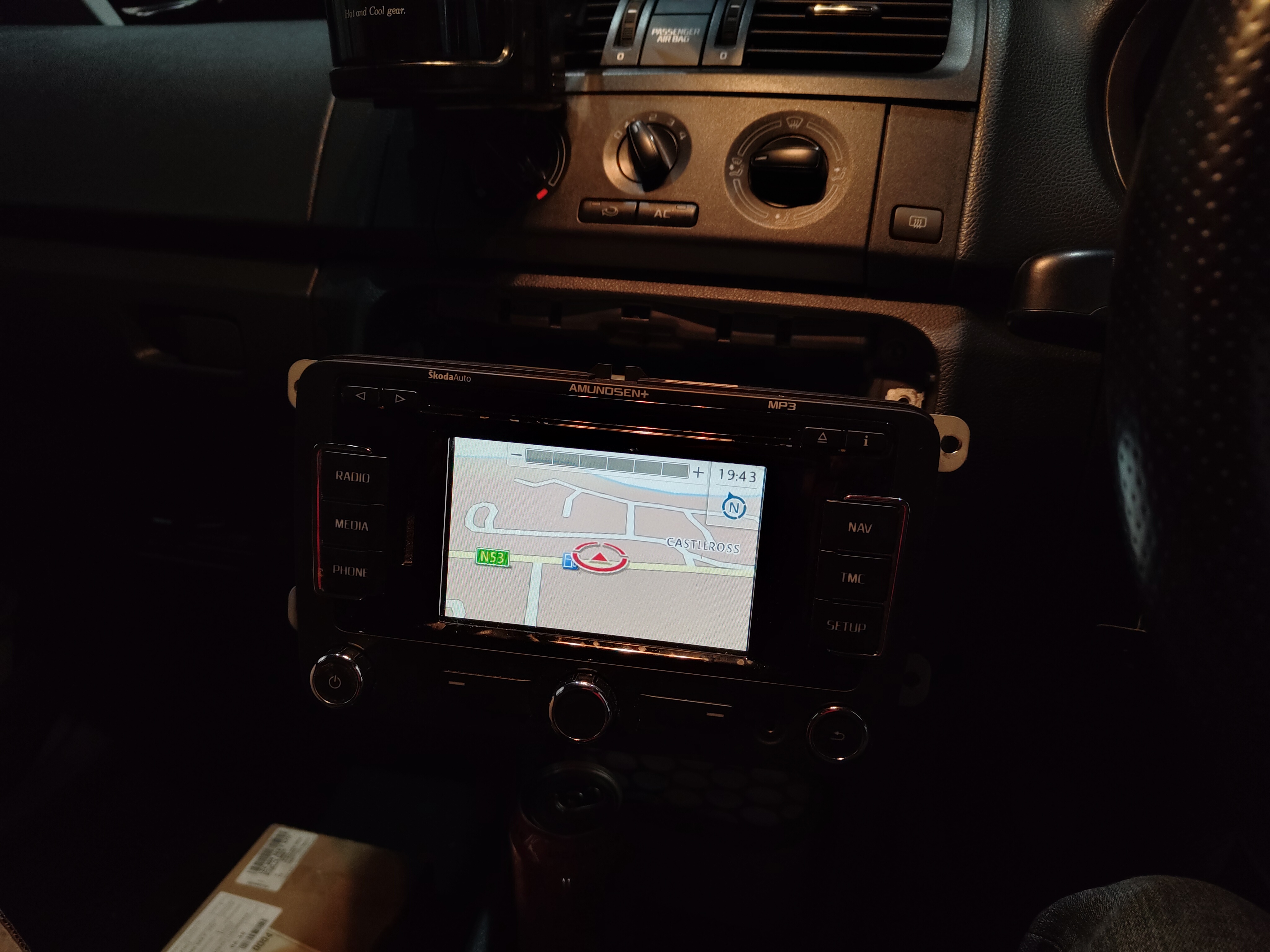

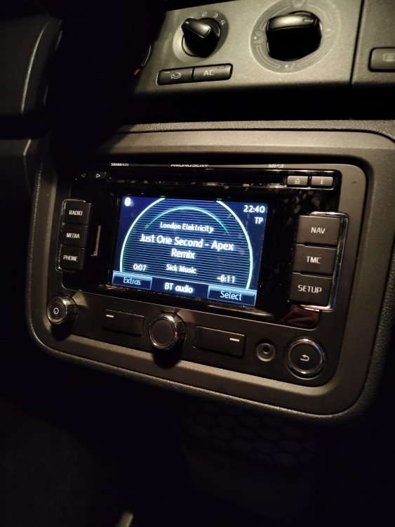

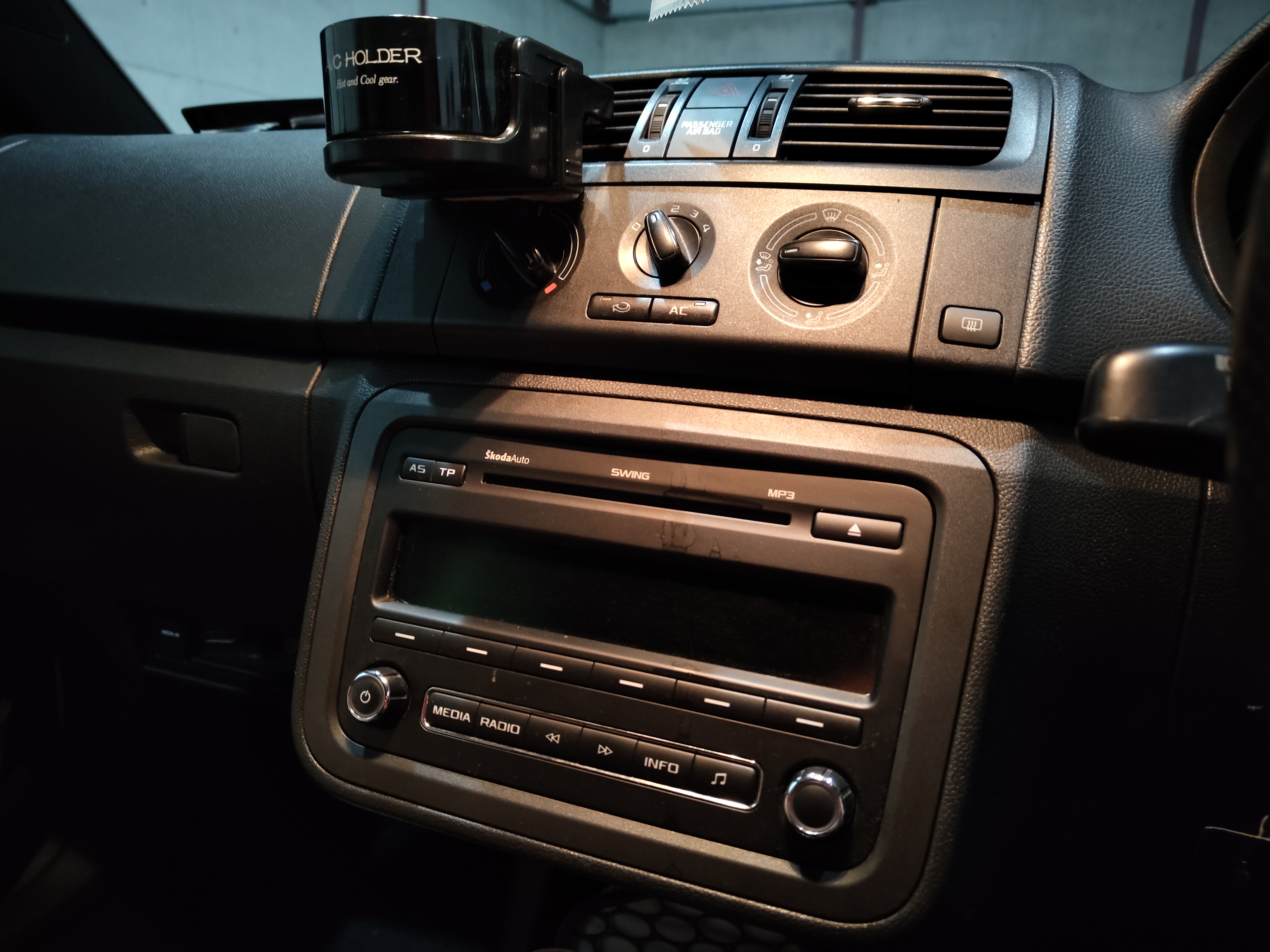

AND finally got an upgrade from my ropey Swing headunit.
Got my hands on an Amundsen+, so Bluetooth and satnav. Neither of which work currently as I haven't swapped the satnav aerial and I need to do some poking around with vcds to get the Bluetooth to work. And I THINK I'll need to put in a mic for the Bluetooth to properly work. IMG_20240110_195852628.thumb.jpg.c7e8e1f022a28a59799660727a28df0e.jpg
Saying that it works well, still have my Bluetooth adaptor so using that. Nice to have a working CD player again too. Did want something Android auto but this is costing me basically nothing and is OEM.
Have an oil pickup tube and seal got too, want to drop the sump and some point and have a look see. Nearly 160k so curious to see how it's holding up. Suspect I have an injector seal weeping too. Plenty of stuff to be sorted to keep it in good shape.
So mixed start to the year but I intend on making the most of it. Lots to do.
Bit of VCDS trickery and Bluetooth is now working. Ordered a new sat nav cable and microphone cable. Should be fully working as it should in a week or 2.

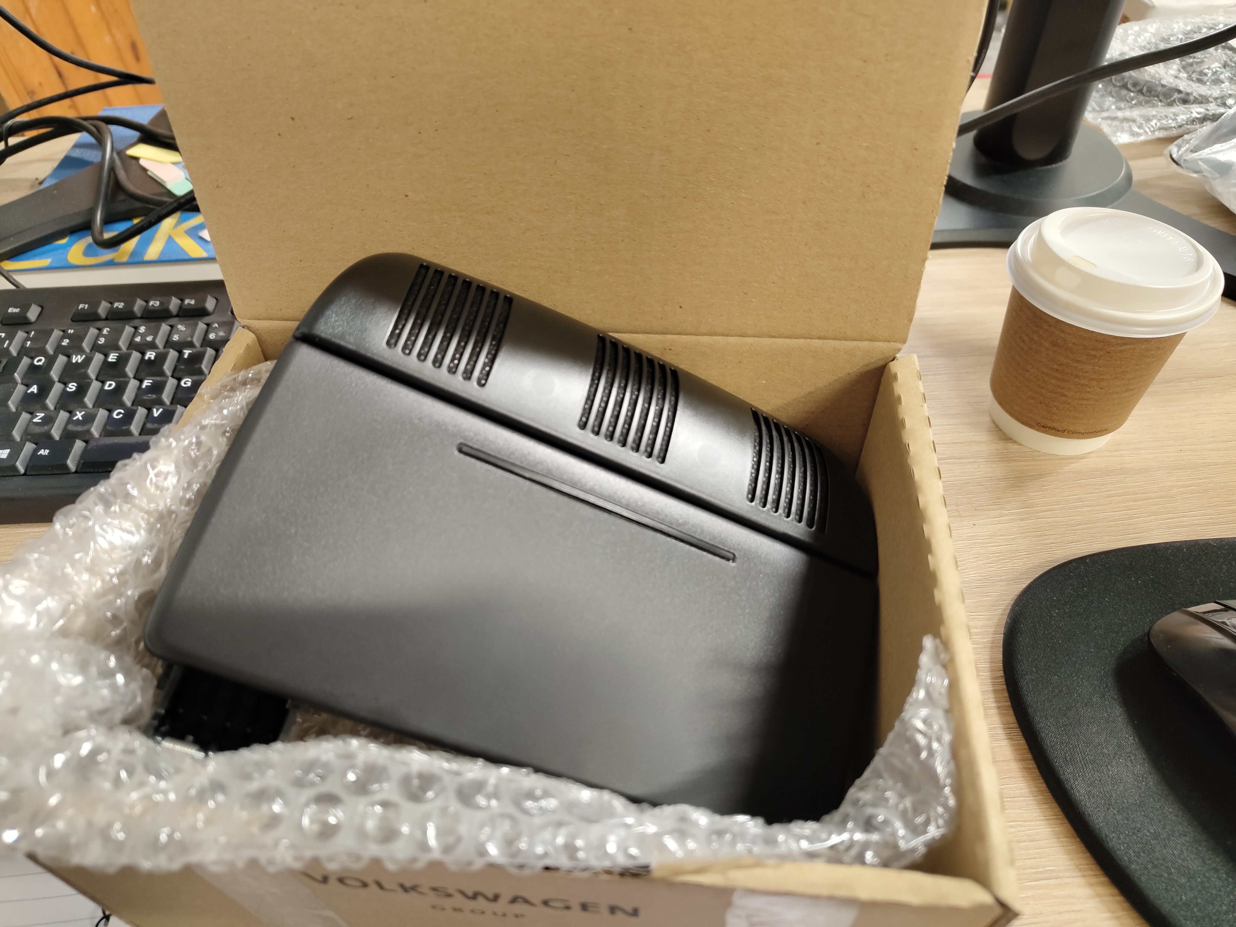

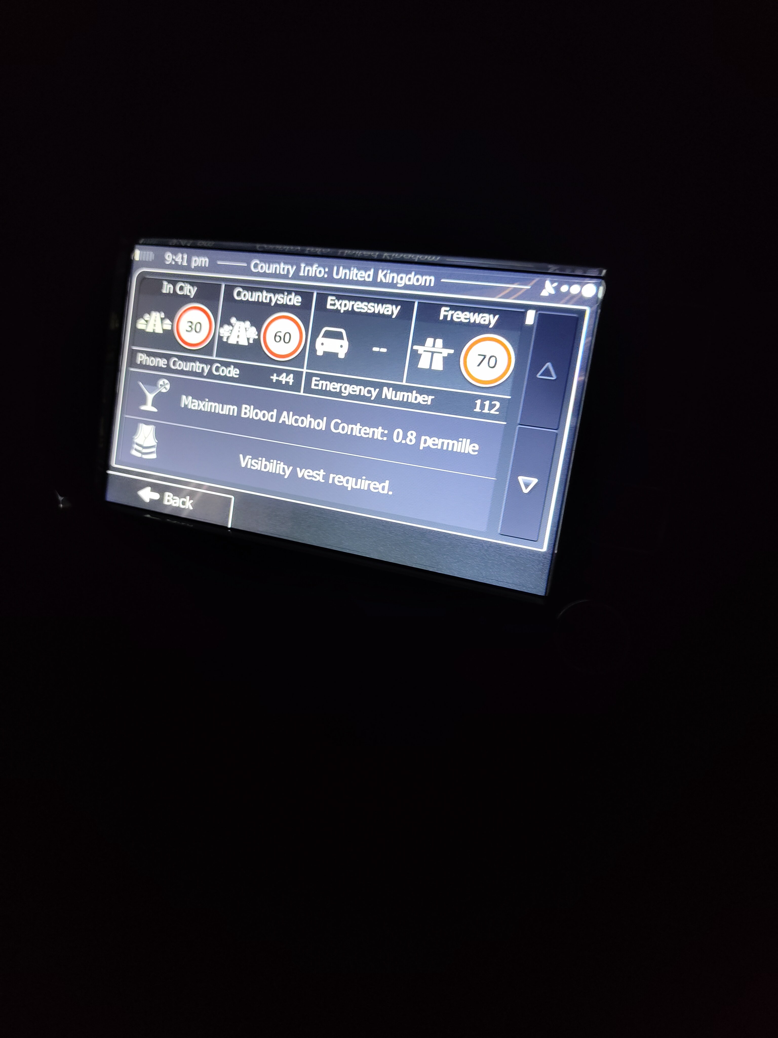

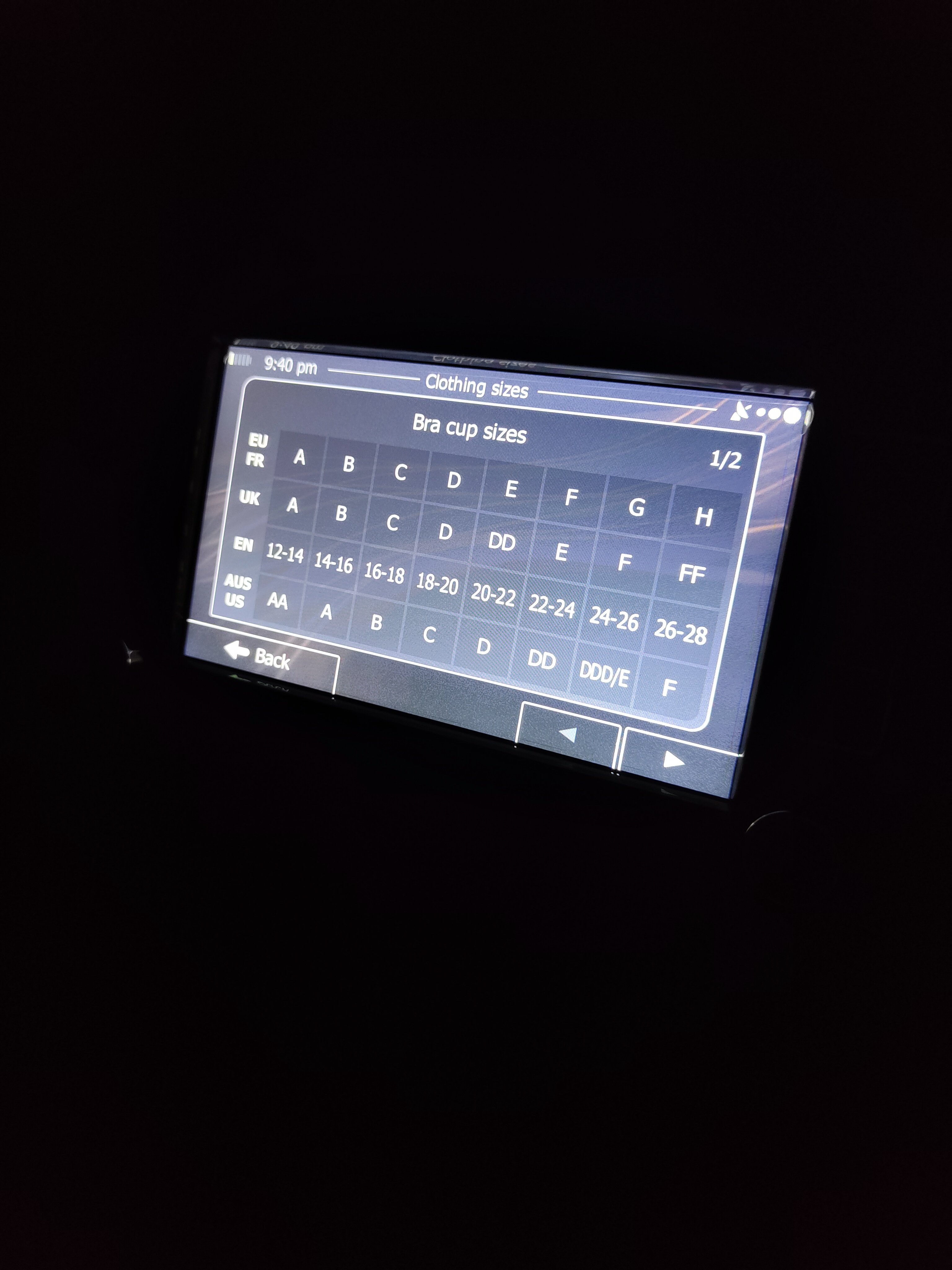

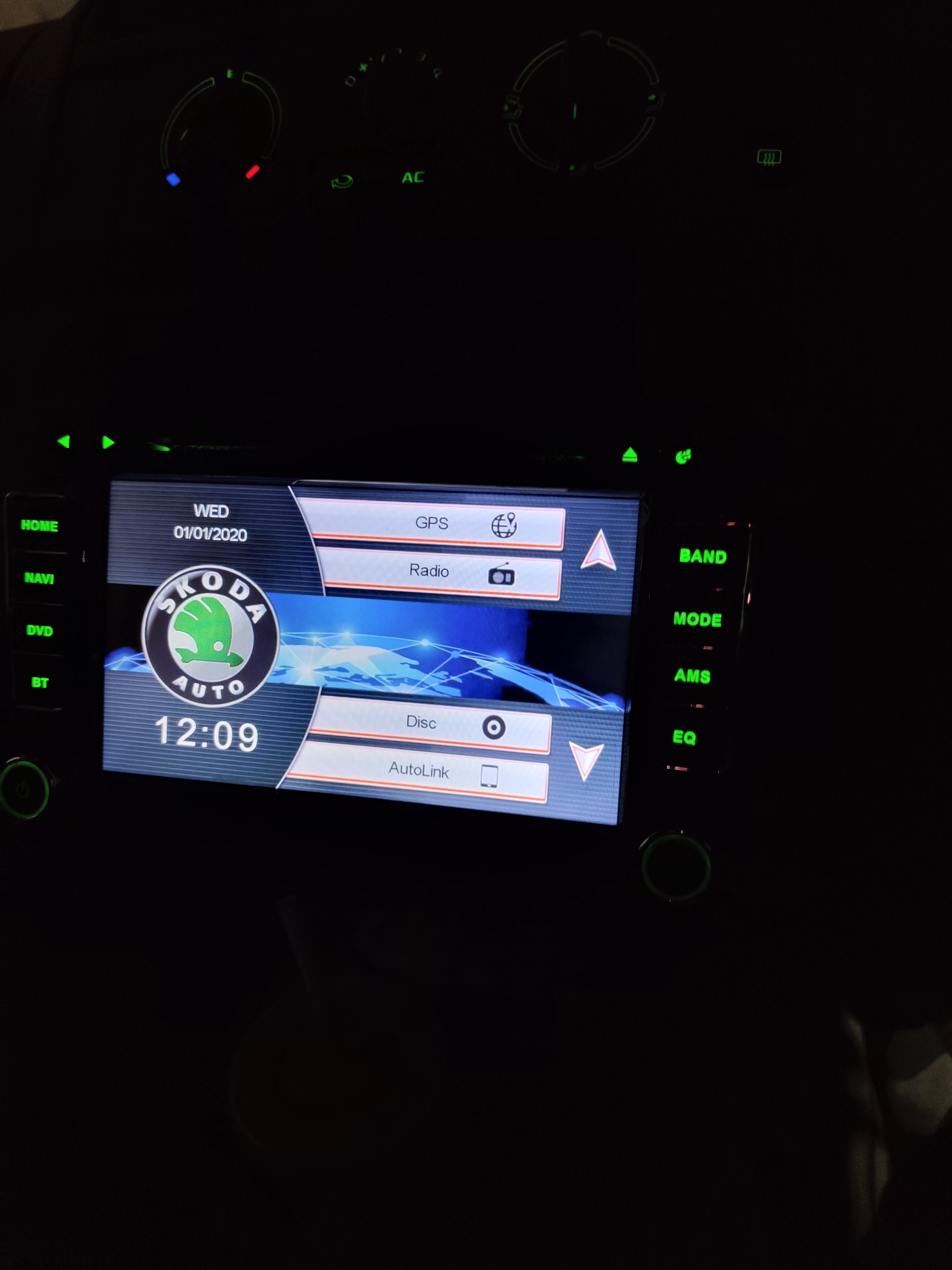

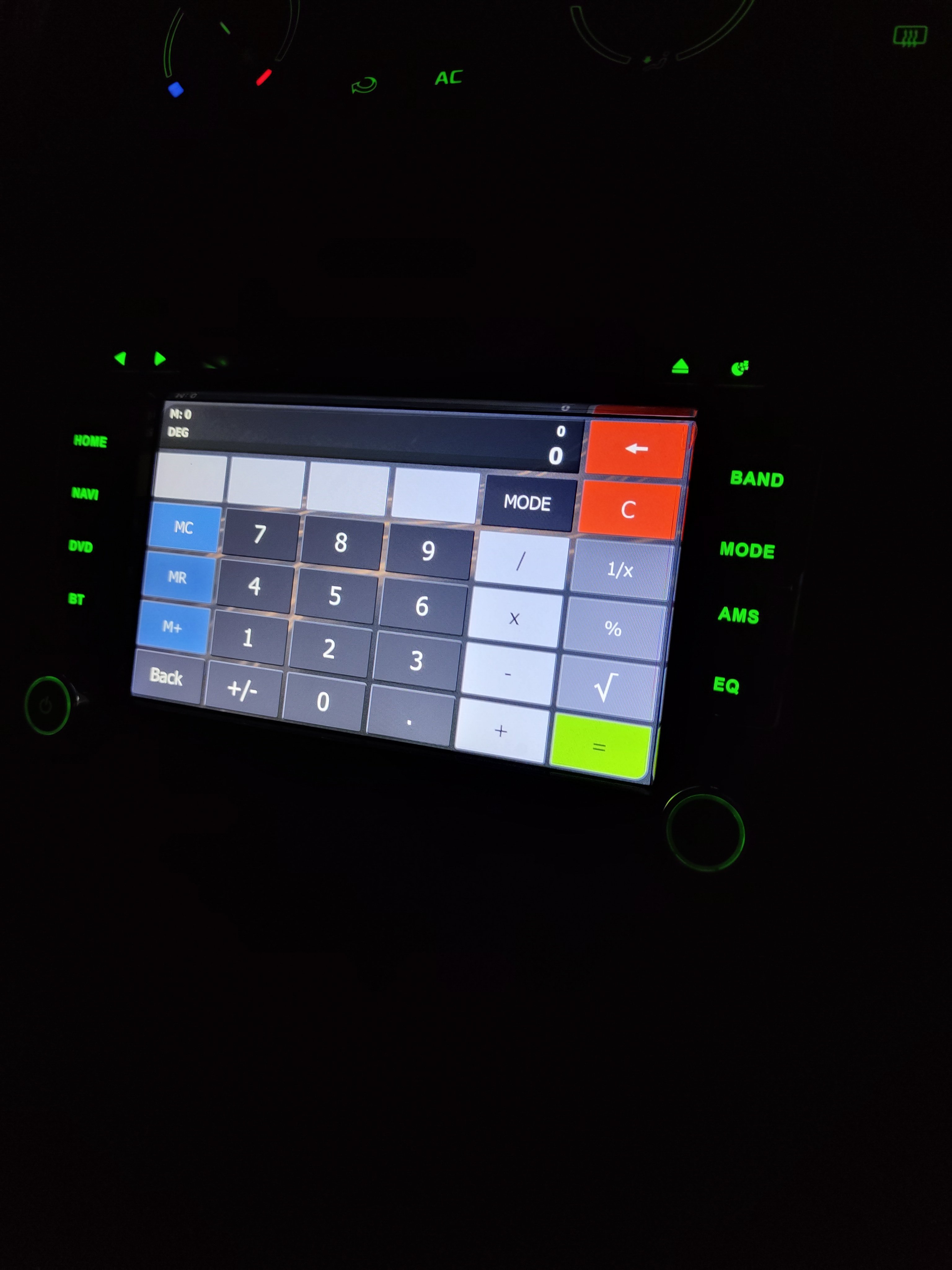

And I got a deal on another radio so tried it out.
Not a genuine unit but fairly smart. New in the box, has satnav via a thing stuck to the window, all works. Bluetooth CDs etc.
Had an adapter loom with a canbus box so plugged straight in.
Has some interesting features including a calculator
Conversion calculator, alerts for speed cameras and road changes, has android auto but cant quite figure it out. Lists of speed limits and alcohol limits for every country.
And bra sizes.
Works well, nice and responsive etc. I'll stick with it as the Amundsen has gone into another car.

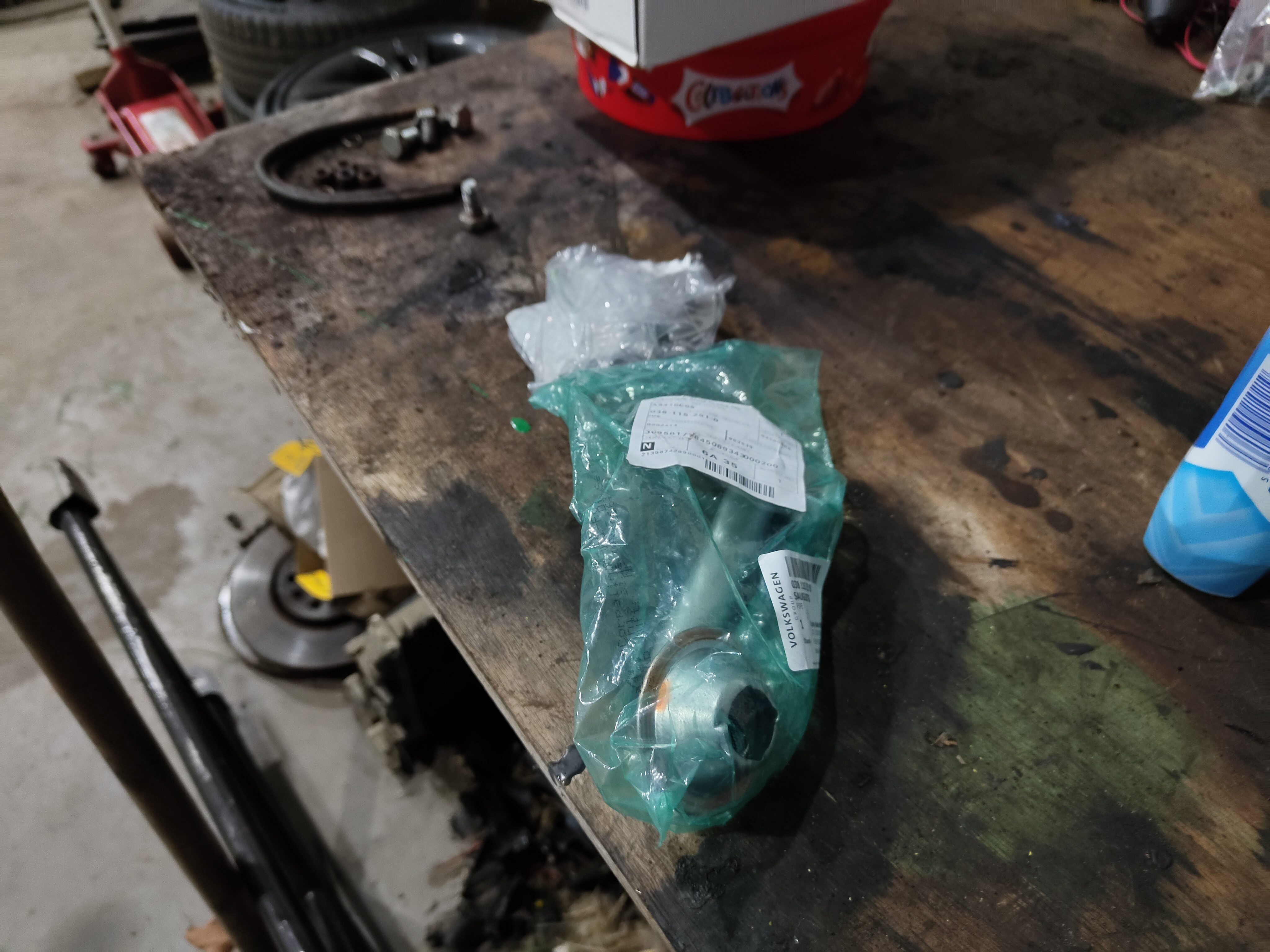

So been assembling a couple of three things over the past while for this. Suspensions been annoying me with bumps and rattles, so decided it was high time for another mid life rebuild.
Ordered the Full meyle HD catalogue, and new shocks and springs. Got a VERY good deal on an ST setup, new in the box.
So this time it has received:
-ST Shock and Springs
-Meyle Rubber Top mounts and bearings
-Meyle Rear Top Mounts
-Meyle HD Ball Joints
-Meyle HD Track Rod Ends
-Meyle HD Inner Track Rods
-Meyle HD Drop Links
-Meyle Shock Boots Front and Rear
-Meyle Anti Roll Bar Bushes.
-Febi Bilstein Rear bump stops (Sports susp)
-Lemforder Bags of Bolts
-TRW Steering Rack Boots
-New Top mount caps (top of struts)
-Mk5 Golf Rear spring rubbers.
-Genuine Top Hats
-Genuine Top Mounts Caps
-Genuine Steering Rack Grease
-Genuine bolts (where possible)
-Genuine Solid Rubber Bushes
-Genuine Air ducts for the Wishbones.

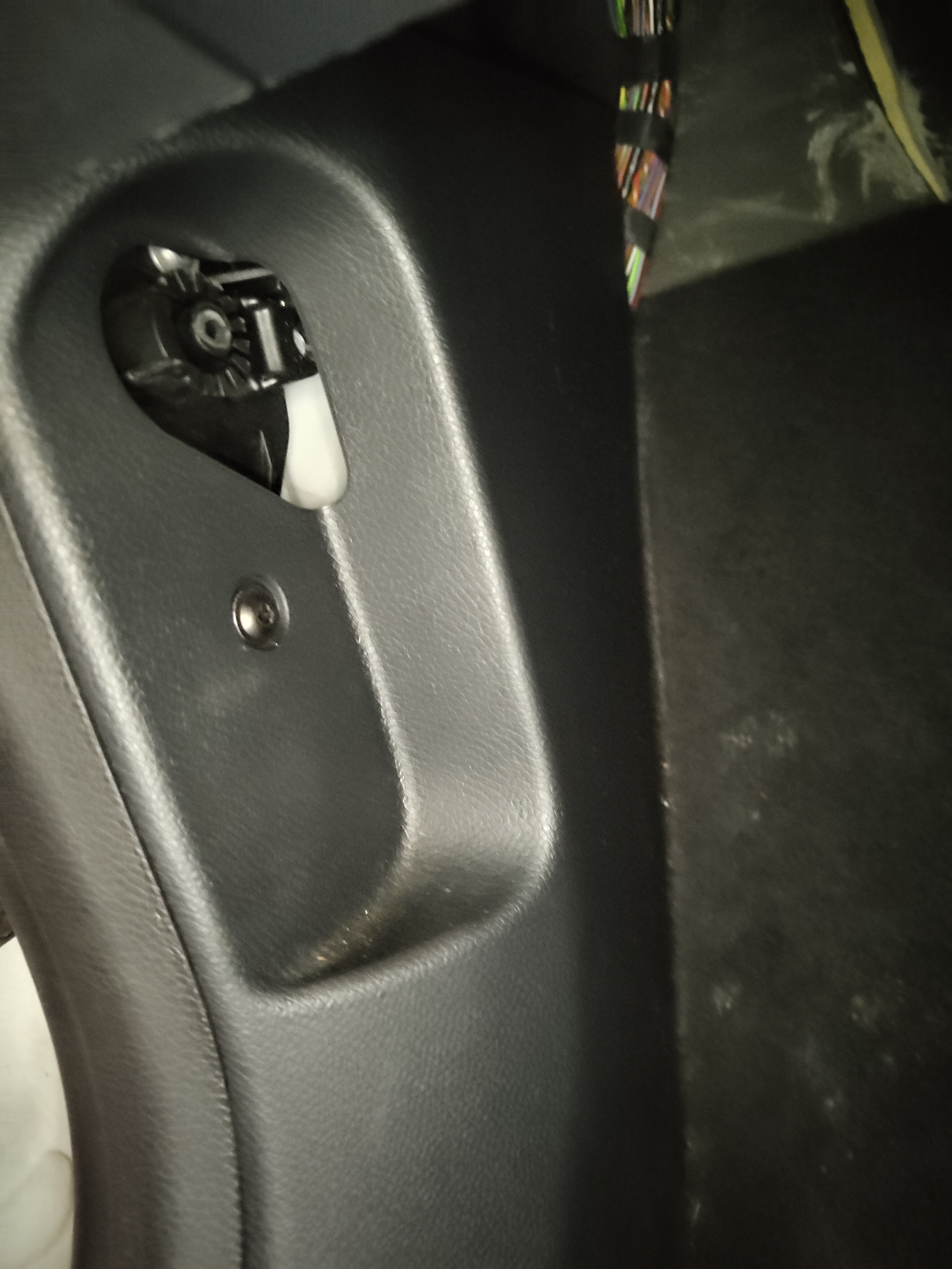

One of my rear buckles has been missing a cover for ages. Got one off the parts car to fix it.
