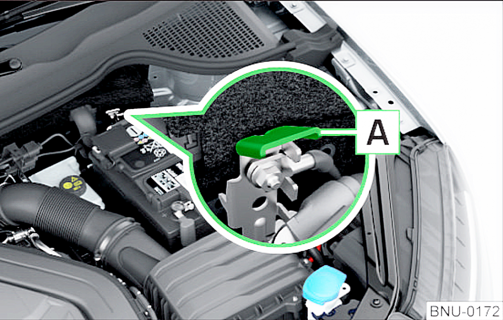

No,   I got the AA trickle charger off Amazon for £26, Positive clipped to positive terminal and Negative clipped to the tab on the bulkhead because you will have stop/start ! and that will be ok.
Thanks for that. I have a C-Tek intelligent charger which should be fine for topping up. Could you explain the reference to stop/start?
RE stop start it's just what I have found on here and in the hand book. If the car has stop start you must connect to the tab near the Neg terminal NOT the terminal it's self.
Ah thanks. I wasn't aware of that.
This is the tab behind the battery where you connect the negative clamp (Manual, Fig.325 - brightened).

Many thanks CTEK  MSX 5 on order and now I know how to safely connect it - after being parked up for a month I had the low 12volt battery message appear when I ventured out for a short essential shopping trip.

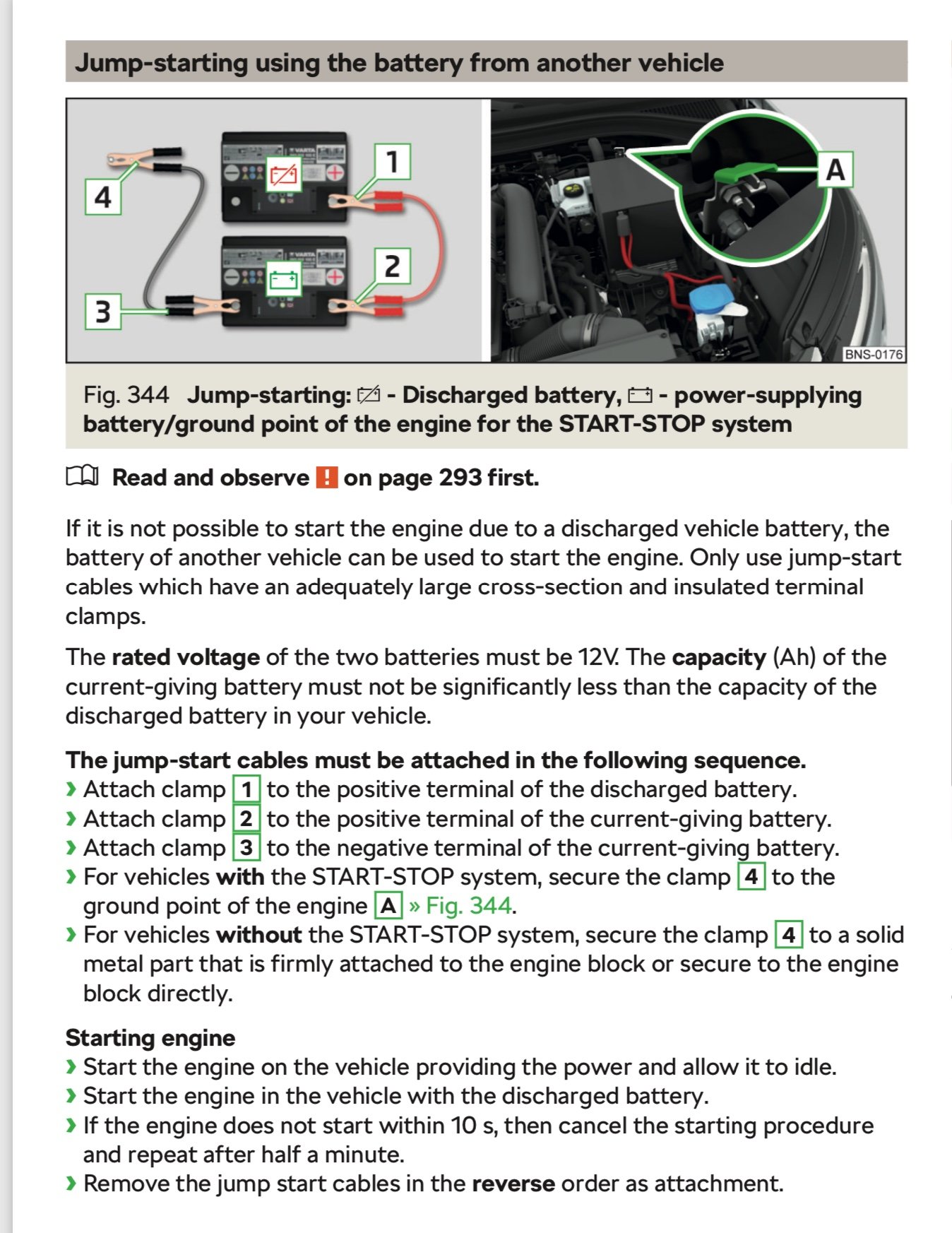

Thanks for bringing that up - you learn something new on here every day. I found the relevant page in the manual and saw that the connection advice also serves for jump-starting from a donor car ..... but what connections are used if the Karoq is to be used as the donor for a flat battery of another car.

So, just to get this straight, if the union is between, say, my Karoq (with stop/start) and my wife's B-max (with stop/start) then the connections are pos terminal to pos terminal and 'ground to ground' regardless of which car is donor/recipient i.e. the neg battery post is never used? Thanks
That is what I would do yes. If you apply the same logic from a car that requires charging or a jump start, you would think a donor vehicle would also need to be wired in that configuration.
Then each car knows the amount of power that has been lost or gained.
If you are in any doubt, contact Skoda, it would be interesting to see what they say.
When jump starting the +ve and -ve leads are connected to the good battery terminals, the +ve lead is connected to the +ve terminal of the dead battery and the -ve connected to the -ve point on the bulkhead as per the owners manual.
I also found that page in the owner's manual - but it doesn't answer half of my question .............. i.e. what happens if my Karoq is the DONOR vehicle?
Edited by StEdmund
grammar
You connect as quoted. Jump leads connected to battery terminals of good or current giving battery as Skoda call it, and connect to battery +ve of discharged battery and to -ve point on bulkhead or to engine earth point if it’s not a Start/ Stop vehicle your starting.
I cannot see anything quoted in the manual about the situation where the DONOR i.e. 'good' battery is the one on the Karoq and I am trying to assist the driver of a car with a dud battery - it's possible that you have a different edition.  Next time I'm in at the dealer's, I'll ask them as suggested by SuperbTWM above.
