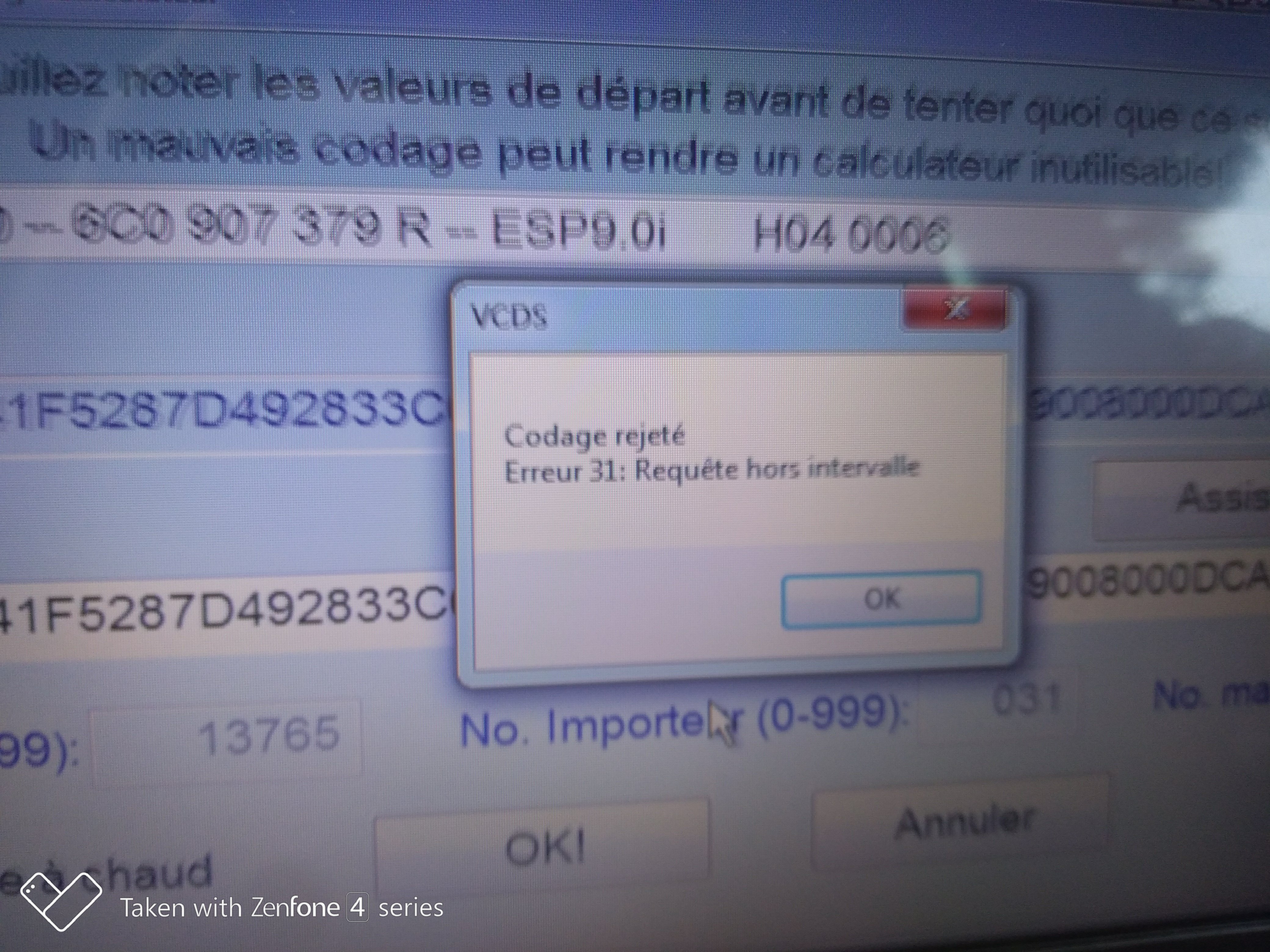

bonjour, est-ce que quelqu'un a déjà activé Hill hold control sur une Fabia monte carlo 2017, l'option est bien présente mais j'ai :code erreur 31, requête hors intervalle
Translated.
Has anyone tried activating hill hold control using VCDS, the option is there but (when I select it) it gives me the code 31 error message.

ESP9.0i can and does support it.
I believe Error 31 is "Request out of Range".
good evening, it's ESP9 Oi that I have, and I can't validate, what do you mean {off page}???
thank you for your answers, it gives me hope, why I can't do it, help me
