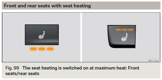

There should be 3 heat levels.
Press the button several times - once turns them on at full power, then press again to turn down the heat to middle, then again for low.
I have done that but still not very hot , can you set the heat temperature at full setting?
The default setting is full on when you turn it on. I also have the same car and my seats are heating up nicely, normally have it on the middle setting.

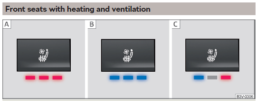

In the UK heated seats are pretty common, but the factory optional ventilated seats (and the perforated leather) are quite rare...
Not many Superbs here with the little fan over the seat on their on-screen menus :D

On my MkII L&K which came as standard with ventilated seats that had switches on the base of the seat, I occasionally knocked the switch accidently with my foot when getting in or out and then wondered why the seat didn't get very hot when I turned the seat heater on.  I'm not familiar with the MkIII ventilated seat controls, but is it possible these can be on whilst the seat heater is on?
